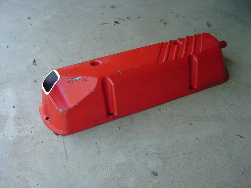

Rory, I am getting some KC rocker covers modified that I hope to pick up tomorrow.
The Kilkenny cast rocker covers have the PVC holes low in the ends of the covers (crap), these I am having welded up. New holes are machined into the top and baffles are welded full length under the covers.
Interested is some pictures?
#6 _rorym_
Posted 12 October 2008 - 03:08 PM
Please..

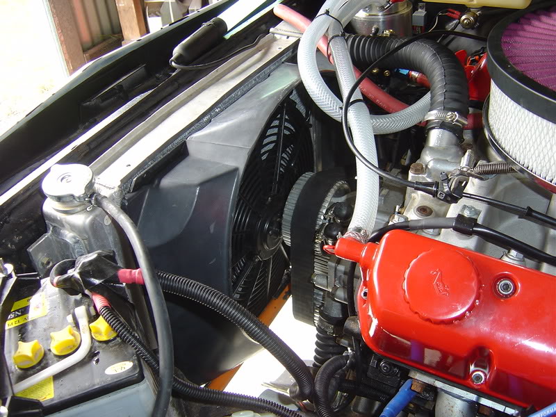

#7 _waz355_
_waz355_
Posted 12 October 2008 - 06:41 PM
Hey Rory,
I modified my rocker covers for the same reason. Is one of your outlets for the catch can at the rear of the tappet covers?
I modified mine so they are both at the front. I found that under hard excelleration the rear of the tappet covers fill up with oil and would get quite a bit of oil in the catch can. By just moving the outlet to the front fixed the problem and almost get no oil at all now.
Here is a photo of my set up.
#8 _rorym_
Posted 12 October 2008 - 09:04 PM
Std VN ones at the front Waz but the height may play a part.

#24 _The Baron_
_The Baron_
Posted 14 October 2008 - 09:48 PM
I hope this works.
How's that?
#25 76lxhatch
  • 7,227 posts
Posted 15 October 2008 - 07:22 AM
That looks great! Is there still enough height in the covers to clear a good set of roller rockers? I'd love to know how it works out, would have to be heaps better than the pitiful attempt at baffle plates that come with those sort of covers!
