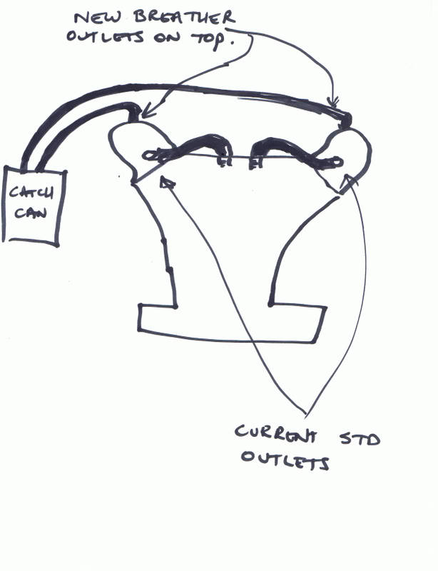

Well this was a thought...tap in some ports at the lowest point..preferably the back...then straight into the valleyy...then have 2 breathers fitted to the highest point to a catch can. I am told L Perkins did this but the lower pipes were on the inside of the tappet covers.

#60 Litre8
Litre8
    Thrillseeker
  • 2,399 posts
  • Name:Howard
  • Car:1976 LX SLR8000
  • Joined: 05-February 07
Posted 19 November 2008 - 04:12 PM
Agree, I still think the new top breathers should be located at the back of the rocker cover too.

Ok what I meant was the new breathers to be on the top of the rocker covers but towards the rear to get them away from any 'wave' of oil under braking. Much like your diagram.
#63 _rorym_
Posted 19 November 2008 - 06:54 PM
See what your saying but I still have the problem with massive acceleration...which this mother is capable of...maybe in the middle would be better?..Then the oil passes under going up and down?
