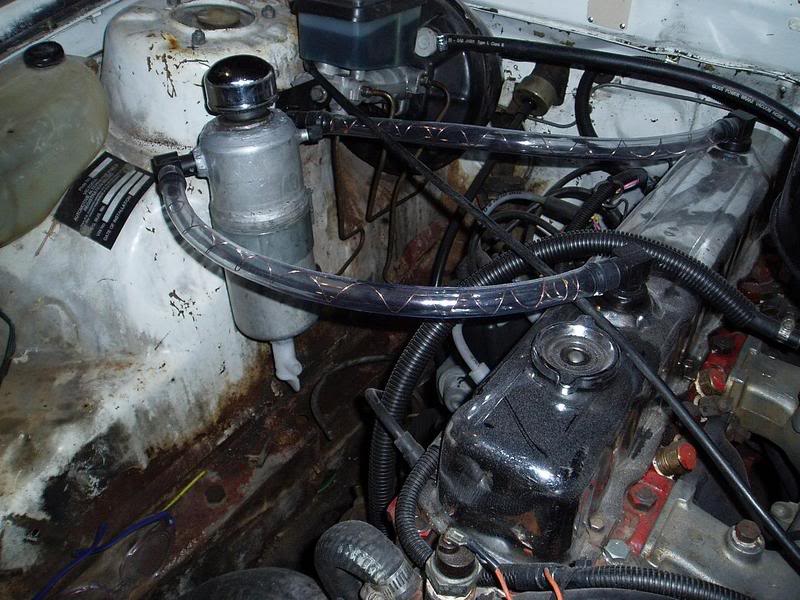

This is the set-up on the Bombadoor. Bargain basement, home made, scrap heap challenge brand. (Don't laugh!) It's capacity is about 2 litres and has no steel wool or such inside, just an empty vessel.
The car has done about 250 laps around Sandown (anti-clockwise) and Calder (clockwise) and every time I've opened the tap to drain it, it has been dry.
The 2 hoses will give you an idea about ls2lxhatch's comments.
#129 rodomo
Posted 14 July 2009 - 05:59 PM
This is the text that accompanies the pic from my thread.
"The catch can was fabricated. The plastic fittings came from the Bunnings garden department ($12 all up) and the hose was $3 a metre. The wire inside the hose is mig wire that I wound around a big screwdriver and pulled through the hose to stop it from collapsing. I mounted the catch can higher than the rocker cover so that any oil would collect in the hose, hopefully, and drain back before it got to the can. The plan here is that the "catch can" relieves pressure rather than catch oil. The coiled wire might help to catch the oil droplets, let it drain back, and let the pressure pass over?"
The fittings and hose are 19mm.

Thanks Rodomo for pics and i agree with your theory regarding height of inlet to catch can being higher than rocker covers to minimise actual oil transfer and just allow for vapour .
This is why i am chasing pics of setups would be nice to see a coupla V8s as i am struggling to see a spot with "height" in my engine bay?

Running the hoses higher, then lower to the can would probably work the same.

Thanks Rodomo and ls2lxhatch, great to get some pics and logical explinations to the problems at hand. I like the idea of the two hoses, adding another at the front. I also like to idea of the higher hose position, and basically I am understanding the whole oil/air/pressure process alot better, so thanks.
