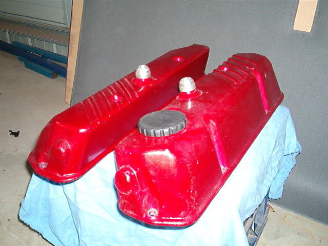

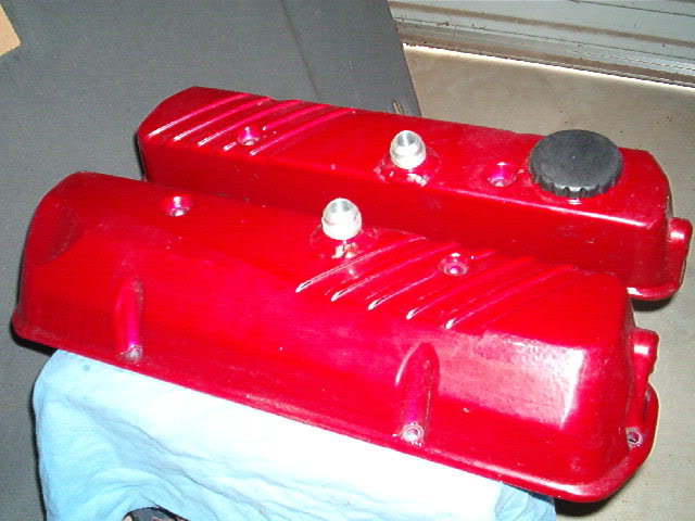

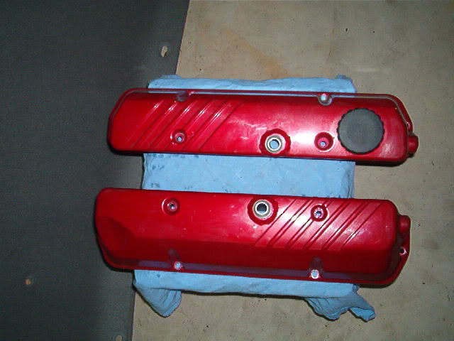

Mine are being fitted the same as Gregs but on the inside where his are on the top.
#91 _evil UC hatch_
_evil UC hatch_
Posted 14 January 2009 - 08:17 PM
wouldnt they be better on the top like the ones pictured Rory? the higher the better I reckon

Posted 15 January 2009 - 05:59 AM
Put them on top. The oil gets flung against the sidewall of the cover more than the top.
ALSO u need at least -12 size hose for breathers. Smaller hose raises the pressure in the line and increases the airs ability to carry oil with it.

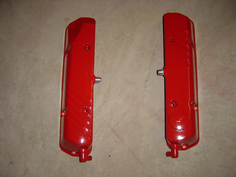

#95 _rorym_
Posted 19 January 2009 - 09:30 PM

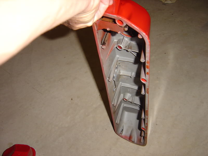

After much soul searching and advise from ex HDT guys and LP boys I decided to fit the breathers in the inside at the highest point with a baffle.
The pushrods with a .035 hole looked ridiculous so I punched them out to .050 ...think this will work as long as we don't idle it too long. Ripping out the H/V oil pump b4 the weekend and fitting the std size one as well.
