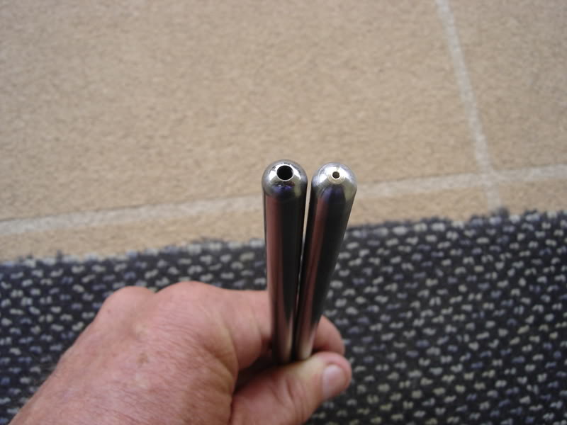

Posted 21 January 2009 - 11:46 AM
Part of the fix.

my eng builder told me to put some pipe cleaners in the pushrods
what do u guys think?

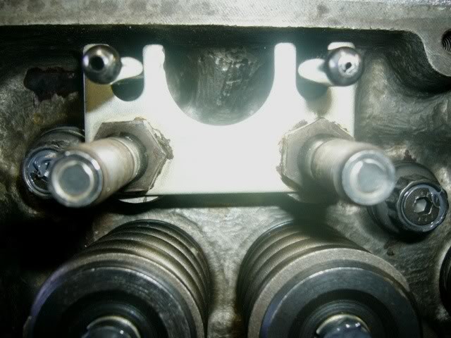

#103 _why-psi_
_why-psi_
Posted 21 January 2009 - 05:48 PM
heres my breather tank. i was thinking of running a line from the bottom of the rocker cover to one of the sideplates as a drain. or does it not need it?
#104 _rorym_
Posted 21 January 2009 - 08:18 PM
Someone elses problem solver.
#105 76lxhatch
Posted 21 January 2009 - 08:19 PM
Is that a roll pin?
#106 _rorym_
Posted 21 January 2009 - 08:35 PM
In the interest of future users and as suggested earlier and speaking to 82911 on my bearing clearances and how my builder has shimmed the pump to the engine, we have decided to run the H/V for now and see where this all ends up. If it still pumps up I can then change to my new std pump.
I will keep all interested parties informed....and Yes...that is a roll pin and his mod works a treat...gotta love aussie ingenuity!!.
Edited by rorym, 21 January 2009 - 08:35 PM.
#107 ls2lxhatch
Posted 21 January 2009 - 10:03 PM
I would be more comfortable with the idea of using a roll pin than using pipe cleaners.

#109 _ass308_
_ass308_
Posted 22 January 2009 - 05:27 AM
the pushrods i bought for my engine,came with roll pins,in the packet.
#110 _rorym_
Posted 22 January 2009 - 08:43 AM
Now thats interesting.....
#111 TerrA LX
Posted 22 January 2009 - 12:22 PM
Brands and pictures please.
I was always worried that a roll pin may gouge into something if the pushrod end was not smooth as.
#112 _ass308_
_ass308_
Posted 22 January 2009 - 12:24 PM
sorry rory,i have lead u astray.the roll pins didnt come in the box with the pushrods.my engine builder bought them home from his work.he was going to use them,but changed his mind.it looked to me like they came together.when i first saw the pushrods,he had the roll pins in his hand,with the pushrods.
anyways it seems like its the way to go.as far as my engine builder is concerned,its ok to use roll pins in pushrods
im watching this closely because ill have to do something to.on the dyno i blew the elbows out of the standard vn covers.but there was absolutly no trace of oil coming out,at the moment
#113 _rorym_
Posted 22 January 2009 - 01:32 PM
There will be..the drain backs are smaller...
#114 Evan
Evan
  • 1,287 posts
  • Joined: 14-January 06
Posted 22 March 2009 - 12:09 PM
Sorry to bring back up an old thread, but what was the conclusion on this matter?
Did the .050 hole in the push rods restrict the oil flow to the rockers? have you stuck with the high volume oil pump or did you go down to a standard one?
Im going to ring the guy doing my heads and get him to drill the drain holes on my VN heads to 10mm.
Evan.
