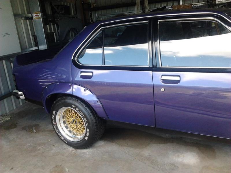

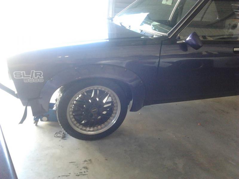

Screwing around the idea of different rims.
I sat the OM's up just because i can. :)

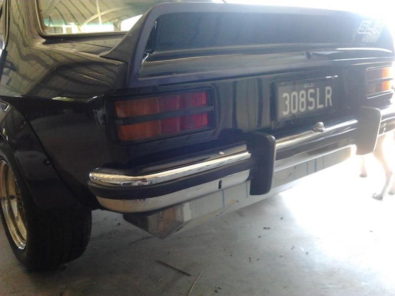

Screwed one of the plates on today. Still pinching myself that i got them. :)

Hard decision on the wheels Col, they both look pretty good.
And as for the plates, well done mate, what a score!!  :clap:  :clap:

Gold wheels looks good Col, but better to look at the whole car to decide  B)

Nice arse
I reckon black one side gold the other

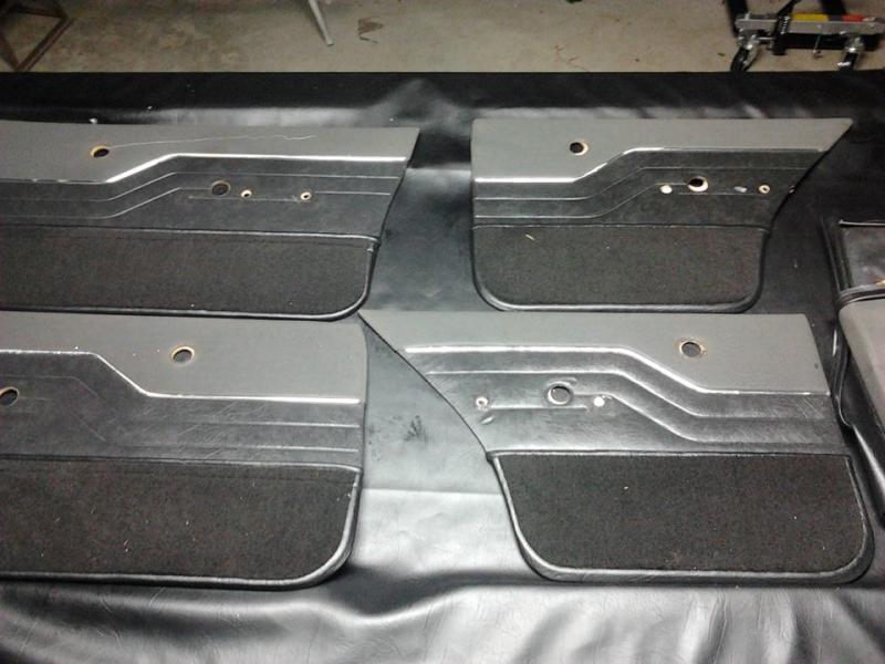

Door trims finally arrived. They are now fitted. Interior is looking good. Sarina Upholstery donated new clips. ( i presume they were donated because i didn't get an invoice) They will also be fitting the rear seat covers for me. ( which is when i will probably get the invoice) lol

You went with LX door trims?

Get those OM's out to 9" and 11" and you'll be looking good.
#435 Ice
Posted 25 February 2015 - 07:29 PM
You know your gunna paint the V5s black they will look pretty good imho
The interior is from 'Black'. I prefer the LX stuff over the LH stuff.

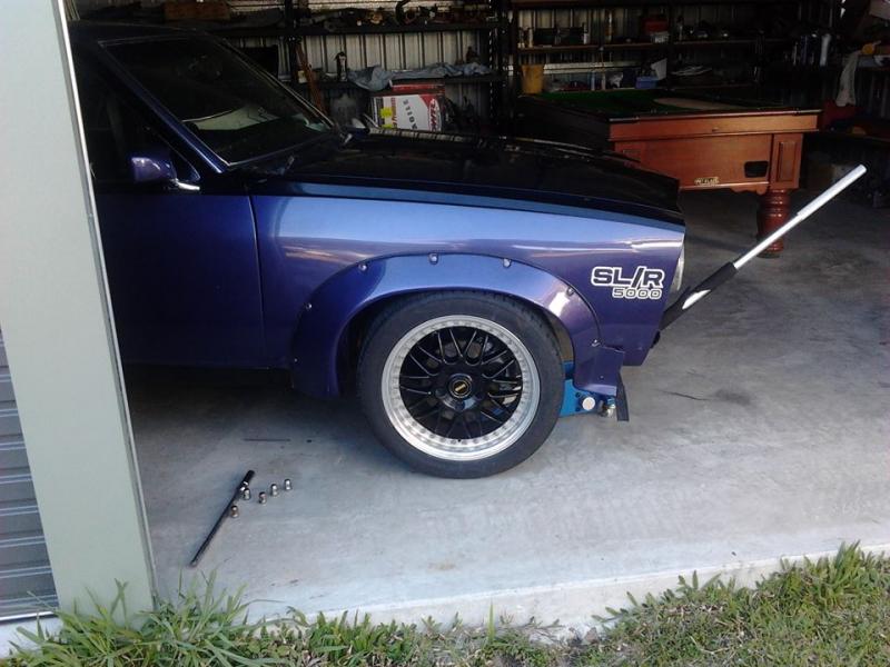

Change rotors, fill/drill rear axles, replace front/rear suspension, order new inner/outer bands ........... nah! That's an expense i don't really need. Stick with the V5's ( but i will change the color)

Tail pipes re-done.
That will teach me to tighten up the wheel nuts. All the clearance faded away.  :banghead:
