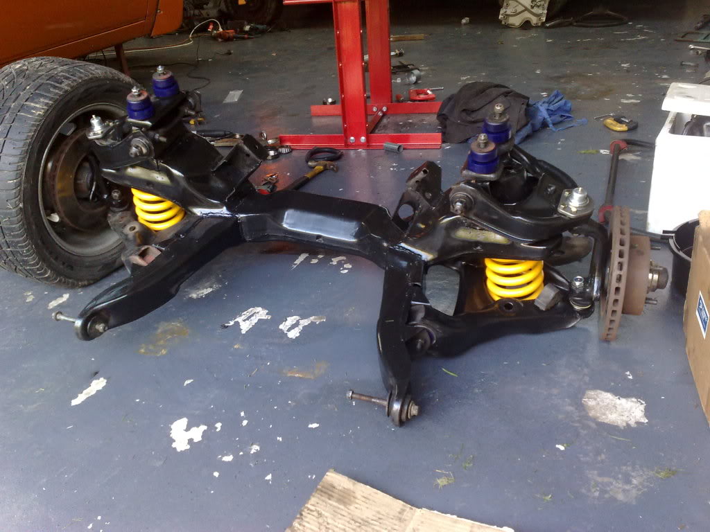

Here is a slight update...
Things have kinda stalled of late... The front end will be ready to go back in over the weekend (Not sure if i'll have the time though, thats the only problem! Thank god for daylight savings though!)
Here is a crappy pic:
Both the front convo's went flat and the bead seal went, so i have to get them to a tyre shop and have that fixed so they hold air again! Dammit! Notice the front left control arm ain't painted... long story but it doesnt look like that anymore... Have the right one and its all painted and sexy now! haha.

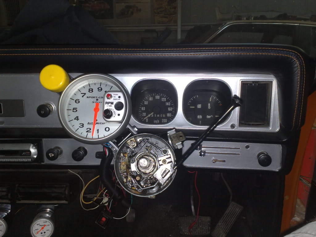

New Steering Column is in..
Now I have the hi-beam on the stalk and not the floor. So hopefully once its all wired up i won't have headlight issues anymore!
Also, check out the freshly trimmed dash pad! Matches the rest of the trim now.

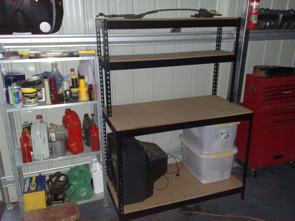

Any I finally have a bit of a workbench!
Thanks mum and dad for the B'day Present! haha
