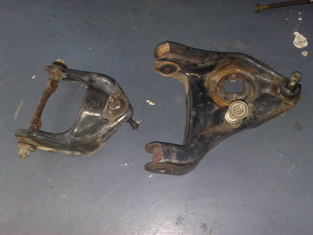

heaps of degreaser and elbow grease should do it
but if your lazy blasting will work i spose
if your not reusing your old rubbers/ball joints?

I'll see how i go with the wire wheel Ryan... Otherwise i'll put a tarp up and go nuts.
After seeing heaths thread with the KBS paint, I'll probably go down that path (Or POR15) Looks nice and easy and gives a good quality finish.
I can't believe how oily and dirty all these parts are!!!

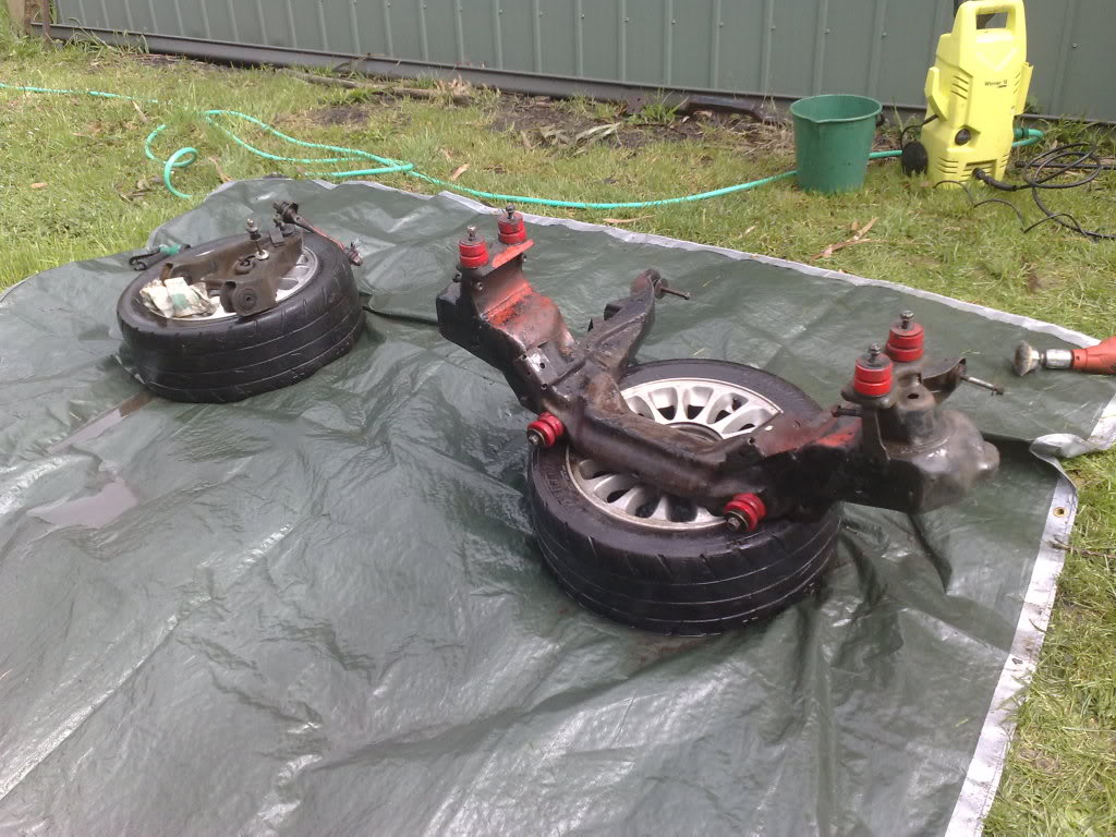

Yeah, i spent this morning cleaning all the parts up.... Some petrol to lift the gunk, hi pressure hose to clean it off, then a wiring brush on the drill.... Worked a treat! I'll grab some pics tomorrow, I've very happy with how well they cleaned up. Can't wait to paint them yet!

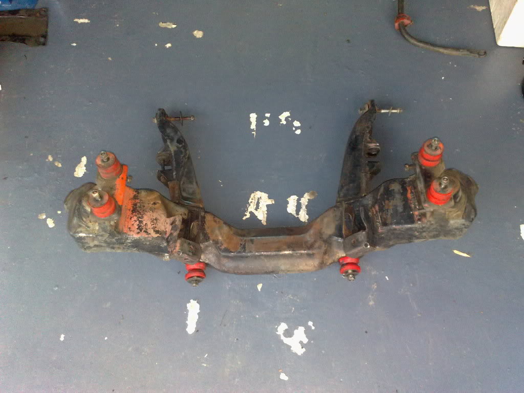

Here are some progress shots... nothing really exciting...
I should have got a before shot of this stuff.... The dirt & grease was about 5-10mm thick all over it!!! Now it's clean and basically ready for a lick of paint!

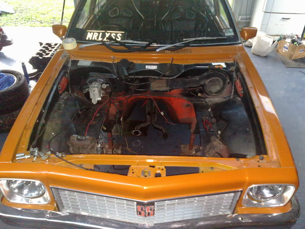

Also got started on the wiring.... Either going to run it under the lip, or inside the guard.... So far i'm liking the idea of it running under the rail... Very easy and simple!
Engine will probably get started on later in the week.... Crank is an AUSCRANK (Thats whats stamped on it). Going to chase up the numbers stamped on it and try and suss out exactly what it is.
Everything else seems to be pretty good.... Just going to machine up the surfaces, clean it all up, new rings, bearings, cam, springs etc and also reco the heads... I'm really looking forward to dropping this sucker in!!! It's going to go well for what it is!

I'm guessing you used degreaser and that high pressure gadget to get all the crap off the kframe??
I reckon run wiring under the lip in the engine bay in dune tubing, still accessible yet tucked neatly away out of sight.
Edited by Brad1979UC, 22 August 2010 - 11:07 PM.
#344 MRLXSS
Posted 23 August 2010 - 07:49 AM
Yeah, i use petrol that i scrub on with a brush.... works HEAPS better than out of the can degreaser.
