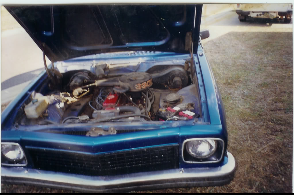

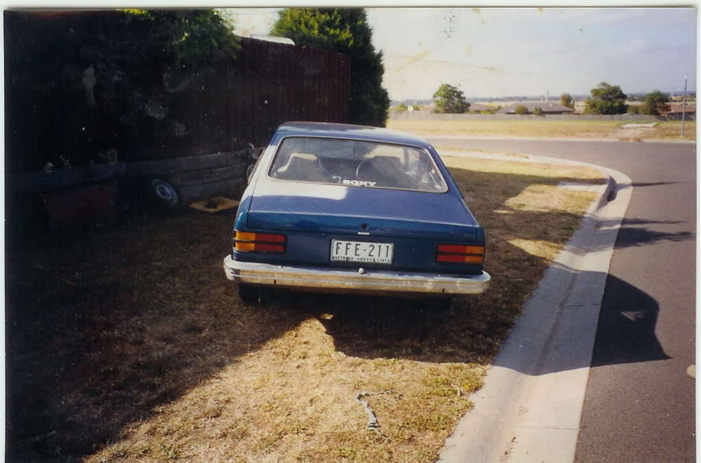

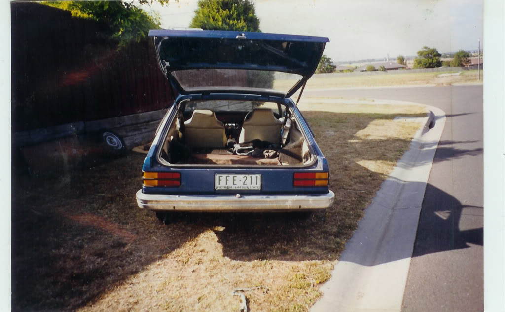

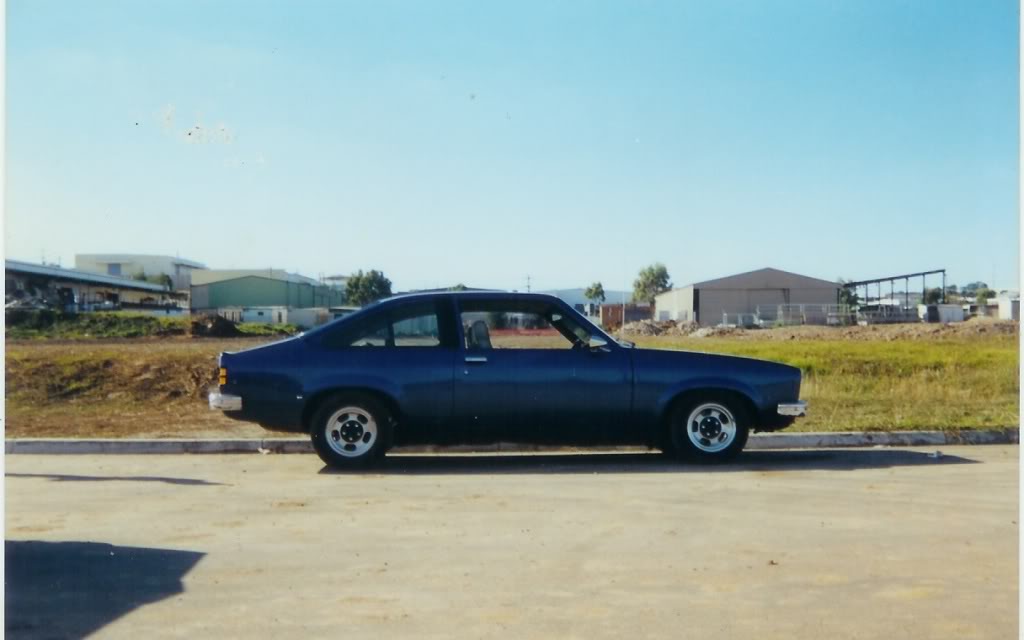

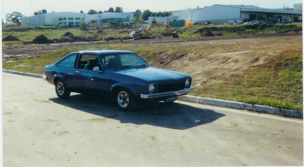

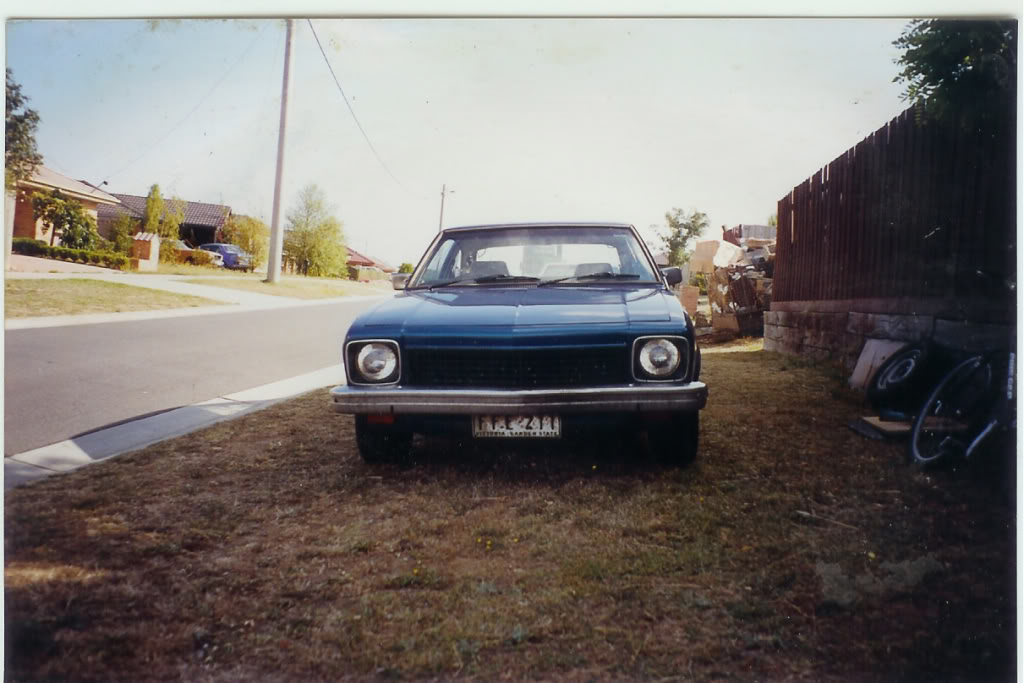

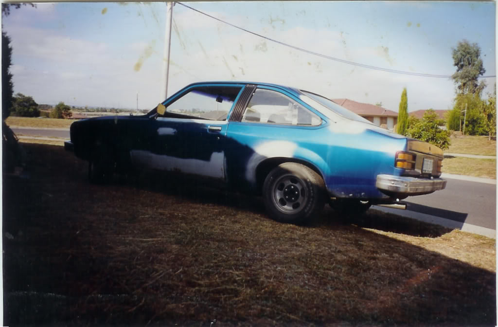

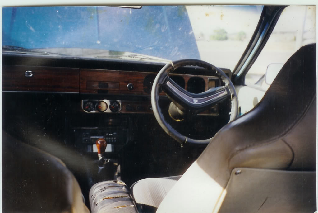

Check these out!
The previous owner (Two owners before me) of the car traced me down off here and forwarded me pics of the car when he owned it! How cool is that!!
This is when how it looked when he bought it.
Then this if how it looked after he gave it some TLC.
I believe he (Chris - SLYLX) owned it from 2000 to 2002, then sold it to a friend, who then sold it to the guy that I bought it off (Street Class Performance in Hallam) in 2003.

should have kept it like that!much nice flareless and blue!!!and a 202!!

HAHA! Yeah, tough as nails!
Remember how smooth the paint on the roof was!
Although, if i remember correctly before you came along with the offer to help with paint, finding me wide dragways at swap meets and coming across flare kits on ebay the Torana was destined to be a flareless blue hatch!!! HAHA!!

ah memorys
where that hot drivers mirror go??

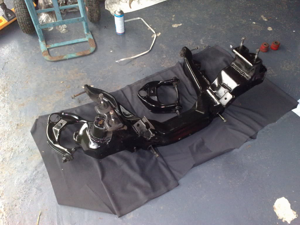

Posted 07 September 2010 - 10:05 AM
Front end looking a lot nicer than before!
My new pipes arrived today as well! Look great! Ryan is coming over tonight to help press in some bushes and also bring over the new control arm he picked up for me! (Legend!)

Front end looks good Matt. I read right through this thread the other night. Love the transformation your cars undergone throughout the last few years.
Hey also just looking at the front end there, how did you remove the upper ball joints and how will you be replacing them? Just wondering cos when I rebuilt my front end I stupidly didn't replace them and now theres a rattle in the front end that through elimination I would put down to being the upper ball joints.

There's no point in replacing balljoints unless they are actually in poor condition, I wouldn't necessarily regret that. Do they actually have some play Mick?
#372 MRLXSS
Posted 09 September 2010 - 08:57 AM
Yeah, Mick i was told by a mechanic that my uppers were dodgy and should be replaced before they let go. The lower ones the boots were all buggered and needed a birthday.
I was reading, and as heath mentioned. The best ball joints made were the Holden ball joints, so if they are still in good nick, leave them in!
With the top ones to remove, i grinded off the top of the pin things, then knocked them through with a drift. Fairly straight forward.
