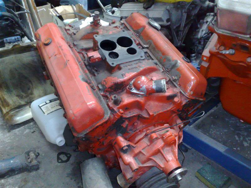

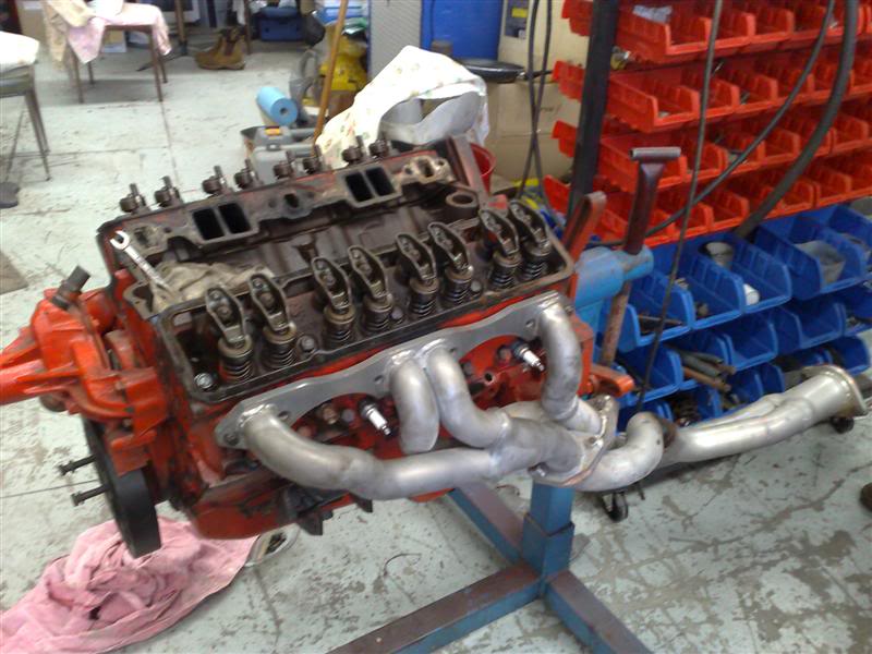

My Uncle had this stock 2-bolt 350 Chev that he removed from his '69 Impala... the plan was to shout it some bearings and gaskets, plonk it in the car, and go cruising. Back on the road nice and cheap!
But a quick mock-up of my extractors (lucky I checked this before starting) - revealed no spark plug clearance. My pipes were hand built to suit angled plug heads, BUGGER!!
The block also turned out to be 0.060" up already, which didn't worry me, but it became too hard. Even using my old heads after having them repaired wasn't going to give me decent comp without changing bottom end parts... so it defeated the whole purpose of this "cheap" exercise....
Next please....

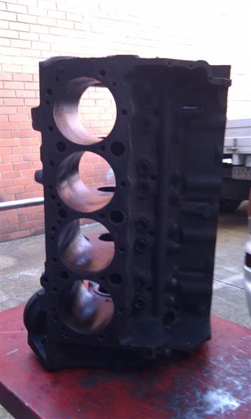

Deb and I cruised down to see Milan (who owns the MENTLE Camaro) and picked up this beauty for only $350... a virgin bore 2-bolt 350 010 complete short block, looked mint:
My engine machinist seemed real happy with this too, but after a kero wash, he found some cracks in the valley, DAMN!!! We also found lumps of melted alloy and blackened components... turns out this one had been in a decent fire. Oh well, not to be.
Next please...

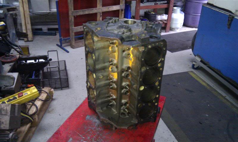

Some more forward progress.

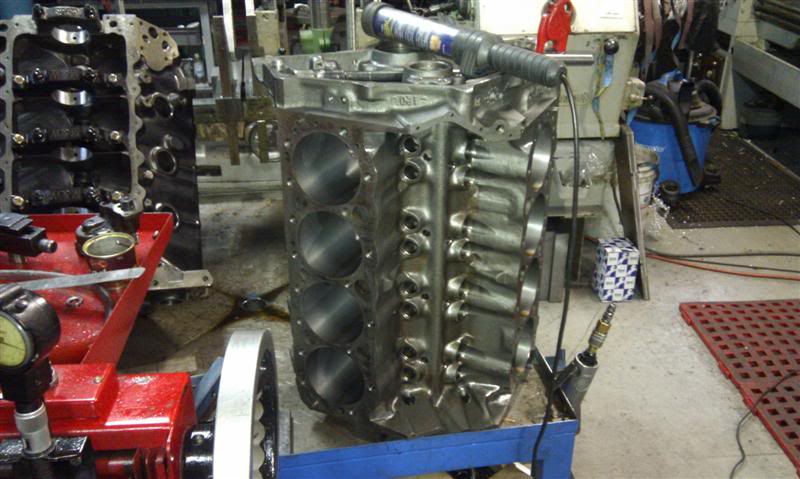

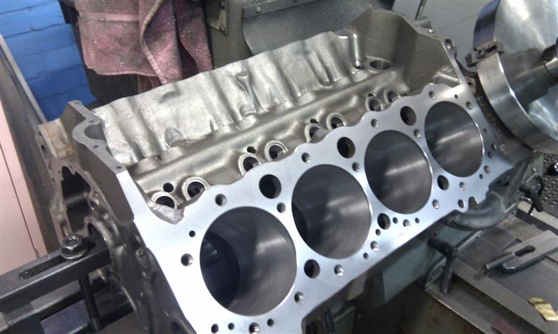

Block is no longer virgin bore... freshly bored just shy of 0.020" :

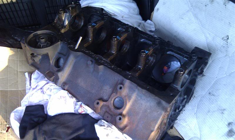

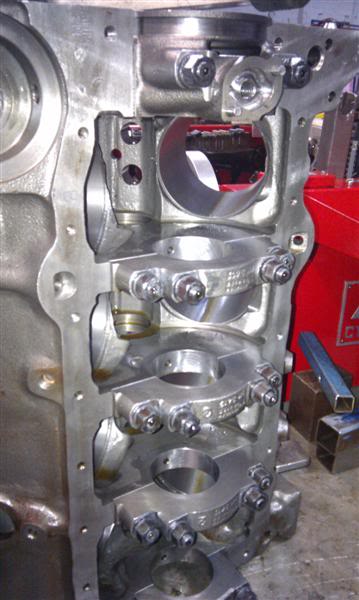

ARP 4 bolt main stud kit fitted, so that the main tunnel could be checked and line honed:
Bores now honed and finished to 4.020". Block decked (zero deck height). Some de-burring in the valley to aid oil return flow:

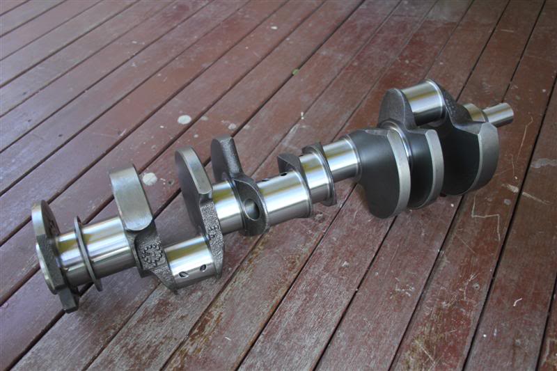

Here's some photos for those of you who enjoy looking at fresh, shiney new engine parts!!

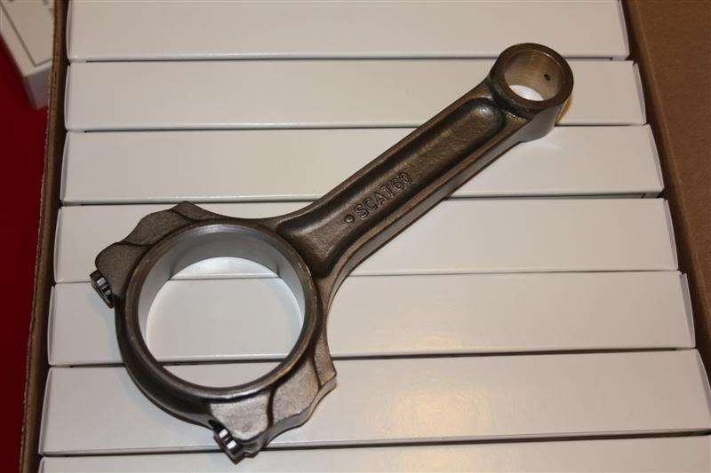

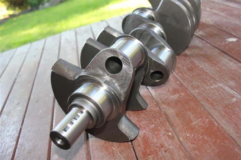

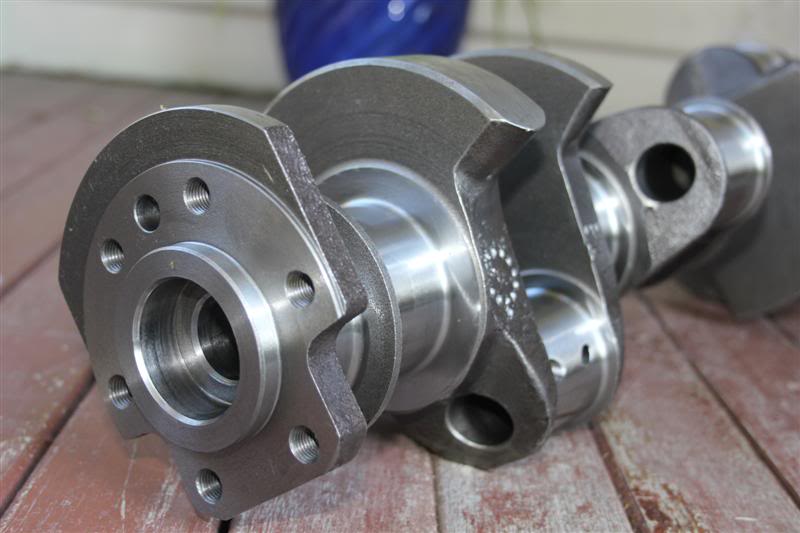

After a lot of research, and still very much on a tight budget, these are the parts I ended up selecting.. nothing fancy, but still very good quality gear..
Crankshaft:
Cast-iron SCAT 9000 'Pro-Comp' series, internally balanced.

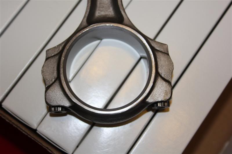

Rods:
Forged SCAT 4340 'Pro-Comp' series 6" I-beams with ARP 7/16" cap screws.
These are specifically profiled for stroker clearance (check out the shape - they look awesome!)
I know Dennis doesn't like I-beams, but these babies will do the job nicely Posted Image
Absolutely superior to any old factory I-beam.

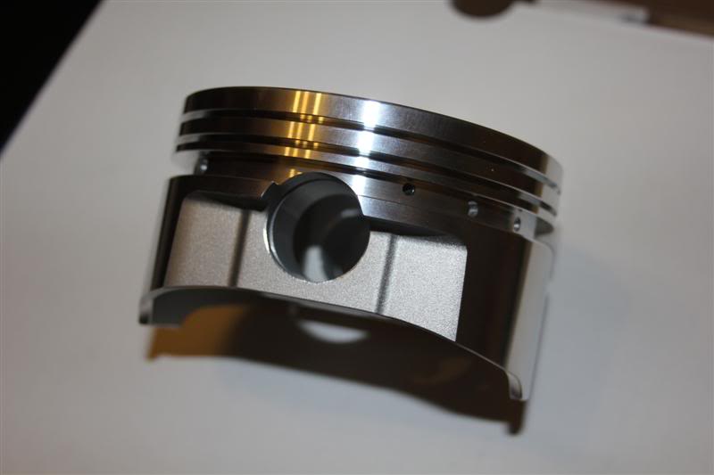

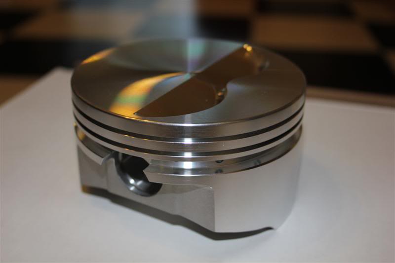

Pistons:
The only expensive item I've bought so far... SRP 0.020" forged stroker flat tops. Sexy looking pistons!
They're forged from 4032 low expansion high silicon aluminium alloy so will be a nice street friendly piston.
We also found some very nice benefits of the later model block I'm using too... the crank dropped straight in, no clearancing required (as expected), but it's when the rods were dummied up that we found the block only needs an absolute tickle (old blocks require huge amounts of grinding). So it's all working out nicely so far.

Can someone tell me the difference between an I-beam and an H beam? Excuse my ignorance but I'm just curious to know.
And those conrods - in the photos they look like they're all one piece. How do they fit around the crank journal?

I Beams aren't as strong as H Beams, but I Beams are lighter and easier to balance... I Beams are normally fine for anything up to 5-600hp (Although I know a lot of pro stock cars running 7-800hp still running I Beams)
If you are chasing extreme HP, H Beams are hands down stronger than I Beams..
I beams are perfect for tough streeters!
The I and H refers to the shape of the piston when you are looking at it flat.

Matt is on the money... if you lay the conrods on their sides, they will represent the letters H or I...
The conrods are indeed 2-piece (the big-ends separate). It just doesn't look it in the photo, cos it's all so nice and smooth and shiney and HOT!!

As for the big ends of the conrods being all one piece, well I guess they wouldn't make much more than an ornament if they were. But yeah they must be damn smooth cos that photo/my eyes had me fooled.
