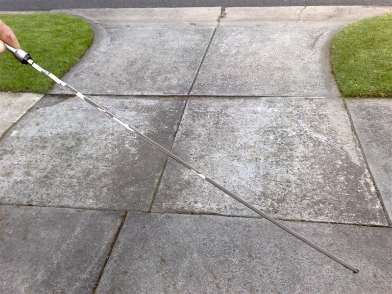

Posted 02 May 2010 - 09:28 AM

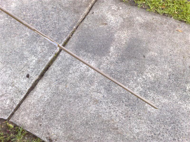

Here's what the dipstick looks like...
Just slightly above the 'Add' mark, and just slightly the 'wrong' colour ;)

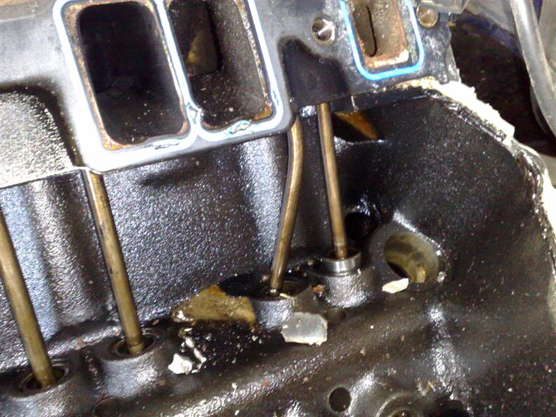

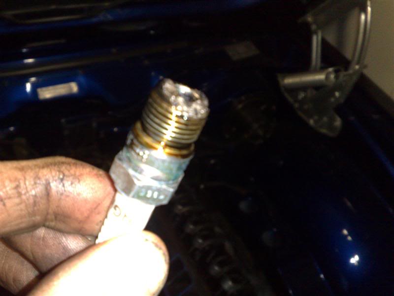

#184 LXCHEV

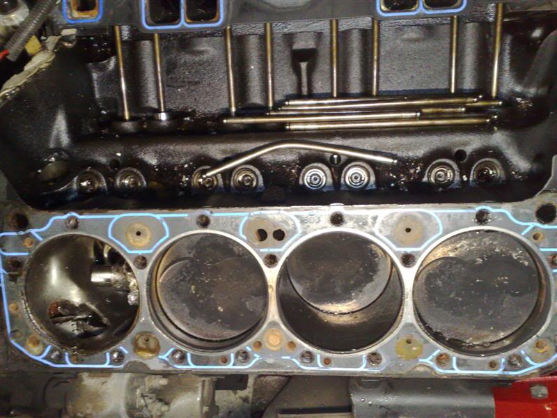

Posted 02 August 2010 - 11:43 AM
Latest update:
This shows the colour of what I drained out of the sump:

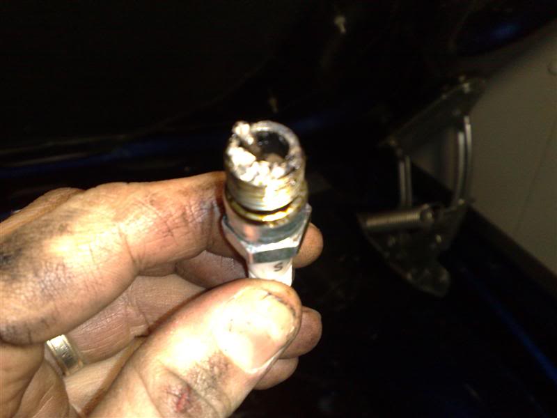

And here's one of my spark plugs (rear-most cylinder on the driver's side):

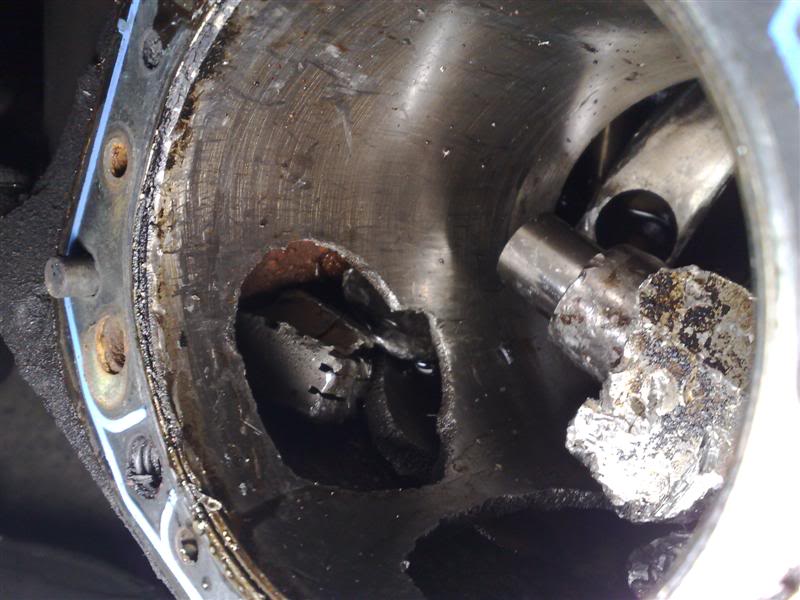

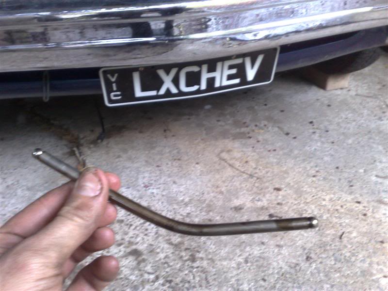

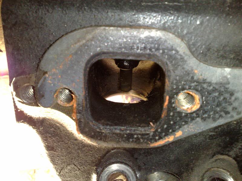

Intake manifold off... notice anything wrong here?
What is this stuff doing in my valley??
Naughty pushrod!
Hi, my name is LXCHEV, I like eating pushrods and metal :)

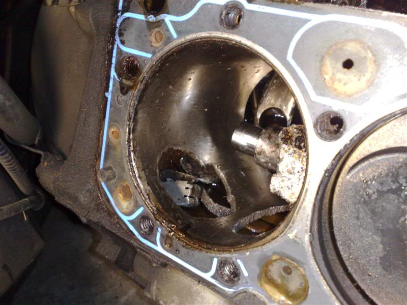

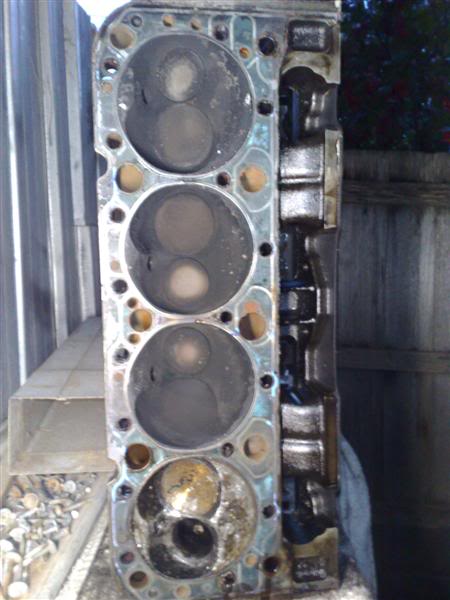

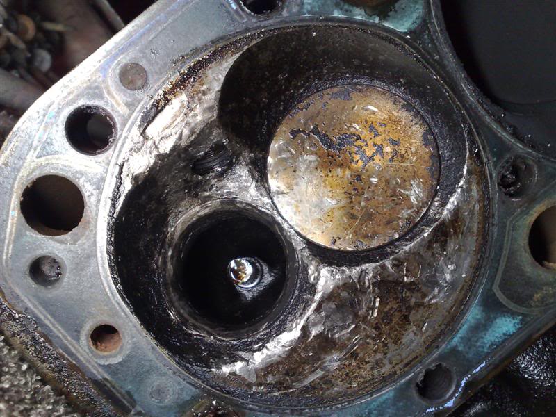

Next up, I ripped off the driver's side head:
Someone has STOLEN MY VALVE DAMMIT!!!! Give it back, give it back NOW!!!
So is anyone interested in seeing the photos of the block???

#187 Heath
Posted 02 August 2010 - 03:22 PM
Woah! I love the "someone stole my valve" lol. Nice finish on the combustion chamber :)

Bugger ! Bit of a mess. Lets see the pics of the block..

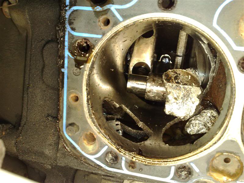

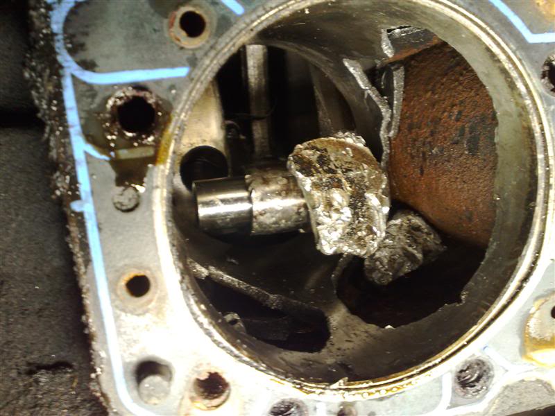

#189 LXCHEV
Posted 02 August 2010 - 05:16 PM

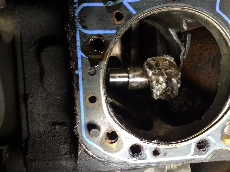

I can't believe it - someone has STOLEN MY PISTON TOO!!!!!
Meet my new coffee table:
It amazes me that all this can happen in the space of a few seconds......

#193 Tiny
Posted 02 August 2010 - 07:00 PM
Shit mate...
You dont do things by halves do you!!!
By the looks of it the valve did the damage and the pist-off said "ENOUGH!!" after about 300 Revs (LOL!)
That's sad mate.... but if there was ever a time for a new combo :P

#196 Tiny
Posted 02 August 2010 - 07:29 PM
I reckon the valve went because you can see all the curved marks that the edge of the valve left in the chamber area, I think it just basically mashed up the piston and obviously the gudgeon smashed the bore!

#197 _red roar_
_red roar_
Posted 02 August 2010 - 07:33 PM
Haha yeah, do you think I can get away with a quick hone job??
I would love to know what actually broke first... I guess there's lots of possible scenarios.
Cheers guys.
it wouldve dropped the head off the valve i reckon, unless it never had enough piston to valve clearance.
Mate, there's a chance you can repair your block/coffee table with a sleeve. Plenty of serious motors gettin around with sleeves. Same goes for your head, with a repair it will be as good as new.
#198 _SS Hatchback_
_SS Hatchback_
Posted 02 August 2010 - 07:49 PM
A few pieces to put on display there Brett. Im not too sure on salvaging it cause im no expert but as mentioned above i have been running around with one sleeve in mine as i wanted to keep the HT block and ive given this thing heaps for around 20 odd thousand k's and its still ok. But we only found a crack in mine where you have a little more missing ;)
#199 Struggler
Struggler
  • 2,426 posts
  • Name:Andrew or AJ
  • Location:Canberra A.C.T.
  • Car:UC Sedan
Posted 02 August 2010 - 07:55 PM
Nice, I feel your pain Brett !!
I would say for some reason (sticky guide, valve bounce) the valve has been in the wrong place at the wrong time, the piston has hit the valve and broken the head off it and then it has all come undone.
That block is stuffed. There is not enough bore wall left to support a sleeve. Get another block. 4 bolt SBC's are still around, someone GAVE me a 060 over 010 4Blt block the other day that honed up perfectly !
If piston bits got under the intake then they will be in every cylinder so check all the conrods for straightness. Chuck the pistons out. Get the crank checked to make sure its not bent. Heads should be repairable.
Good luck and keep us posted !!
