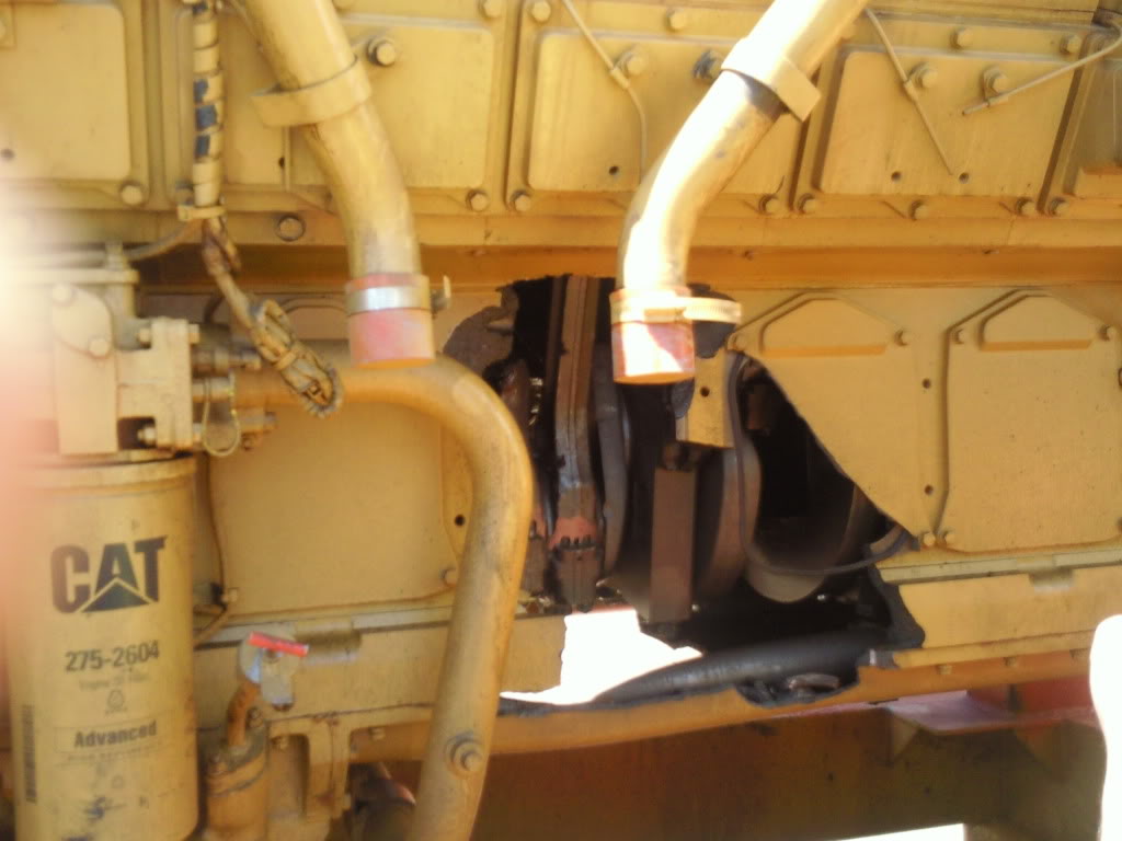

Ive seen a few 3516 cat engines do the same and most of the time its been apprentices doing valve sets wrong causing the valve bridge to come free and jam the valve open then it snaps and the piston starts to break up then it smashes through the liner in the end it throws a rod or 2 and you get this
sorry to go off topic a bit but thought id share some carnage pics.

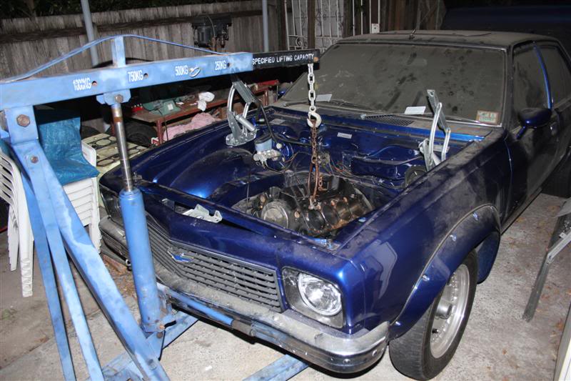

Posted 22 July 2011 - 10:16 AM
Wow.. long time with no updates on my old pile of junk I still like to call a Torana!
Quite a few things have happened in the last year or so:
* Sold my LX hatchback :(
* Got retrenched from work :(
* Finally had a closer look at LXCHEV's bottom end - discovered everything is still mint, so I never had any bearing problems. The blow-up was 100% related to valve hitting piston. Nice to know :)
* All of a sudden, Brock is already 18 months old. He's been upgraded from baby status, to little monster toddler status. What happened?!!!

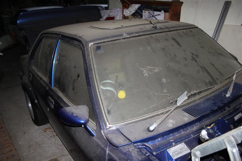

Anyway, these next photos may disturb and upset Torana fans.... please don't ban me from these forums for car abuse.....
She might be in a very sad state right now, but the local neighbourhood cats have taken a liking to it...
