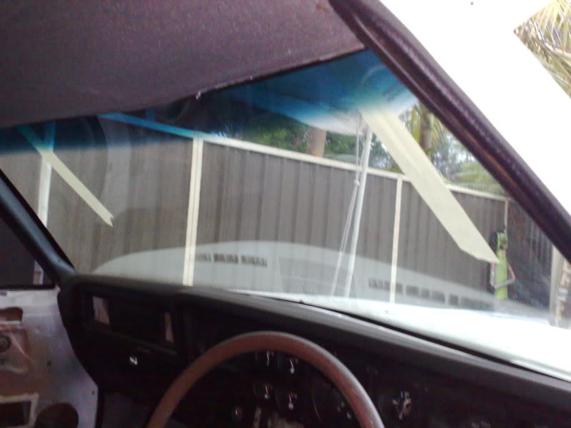

New screen!
Looks great!
I didnt realise I needed to have the trim clip things though, so Marshy (windscreen bloke) said I can put them on later (very carefully)
So bying them tomorrow night and then I'll polish up and fit all the trim.

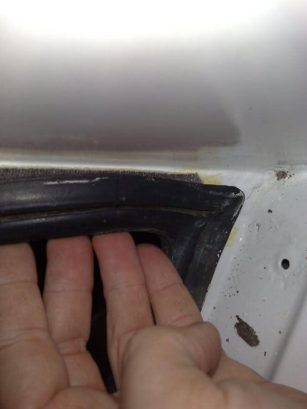

Rear screen couldnt go in though as the rubber didnt cover the "overhang" from the hoodlining (see photo)
So I need to trim it back to about 5mm and we will try again (marshy is coming back out next wednesday to do it)

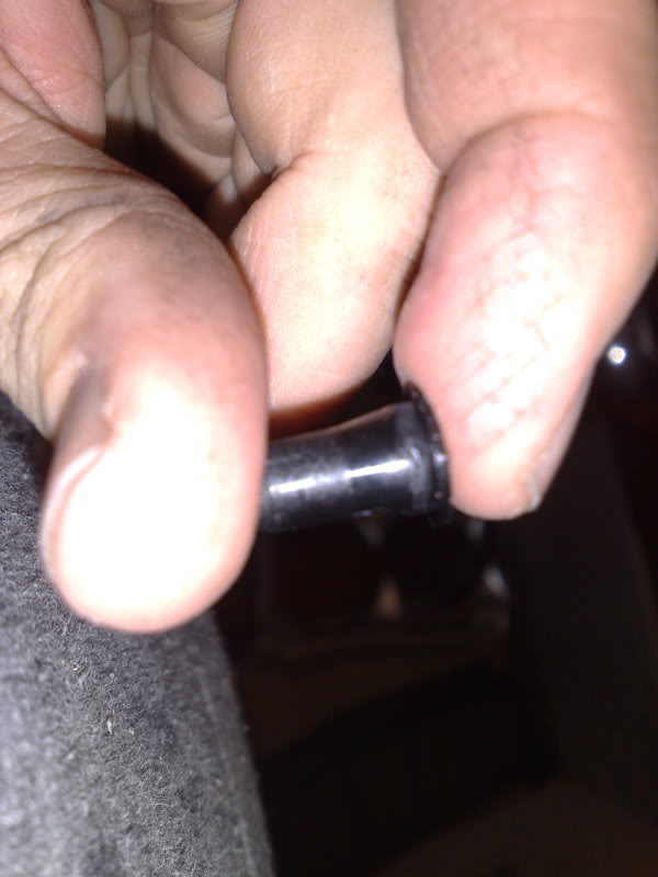

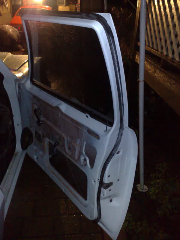

I also bought some "door rubber fitting kits" about a month ago and thought Id stand out in the rain and fit them last night.
This was the finished product-
Now for my whinge-
What the frOck is with Rare spares! HONESTLY!
Common sense tells you that a "door rubber fitting kit" would have enough little clips for A WHOLE DOOR RUBBER!
I bought two kits, and there was only enough clips for 1.5 door rubbers. Luckily enough I had some spares buried in the cupboard so I could still do both rubbers.

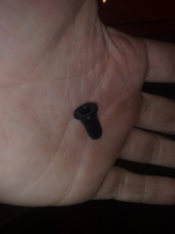

Then I tried to fit these frOcking things-
WHAT A frOckING JOKE!
they dont have any "locking" device or lip on them that keeps them in, I jammed a few into their holes with a screw driver and a twisting action, but some just fall out on their own straight away (and that was pressing so hard the door was going to bend)
Has anyone else had to fit these things? Im planning to just superglue to frOckers in now as I cant see any other way to make them stay put.

Usually they are tight, they will probably expand a bit with the clip doodad in them (they don't go in all the holes, hopefully a previous owner hasn't drilled out the holes or anything stupid)
#281 orangeLJ
Posted 27 May 2010 - 12:56 PM
I tried sticking the clip in one and seeing if that made it snug, but it didnt work.
Its only like 5 holes between the two doors, not in the same spots or anything either, so probably havent been drilled out.
They just dont want to stay put!
I think it would be a great idea to have a slight thread on them so they just screw in, rather then pushing in, would solve the whole problem and make them easier to install/remove

Yeah mate those rare spares door rubbers shitted me off too. They make them with plastic clips in them instead of the traditional wire ones and they don't stay put inside those little plastic things you've got in your hand in the pic. I've ended up just gluing all the bastards in and in some spots gluing the actual rubber to the inside of the door.
Next car I do up I'm gonna come up with a better way of fitting stuff like that.

The plastic clips for the rubbers dont worry me, Ive got em on my LJ and never had a drama.
They seem to fit the little black "cups" pretty snug too. The "cups" just wont stay in the fukcing door!

I meant someone may have drilled the original ones out like you do with rivets because they were too tight to pull out. If you're really dexterous and inventive you may be able to get something to screw onto them inside the door?
#290 orangeLJ
Posted 27 May 2010 - 03:26 PM
didnt think about trying to fit a nut to them inside the door cavity... hmmmm.
I think a drop of superglue would probably be easier though. They wont be coming out until next time I want to paint it (probably 3 or 4 years) so it should be fine (I hope)

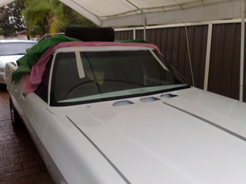

Rear screen is in :)
Going to go home today and get most of the front bolted in tightly, then might take it for a quick lap after tea tonight :)
Maybe even a video of the theoretical run in the morning! Will just need to tape the bonnet down as there isnt a latch!

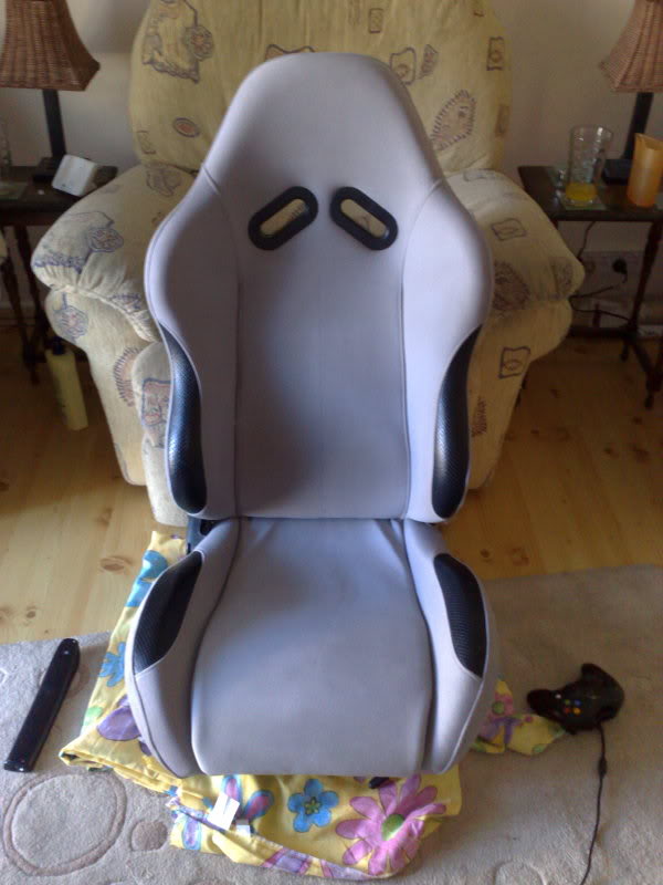

Also, bought some seats for the ute as a surprise for Karlie a few weeks ago off a forum member.
(I cant find the photo of both, but Ive been using that one to play forza in! haha)
We will get it regoed with the bench seat, and eventually swap in the buckets when I get around to it!

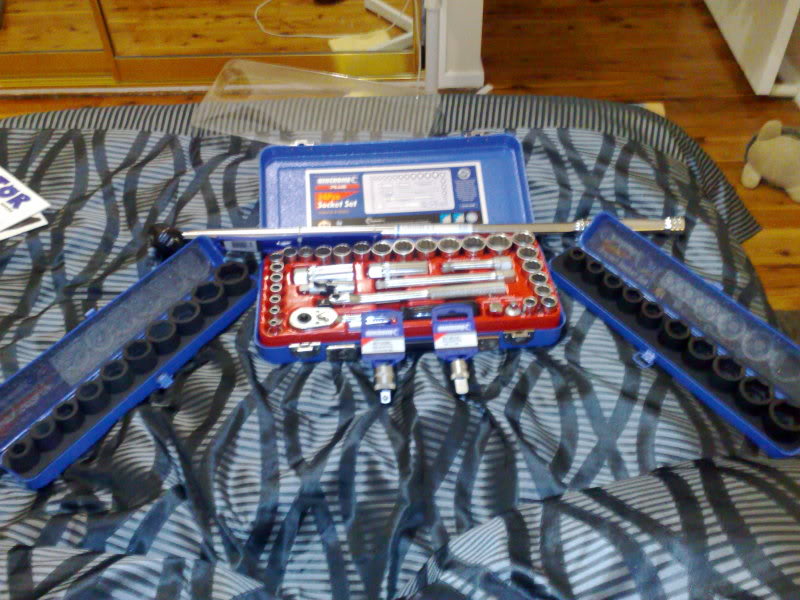

got some things that make life easier for my birthday
:D
plus a new jack (old one shat its guts all over the drive, was only a couple years old too!)
new cordless drill, another set of jackstands, pick and scraper set etc.
so should be alot easier to work around the joint, Ive always had tonnes of tools, just shitty quality and seem to go walkabout all the time.
Im planning to set up my bench properly with these so nothing goes missing and everything has a place.
