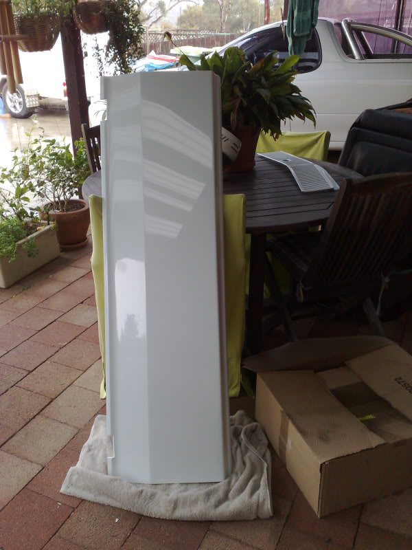

shiny painted tailgate and cowl

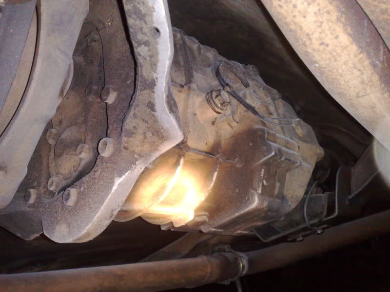

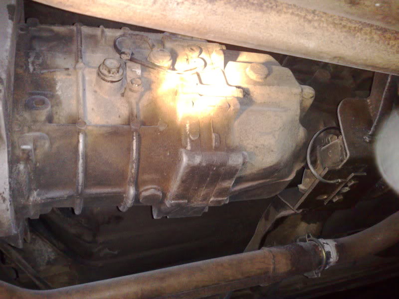

Gearbox- was told it was a supra box, anyone care to have a jab at what it is? It looks fairly different to my celica box in the LJ

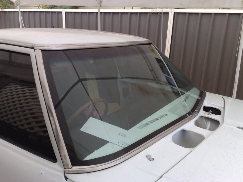

Windscreen chrome

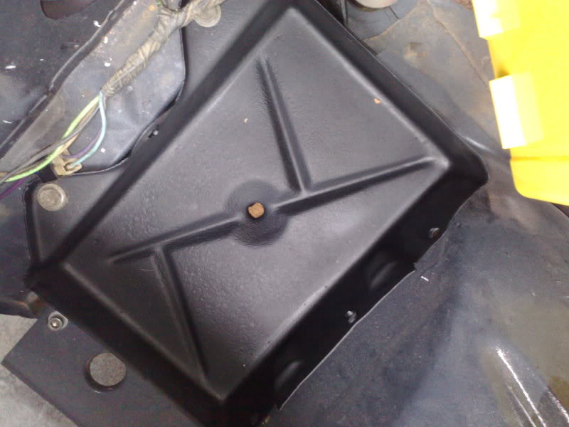

battery tray

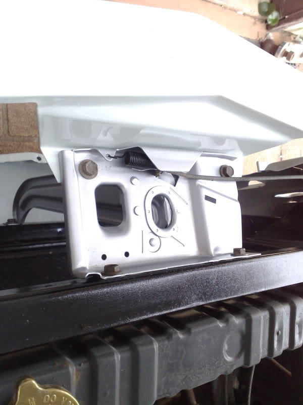

fresh bonnet catch support

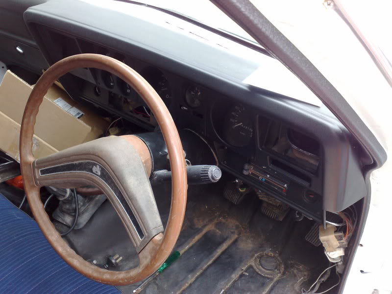

column back together-

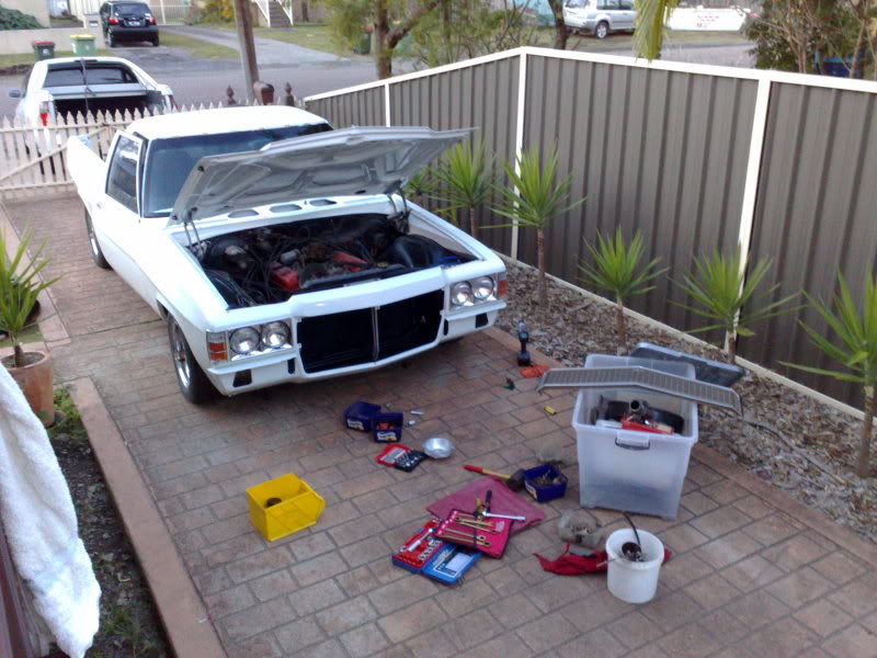

working space?-

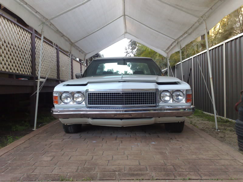

The front is now 100% and the rear is just missing the bumper.
Yep, W55/56/57/58/59 - I'm guessing you have the steel case type box in the LJ

Yeah im running a steel case celica 5 speed in the LJ, are there any noticeable differences between the differnt supra boxes?
I know there is a thread somewhere, but the whacked out search function makes it fun trying to find them.
Cheers for the help mate.
#315 76lxhatch
Posted 30 July 2010 - 10:43 AM
W55-59 are the same box with different ratios if that's what you mean
#316 orangeLJ
Posted 30 July 2010 - 10:54 AM
wasnt one of them the turbo version that is the overly expensive version?
#317 _LXATIV_
_LXATIV_
Posted 30 July 2010 - 01:20 PM
The turbo version is the R154, and unfortunately your box isn't one. The turbo box has the drain plug on the drivers side and different ribs from memory to whats on yours. Still, the w series is goof for round 300-350hp

If it had been anything special it would have been out of the car and on ebay! haha.

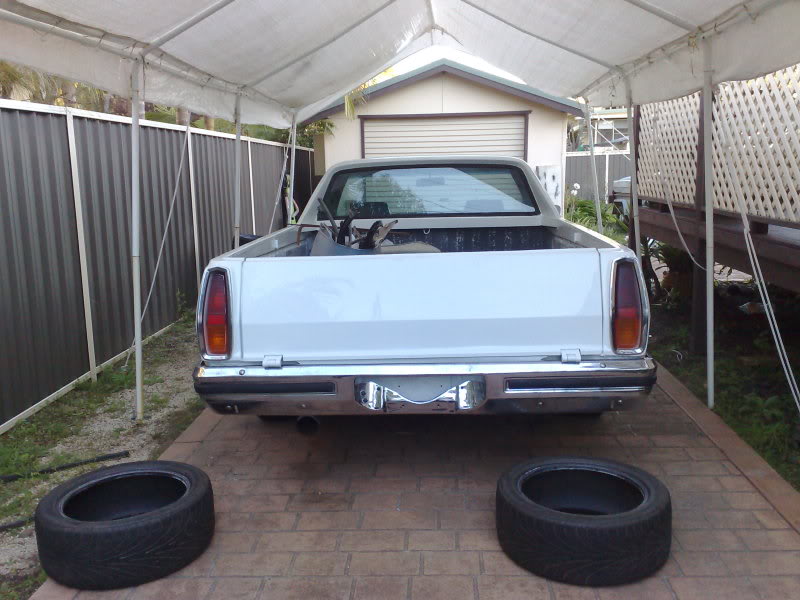

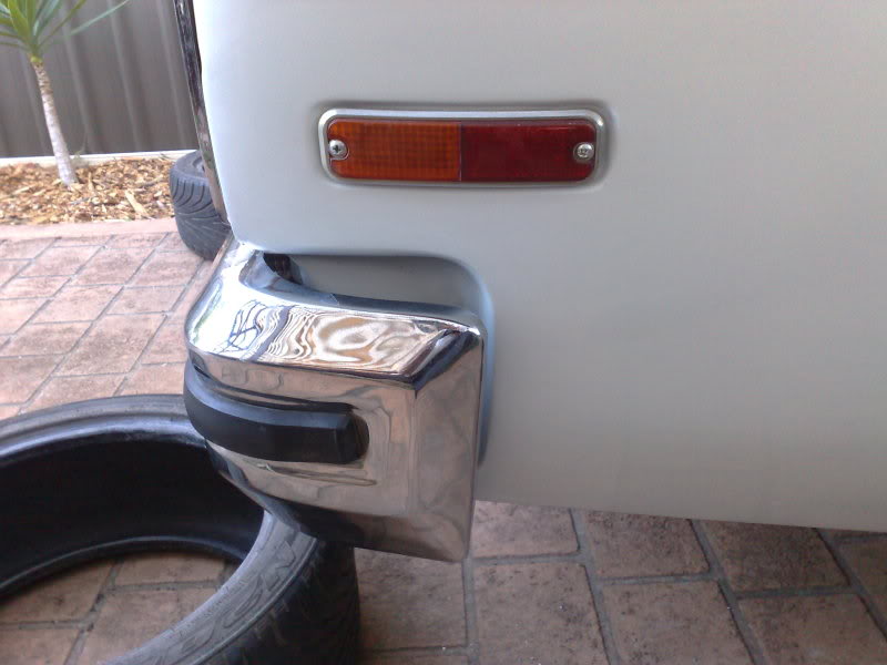

Rear bar is finally on! fitted as snug as I could.
Im going to make some corner brackets to fix this issue though-
looks fine, but im being picky thoug and it needs the bottom pulled up level.

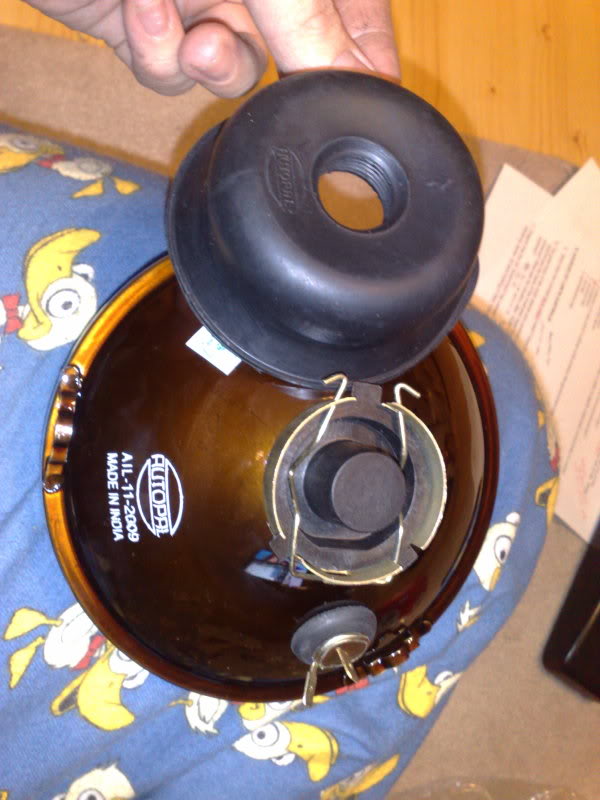

I gave the filter housing a good clean up and a paint, Im on the lookout for a cheap set of rocker covers (chrome ones) too.
also bought these at cessnock swap meet
(yes... they are my ducky pajama pants... :D )

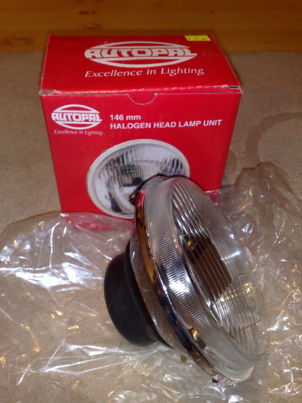

They are low beam halogen headlights :) so I can fit new bulbs to them, wire in a relay and have some nice bright headlights (instead of the old candle powered sealed beams)
they were only $15 each too.

Posted 17 August 2010 - 02:51 PM
Is this a HX HZ?
#325 orangeLJ
Posted 17 August 2010 - 02:55 PM
Nope, I have NFI what thats from? maybe earlier model? or later?
My HX one looks like a torry one (just a bit chunkier) it has the 3 small bolts to hold it to the firewall in a triangle sort of formation.
