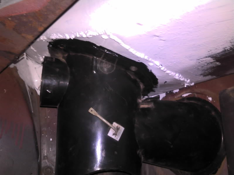

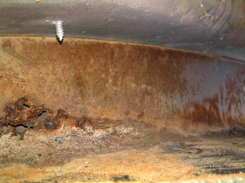

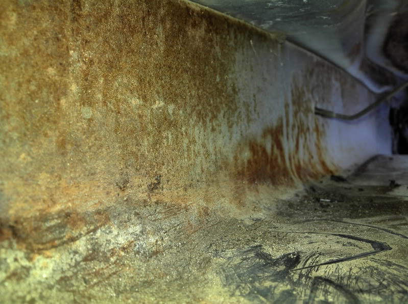

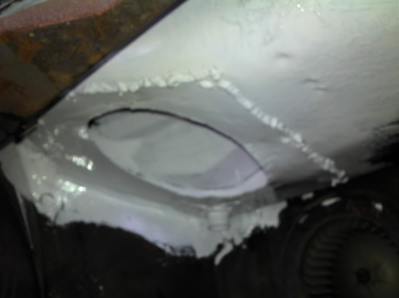

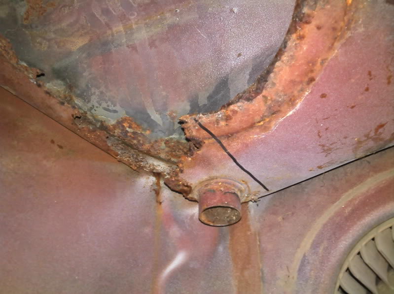

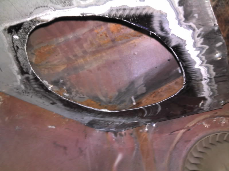

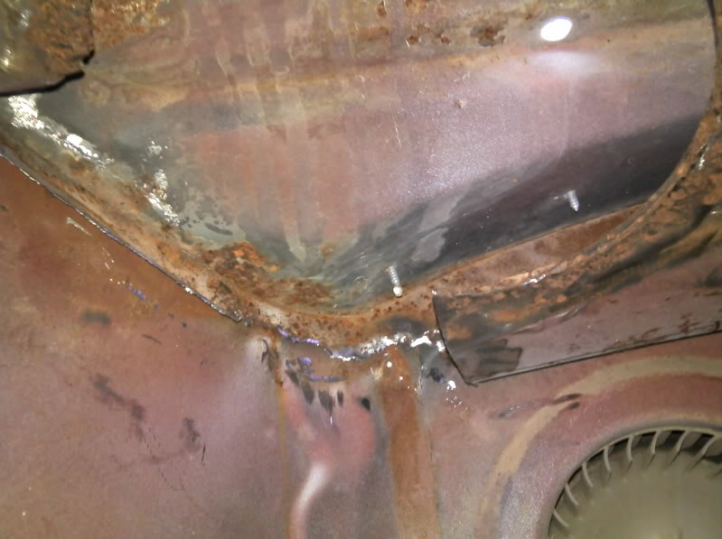

A few pictures, pictures in in the basic order they were taken :)

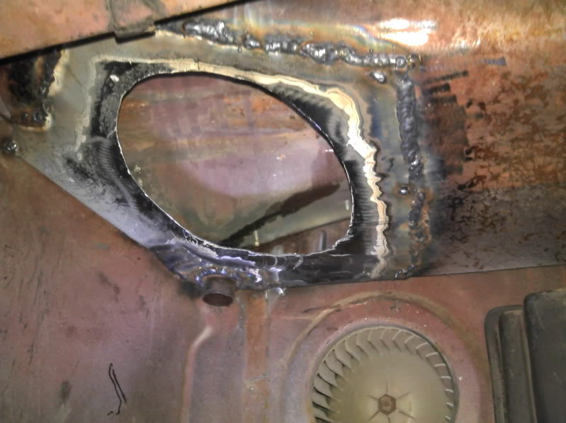

What I was greeted with when I pulled the vent out and stuck my head under-
Thankfully the inside of the plenum wasnt too bad, being an inland car has done it some good :)
Started cutting-
At this point I decided it was going to be easier to just cut the whole thing out and start from scratch, the round section where the vent bolted up was ok on the forward edge, but the rear was quite rusted and beyond any decent repair.
I didnt get any photos of the whole thing cut out, but you can see it vaguely in the next few pictures.
As an aside, this is the rust I still have to deal with in the next rebuild, its at the corner of the plenum infront of the passengers corner of the windscreen, I knew there was a repair there, it has SOME metal, but looks like a big bog wipe. seems solid for now, but will be fixed in 12 months when it gets a full off chassis rebuild (hopefully)

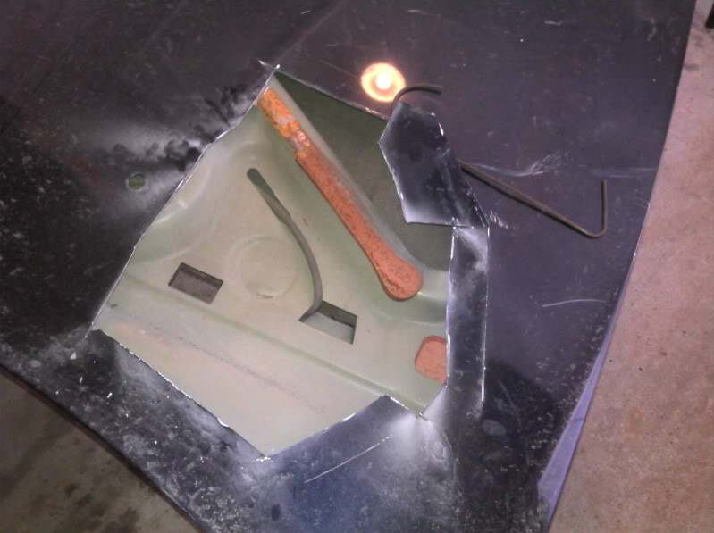

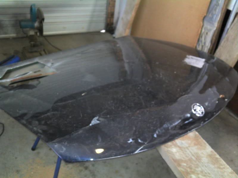

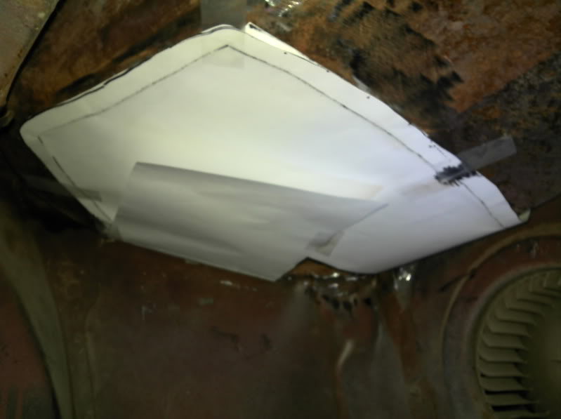

Once as much rust as possible was removed, I knocked up a template from paper, and transferred it onto some wax, single sheet cardboard as a final, shape holding template.
I then put an old VT bonnet to good use :)
cutting the large hole was the worst and most annoying part of the whole thing as I didnt have a complete section to copy from, so with a bit of farting about and luck I managed to get it spot on first go!
Posted Imagehttps://cache.gmh-torana.com/i71.photobucket.com/albums/i153/orangeLJ/2011-06-12_14-15-00_644.jpg[/IMG]
I made the repair in two sections as I couldnt see a way to bend the corner section in one piece (especially with my limited skill and knowledge when it comes to panel forming)

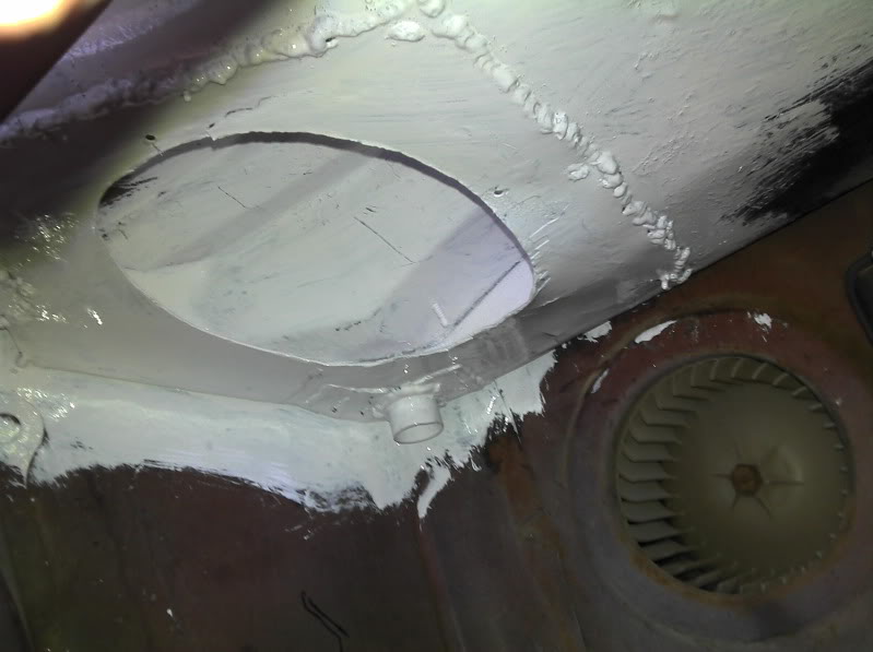

so here it is all welded in and ready for some rust converter and paint!

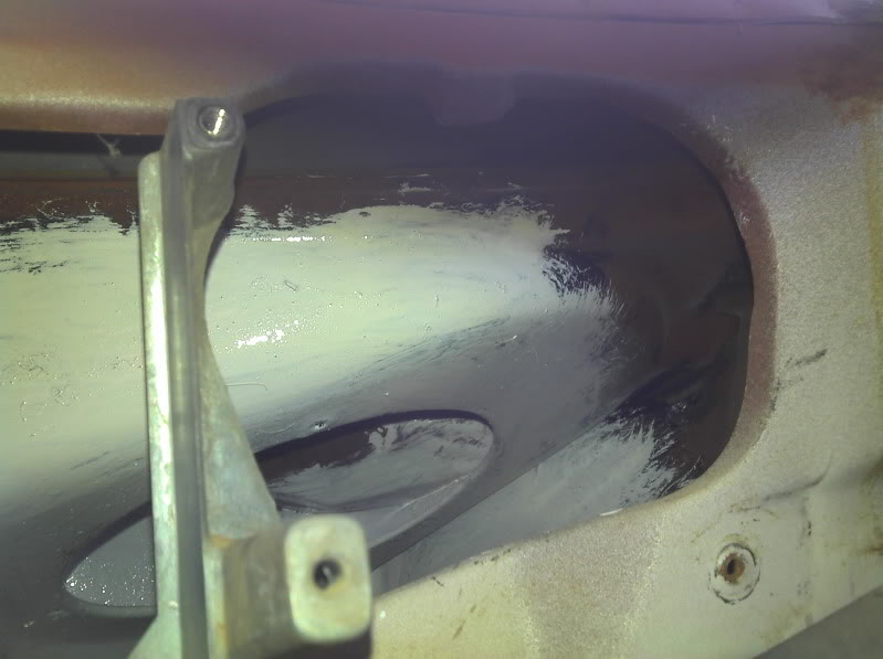

I also gave the drivers side a good hit of rust converter for the minor surface rust and some white rust kill enamel
and all fitted up
I know its not 100%, but doing it all upside down, with limited tools and bugger all skill in terms of making panels, I think it turned out ok! Its also leak free!

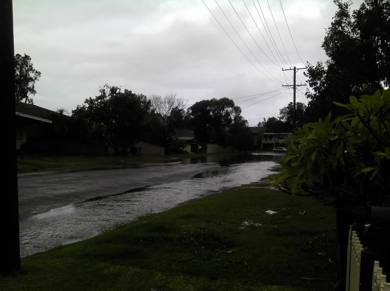

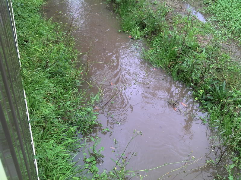

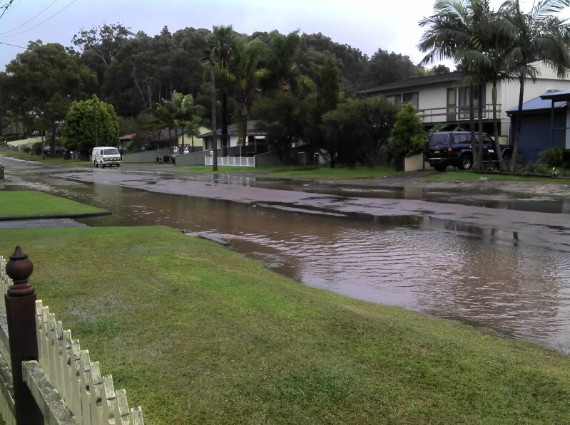

on the water note,
this was our street during the recent rain/flooding we had
and over the back fence (usually about 3ft-4ft deep drain)
At the peak this water was under the fence and only 4ft ffrom the back of the shed which was a bit hairy!

How many burns across your chest did ya get doing those repairs....? Nice work, better than "no more gaps"

Good repair Chris and I didn't realise you bought a waterfront property. :sofa:
#357 orangeLJ
Posted 24 June 2011 - 02:00 PM
Im thinking if we ever sell, I should put "part time full waterfrontage, just depends on weather"
The lake is still up 50cm, but nothing on what it got to at the peak, house is raised up about 1.2m, but the sheds only up about 8 inches via a thick slab

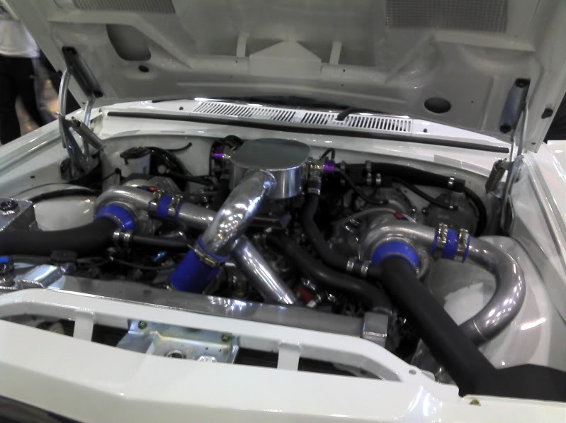

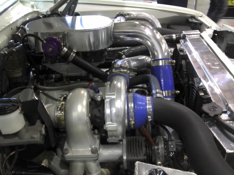

alright so saw this at motor ex and got me cranky! lol, someone beat me!
but rest assured, my setup will be lots more affordable and improvised! haha.

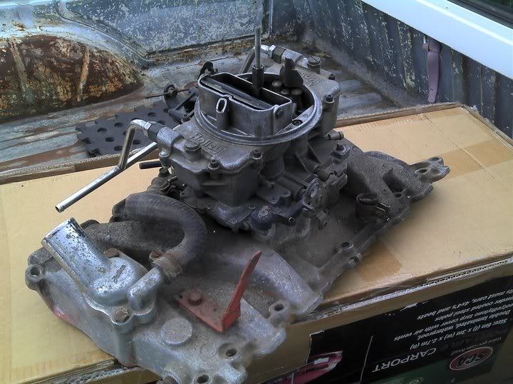

bought these at a swap meet
650 holley for $75 off a running driving car, was on a 351 clevo tunnel ram twin carby setup.
spreadbore manifold with holley adaptor plate $30

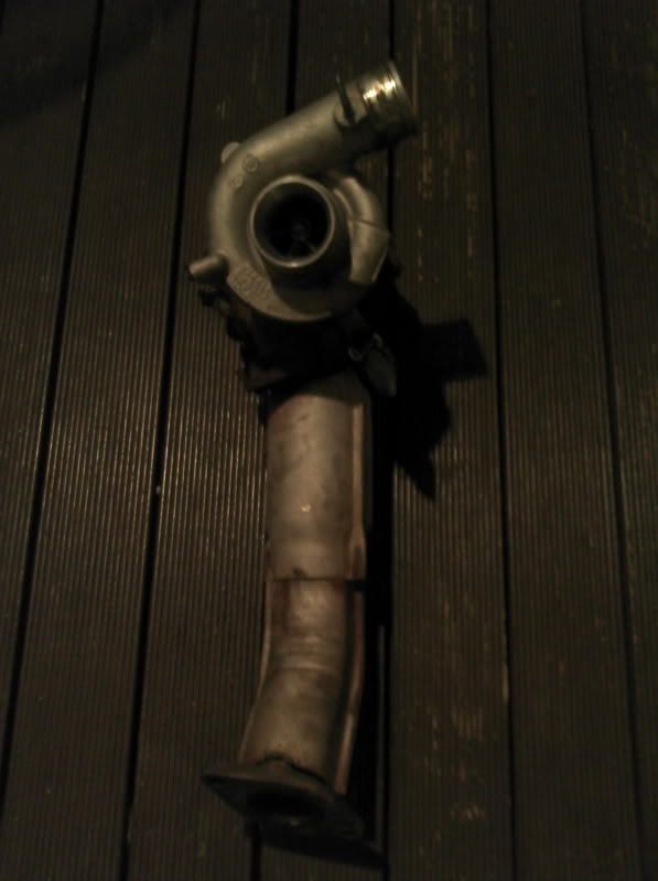

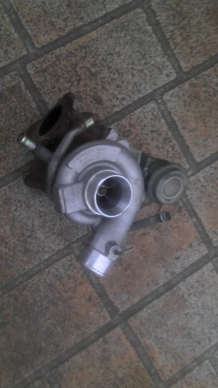

Picked this up on ebay-
td04l, no shaft play, $120+30 post to my door
on the hunt for a second one now.
Im going to need to get some flanges to suit, but so far so good!

Bought a second turbo today!
Full steam ahead!
#363 orangeLJ
Posted 14 October 2011 - 04:07 PM
Second turbo
$100 jobbie, has a wee bit of shaft play, but housing isnt marked and its nothing major.
Just need to get the torana back together and then I might start playing with this setup properly.
Bought some other random bits for it, definitely going to be fun!
