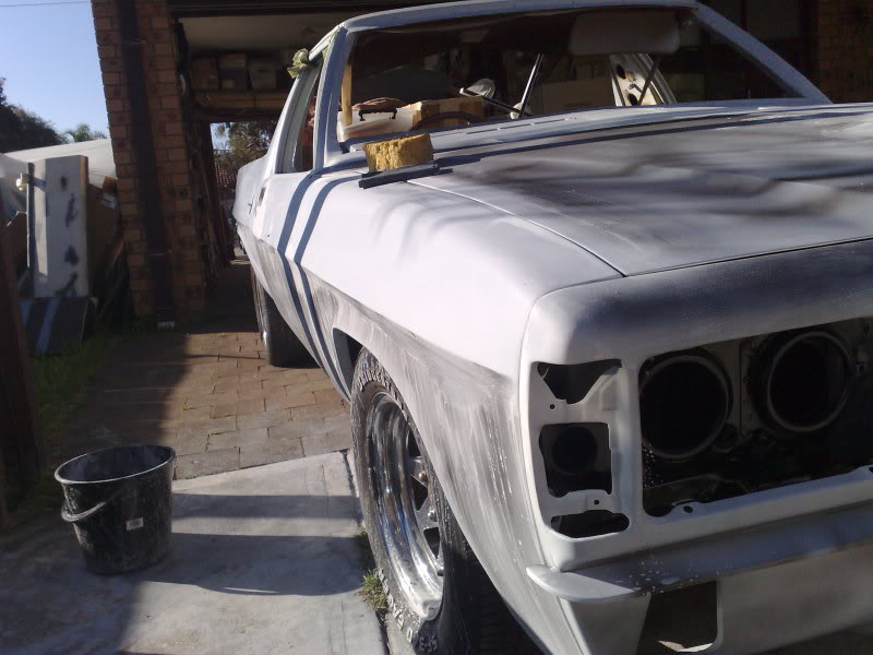

Hanging some panels on the car tonight. doing some fine bogwork for a few pin holes, going to give it a blocking this weekend, final rub next weekend (satdy) and painted satdy arvo.

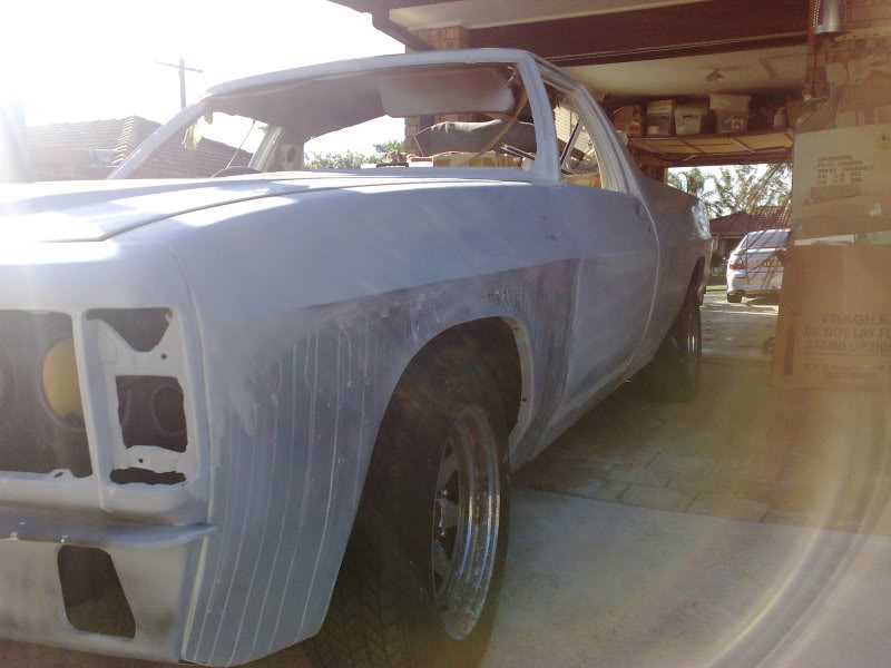

panels are on and aligned.
only one area where we have a problem, our reparied gaurds :(
They fit and bolt up, but it seems someone has repaired the body of the car at some stage aswell which combined with the slight difference in the rares panels, has left a bit of a gap.
Im going to work on it a bit and see what I can do to fix it a little, but doors line up, nose cone lines up etc.

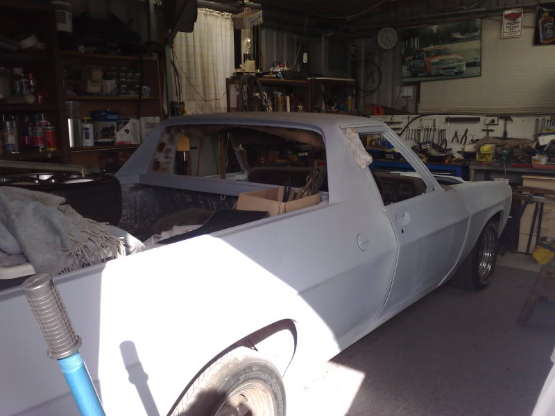

I forgot to grab photos of it out of the shed, but you get the idea-
definitely getting there!

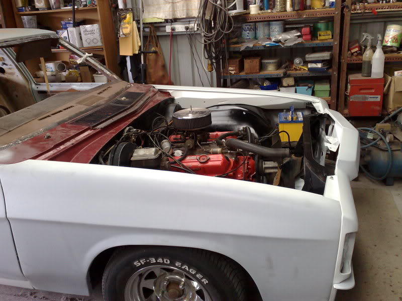

I stuffed up and forgot to paint the plenum before we fitted the panels, so just going to undo the firewall end und chock it out enough to blow some paint in there.

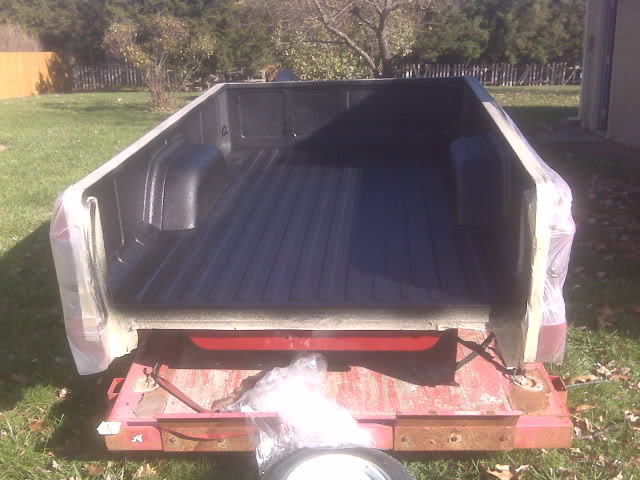

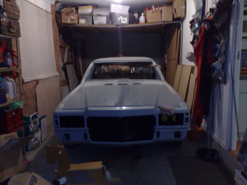

As for the rocking horse, Ive had it since I was about 2! its lived in the roof at my parents joint for the last 5 years, but they were getting insulation put in, so all the crap had to come out!

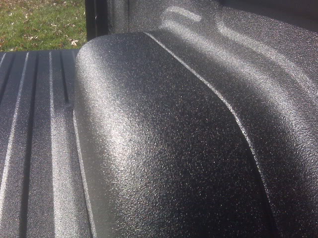

Im going to spray the ute back with this-
http://ppcco.com.au/kits7.htm
I can get it $130 US for a kit including a spray gun to use with it (plus postage)
comes out like this-

Those two-pot urethane liners look good and are reasonably durable but still a bit slippery (hard finish), depending on what you plan on carrying a big rubber mat may offer more traction.

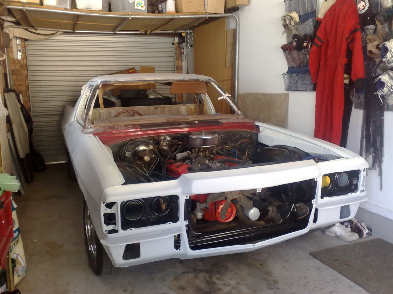

Well its painted.
Few dramas with the first coat going on, bloody tidal wave in the PS rear 1/4 panel, few little runs here and there (Ray mixed the paint up a bit wet)
4 coats all up, rest layed down fine.
Just going to but and buff the side panels to get rid of the runs and make it all uniform, then she whould be right.
also, few dings showed up that I hadnt noticed (that bit doesnt worry me that much, was never meant to be perfect)
But its white and its coming home tonight.
Will grab the photos off my phone and throw them up later.
