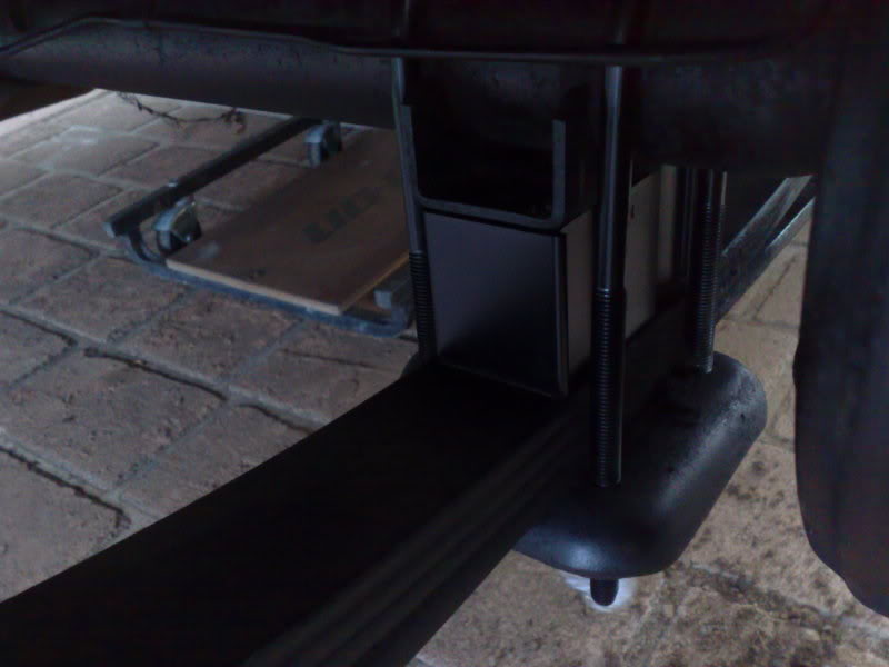

Yeah the locater lug is slightly too tall.
I noticed it once I had squared the whole thing up and let it down off the stands.
I wasnt sure if it was supposed to be larger so that the allow will "mushroom" out at the top and lock the block in place or it was just too tall and needed to be ground down.

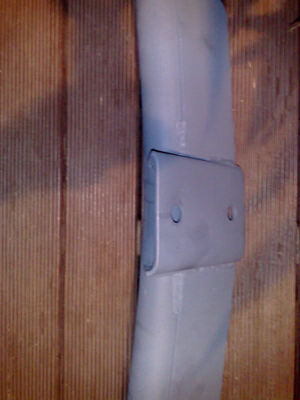

I still need to knock off the extra length from the U bolts too.

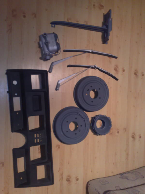

Had my mate Gary do some more blasting for me.
I was a slack bastard and left some of the last lot in bare metal in the shed, the humidity must have gotten to them because they surface rusted up pretty badly.
So I had him do some extra bits for me at the same time-

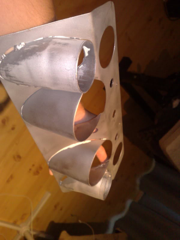

and this should go in my LJ thread, but this dash is actually still in the works! even after all the dramas.
I had gary blast all the bog out so I can cut and modify it to fit properly.
then its just some minor bog work again and it will be in the car.

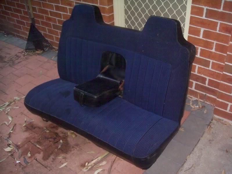

Picked up this bench seat from old holden for $20
should come up alright with a good clean.
Im not planning to leave it as is forever, but it will help cut costs to get this thing on the road.

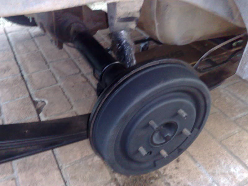

Will finish cleaning up and painting the diff today, its only cheapo black pressure pack but it will clean it up alright for a while.
Eventually I'll yank the diff and give it a proper clean up.
#205 orangeLJ
Posted 03 March 2010 - 07:54 AM

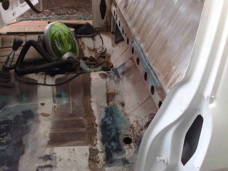

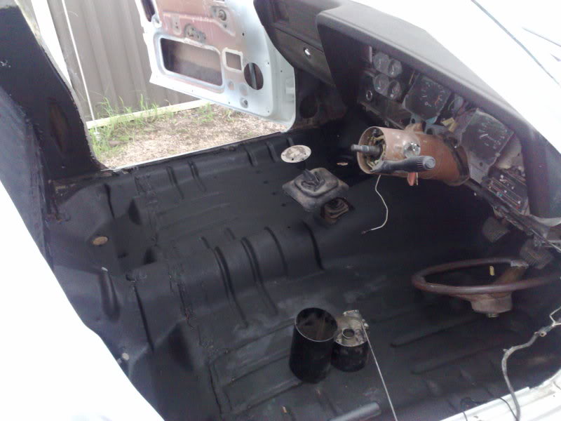

Alright, diff is fully painted now (was a few weeks ago)

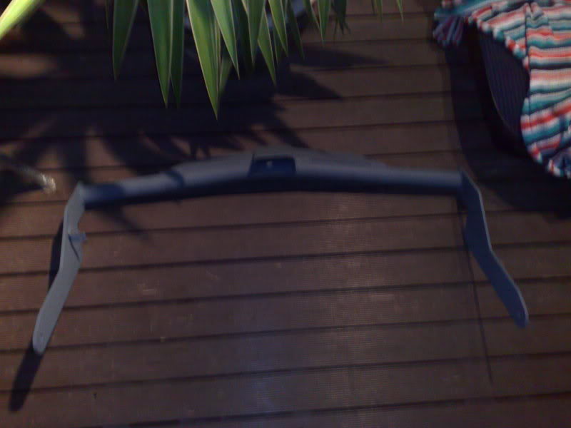

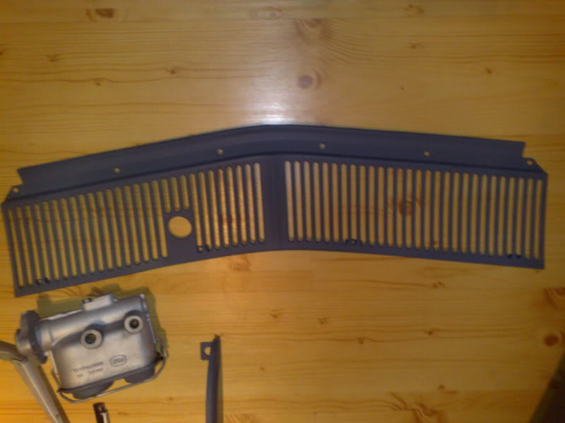

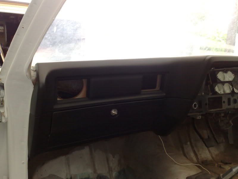

Started playing with the interior panels over the last week.
Cleaned, stripped and painted the glove box, lower dash section and the A pillar plastics.
Threw the glove box in-
While doing this I discovered a bit of a problem though, there is a small (50c piece) hole in the PS rear plenum chamber that has been leaking water into the PS footwell, I didnt notice it originally due to the duct.
I can get in there with the welder (just) so it shouldnt be a massive drama, just a pain in the arse.
CD player is going in the glovebox, which means I need to repair the GTS facia (hacked out for a stereo) The dash in the car (metalwork) hasnt been touched, so Id rather fix the facia and leave the metal orignial.

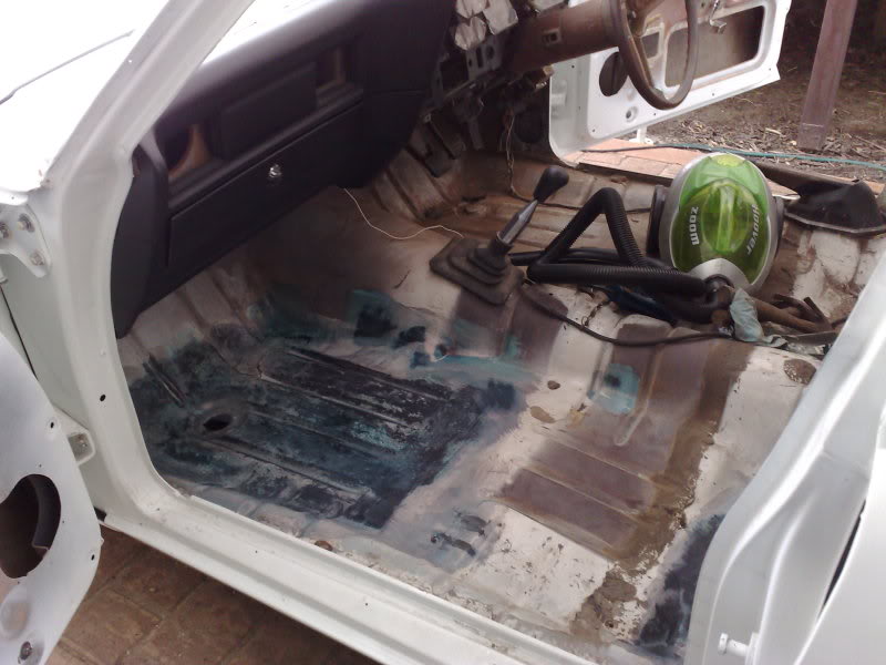

Apart from that I stripped half of the floor with a wire brush and went to town with "K&H rust convertor+primer" good shit!
I didnt get time to wait for that to dry, so I painted the clean half of the floor (the side with no rust) with this-
and painted some of the rear wall-
going to paint the rest this afternoon. Should look a shitload better.

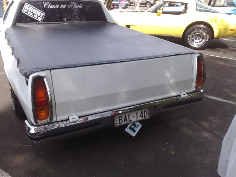

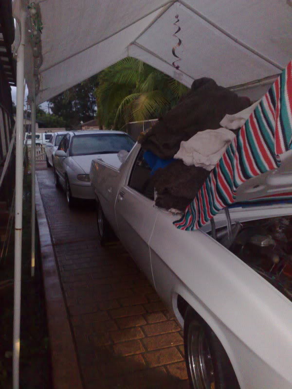

Also decided a wagon/sedan rear bar is going to look better after seeing this ute at a local show and shine-
Was dropped on its guts, 2.5" lowering blocks and only 2 leaves left in the spring pack!
looked nice though!

thats an interesting custom tonneau cover on that ute in the pic you took.
#207 orangeLJ
Posted 03 March 2010 - 12:02 PM
Yeah it also gave me some ideas on how to make one work with the HX.
Im planning to just run some push stud bases around the whole top and have a "clip" down toneau cover made. (similar to the front and rear of the one in the pic)

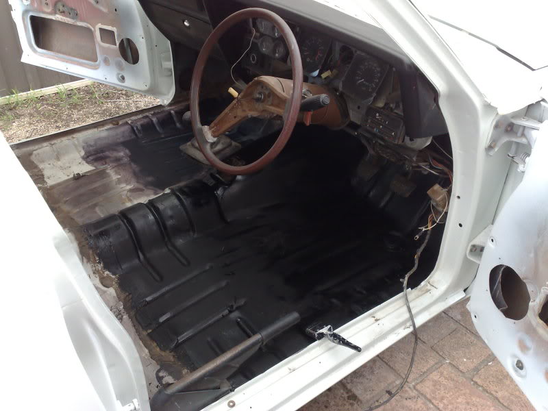

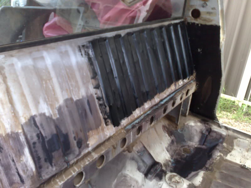

Finished the floor yesterday arvo-
Will give it another quick coat sometime over the weekend just to give it a final seal.

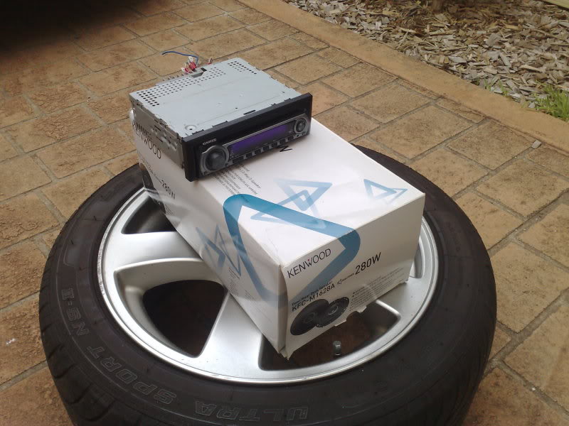

Started playing with the wiring so I can throw the headunit in.

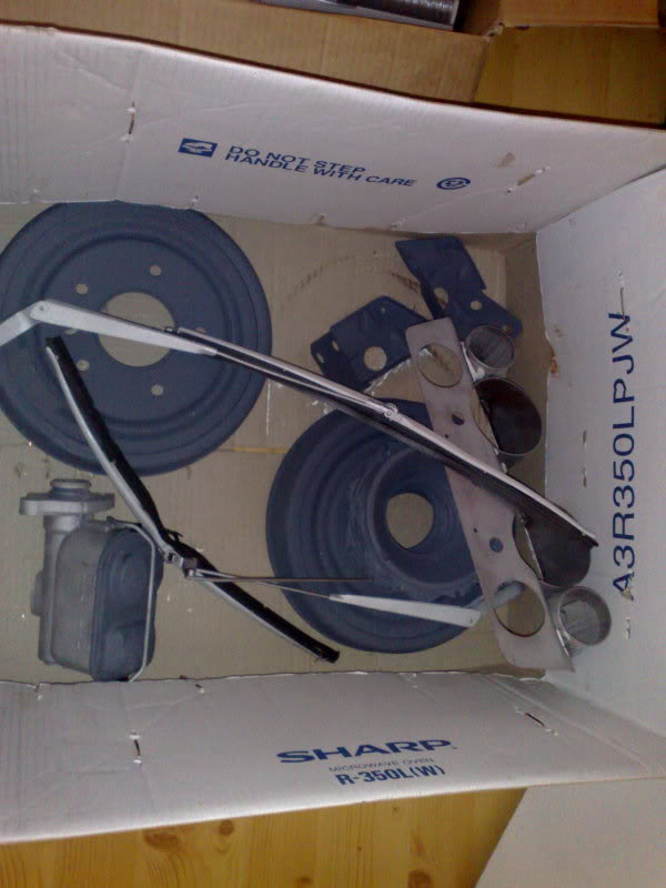

Spare headunit and speakers that im throwing in.
There are holes cut in the doors for 6" speakers, so I just need to sort some rubber tube to run the wires through (from the door to the body) and it should be sweet.
Thinking maybe some 4" speakers in the B pillars too, might be annoying right next to your head though.

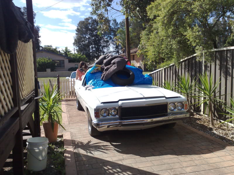

Bought the ute a present at Morriset swap meet on the weekend, forgot to grab a piture,
but managed to pick up a large K&N air cleaner (15inch diameter, 4 inches tall) with polished alloy top hat and chrome baseplate
(to suit holley, but can be made fit)
All for $20!
Its in pretty good knick too.
came across alot of people selling HX/HZ prem fronts for 300+
Ive got one at home that im only asking like $150 for! makes it seem like a bargain!
Also had gary blast and prime the towbar for me last night (top bloke once again)
no more rust :)
Will clean it up and paint it this week.

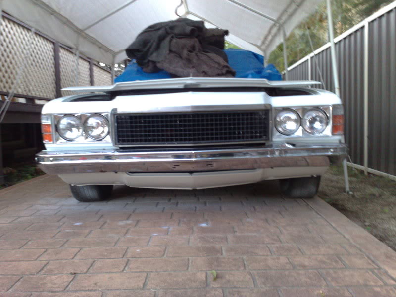

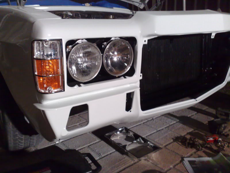

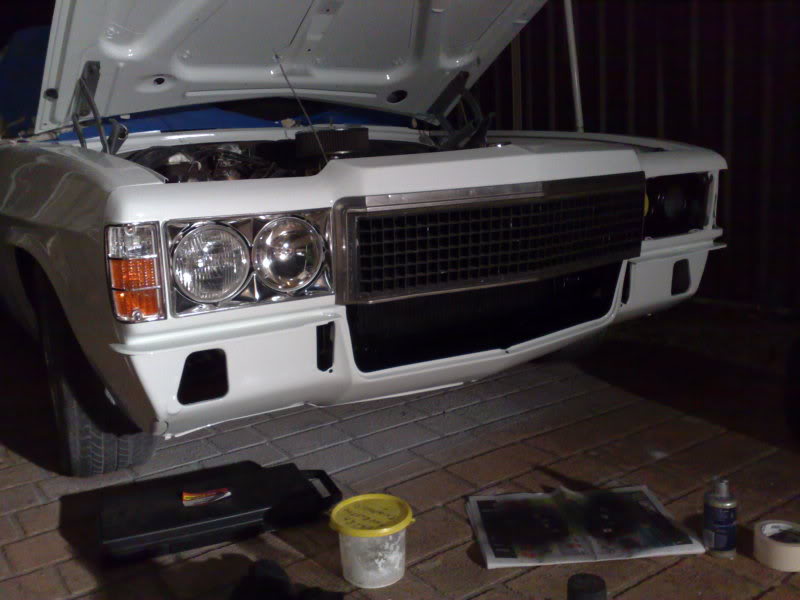

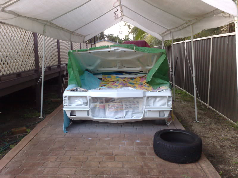

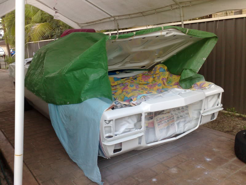

I needed to repaint the front apron as I found two problems with it.
the first was that I missed some spots when the car was painted, so the bottom of the apron was still in primer, and I didnt blow any up around the headlight frames/blinker frames etc.
then when I was cutting/buffing, I was cutting a run out and rubber through the white to the rpimer.
so I roughed it up and hit it again on the weekend, came out heaps better-
wee bit of overspray to deal with, but pressure pack will be fine to touch up the rad support, driveway swept clean! haha.

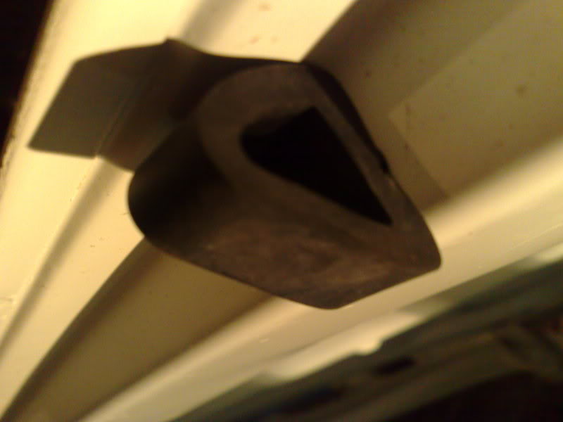

also threw on the bonnet rubber kit to stop it from touching down-
:D
going to give it a few days to harden up, then I will throw the front together, get the headlights and blinkers working etc.
Ive got two grilles now, so Im going to paint one silver and one black so I can change them out whenever Karlie feels like a change! haha.
Hoodlining should be in this week.

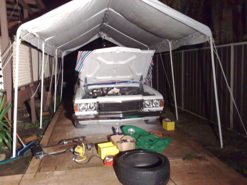

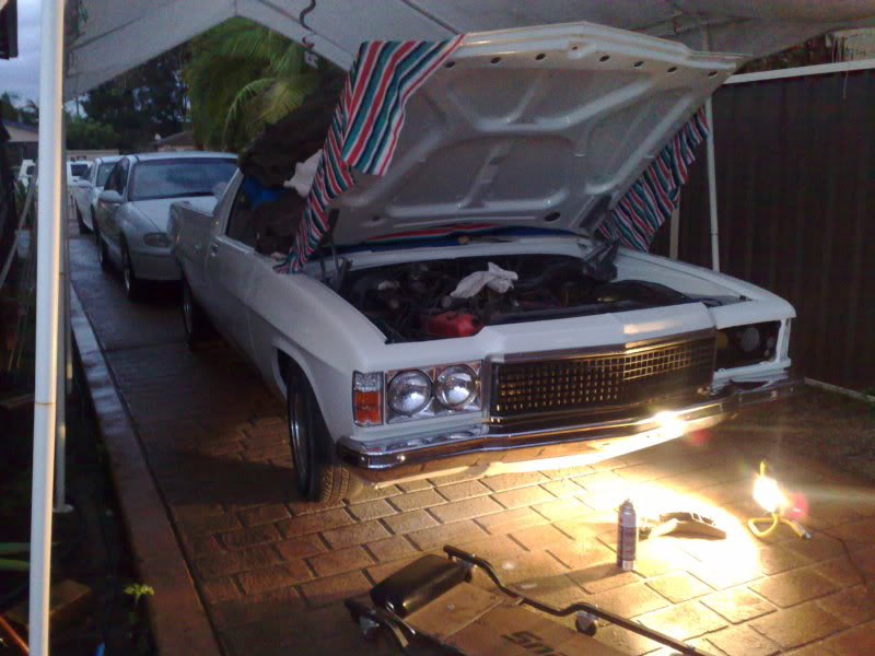

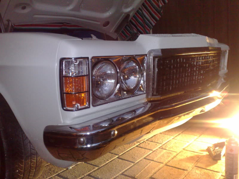

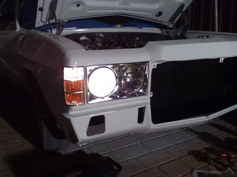

more done-

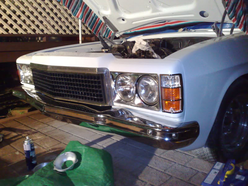

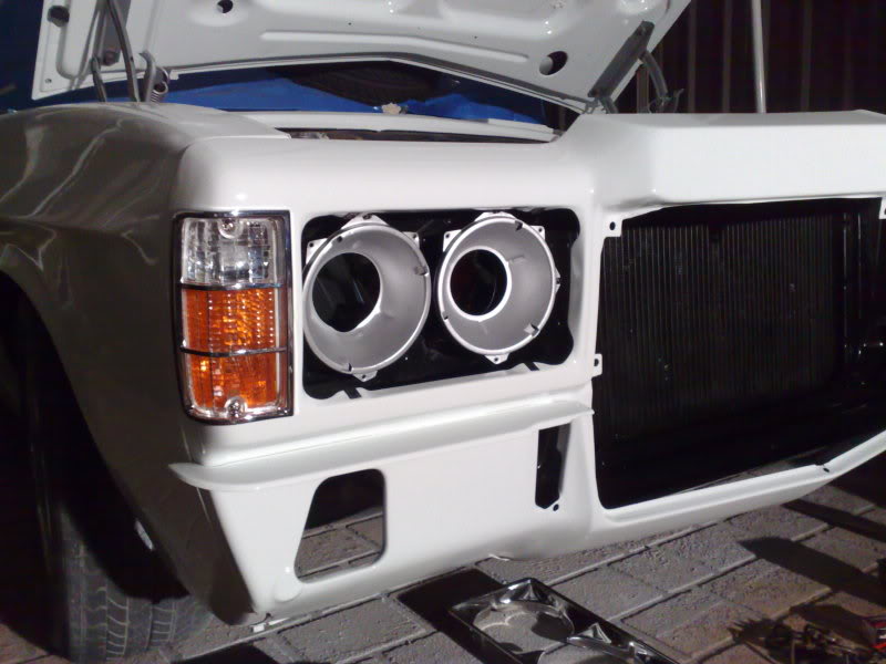

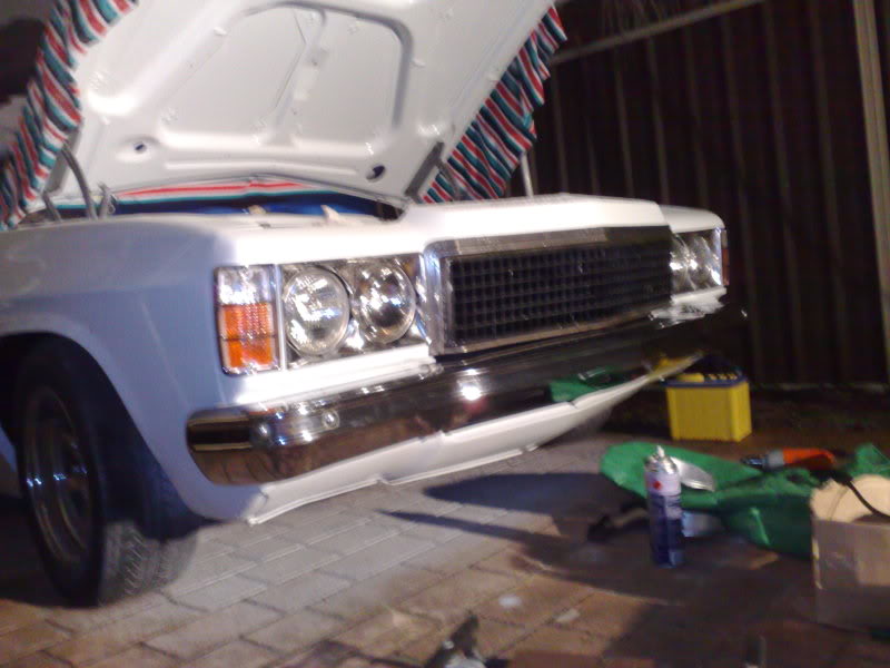

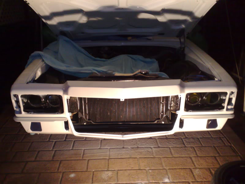

Masked and painted the front of the radiator support again to get rid of the overspray (no photos though)

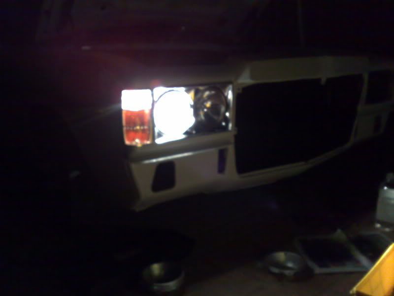

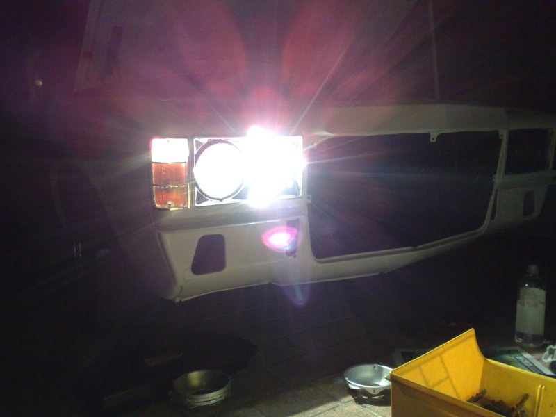

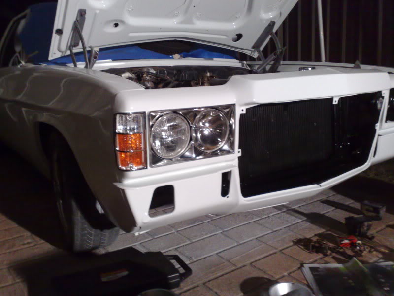

then started on the lights-
highs-
Called it a night after that.

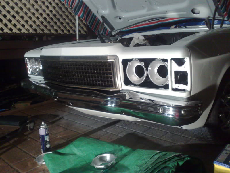

Put Karlie to work on the sunday scrubbing and polishing the front bar, she did a wicked job and it came up pretty good. Im planning to pull it off and rust convert+paint the inside and brackets, but with some more help from Karlie I threw it on and bolted it all up.
we must be a real white car kind of household-
Posted Image :D

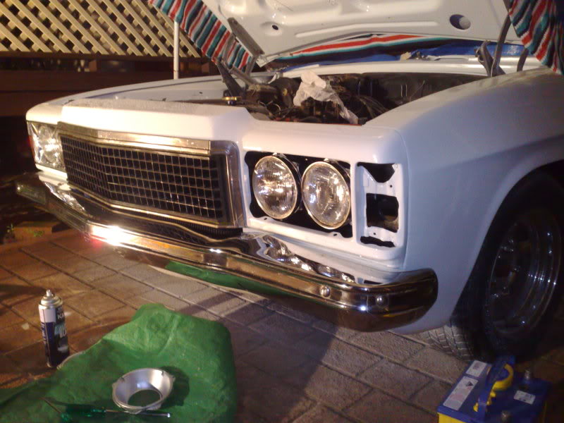

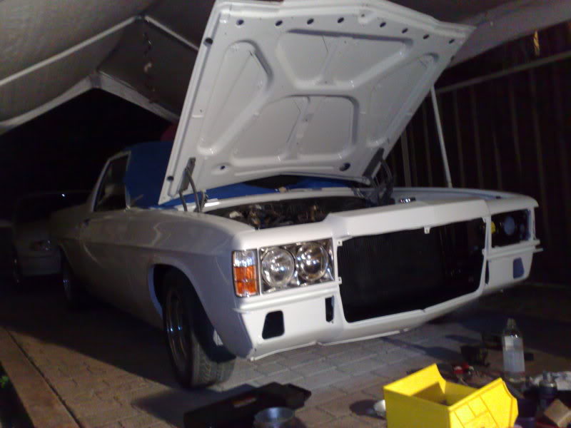

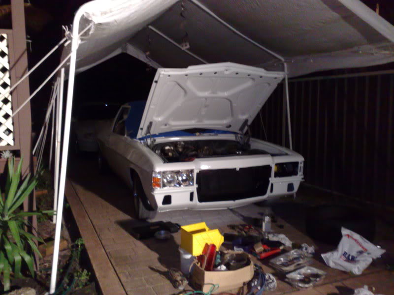

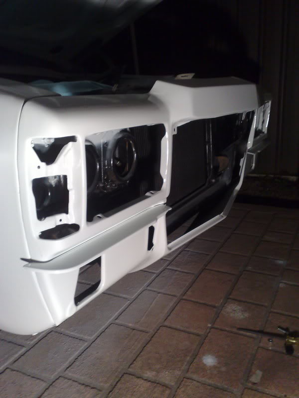

Then I made a start on the passengers side-
and while I was working away on the ute, karlie and the dog were obviously relaxing-
at the end of the weekend it looked something like this-

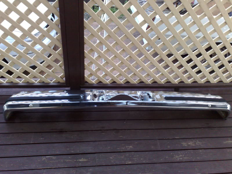

I also spent some time polishing up the rear bar ready to go on once I cut and weld the brackets up-

p.s I know my headlight surrounds are on backwards in some pictures! lol, I only had them sitting there and realised after Id pulled them off to polish them up
