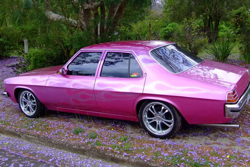

Your ute is looking really good. I like the commodore wheels.
As for lowering blocks, save your money. Just pull the centre bolt out of the spring pack, take the smallest or second smallest leaf from the bottom, flip it over and stick it on top. Then put the centre bolt back in. All done. And free : )
My old HZ ran 18 inch commodore wheels. I bought a set of 30mm thick hub adaptors that bolted to the HZ hubs with imperial PCD, then had another set of studs coming out of the adaptor with metric PCD. They were only $200 a set and made the choice of wheels endless. Just a thought.
You can see them in behind the wheels.

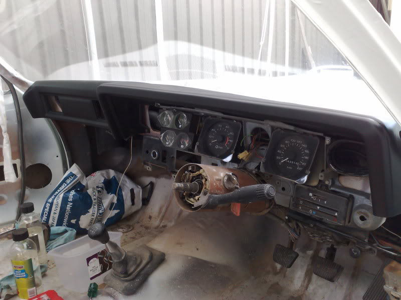

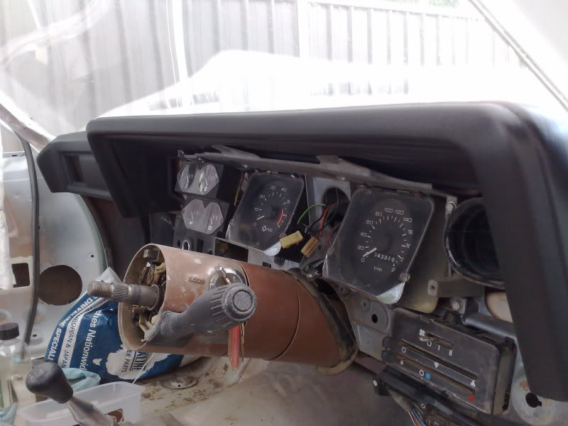

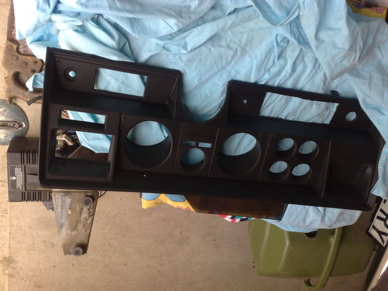

Got some work done on the weekend-
swapped the dash cluster and crashpad over-

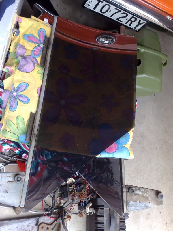

Made some temporary plastic windows to keep the weather out- (not progress, but thats all these photos really show! haha)
Cleaned up and painted the facia-
And had Karlies dad tint the windows before I get around to putting them in-
fair bit darker then "legal" but will look schmik (had the back window done too)

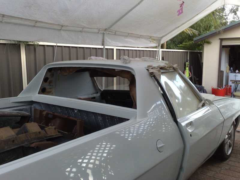

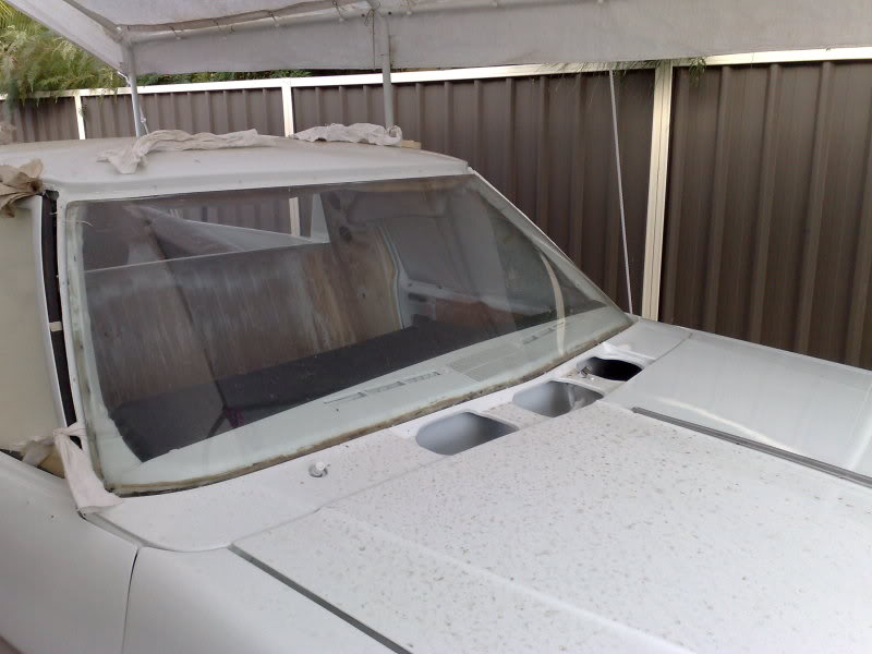

Need some weather strips and clips for the doors so I can install the windows, then I will get the windscreen guy out to put the front and rear screens in (buying new front)
not a bad driveway-

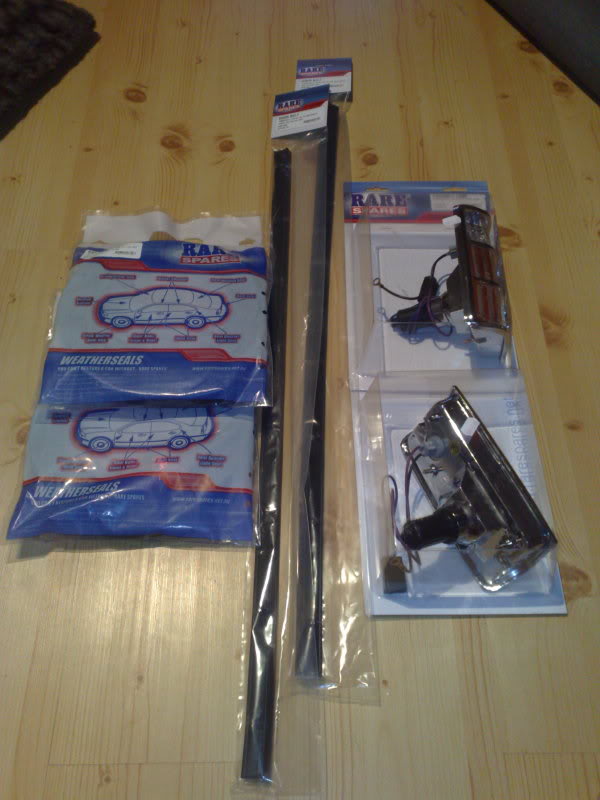

Then it was off to Rares-
Bought full bailey channels for both doors, outside weather strips and 2 new front indicators (others are a bit dodgy)
Aswell as a front and rear set of that chrome pinchweld type stuff for the front/rear windows on the racecar :)
