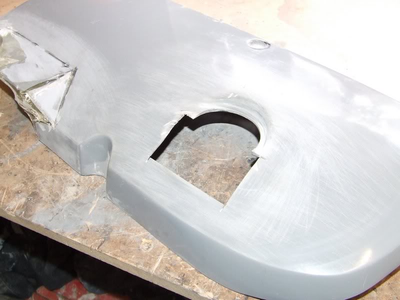

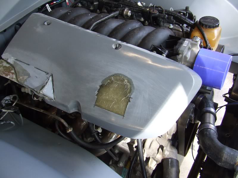

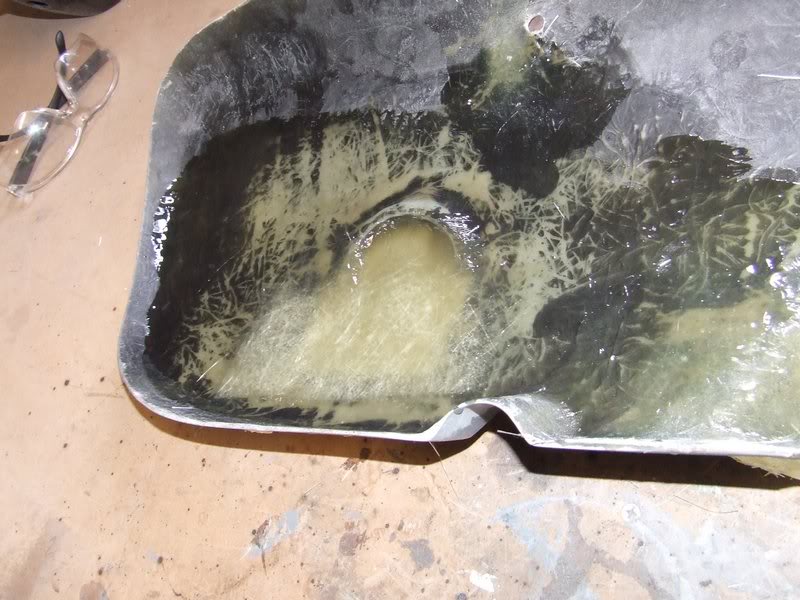

ls2lxhatch told me that the oil filler neck, that protrudes from the engine cover, can be unscrewed and the oil cap screws to the tappet cover where the neck used to be. Bargain! Thanks again Andy.
Unfortunately for me that meant a bit more fibreglassing : (
Here's the cover before I chopped the oil filler out.
Even though the raised lip around the bottom of the hole is small, the whole area is flared up to meet it, so I cut the whole are away to get rid of the high spot.
With that done I prepped it and fibreglassed the hole up.
It's not pretty, but it will be eventually : )

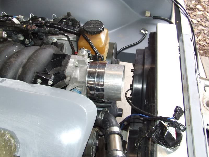

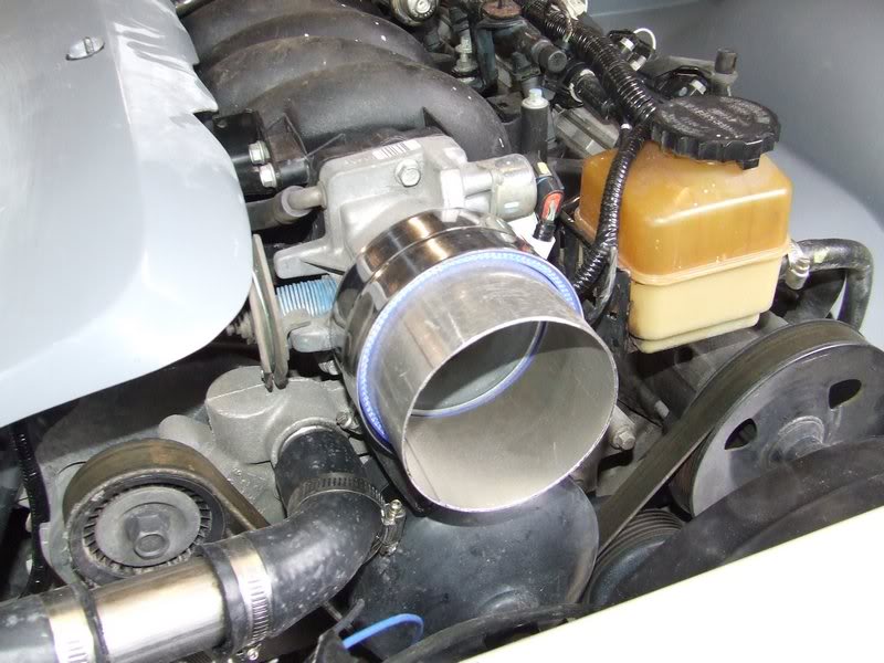

Now, the only silicon hose I could get was blue, yuck, but I had no choice. Seeing as I only need a very short piece, I bought the widest stainless T clamps I could to try and cover it. Well, it certainly does that. Apart from the side of the hose, it's totally hidden.
From this angle it's all shiny metal and no gay blue pipe : )

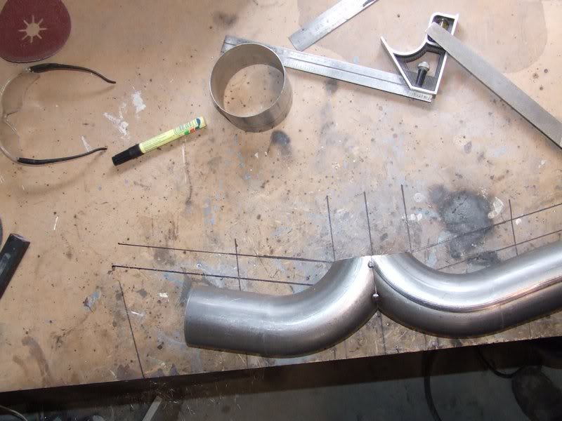

The new intake has the pipes come out and sweep back, rather than the original one being 90 degrees. This meant I had to be careful with my measurements and cuts.
I drew it all out on the bench, so I knew where the Y piece would start and the edge of the bench signifying the radiator, so I knew my space restraints.

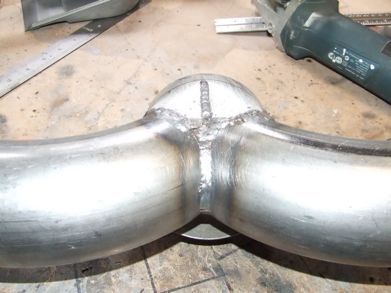

With the two 3" intake pipes welded together it was time to join them into the 4" pipe.

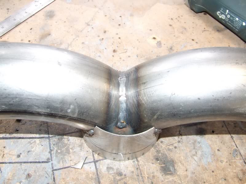

The pipes are welded into place now, but there's a bit of a gap here.
I just cut a small V out of the 4" pipe, knocked it down and welded it all together.
Here it is having a trial fit.

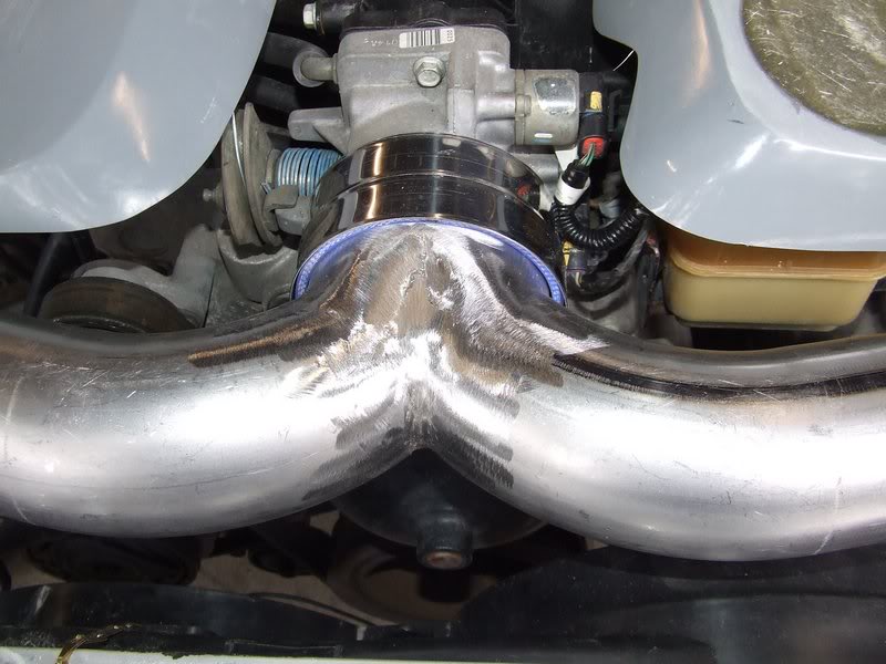

It came up OK after a bit of a sand with a 36 disc on the grinder. I'll get it better once it's finished. This was all I could be bothered doing this arvo : )

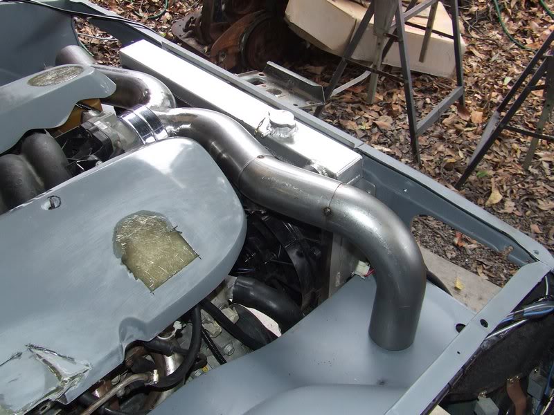

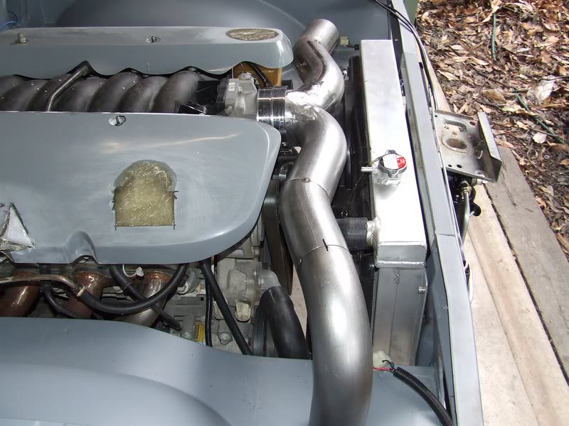

I then added the next bend on each side, then tacked the 90 degree bend on the drivers side that will see the intake pass through the inner guard, with the filter underneath. I'll get the other side to this stage tomorrow, then make some supports for the intake that will bolt to the motor, then I'll hole saw out the bits I need. Doing that last will ensure they're in the right place.
I like this pic. The intake looks weird, but I dig it : ) It looks like an old school moustache.
Well, love it or hate it, I like it, and there's no notches or small bits added in, so this WILL work : ) hehehe.

Hi Tim, just an observation,
If you have the intake pass through the inner guard, with the filter underneath, will this cause an issue with the water and dirt/mud coming off the wheel and onto the filter??? other than that it looks fantastic.
Cheers Paul.

Hey Paul, yes you're right there is the possibility of that being an issue. I've sort of figured out some plastic shrouds in my head that will stop anything from the tyres hitting the filters, and should be fairly simple to make as well.
Plus, I'm hoping he doesn't do too much rally packing in it anyway : )
