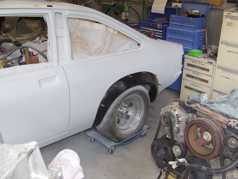

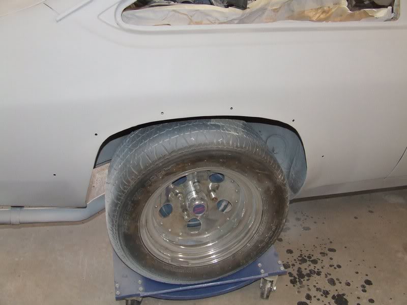

Got the rear guard finished. It's funny how after it was all cut and welded it didn't look like I'd cut that much out, until I put the wheel back on : ) I also added a little bit of filler around the wheel opening just to smooth it out, even though the flare covers it.
I'm using stainless 1/4 inch allen bolts to hold the flares on, so I drilled all the holes out to suit.

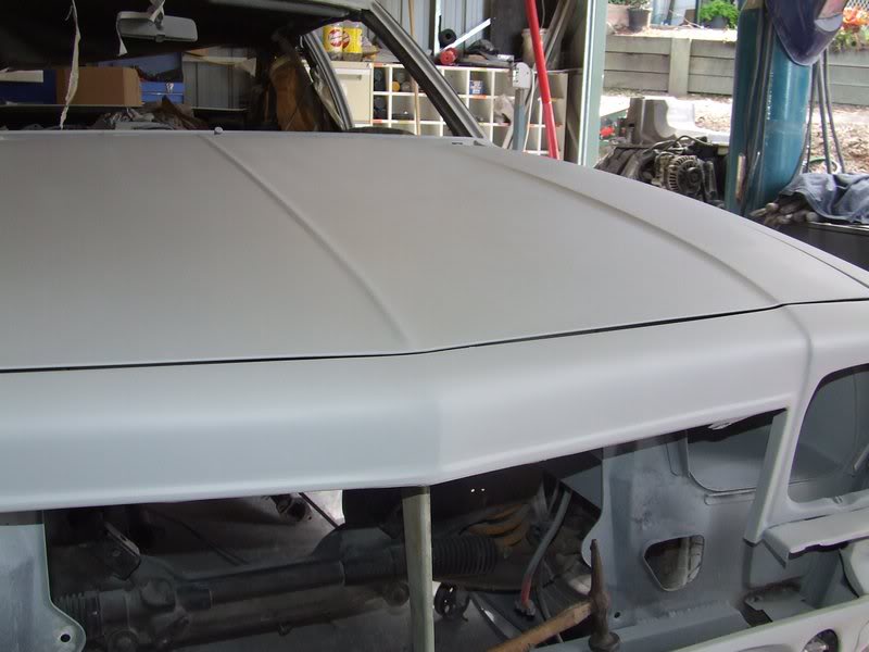

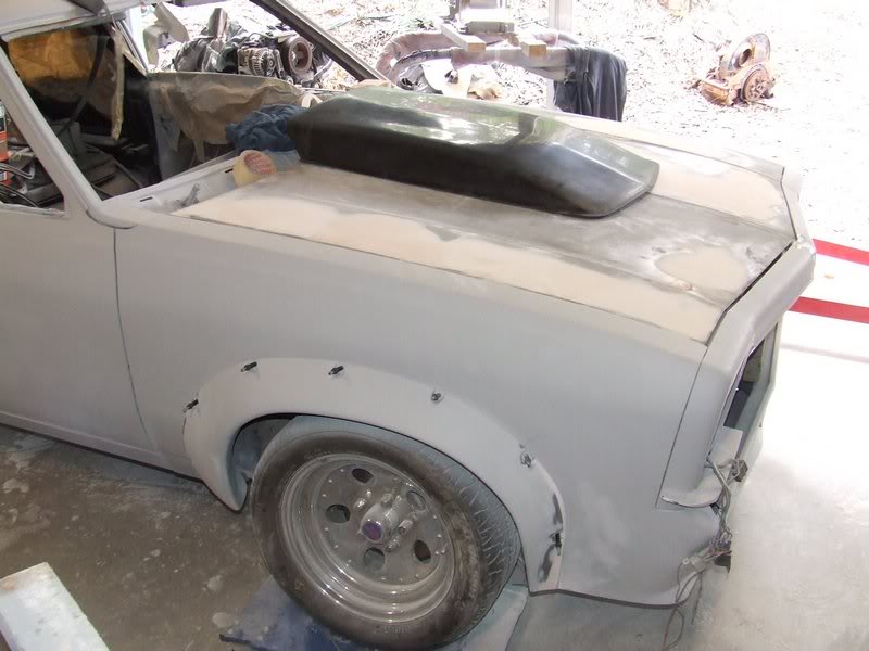

Next job was to fit the bonnet and try to get the nosecone to line up. The nosecone has had a pretty decent hit at some stage in it's life and isn't exactly what you'd call straight. I ended up having to put a few cuts into it so I could yank it into the right position before welding it back together. It's all good now though.
I got the bonnet scoop out today. I hadn't even unwrapped it and it's been here for quite a while (since before work on the car started). It's actually not too bad. I'll need to straighten the top up a little bit but at least it isn't horribly sagged in the middle like some.

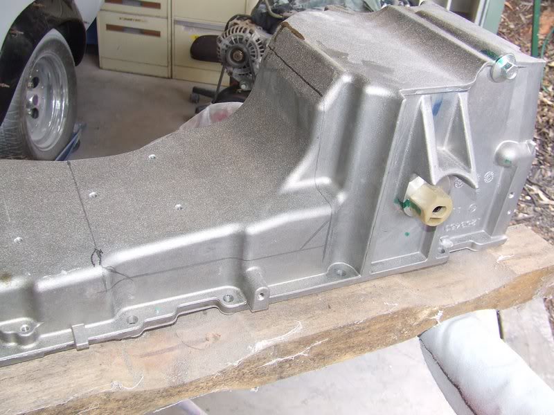

I pulled the motor out again today so I could rip the sump off and get it ready for modifying. The section marked in pencil is getting cut out and plated, plus the pan needs 50mm taken from it's depth. Yay.
Got the left rear flare into position as well. I still need to make some adjustments to the flare itself, as I did with all of them, and then cut the guard out and weld it.

Well there's been a little bit more done in the last couple of days so I thought I'd post some more pics, see if we can start any more arguments. I enjoy the arguments : )
It was good to get the bonnet on. Not only so I could get the gaps sorted out, but so I could see how it looked now it's a bit smoother underneath.

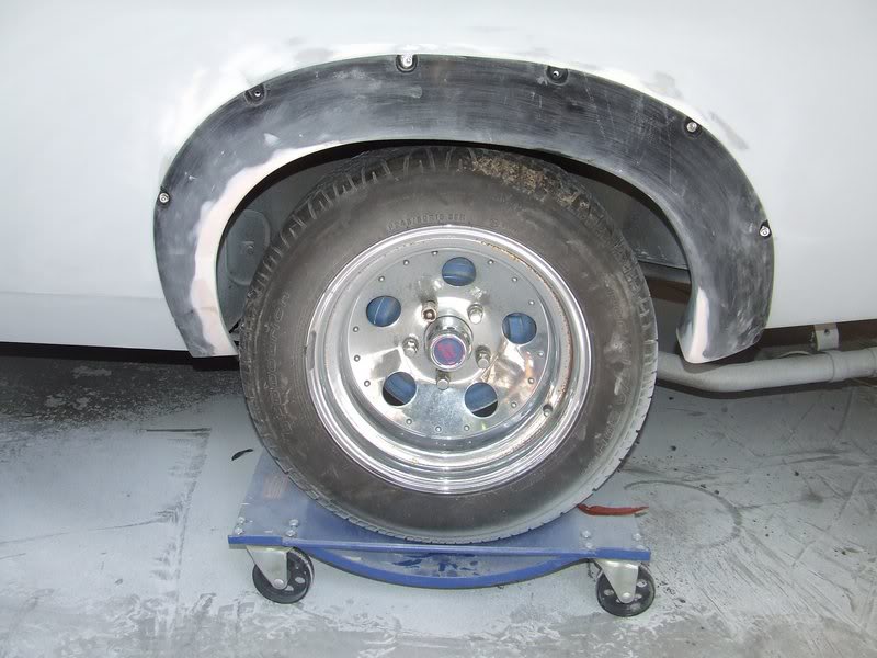

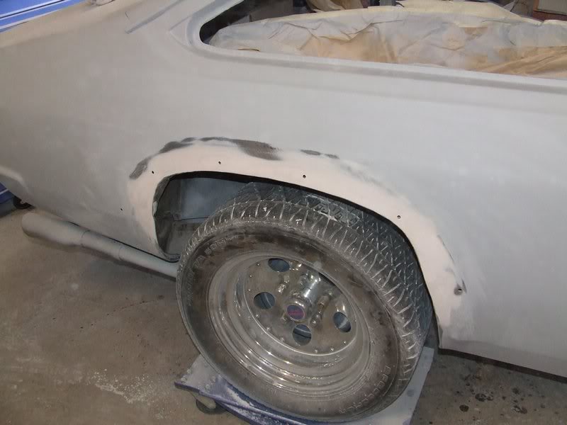

The left rear flare got mounted. It didn't fit too badly except for the fact it was so out of shape I couldn't get it to cover the front of the original wheel arch. I tried all sorts of positions, but the best fit overall was how it is in this pic. It just means I'll have to extend the flare to cover the original wheel arch. Yay.
Then it was time to cut the guard.
Weld the guard
Bog the guard. Exciting stuff this hey : )

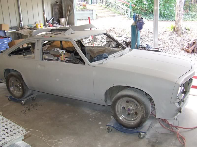

Now both rear guards are ready for primer.

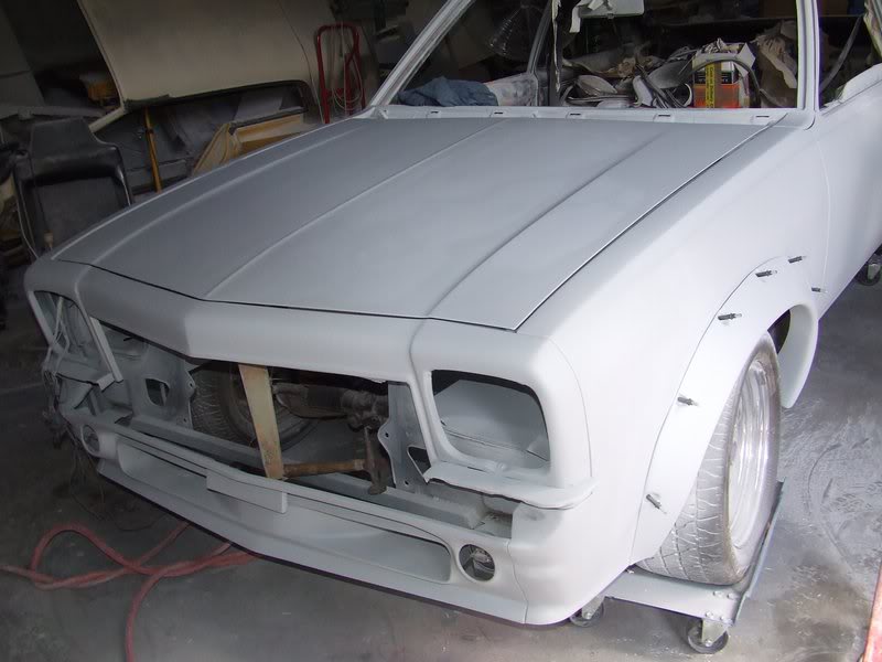

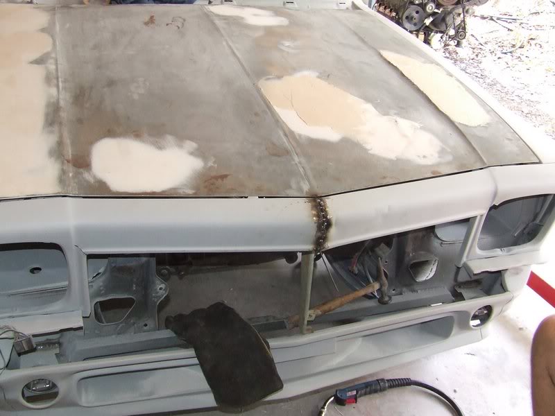

The bonnet and nose cone are finally getting some attention too. The nose cone was in a fairly bad way, so took a lot of mucking about to get it to line up good and proper. The gaps are looking pretty good now though.

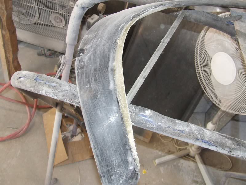

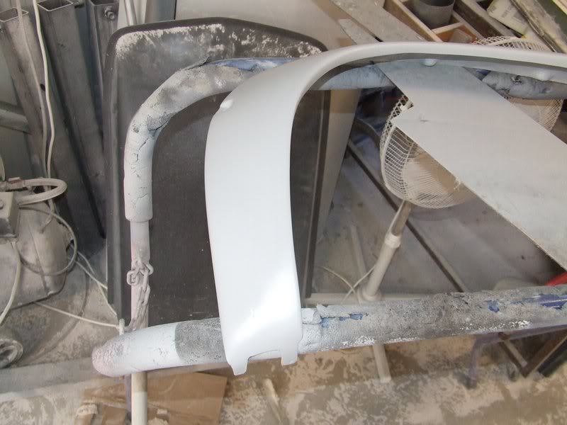

I was totally unhappy with the shape of the right hand rear flare. The bottom of the front section looked to chunky after I'd fixed the big gap. I ended up using a sanding disc on the grinder to cut it into the shape I wanted, then fibreglassed over the top to give it some strength back.

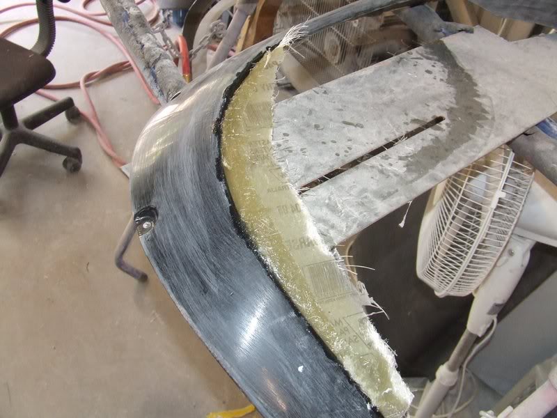

This is the left rear flare getting some extra fibreglass to close up the wheel opening so the metal isn't visible from the side.
Here's what I ended up with once it was dry.
After a bit of a trim down.
It copped a bit of filler front and rear, as I had to cut the back part as well like the other 3 flares. It looks much better now. Don't worry about how it curls back towards the tyre, when it's bolted on properly it doesn't do that. It's just hanging there for the photo.

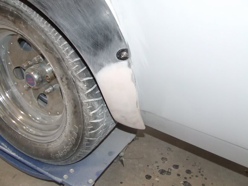

Here's the front of the other rear flare after I reshaped the bottom section. It's much better now compared to how it was. Again, it's just hanging there, so don't worry about the bad fitment.

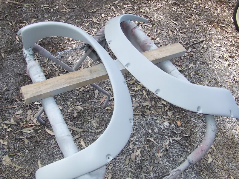

After all that exciting work it was time for some more primer.
The rear guards got a couple of coats where they were cut out.
Don't they look great now? No? : )
This is the left rear flare that I added all the fibreglass to so the wheel opening was a bit smaller. I think it turned out OK.
The other flares I had to do more work to also got coloured grey.

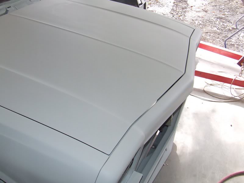

The bonnet and nose cone actually look like they belong to the car now.
It's nice to finally have the dents taken out of the nose cone. The grill opening was fun to get straight.
Speedway here we come!!!!
It's nice to finally see the whole car the same colour.
Well that's it for now. These areas I primed today will need to be dry sanded and primed again after any imperfections are fixed. Feels a bit like a vicious circle : )
