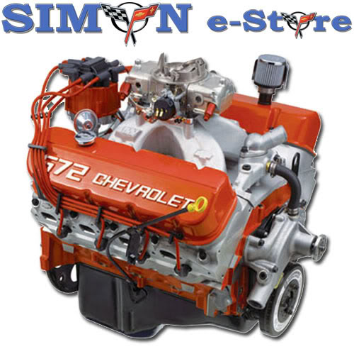

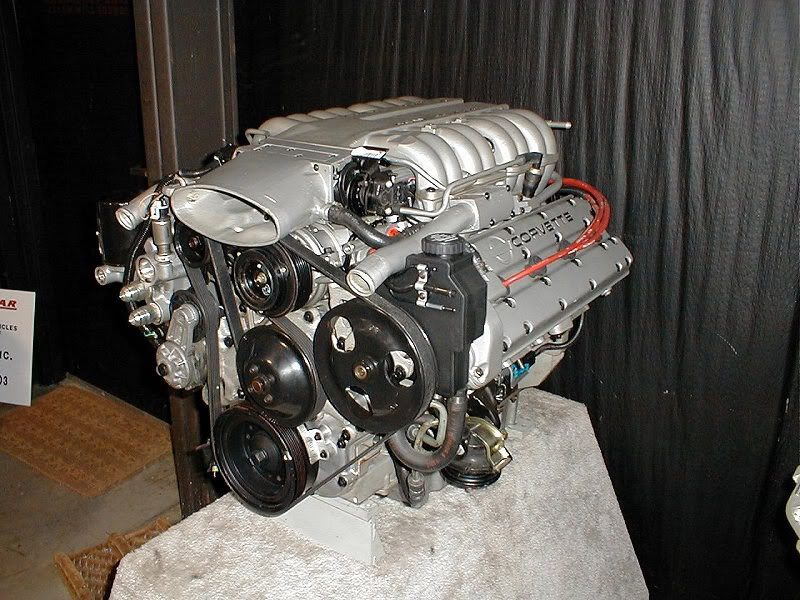

Standard fitment in a Monaro or Torana should be either one of these :spoton: The 572 would have enough torque to kick start a dead planet
https://cache.gmh-to.../untitled-1.jpg
https://cache.gmh-to...572Bigblock.jpg
hahahahha. Gotta love the yank tanks, bigger is always better.
If its worth doing, its worth overdoing :spoton:.
