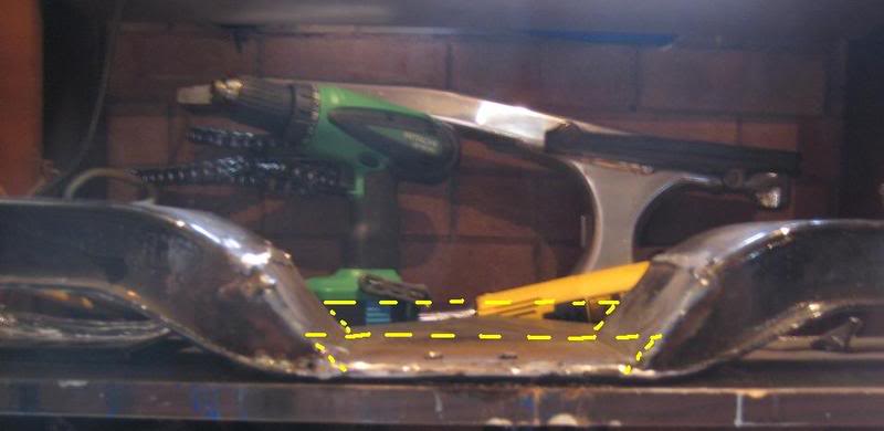

I finally got around to cleaning the garage, now that i can move in there i got stuck into the crossmember that was making the gearbox sit too high.
I cut the center out of the crossmember than boxed it all up with 3mm steel plate.
I have to brace it a little more because it has a small amount of flex in it, if anyone has any ideas on how to strenghten the center id love to hear them.
#261 rodomo
Posted 22 June 2008 - 02:22 PM
A couple of gussets front and rear should do it.
The heaight of the gussets would be goverened by the deapth of the rubber mount.
Either 3mm flat or even 25 x 25 x 3mm angle if you can fit it in.
#262 _doogs_
_doogs_
Posted 22 June 2008 - 02:45 PM
Just read your whole thread, very impressed.
Great job on coming so far , looks great :clap:
#263 _jabba_
_jabba_
Posted 22 June 2008 - 02:46 PM
Ill have to find some more steel and finish it another day, doing it like that looks like the go.

#265 _jabba_
_jabba_
Posted 22 June 2008 - 06:24 PM
I found some scrap 3mm steel, i made 2 angle sections out of it for added strength and its rock solid now with NO flex :). I went abit crazy with the welding, lots of grinding needed :P.

#266 Bart
Bart
    Shit a brick
  • 2,559 posts
  • Car:LJ Torana
  • Joined: 20-November 05
Posted 23 June 2008 - 12:34 AM
You could start from scratch and use square or round tube and make up a new cross member?
#267 _jabba_
_jabba_
Posted 23 June 2008 - 10:16 AM
Yeah i was thinking that, but that probably would probably have cost about the same as one i could buy off ebay and this was free :P.
