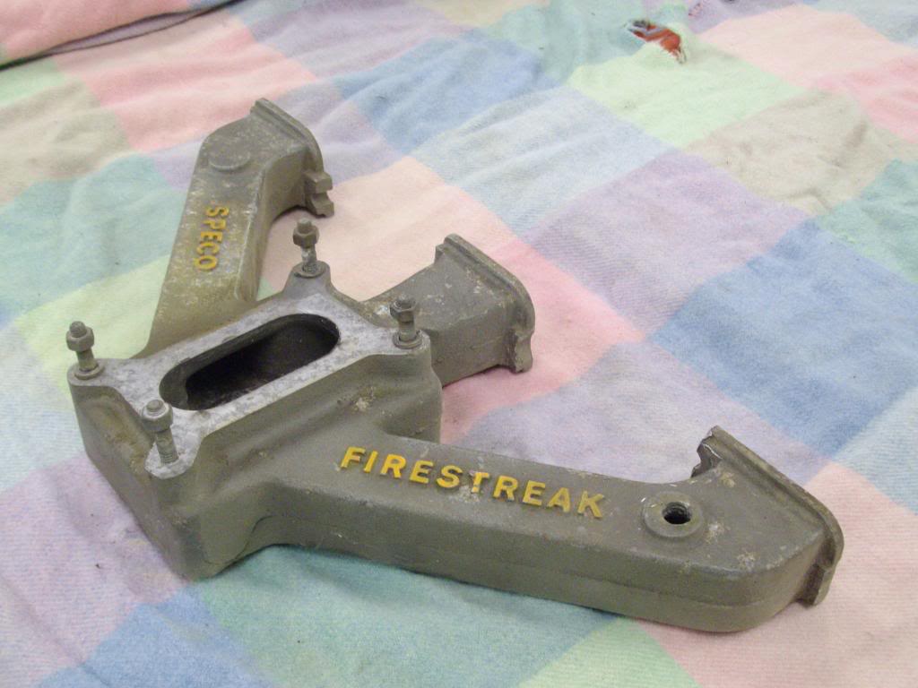

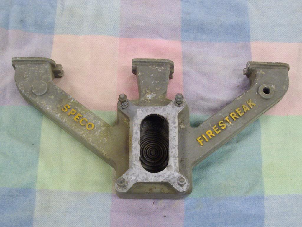

As for the manifold in the pics it looks like a speeco firestreak. They were water cooled so it would have plenty of room to machine out and make a plenum that the 4 barrel adaptor was welded to even without a mill. Just take plenty of time.

I have a firestreak manifold .
If a pic is required,just ask.

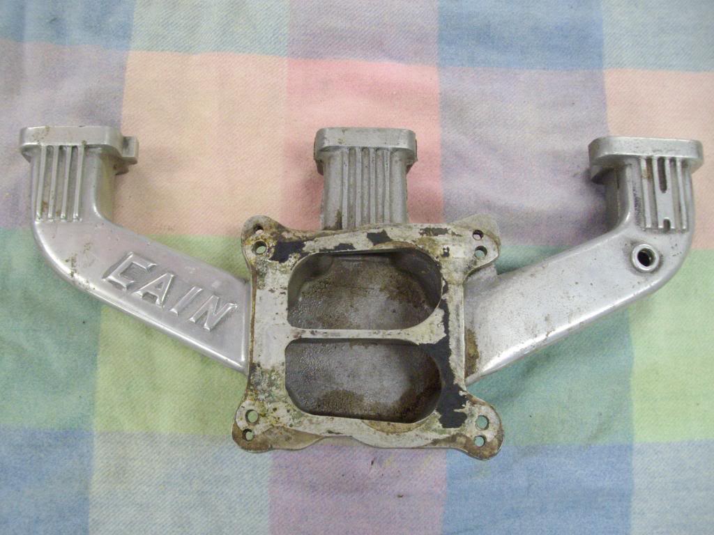

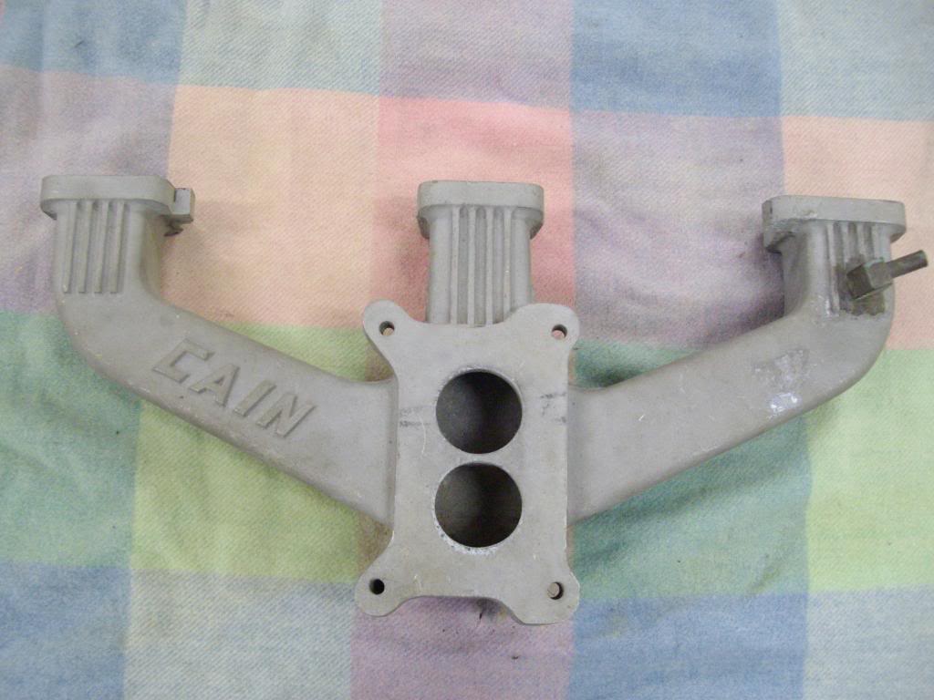

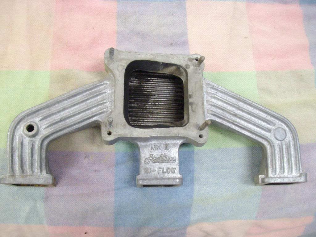

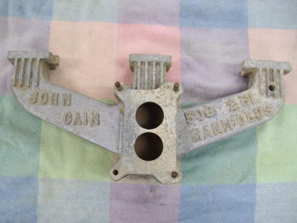

#45 wot179
Posted 24 February 2010 - 09:28 PM
Heres some pics whether you want them or not.

#48 wot179
Posted 24 February 2010 - 09:35 PM
I agree.Take your pick of one of these.
#49 Heath
Posted 24 February 2010 - 10:04 PM
Am I the only one who thinks they all sit the wrong way? Even the four barrels.
#50 _Bomber Watson_
Posted 24 February 2010 - 10:12 PM
Yeah look im not entirely sure what it is either, i know its not either of the bottom two, i doubt its the second one from the top, the first one.....i still dont think so but its close.
