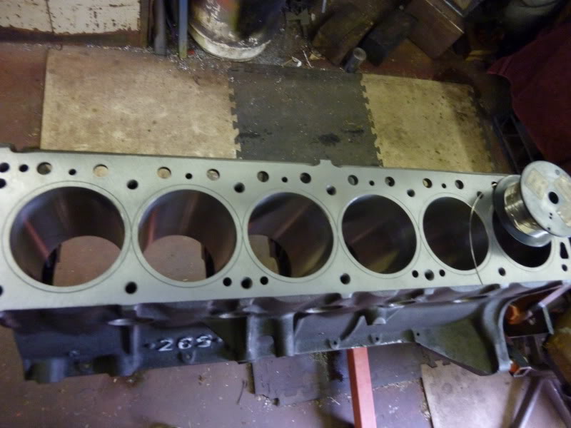

i have now got block back from machine shop it is now ready for grout filling. it has got orings on block aswell i have to do that aswell hopfully today somtime.

You should have grout filled the block before you did any machine work.
If you have torque plate honed and/or line honed the block I would not fill it now. The grout will distort the block enough to render those machining operations inaccurate.
#65 _Drag lc_
_Drag lc_
Posted 28 March 2010 - 08:23 AM
struggler,
from what ive been told and did on ours the block should be filled between borring and honning so once i have the orings in it has to sit with the torque plate on and girdle on for some time before the bloke will grout it.
yeah it has been line borred aswell and flats on main caps for girdle aswell.
#66 Struggler
Struggler
  • 2,426 posts
  • Name:Andrew or AJ
  • Location:Canberra A.C.T.
  • Car:UC Sedan
Posted 28 March 2010 - 08:32 AM
Your line hone might be OK as it is a six cylinder.
I'm glad you are torque plate honing it after the fill.
If I'm going to fill a block it is the first thing I do, after the initial hot tank.
#67 _Drag lc_
_Drag lc_
Posted 28 March 2010 - 08:40 AM
arh ok.

Posted 28 March 2010 - 06:06 PM
not quite im a bit afraid to machine that much off the caps..
here is a pic of the o'rings i fitted today.carnt really see them that well but u get the idea.

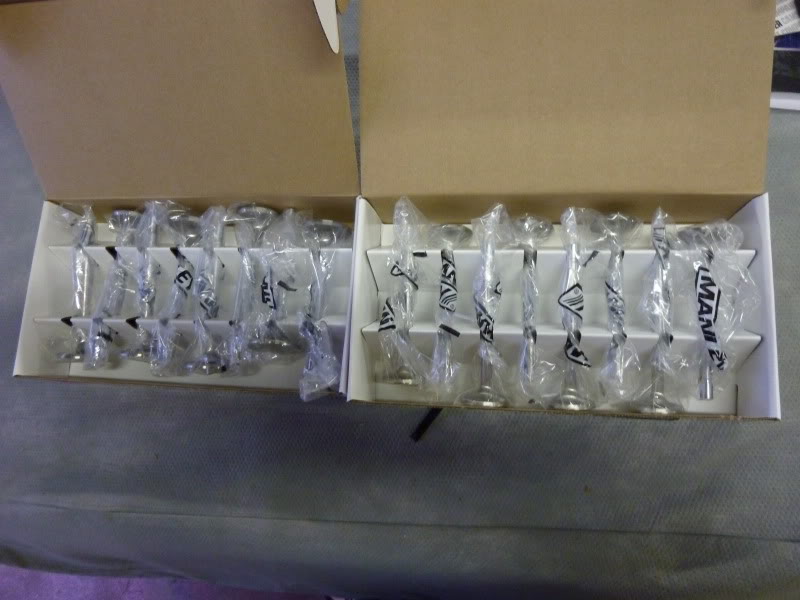

#75 _Drag lc_
_Drag lc_
Posted 31 March 2010 - 05:54 PM
just an update these arived today, this thing is really coming together now it seems.
johono couldnt resist one last :stirpot:
rest easy i will send the interested parties photos of it in the next few days.
