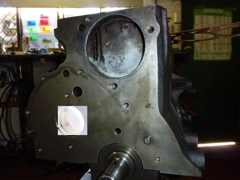

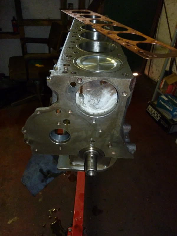

Just an update on this thing.
the block has been back from getting grout filled for a while now but ive been pre ocupied and a few things have happened since.
so i have now fitted the crank and a slug again to get some more work done on it then it will be pretty much ready to go together i was hoping to have it together by now..
in the pics u can get an idea of how much grout was used hehe.
Cheers Hayden

nice any chance off a pic off the girdle
#80 _Bomber Watson_
Posted 23 May 2010 - 02:18 PM
Wow that cam bearing is really clean in the second pick...
#81 _Drag lc_
_Drag lc_
Posted 23 May 2010 - 02:35 PM
yeah funny that hey dj.

is that block grouted so it can still run water through it? will the car see any street use?
#84 _Bomber Watson_
Posted 07 June 2010 - 08:33 PM
Plenty of room for about 200mls of water mate :P

Posted 09 June 2010 - 07:34 PM
stinga
yeah there is still room for the water to circulate in block to be honest im more concerned about the water circulation in the Iron head than the block as u will see when its finished.
the car will see as much street use as it can handle i guess :rockon: with the boost down to a pump fuel freindly level.hehe.

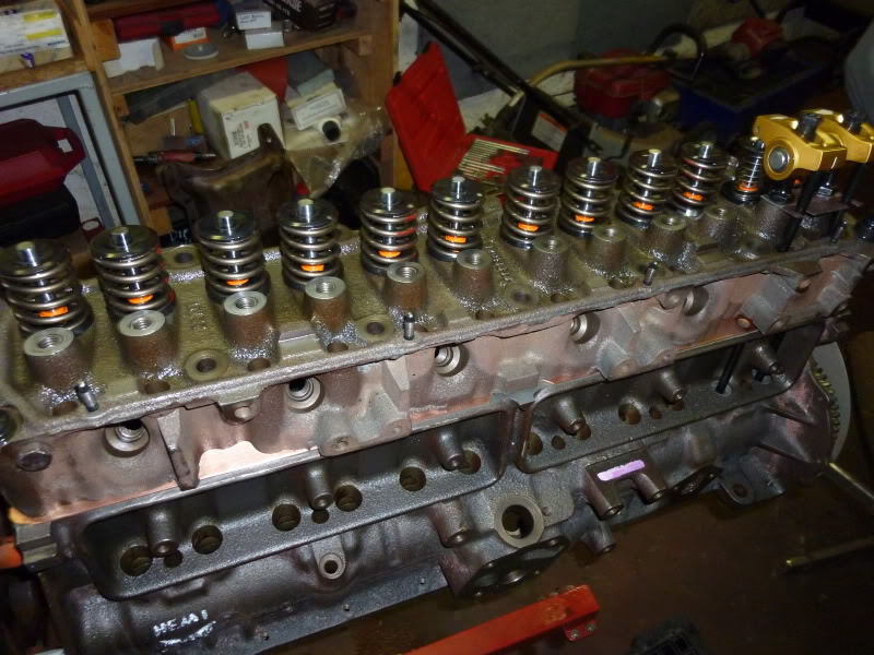

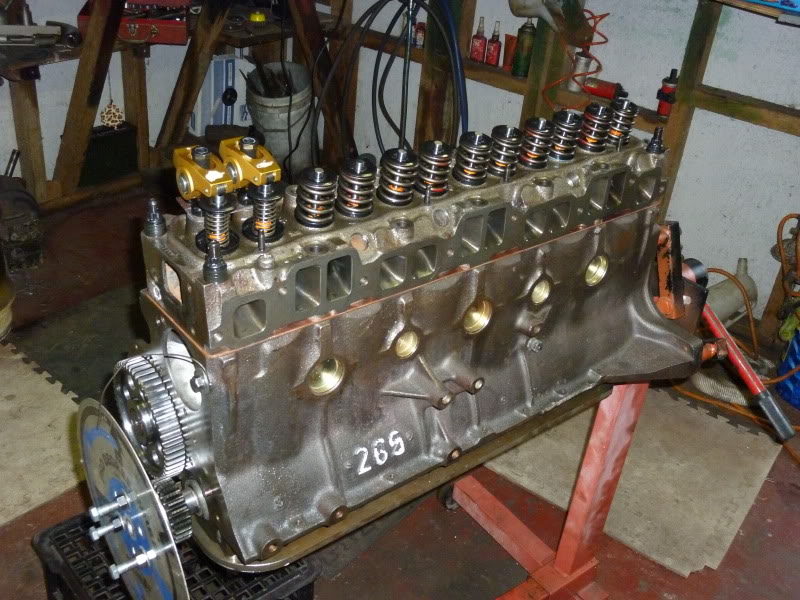

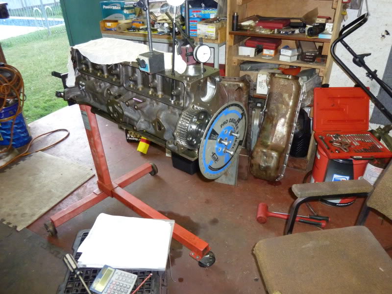

Posted 27 June 2010 - 05:55 PM
ok did a few more checks thisarvo here are some pics note the size of the valve springs,no not the ones under the rockers.i guess u need them when your looking for a fair amount of hp.
im so used to piston to valve clearance dictating how much comp u get, this has way more clearance in that area than ive seen in a long time.
anyway these maybe the last pics before it goes together.

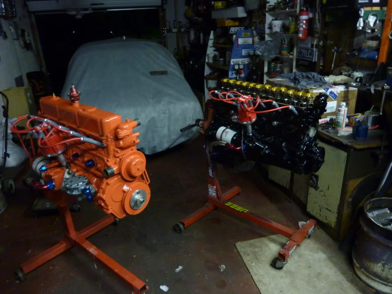

Posted 27 December 2010 - 09:21 PM
well finaly the day has come this engine is all but done pete is picking it up tomorrow and from what i can gather it should go in a few months. it has had good company in my shed this last week just hope some of the hp it will make might have slipped into my old faithfull.hehe. that is what i have been doing all last week.
i will add the vac module on the dizzyu will be gone tomorrow.woot woot
Cheers hayden
Edited by Drag lc, 27 December 2010 - 09:22 PM.
#96 _Bomber Watson_
Posted 27 December 2010 - 09:35 PM
Wow thats impressive paint work for you Hayden :tease:
#97 _Drag lc_
_Drag lc_
Posted 28 December 2010 - 07:53 AM
hey pete painted it ...hehe :buttrock:
