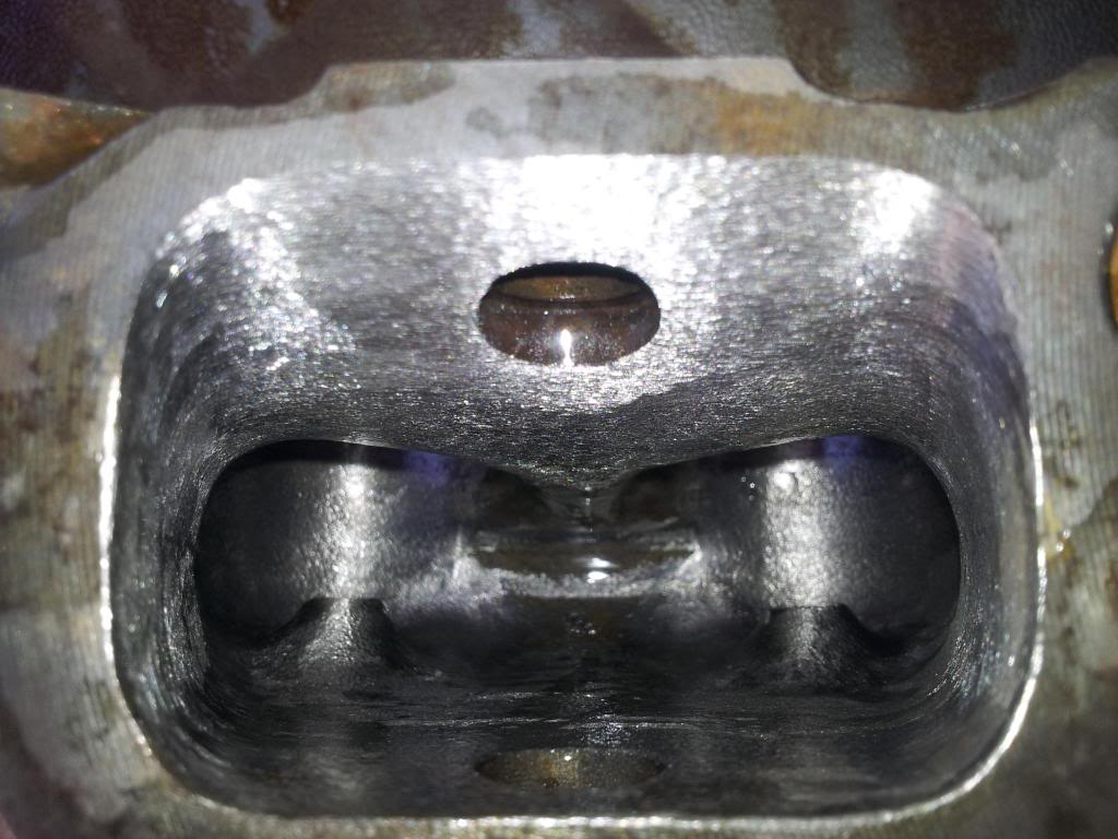

#134 _runna_202_
_runna_202_
Posted 12 January 2013 - 03:05 PM
im out of bends for the manifold so i thought i do a bit on the head. its a closed chamber 9port for a aspirated combo

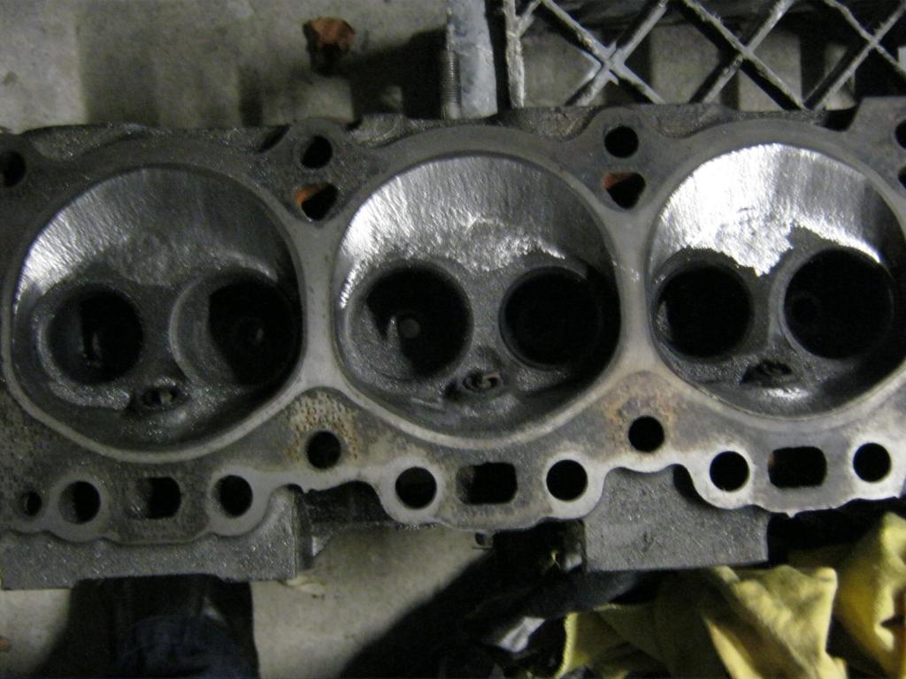

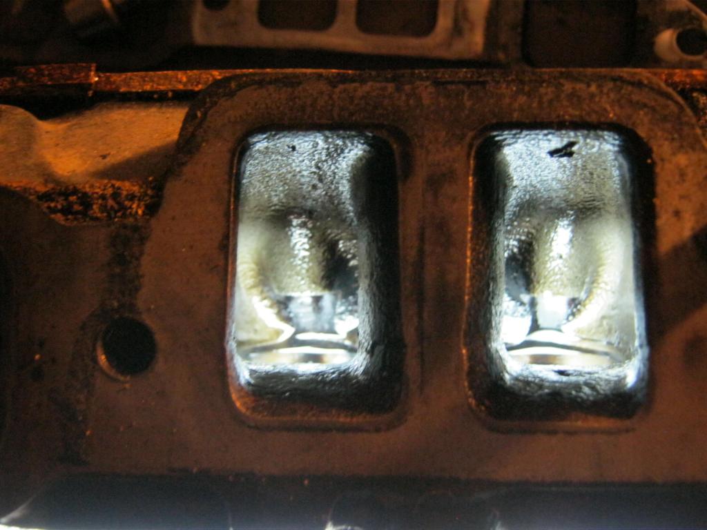

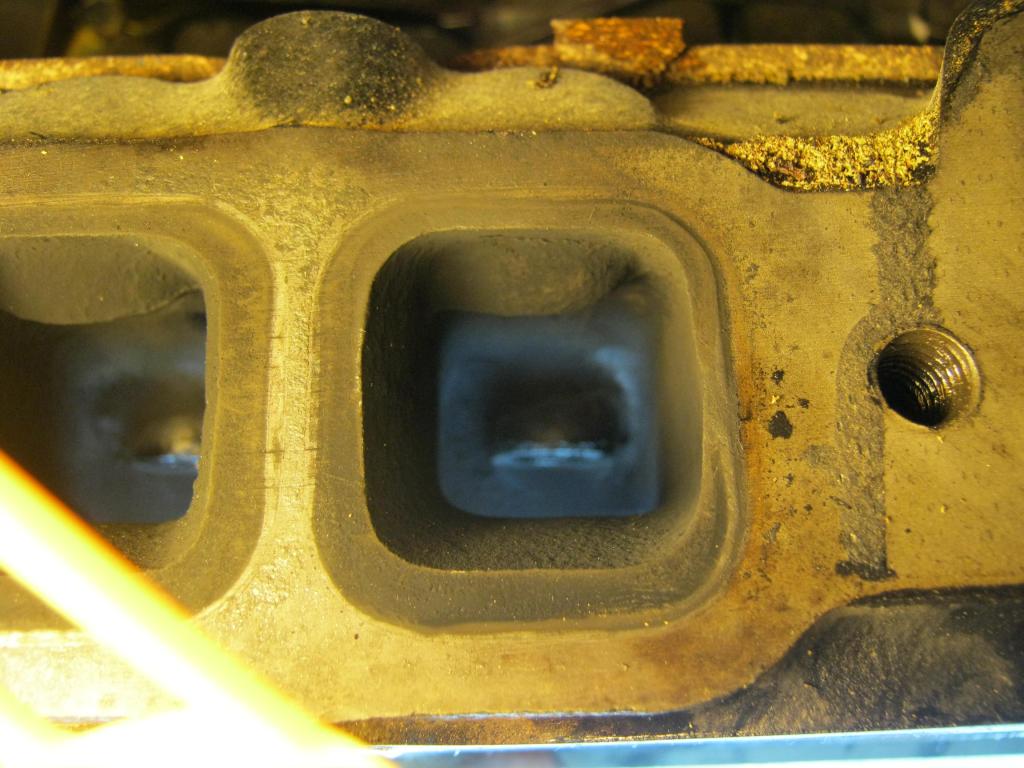

#135 _runna_202_
_runna_202_
Posted 12 January 2013 - 03:09 PM
intakes are almost done i just going to finish them with 80 grit cartrige roll
#136 _runna_202_
_runna_202_
Posted 12 January 2013 - 03:14 PM
chambers almost finished

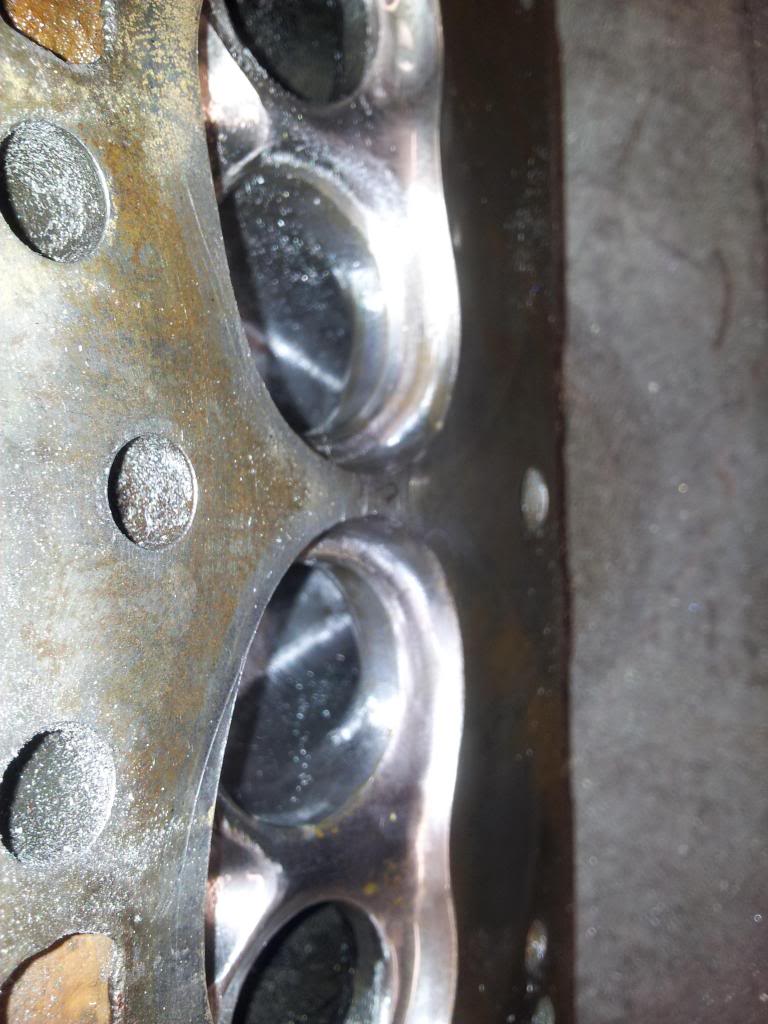

#137 _runna_202_
_runna_202_
Posted 12 January 2013 - 03:18 PM
its hard to take a photo of the shortside but gives you a bit of an idea,this is where the powers made and lost.hehe
#138 _runna_202_
_runna_202_
Posted 12 January 2013 - 03:46 PM
Ive ported the few holden 6 heads now and just done one for a fello forum member for his everday streeter,its was nothing flash had a bowl job,short turn,chamber work i left the port size standard as i tryed to inhance air speed and also 9 ports inherently have a large port from stock specialy with the boss removed. So we put in on a mates sf600 flow bench and it went 185 @ 500'' which is about 285hp in flow potential. We were both pretty stoked with that and the engine the heads on is only hyd cammed it seems to go really well. If anyones interested in getting a holden head ported for a street car,race car,turbo, nitrous supercharged pm me.

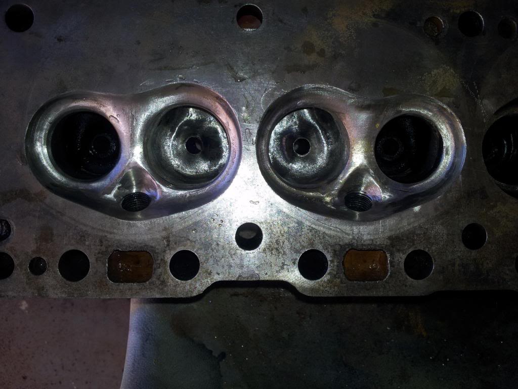

#141 _rb3torana_
_rb3torana_
Posted 14 January 2013 - 07:25 PM
I havent got a finished pic of the head, I got abit too keen and put it on before pics lol. But heres some during the early stages. Basically all that changed was polished the chambers, did the short turn on both inlet and exhaust and straighten the inlet a tiny bit barely worth mentioning. Also ground the air injection bossed flat on the exhausts. Stock valves. I dought that the head would even flow 140-150cfm lol. Chambers were 62-63cc. Cheers
Edited by rb3torana, 14 January 2013 - 07:27 PM.
#142 _runna_202_
_runna_202_
Posted 15 January 2013 - 07:17 PM
looks good mate. how does the motor run without quench? the 265 hemis seem to perform well like that. Its good to see you are doing the work yourself mate,its pretty satisfying i recon. cheers peter
#143 _rb3torana_
_rb3torana_
Posted 15 January 2013 - 08:32 PM
Yeah I think it is a little slower down low but still runs well, have been able to run more boost/timing this way also. Id say more benifited from chamber design than the lower comp. Cheers
