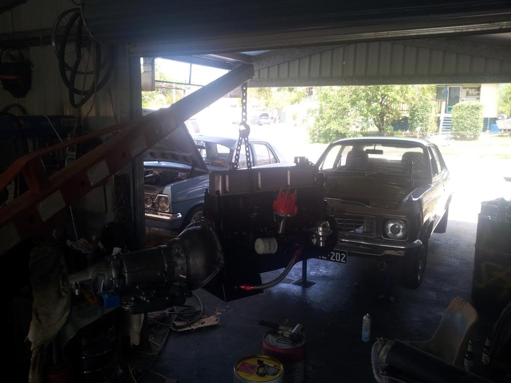

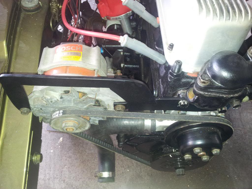

hi fellas,
not sure if everyone was aware but ive been side tracked for a couple of years playing around with a blowthrough turbo red in a hr holden that i also own. As we speak iam frabricating a new set of pipes for the lj and grafting the engine from the hr in the lj with some different, hopfully better mods. My hr went 11.2 @ 118 on 14psi which i was pretty happy with,it lifted the head a couple of times this year as i think theres been a few tuning issues but hopefully now we are on top of it now. Im pretty retarded when it comes to computers but hopfully ill get some pics up soon,thanks for the interest guys i honestly thought it had slipped of the radar.lol thanks peter

#111 _runna_202_
_runna_202_
Posted 28 December 2012 - 07:04 PM

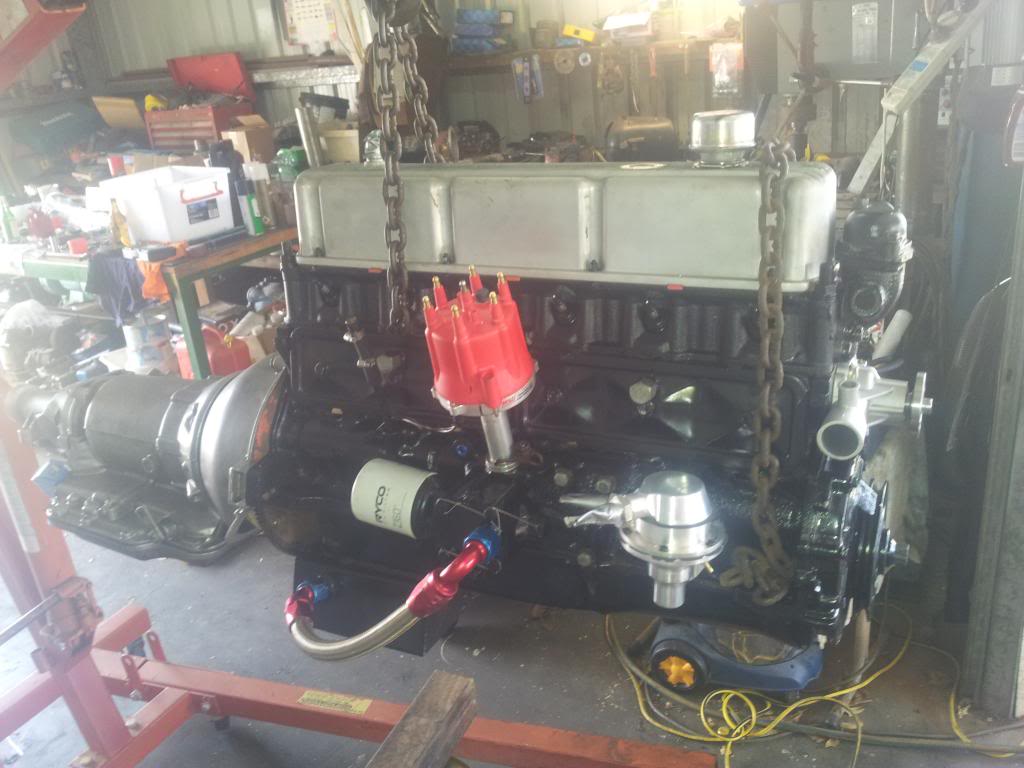

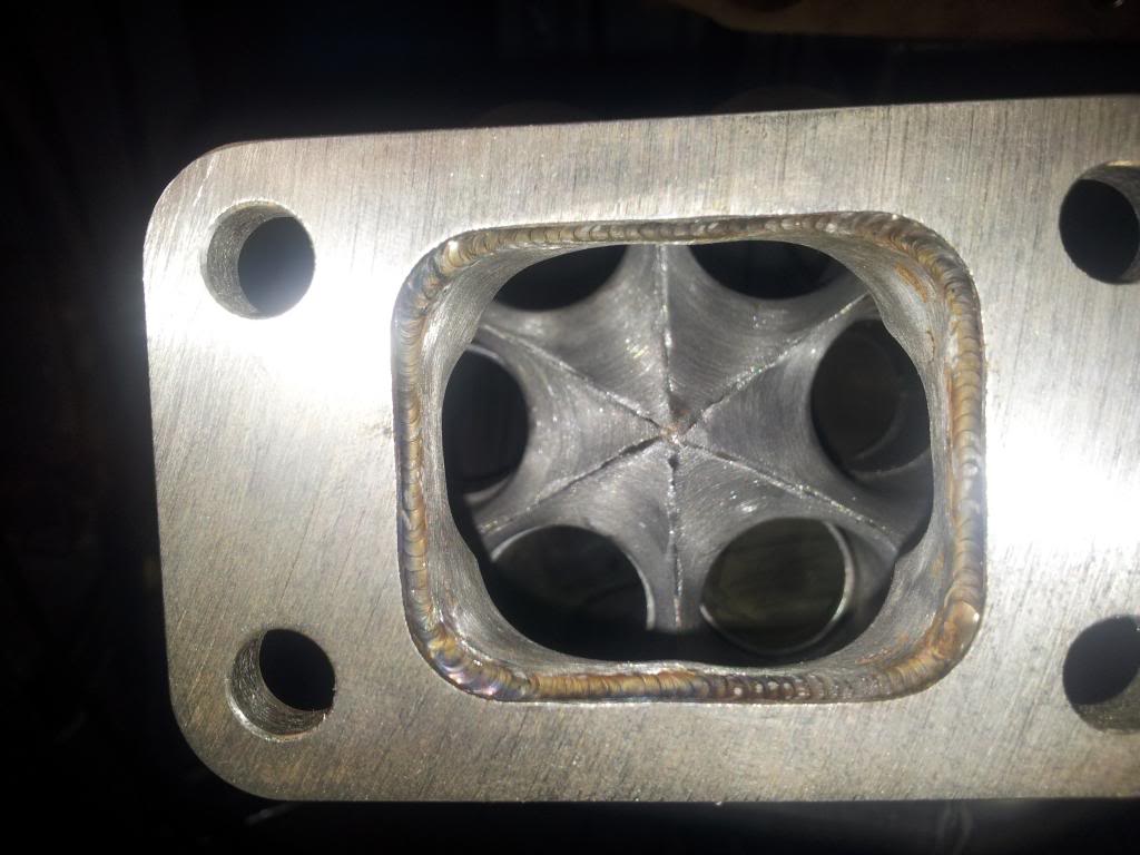

#112 _runna_202_
_runna_202_
Posted 28 December 2012 - 07:36 PM

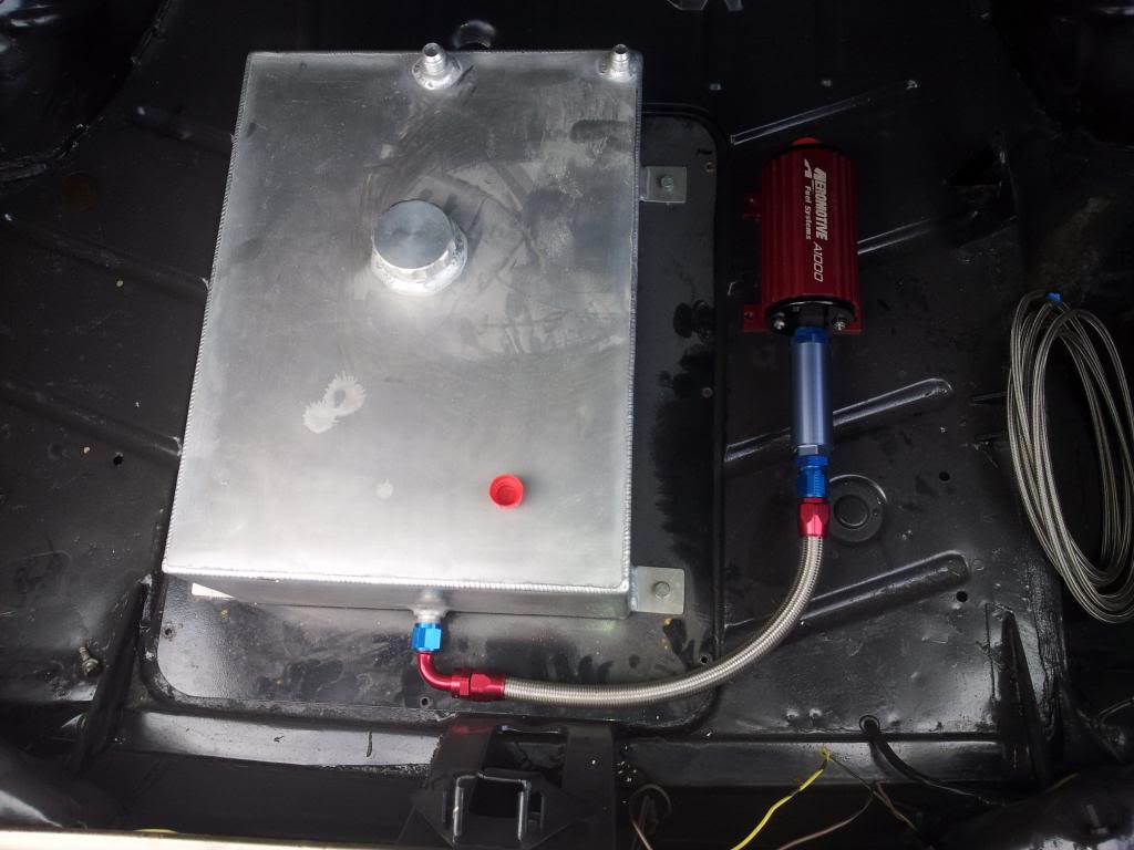

Posted 06 January 2013 - 03:08 PM

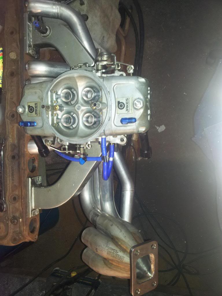

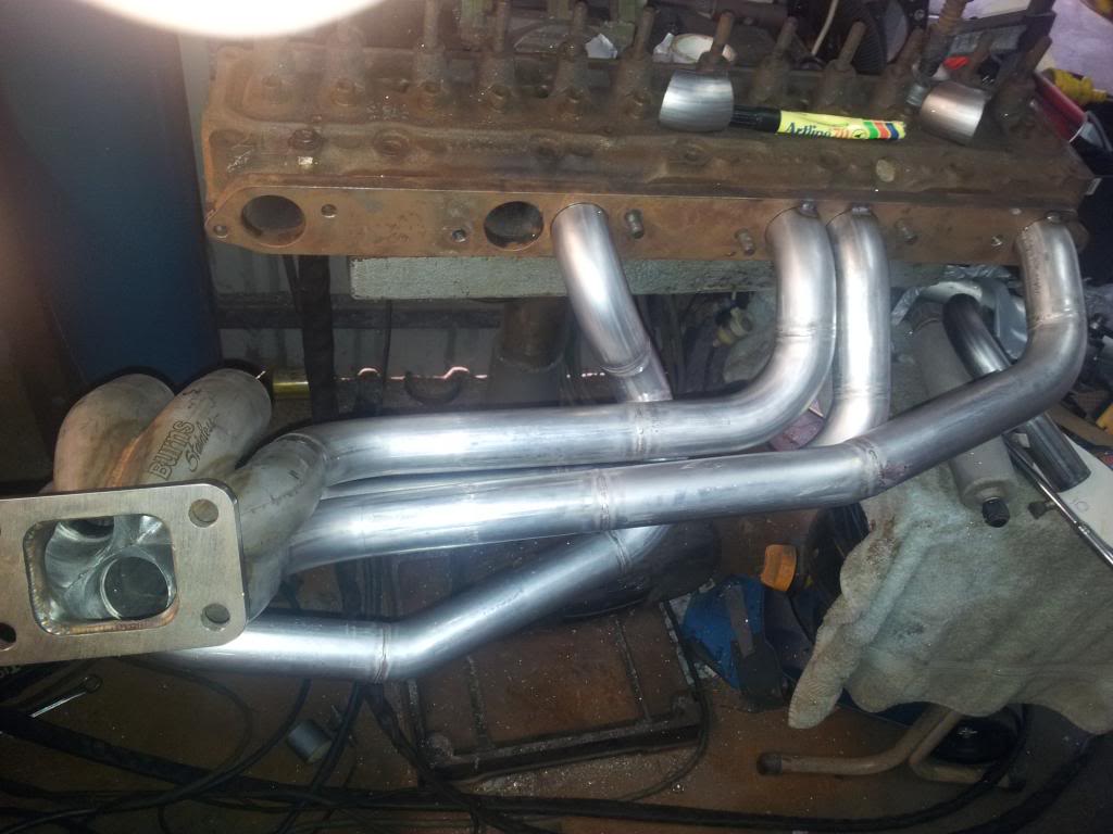

re-routed pipe on pot 4 and welded it,now im out of bends. I did get an a1000 pump off haydens uncle yesterday so i can finish the fuel system.
#117 _LS1 Hatch_
_LS1 Hatch_
Posted 06 January 2013 - 03:21 PM
Just spotto the Burns Stainless setup....I've been there a couple times, good guys and know thier stuff !

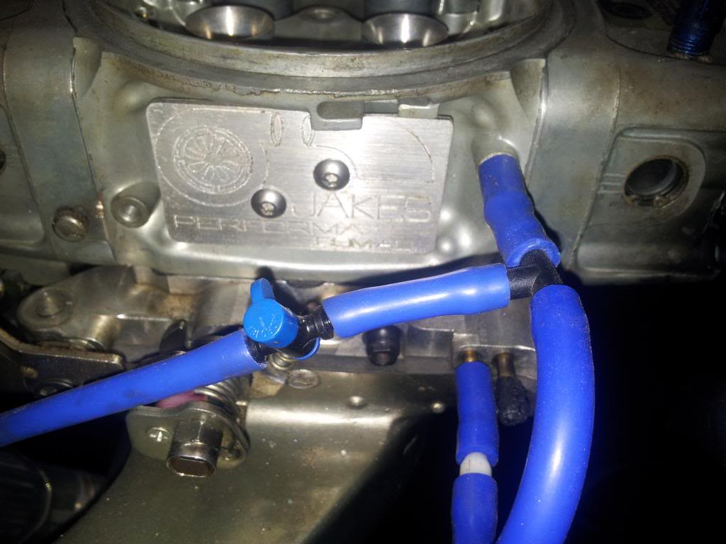

Is that big loop of -4 for the nitrous?
#122 _runna_202_
_runna_202_
Posted 06 January 2013 - 06:58 PM
correct bomber it is for gas. its was for when i had the gt 42r that i sold you. the new 35/40 makes boost on the footbrake so its not needed. But its all hooked up so u never know.lol hows your rocket going. you got the e85 happening?

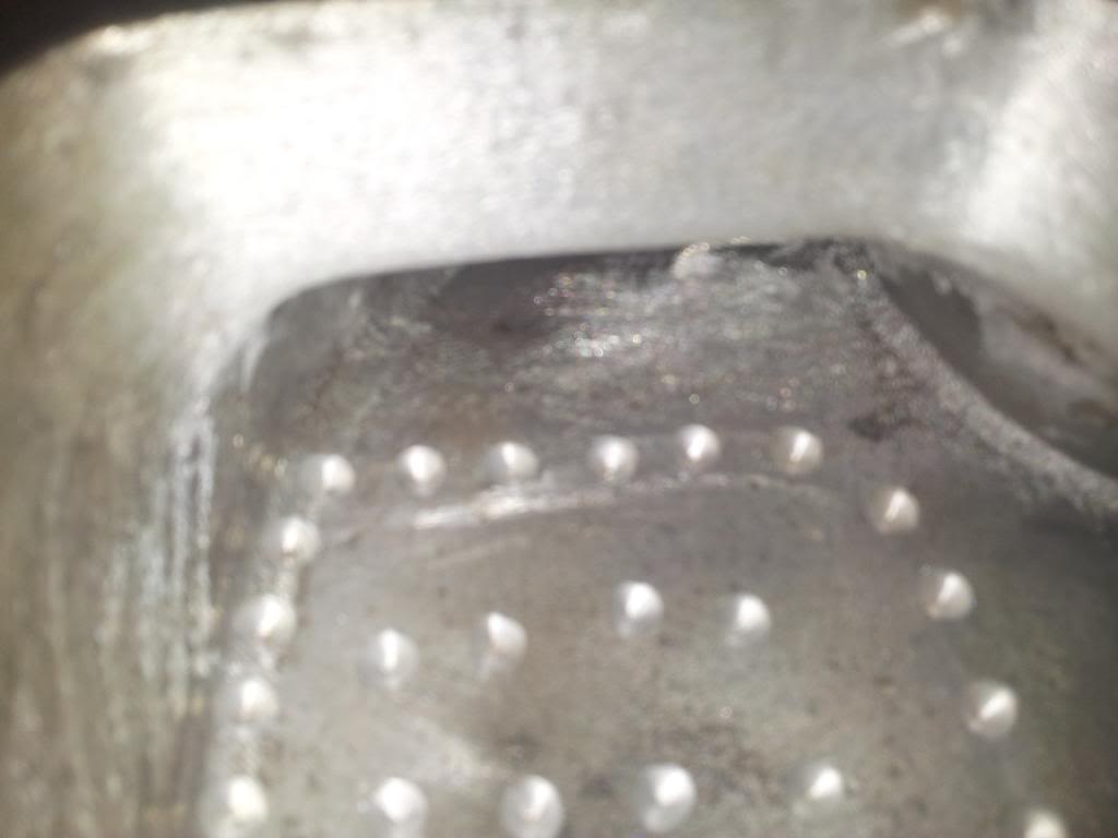

How much timing were you running on 14psi? Solid cam? BTW what are all the holes half drilled in?
#125 _runna_202_
_runna_202_
Posted 07 January 2013 - 02:44 PM
timimg was around 25 deg from memory. yeah mate a custom solid that crow done that worked a treat. the holes are in the floor of the intake manifold. cheers peter
