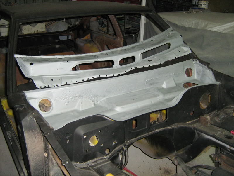

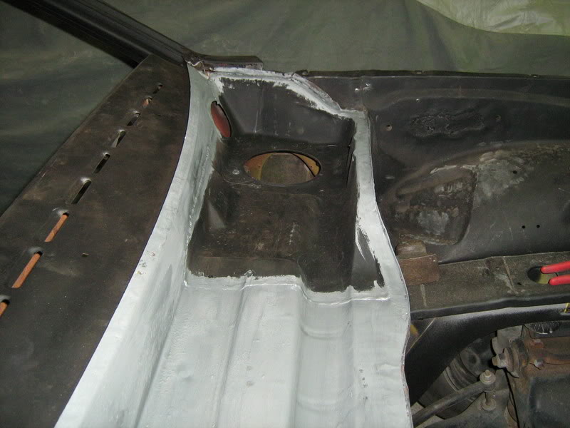

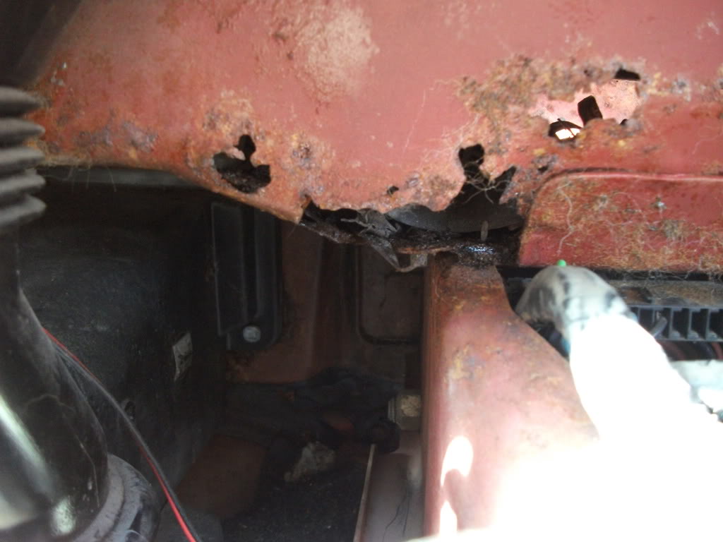

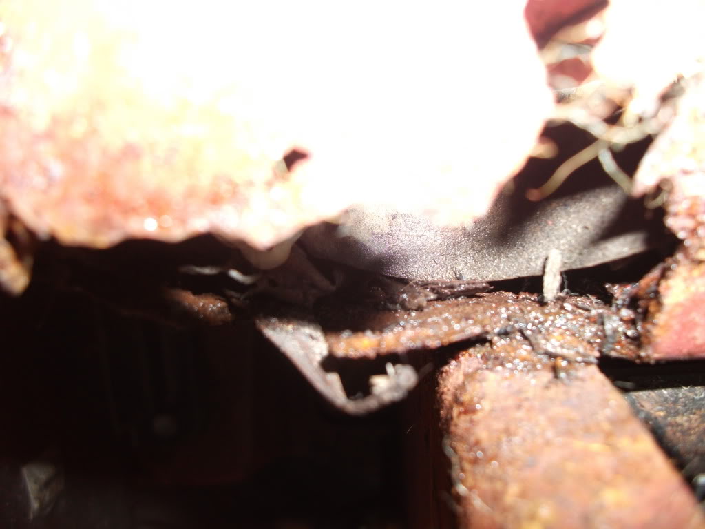

Matey, this is an LX, and is the plenum chamber, but with the top section unpicked.
Gives you an idea of what is going on down there. Stupid bloody design not being able
to get to it eh!?
This is LX5008's SS, and he is using a UC donor panel in there.
I've just discovered a lot of rust on my driver's side, and will do the unpicking job,
even though it wasnt really in my initial plans. But its the ONLY way to ensure no water leakage.
The 'coconut hair' hides all......
If you dont want to do all that, may I suggest you remove the lot. The whole dash. Its an easy job.
You wont lose much blood, just a bit when unclipping the speedo. Oh and its great when you're all contorted
and trying not to cut yourself on razor sharp rust, and a huntsman runs out at you up your arm. Aaaaaaahhhhh!!!!!
