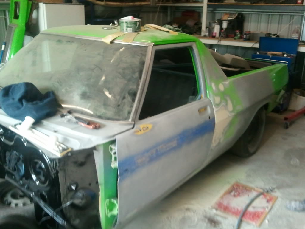

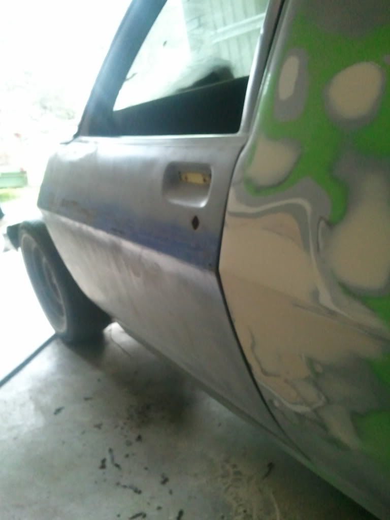

Posted 26 June 2011 - 11:29 PM
As requested, some progress pictures
door all aligned up,
just rio filled the mirror holes and trim holes,
alot less bog in the rear quarter now the quarter actually has a shape
big thanks to my uncle jay who did that, the best bloke out
will be hitting it with primer tomorrow and put all main components in ie glass than paint the inners on the weekend
#265 _Quagmire_
Posted 27 June 2011 - 03:19 AM
either that door needs to be raised an inch or your uncle got the body line on the 1/4 wrong
as i got it to line up with the old door
looks out to me in those photos m8t
#266 _Woodsy_
_Woodsy_
Posted 27 June 2011 - 08:01 AM
That stands out like dogs balls
#267 dattoman
Posted 27 June 2011 - 09:24 AM
Slap abit of puke green on... she be right
#268 _gen3torrie_
_gen3torrie_
Posted 27 June 2011 - 12:19 PM
the door needs to be lifted a tad just looked at it then, but its got alot less bog in it now the metal was shaped it took about a weekend in total to get the metal basically straight, and chasing bog everywhere, it was a nightmare of a job, wasn't too sure were the bog was gonna stop but im glad it stopped were it did

From the pic, it is clear there is an issue with alignment.
Better that people point it now rather than after you've painted the thing don't you think?

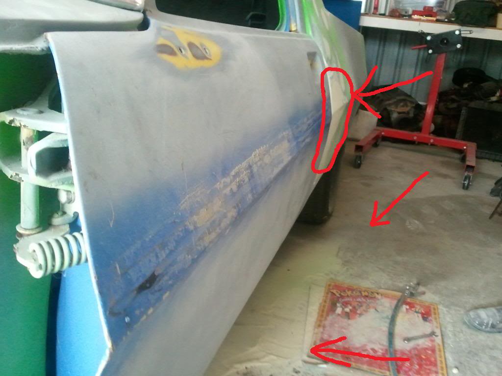

i wouldnt be to concerned about the door being out just yet but what is a worry is in this pic.............
that looks like a awful lot of bog thats been jammed in there, there is about an inch deep of bog dust on the floor :DOH:
