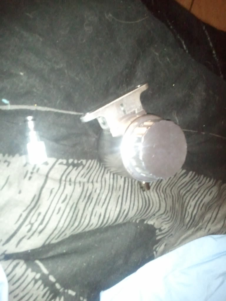

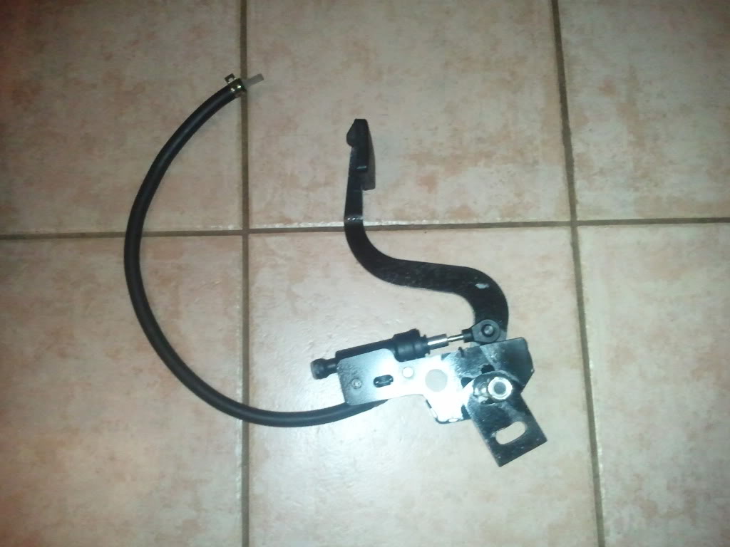

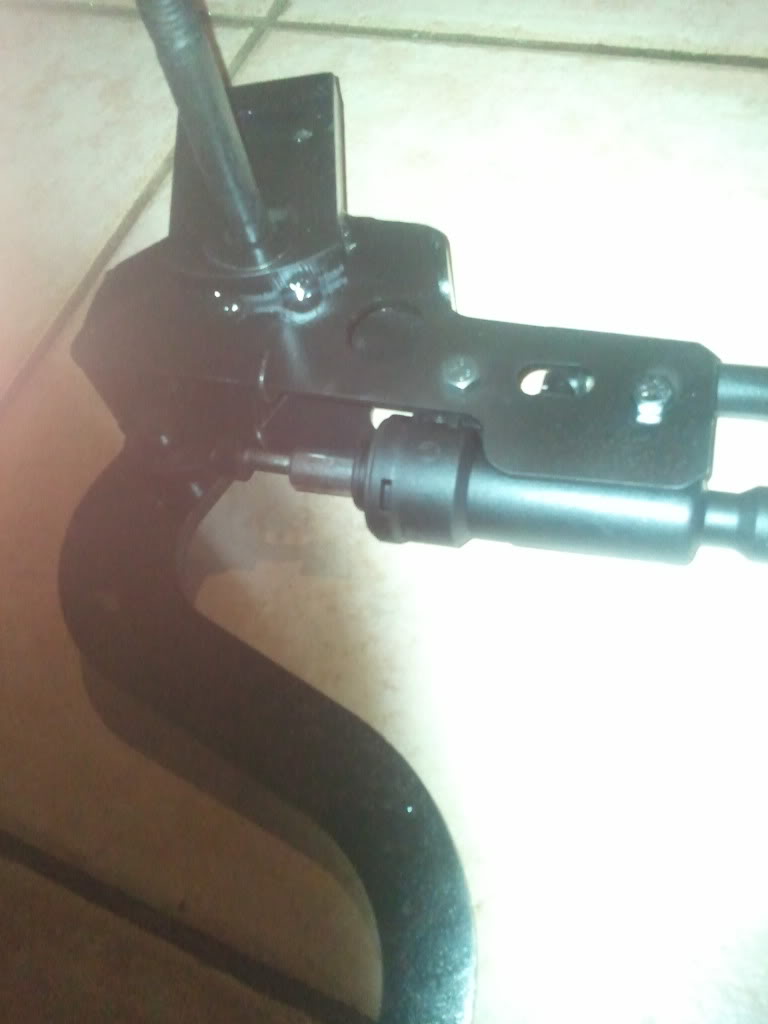

Well got a nice box of goodies today :) fresh from mal wood, for an awesome price
hydraulic under dash system with pedal to suit HQ-WB Getrag 290 using a BF XR8 Master Cylinder
even came with a nice polished container
