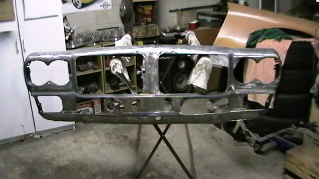

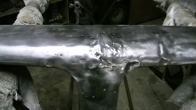

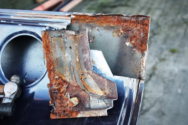

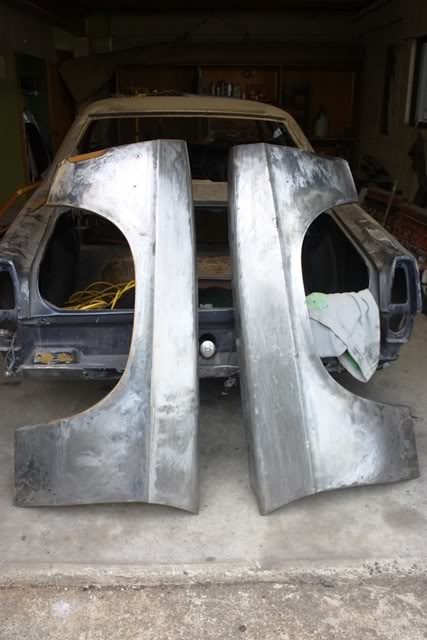

Finished up the guards, gave em a beat and a file, now stripped the nose cone (well most of it)
Found a few bits of rust for good measure

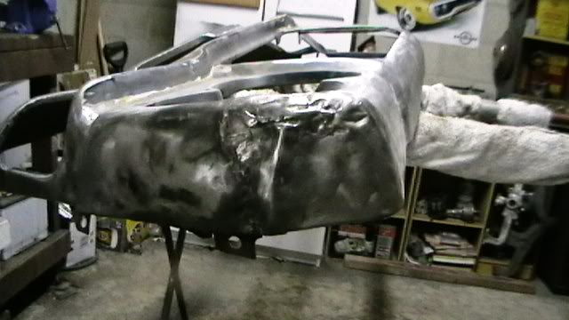

By the looks of things this has been involved in a bit of an accident, pretty bad dent (lots of creases in the metal) which has been bashed out and filled with bog.
But never fear, here I am about half way through the repair

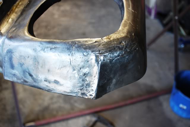

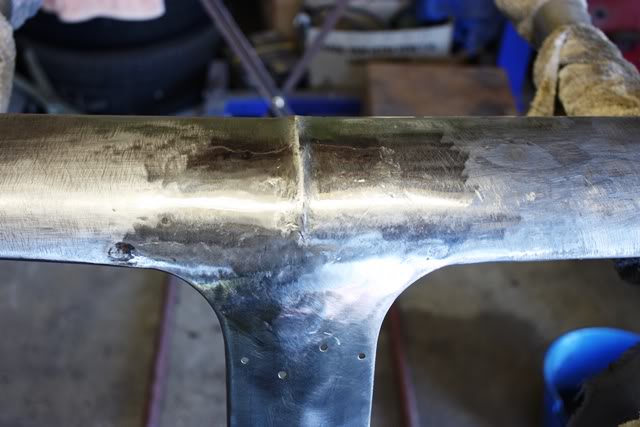

And this is pretty much finished. Someone previously has moved the bags from the top of the cone to lower down, I liked the look so I welded up the left over holes (rather than have them plugged with bog)

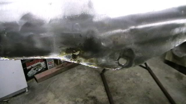

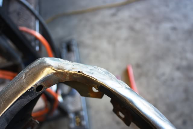

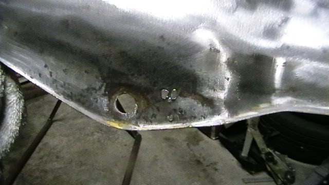

Passenger side corner is even worse. Worse so there are areas where the metal is about to tear.
This is about half way through, havent gone for the final planish. I'm having to straighten up areas then weld up tears so I dont ruin the lot.

Nice work

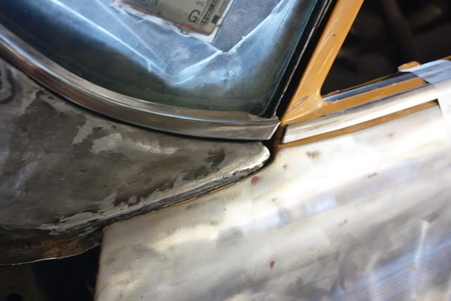

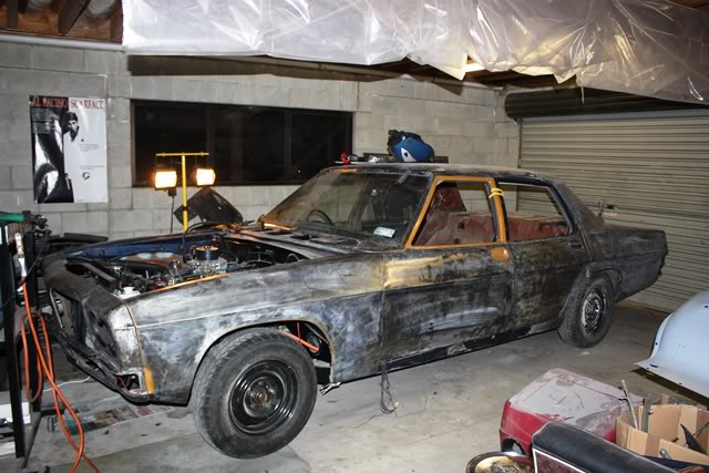

Mostly fixed up the nose (few pieces of rust etc.) and got it as straight as it will ever be. Today was a public holiday and I needed some cheering up so I the idea to hang some panels crossed my mind...
The corner isnt too bad (at least it's the best I can get it so far. I'm afraid that if I try and planish it too far that I'll ruin it since there are some areas which are quite heavily folded. Might just have to accept a bit of filler in this region.
Plan is to sort the gaps, figure out the bits that need cut and welded, then pull the hole lot to pieces, strip the hard to get places then crack out the dollys and panel file.

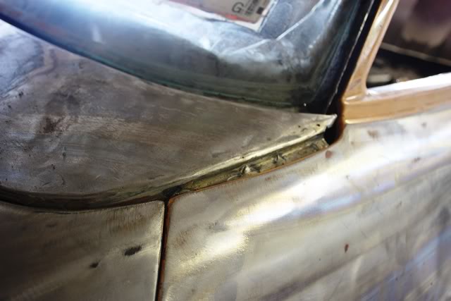

In the back of my mind I had the thought that the cowls weren't right, it was the first area I attempted to fix and I was a bit 'green' at the ol' panel beating at the time. Coupled with the fact that the patch panels I bout were rubbish the result is less than pleasing...
I mean I am only human after all...

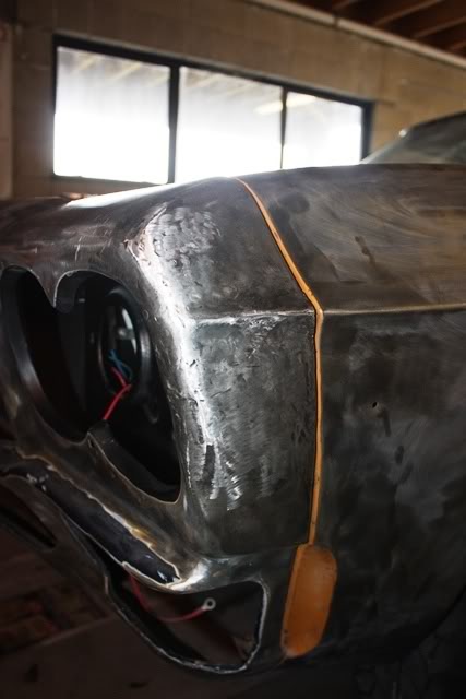

So I lined everything up surrounding the region (i.e. glass,door, guard and chrome) and got to fixing it properly. The whole lot needs to be pulled down and slightly widened.
And this where we're at as of this evening.
Peace out...

Take a look at the gaps at the top front of the doors on some other cars and you won't feel so bad. I won't discourage you on fixing them though, one of those details that can really make all the difference because you know its there...

Spose you're right, every time one of my mates say "wow cool old (HQ, valiant, XY etc) I immediately look at the gaps and see how much work has gone into them. Ran into a whole line of classics at the Waikaka pub with all new paint jobs and barely any of the panels lined up. Incidentally it sounds like this is one of the areas that seems to never gap up right with HQs so I want to put some time into it.

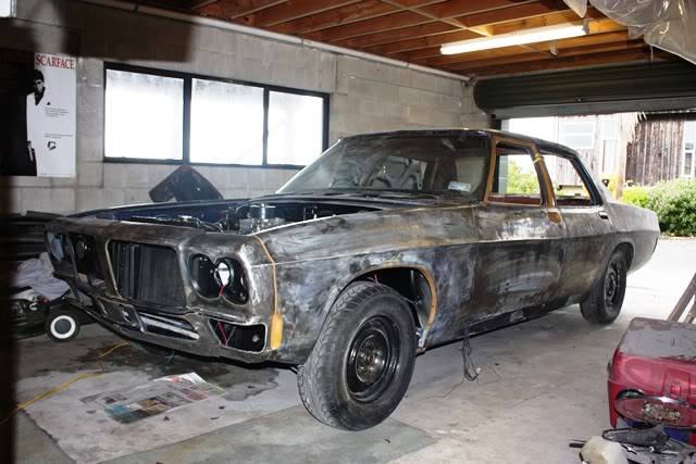

Posted 26 March 2011 - 02:42 PM
Well I hope to try and get mine better than how it was
Not too much action this week, have the cowl panels to pretty much where I want them (or as good as I can get it
Been fixing the gaps round the front end (just a gentle 'massaging' of the panels) but have a feeling my radiation support panel (and consequently the entire front end) is way too low. I reused the rubber spacers that attach to the subframe and have a feeling they are a little squashed. Really didn't want to have to buy new ones since they seem rather pricey to me, oh well, keeping on truckin...

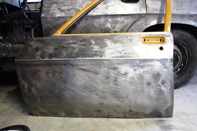

Posted 03 April 2011 - 02:49 PM
Haven't been able to spend much time on it this week but this is what we've accomplished since last time.
Two guards, file finish (give or take)
And about halfway through straightening this door

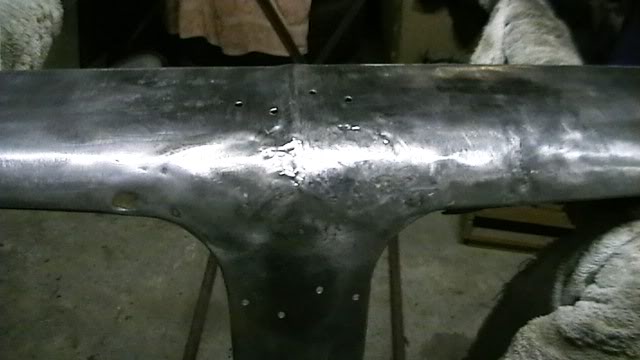

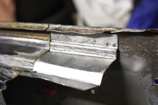

Posted 09 April 2011 - 06:23 PM
And I thought it couldnt't get any worse...
There was a solid INCH of filler over this repair, whoever did it has gone to alot of effort to hind their handywork (as with every other bloody repair)
Least I know I can make the profiles for the inner frame
Going to have to replace the skin in the corner too, and just when I thought I was getting somewhere...
