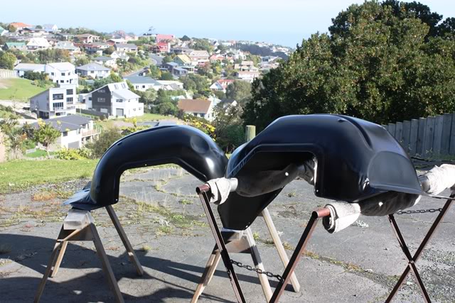

Just to confirm that I am quite possibly the worse painter in the world, I finally got some colour on these things. Beautiful day here in Dunedin.
#152 _Bomber Watson_
Posted 10 April 2011 - 02:55 PM
Dont look to bad from over here??
Gloss would have been nice though :P
Just remember for next time that the shine goes on the outside of the paint not the inside.
:tease:

#153 _nzstato_
_nzstato_
Posted 10 April 2011 - 03:13 PM
Good from afar but far from good, but I'm a pedantic lil bugger anyway.
Rightoh, next time I'll paint it from the inside out, not the outside in :lol:
Didn't want gloss, my grubby mits would ruin it. Next project will be the one where I really learn how to spray.

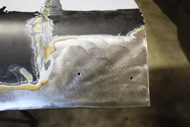

More panelbeating over the long weekend....

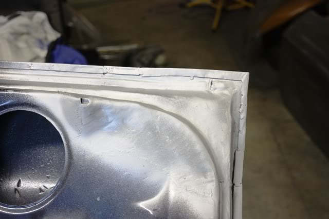

Finally got the nosecone to a presentable state, I refuse to touch it anymore!

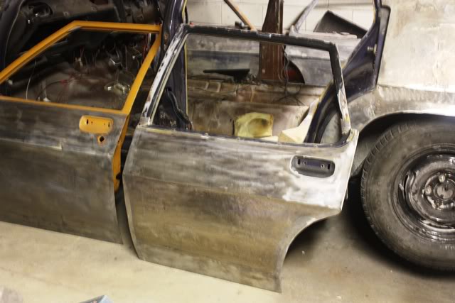

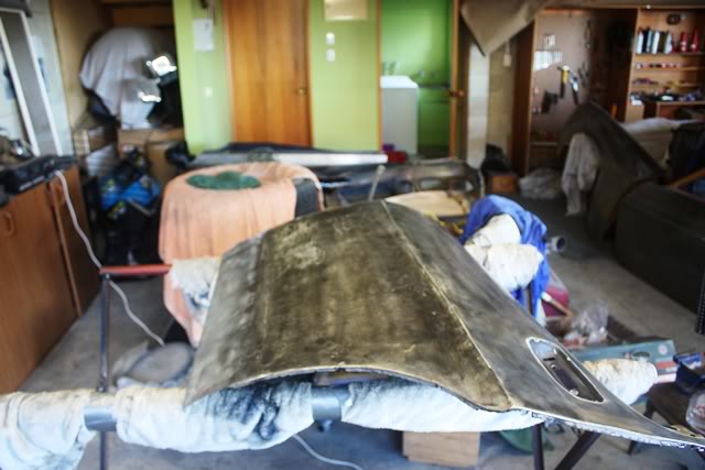

One of the rear doors is almost a write off (full of dents). I've pulled it off the skin to beat it out and fix up some problem areas, the jury is still out if I am able to save this (it's half done in the photo).
Though our cause is helped somewhat by the new toy, shrinking discs rule...

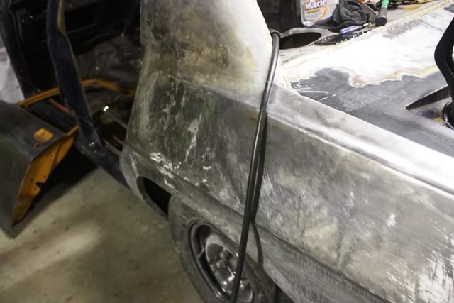

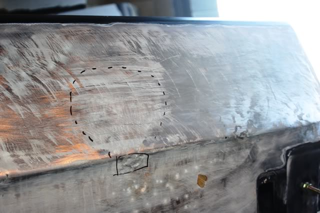

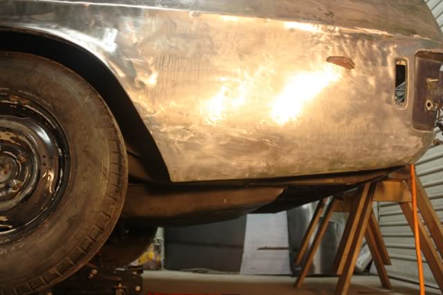

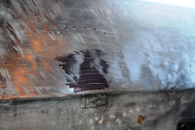

Also got on to the rear quarters, this is an example of what I'm dealing with. Previous person welding up the trim holes far too hot which has distorted and pulled the panel in to form a low spot
If you lose where you are with highs a lows, one way to get the constrast back is to cover the metal with perminant marker...
Top of the quarter is as good as I can get it...

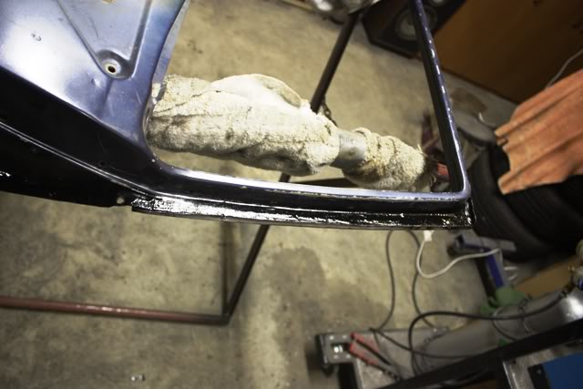

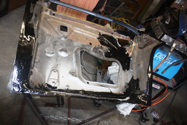

Also pulled the skin back from the top of the door as you could see a whole lot of rust hiding below, wire brush and POR15 dealt to that
#163 _LH SLR 3300_
_LH SLR 3300_
Posted 26 April 2011 - 07:13 PM
Excellent workmanship!! I like the permanent marker guide tip, haven't thought of that one myself, i use flat black in a spray gun but your method is a good one. Great work removing the door skins & folding back the flanges to deal with rust tracking behind them, you must have alot of paitence to do this type of repair. I'm sure alot of people on this forum will gain from your skill & knowledge. Well done!
#164 _nzstato_
_nzstato_
Posted 26 April 2011 - 07:34 PM
Thanks, appreciate it since sometimes it looks to me like I'm not really getting anywhere but I spose I am.
Marker pen wasn't my idea, picked it up from another instructional dvd. It's great when dealing with small areas and the best thing is that it dries straight away, unlike the paint. I need to get some of the marker pens with the really wide nibs.
Removing the skin wasn't too back, just drilled out the spot welds and peeled everything back with a screwdriver then tidyed the edges up with a panel hammer and a toe dolly.

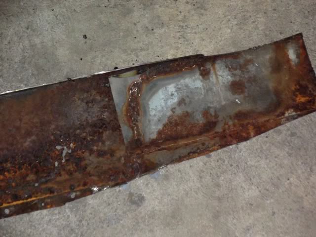

Re did one of the repairs in the lower 1/4, purely because I wasn't happy with it. Final result is pretty good and will need way less filler than what was there, plus the welding is alot better.
POR15 the inner of the door frame

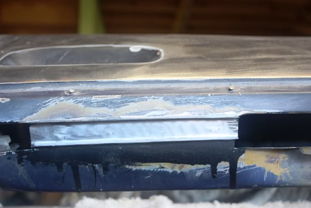

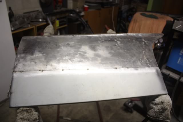

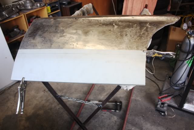

Also, back to the door skin I'm fixing. Decided the lower half of it was just too dented/ripped/rotten to warrent repairing. So in typical fashion I took a lower skin for a HQ front door I had sitting around and cut it up/bent up, to suit the skin. Laying it on the frame ensured it was sitting right and the ability to panelbeat it properly off the frame is a good way to ensure the steel is close to perfect as possible. If I had to fix a lower skin again I wouldnt hesitate to do it off the frame again.

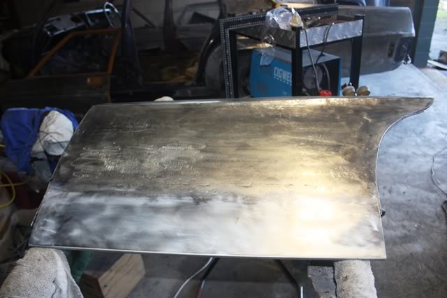

Welded up the lower section for the skin, so glad I decided to do it properly, am getting sick of this door now.
Bit more hammer, bit more dolly and a bit more shrinking disc and we have a (generally) straight skin
Chucked it back on the frame ( plenty of seem sealer) and fixed up a few more bits...
Very happy to have this done, like the nosecone, I'm leaving it the hell alone!

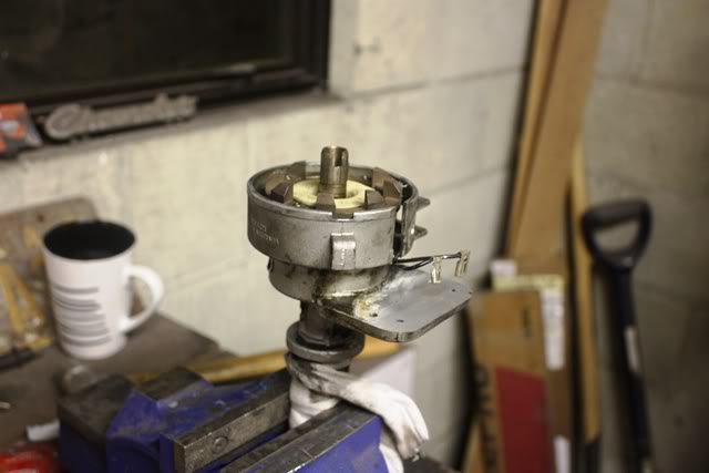

Pick up another one of these too (they are bloody exey over here so if they are cheap I grab em!), the shafts on this one is siezed so will require a refresh and test.

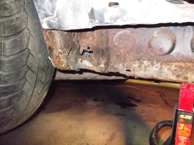

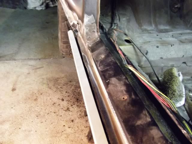

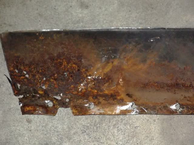

Been meaning to do this for a while, ripped the drivers side sill off
Inner isnt too bad but the outer was like swiss cheese
Some more crappy repairs
Now the question is how should I cut and weld it? Hard up close to the door frame?
Or cut halfway across the top bend of the sill (though it would need to be trimmed compared how I have it here)? I'm leading towards this idea as it will be easier to hide the repair, or should I do the former?
#170 _Bomber Watson_
Posted 27 May 2011 - 07:05 PM
Thats a very strange looking shoe.
I would usually vote right up the top as per top pick, but theres an awe full lot of variance along the length so perhaps half way would be better....
Let someone who actually knows what there belting on about answer says i.

#172 76lxhatch
Posted 28 May 2011 - 07:52 AM
I don't know either but I usually pick the spot that is easiest to dress afterwards, gives more room for error and fix ups without affecting the end result.

#174 _LH SLR 3300_
_LH SLR 3300_
Posted 28 May 2011 - 04:30 PM
If you're going to butt weld the sill, personally i'd join it as close as possible to the step. Reason being is the folded step has more strength & is less likely to distort whereas half way it can distort creating an uneven surface requiring varying thickness of filler to get straight. A metre rule or similar straight edge will be handy when doing this repair.I recently fitted both sill panels including inners to an XW GT at work & i fitted & gapped up all four doors & more or less left them on when fitting the outer sills to make sure the gap between the base of the doors & top of the sills was even, exactly 6mm the whole length. I also trial fitted the guards to make sure the gap to the leading edge of the sill was the same both sides. Alot of stuffing around but the owner is paying big $ so understandably he is very fussy add to which the car will be painted gloss black so everything has to be spot on.
#175 _nzstato_
_nzstato_
Posted 28 May 2011 - 04:49 PM
^ This was the answer I was needing (I was hoping you'd chip in). I think I'll slice the existing sill to give it a very slight edge (which I will bend down) to rest the new sill on and weld straight, was going to hang the doors too (that's why I wanted them finished first) but hadnt considered the front guard, best I do that too. Cheers for that, your build is looking good too
