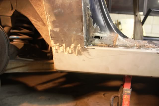

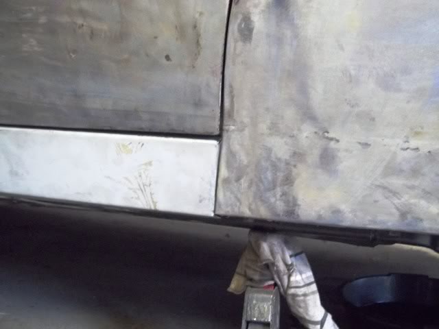

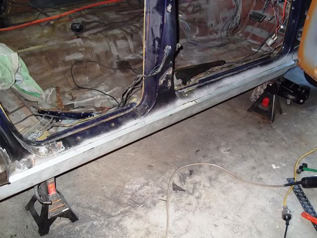

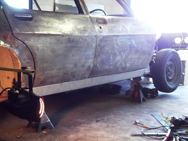

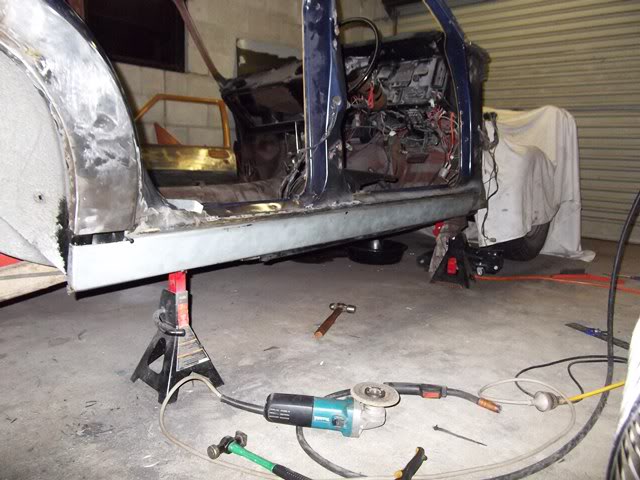

Sorry that there aren't many photos with this but I accidentally deleted a lot off my camera, bugger.

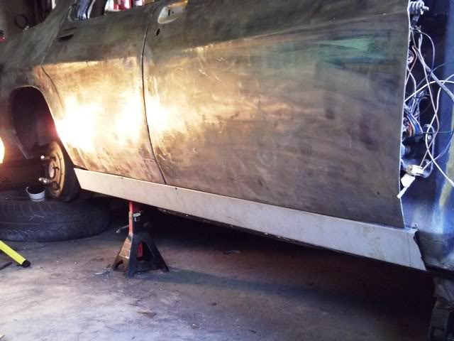

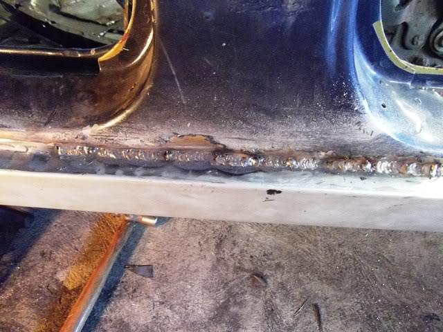

Decided to go about replacing the sill properly. The rear internal braces all needed new metal and all of the internal cavity has been painted with POR15, should keep the tinworm at bay.
I hung the doors again to ensure my gap was even all the way across.
I had left a small 'lip' from the old sill so I could rest the new section on, also made it possible to screw the new section in and hold it straight as I welded it.
This area isn't crucial to get right (chrome strip goes over it), this is close to finished.
Welded it in fairly slowly but ensured the weld was plenty hot. Welding two panels in a 't' arrangement is a pain in the arse but lots of little 'c's get the best result.
Finished result isnt too bad, hasn't warped at all (thank goodness) and was able to hide most of the welds by grinding it back. A small amount of filler where it has slightly undercut in places will be all thats needed. Just a small section near the dogleg will finish it off.

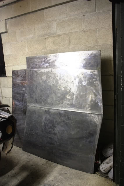

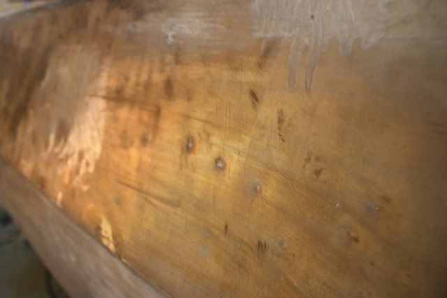

Stripped the boot and the bonnet (only panel on the car not to have rust/repairs)

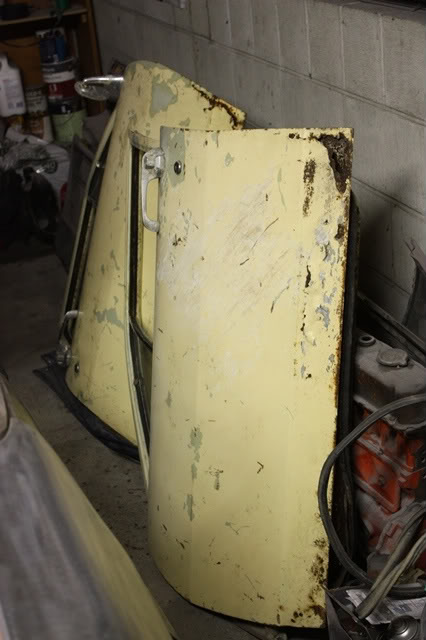

Had some more panels follow me home, HT kingswood anyone?
Still haven't fixed this area and the guy I was relying on for the section might fall through, anyone had a go at fixing this from scratch?

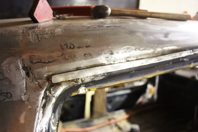

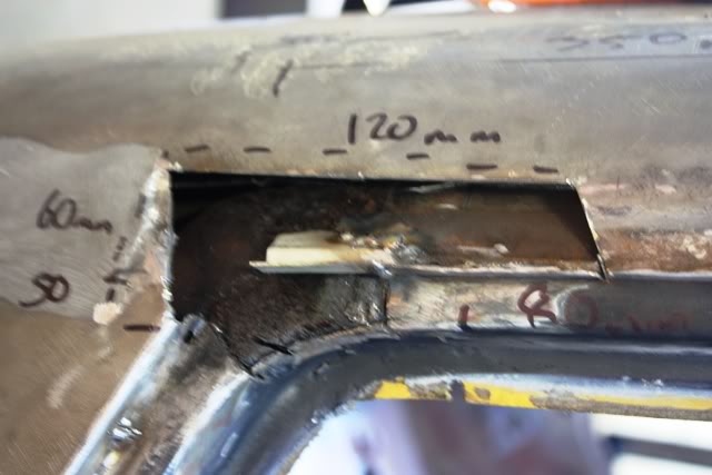

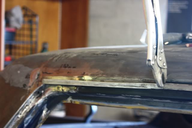

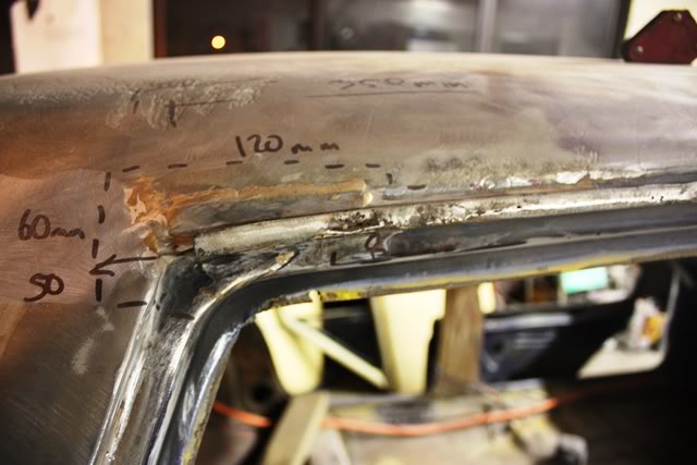

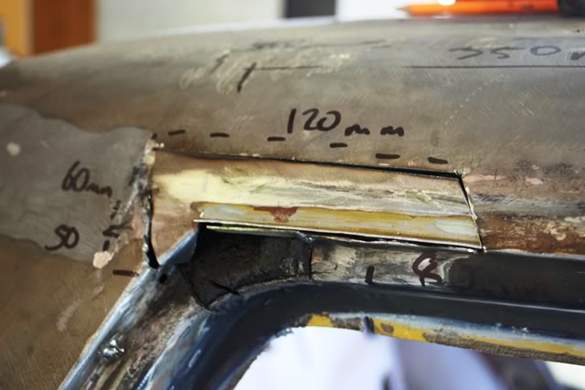

Decided to fix the corner of the roof from scratch, was not looking forward to this
Was able to bend a bit up which followed the lines quite well
Made a section of gutter and welded that up
Rather impressed how this turned out. Had to melt out some of the lead so will fill that with reinforced filler.
This is the last job before I spray it with epoxy, fix this bloody 1/4. If I could I would replace the whole thing, but I'm not, least the shrinking disc makes the job a little bit easier.

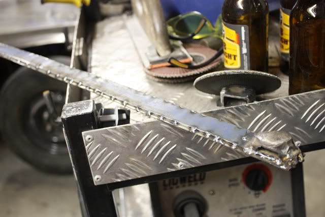

And because it is near on impossible to get a regular dolly in behind parts of the quarter I fabbed up this. Half the head of a hammer welded onto two bits of 3mm steel (didnt have anything thicker)

Took a page out of the dodgy bros engineering book... plus i got the metal from slicing a section of RHS lengthways.

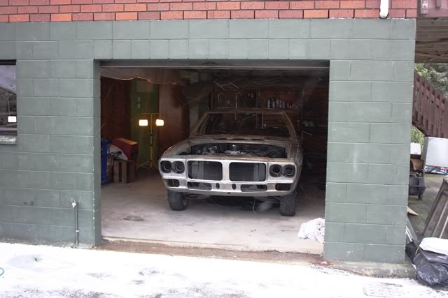

Posted 24 July 2011 - 04:38 PM

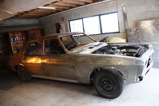

Had a chance to clean up the shed (it needed it) and rehang the panels, some members of our car club came round yesterday so needed to have it presentable
Had a really cold snap today which didnt make working in the shed alot of fun, next shed will definately have a pot belly stove in it. Have been spending most of my time trying to get these 1/4s straight. Not very interesting photo-wise but I thought I'd let you know what I'm up to. Going to order some epoxy this week so should have some stuff painted next week
