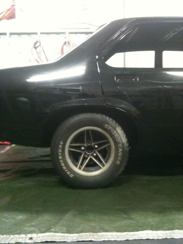

Should be right. I forgot to add that I had 21/2 inch lowered springs at back with rolled gaurds and was sweet even with people in the back.
#227 hanra
Posted 11 October 2011 - 06:33 AM
Were u running flares with 245's?
#228 _nial8r_
_nial8r_
Posted 11 October 2011 - 08:48 AM
my old LX was running 245/50/14 with only rolled gaurds and they never scrubbed on the gaurd but they did rub on the shock if i hooked in to a corner :buttrock:
#229 hanra
Posted 11 October 2011 - 10:06 AM
Cool thats handy info to have when the time comes!
#230 _LH8VD69_
_LH8VD69_
Posted 11 October 2011 - 05:41 PM
Don't forget it depends on rim offset. A 245 may fit on one type of rim but on another a 235 might be to big.
#231 _hatch76_
_hatch76_
Posted 11 October 2011 - 07:43 PM
Yeh, I had no flairs. I can't remember the off set of the rims, but can find out in need be as my mate bought them for his FJ ute.
#232 _cruiza_
_cruiza_
Posted 11 October 2011 - 07:46 PM
I ran 245 50 14 on the back of my hatch with the guards rolled standard width diff and zero offset 8in wide rim never rubbed anywhere and no issues at all looked good too even later when i fitted flares I kept the same wheels and tires fronts were 215 60s which did take a bit of work as would foul on seam on fire wall but I removed the seam and braced it on the inside

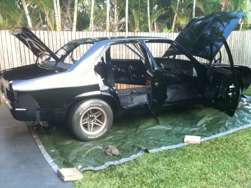

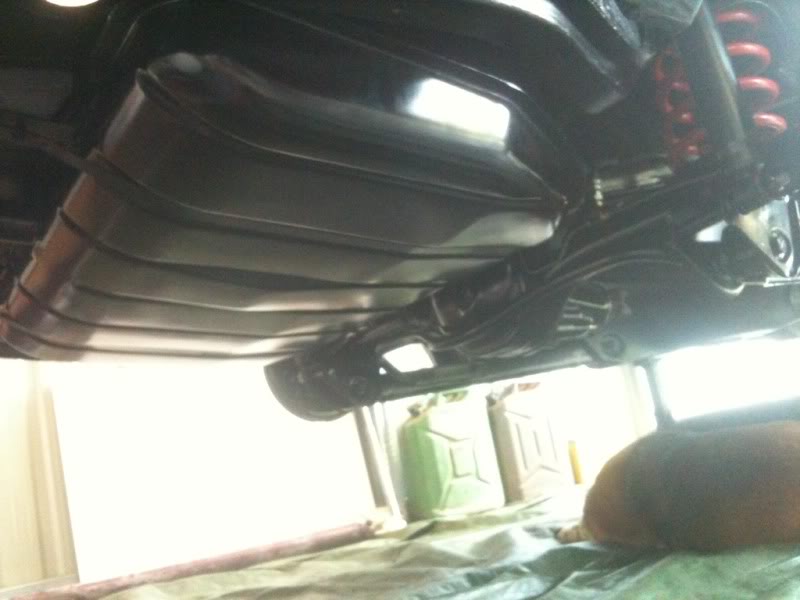

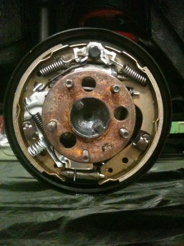

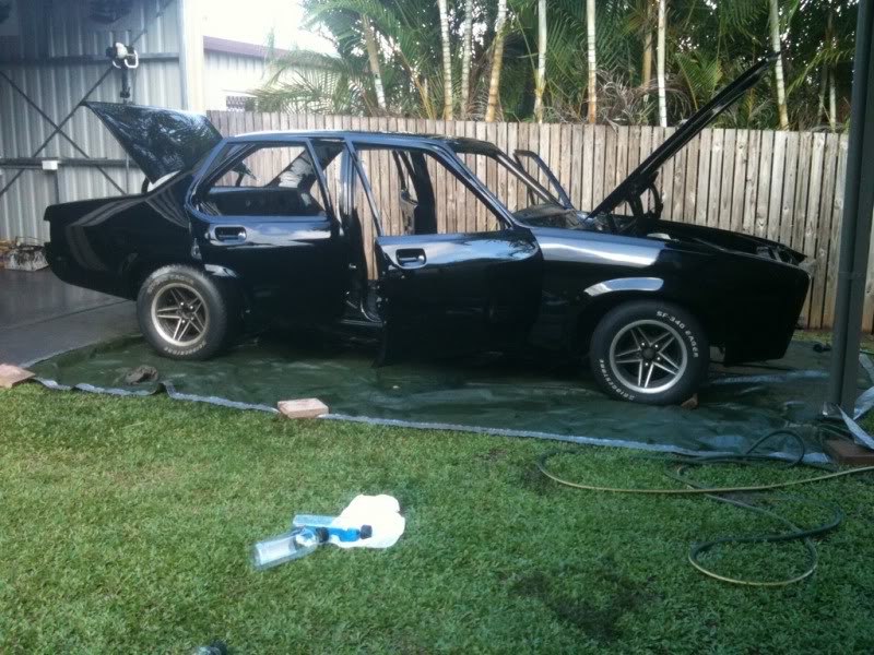

Fuel tank finally fitted up correctly. Diff in. New steel brake lines, rear brakes almost finished with. Almost time to go back on its wheels....

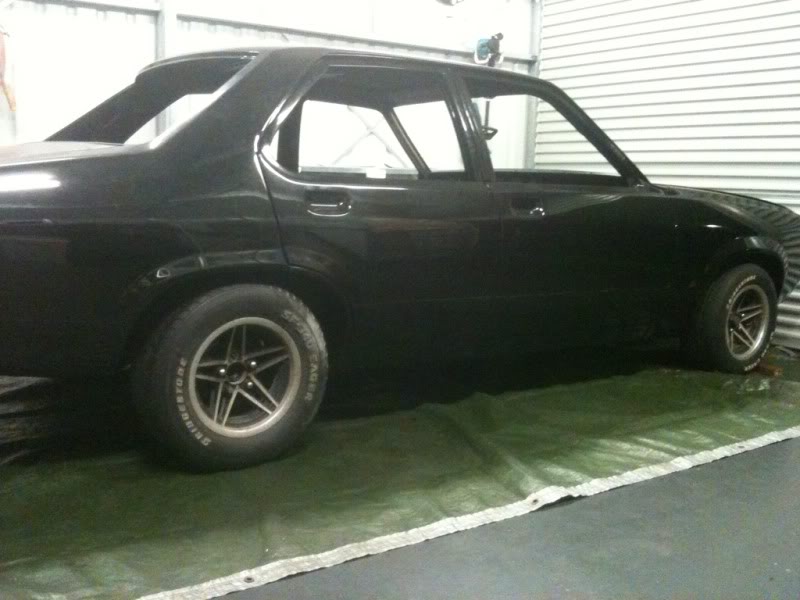

Got the rear brakes all sorted now, found all the bits. Got the wheels back on and put it on it's feet for the first time in like 4 or 5mths!!! Will give it a kero bath this weekend.

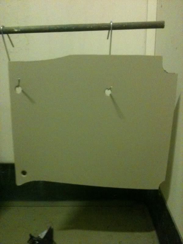

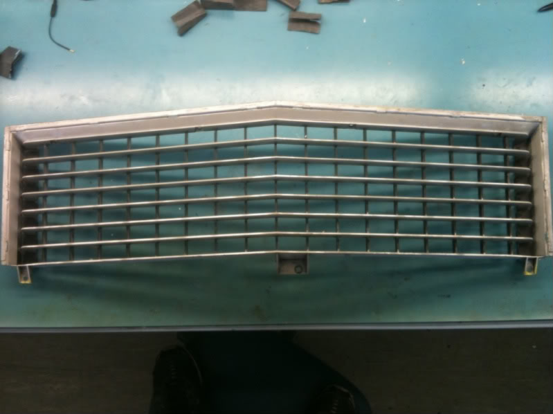

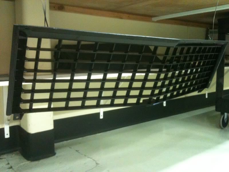

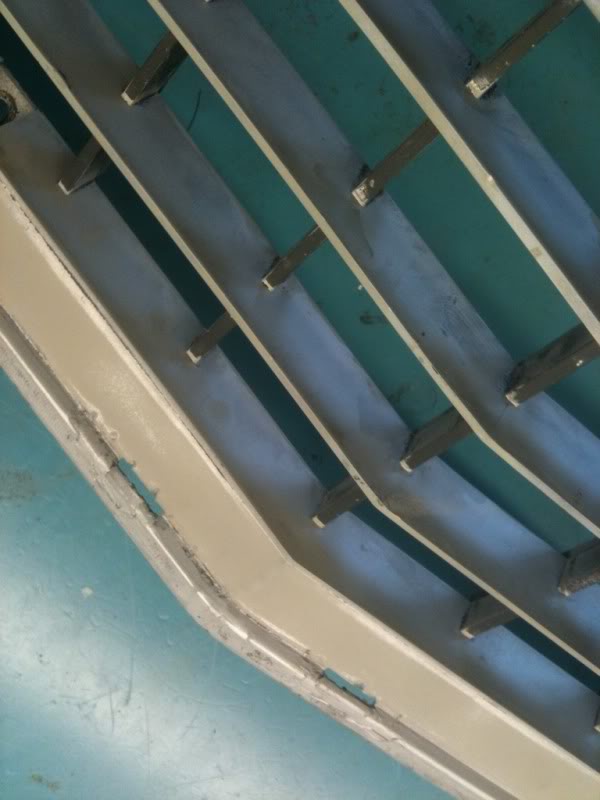

Managed to get the majority of the paint stripped off the grille using M.E.K. I finished it off using the soda blaster at work with the pressure turned down really low!!! Gave it a hit with plastic adhesion primer, then 2 pac satin!

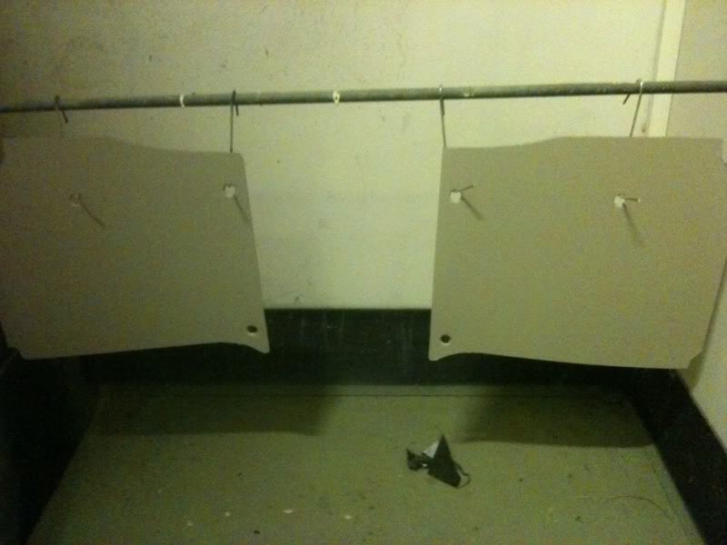

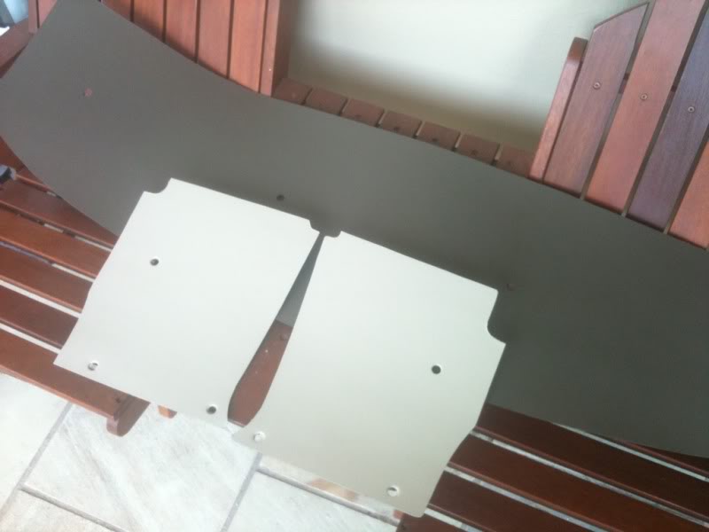

The kick panels are only available in black so I got some Chamois mixed up and gave them a hit. Still have to do my centre console this colour!
Also painted my parcel tray covert to, but dont have any pics... Its a shity poo brown colour.

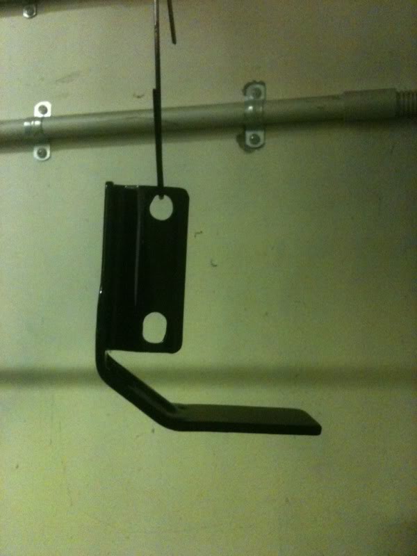

Exhaust hanger black

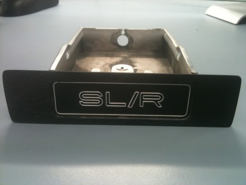

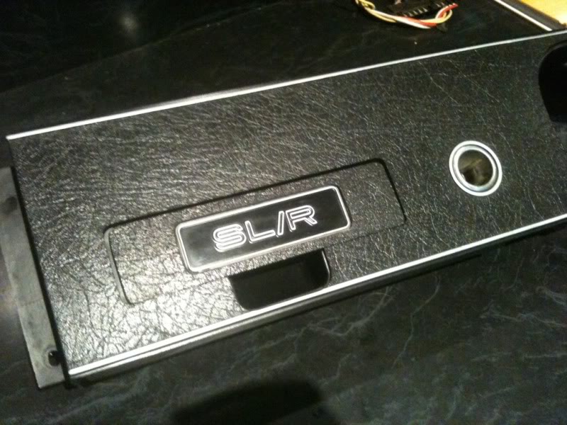

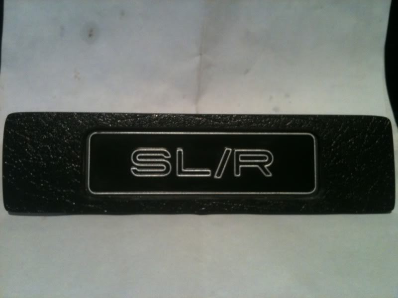

My fancy new SL/R ashtray!!!!! Saweeeeeetttt!!!

#239 _LH8VD69_
_LH8VD69_
Posted 23 October 2011 - 01:12 AM
New ashtray? Or is this one you've made look as good as new ? :)
Looking great btw
#240 hanra
Posted 23 October 2011 - 12:50 PM
Its a brand new one!!!! hehehehehe!
#241 hanra
Posted 23 October 2011 - 06:21 PM

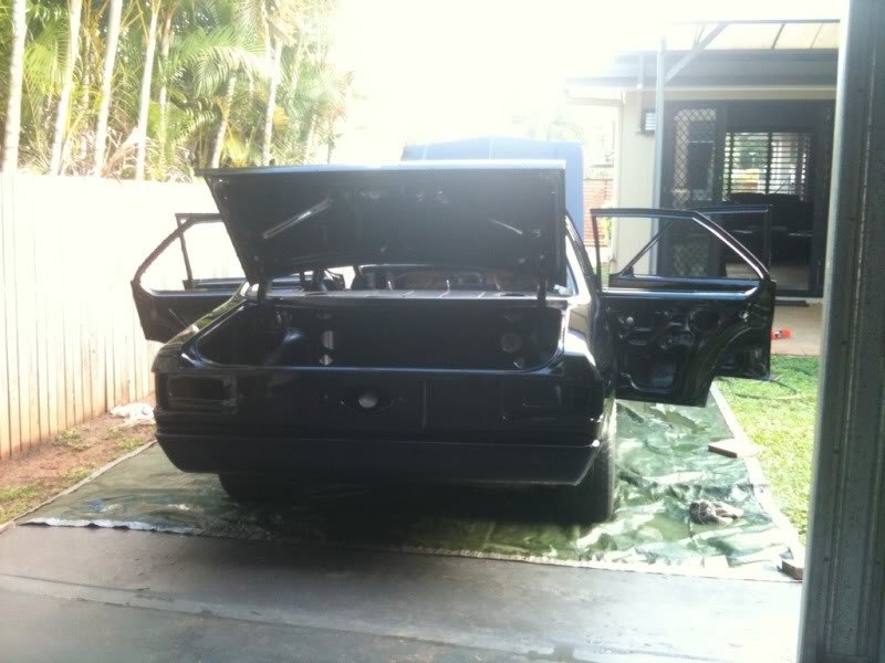

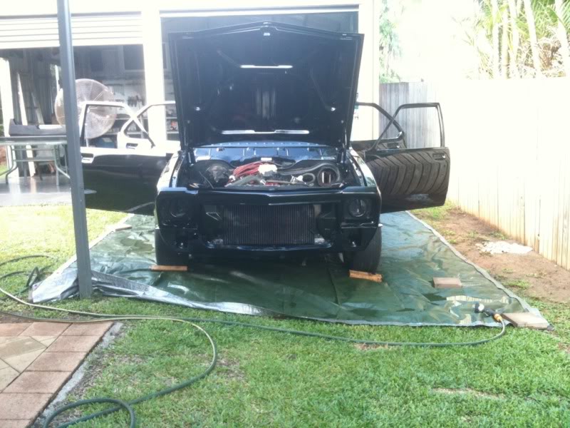

Got it wheeled outta the shed today for a bath in kerosene... Man that stuff burns ya hands after a few hours..... Now I can get to work on putting things back on instead of pulling things off...!
Is it one of those ashtray's that are made out of old dash panelling?
Hit the nail on the head mate!!! A forum member has gone far beyond.... and has helped me out tremendously and made this up for me!!!!! This was another bit of the car that was missing and I could not justify spending $1000 on a replacement.... It does the job.

#247 hanra
Posted 24 October 2011 - 08:18 AM
Im still pretty stoked with this!!! hahahahaha
#248 _LH8VD69_
_LH8VD69_
Posted 24 October 2011 - 09:29 AM
I got one off him as well. They are top notch !! :)

Posted 24 October 2011 - 05:56 PM
Some more pics of the Covert coloured parcel tray and Chamois coloured kickpanels
