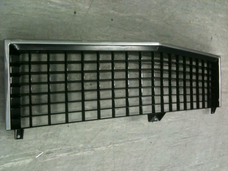

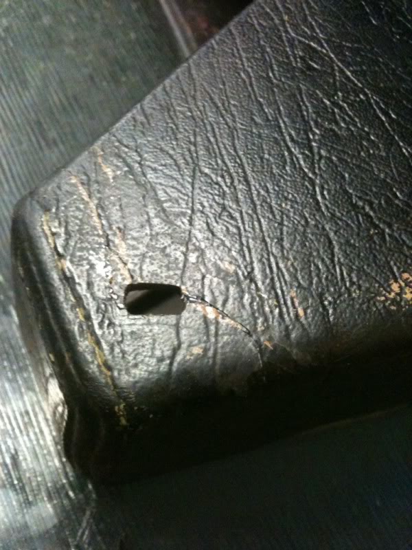

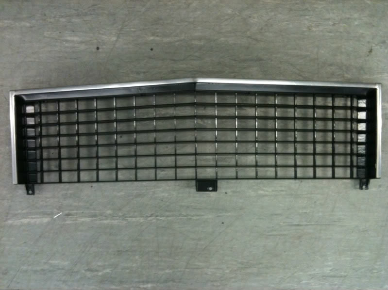

Got the grille all sorted now with some nice un dinted stainless! Had a few small dings, but I just panel beat them out.

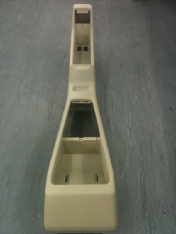

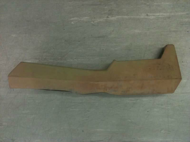

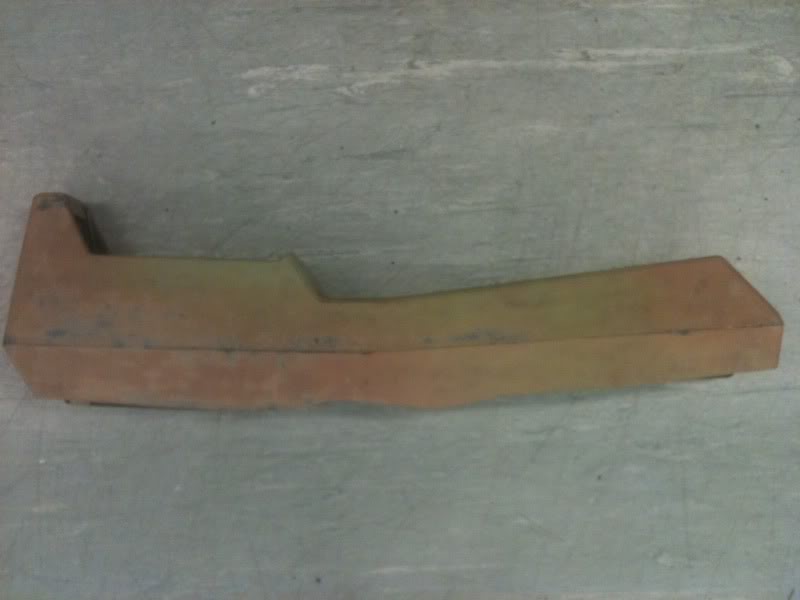

Also decided to bite the bullet and sit down and fix my centre console. Yes, its in really good nick, but had a few cracks from possibly rough treatment in transport or rough treatment in its general life....
Had a section near the arm rest that had cracked badly, enough so that a piece had actually broken off and left a small odd shaped hole in the side... The only thin to do was to make it into a normal shape, and use a piece of my old broken centre console cut to fit the hole. Ive still got to strip it back and paint it Chamois....
Ive been using loctite Tak Pak, its great for this kinda work!!!

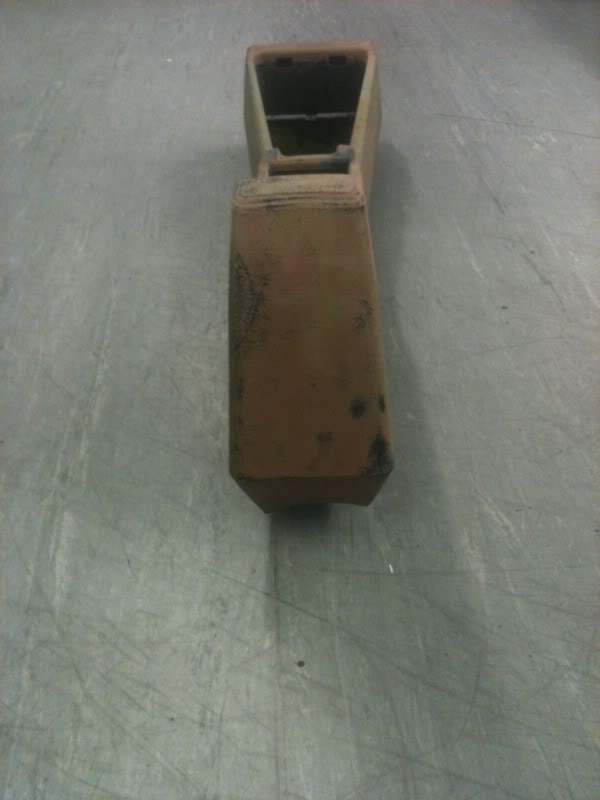

#252 hanra
Posted 01 November 2011 - 06:02 PM

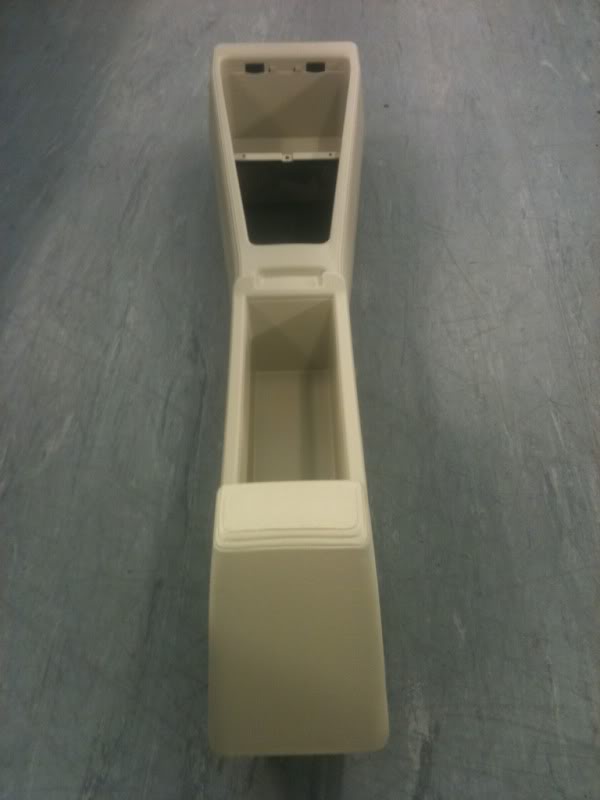

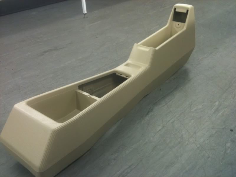

Got the centre console all repaired and then soda blasted with the pressure down really low to start off with then I dialed it up to like 40psi cause it was taking foreeeevvvverrrrr...... Didnt damage the plastic anywhere. Ive got some Chamois Acrylic for this that Ill hit it with. Im just using a pressure pack plastic adhesion primer, so hope it will be ok.
One question, should the storage bins be Chamois as well??? Or Black??? Im kinda thinking black? But I think Ill just do em Chamois... Also going to give the sunvisors and grab handles a hit with the Chamois to.

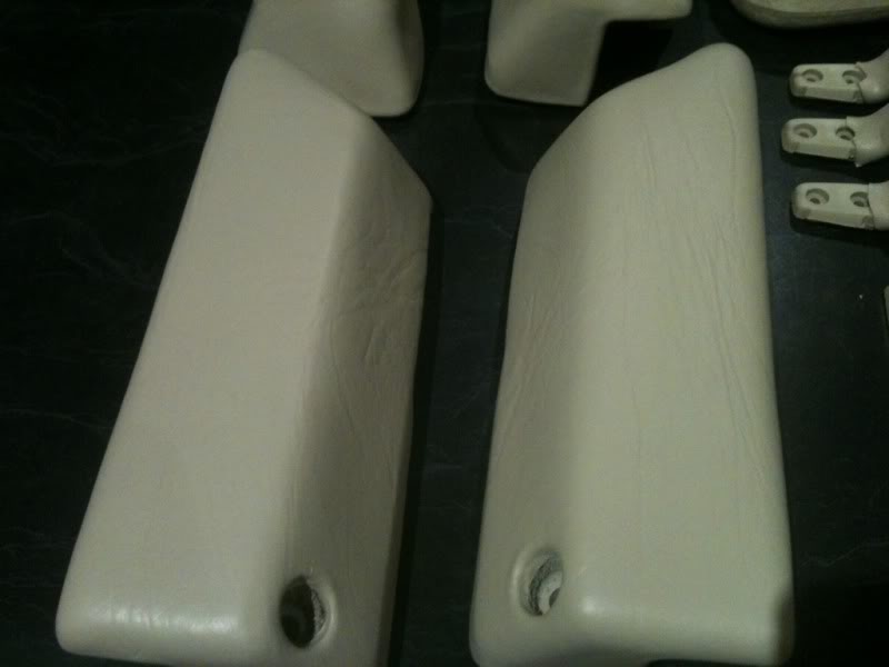

#255 hanra
Posted 02 November 2011 - 06:31 PM

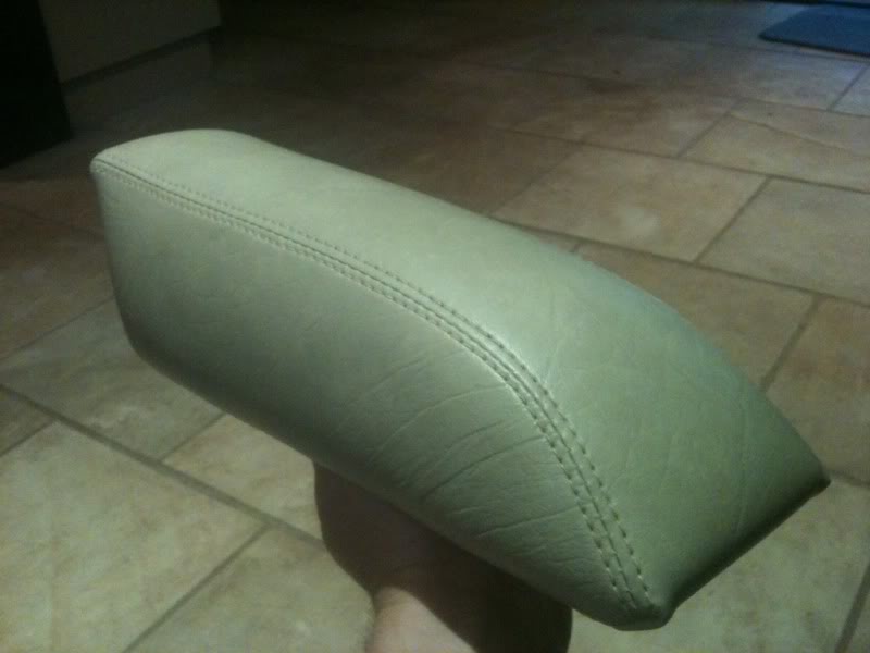

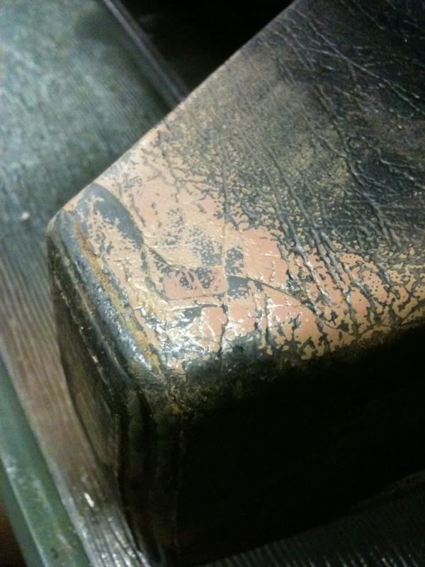

Arm rest good to go. Bought some more Chamois paint today so Ill get that console sprayed this week. Also got all my chamois door tops and pillar trims.

#258 hanra
Posted 05 November 2011 - 02:46 PM

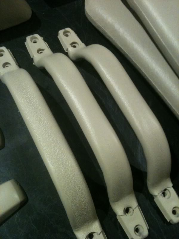

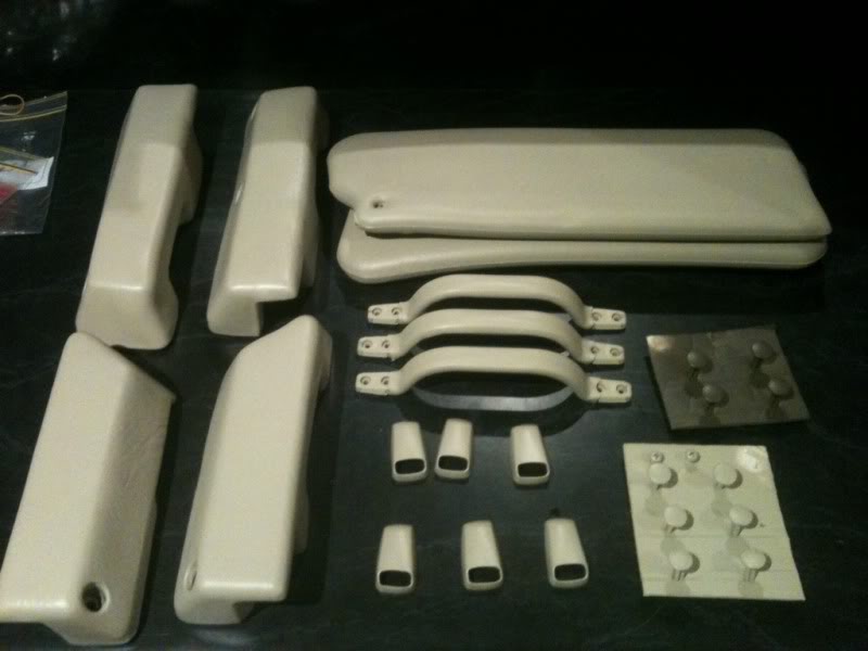

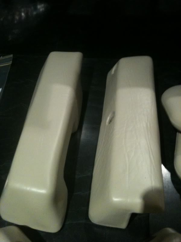

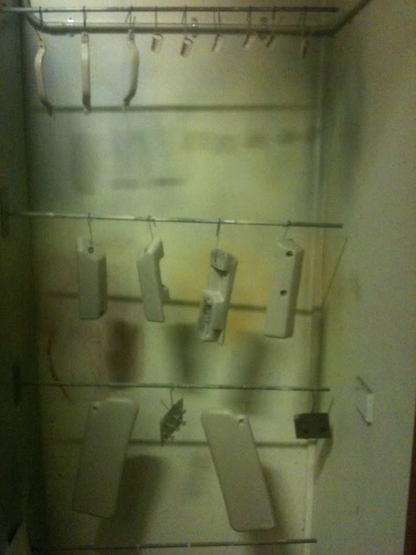

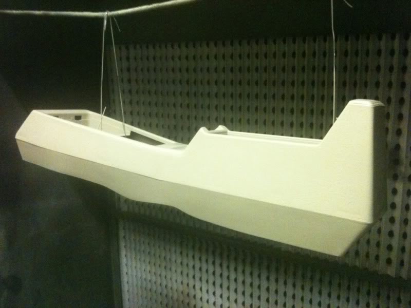

Well got all the Chamois stuff sprayed up today, armrests, grab handles, sun visors and the centre console. All come up pretty good I think. See how hard wearing it is I guess? The arm rests and sun visors were originally Chamois anyways, just a bit grubby.

yeh that console looks really good man. I'm guessing it would be prett humid up nth at the moment too? have you painted it in a booth?
#260 hanra
Posted 05 November 2011 - 10:24 PM
Its always humid up here mate. Yeah I do all my painting in a booth.

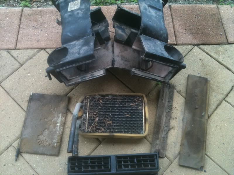

#261 hanra
Posted 06 November 2011 - 07:52 PM

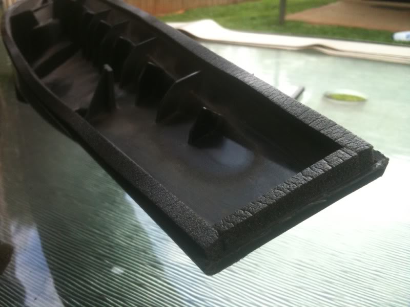

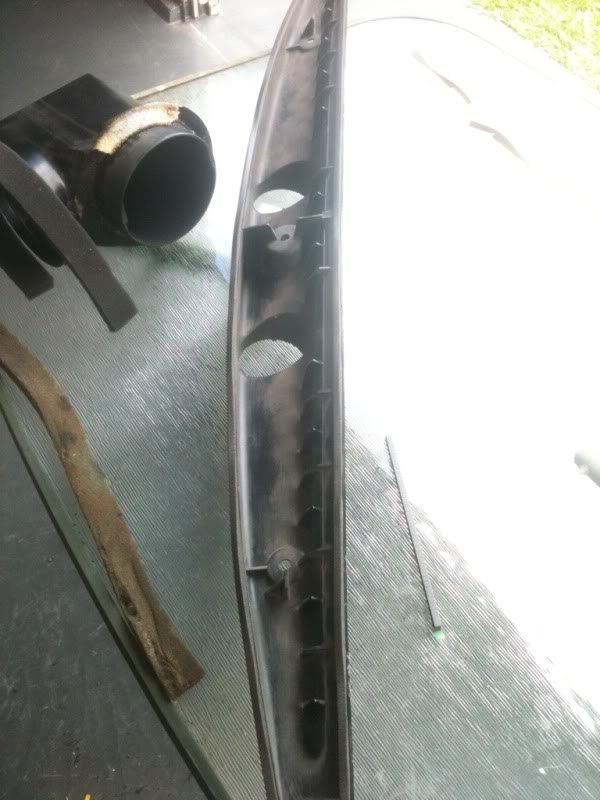

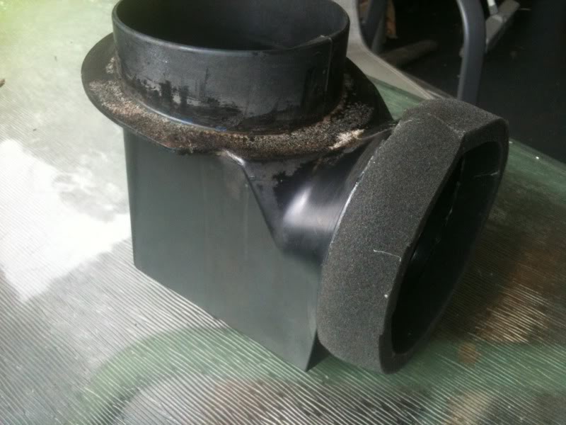

Got the heater box out, will need to replace all the foam on all the internal flaps. Ive got a new heater core, although this one still looks really good??? Better be safe then sorry! Also got some perfect size sticky back foam for the vent cowl that fits under the dash panel. I hate seeing old cars where the heater and things dont work.... I want everything to work as good as it should with this car. Found the heater was full of small bits of broken windscreen to....

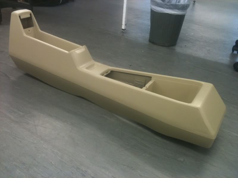

#263 hanra
Posted 07 November 2011 - 08:39 PM

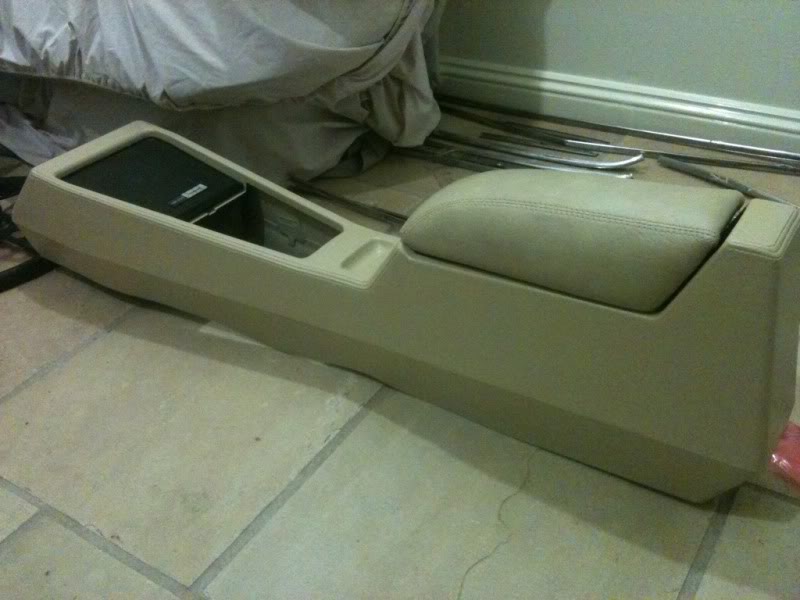

Centre console is coming along, pretty happy with how this has turned out.

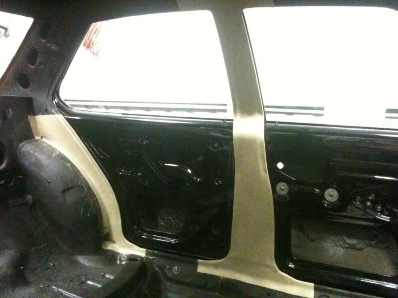

#269 hanra
Posted 10 November 2011 - 10:02 PM

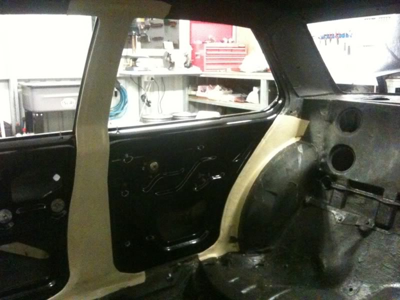

Got the A, B, C pillars and dog legs trimmed up. Because the A pillar never got painted when the car was done......? :wtf: Ive decided to trim it with black long grain vinyl. Im actually glad I did this as I think it looks better then plain paint. My only concern the front windscreen rubber fitting and sealing... with the vinyl running down the length of the A pillar? Fitted 5mm foam to the C pillars also. Basically now ready to fit the roof lining.

#270 _LH8VD69_
_LH8VD69_
Posted 11 November 2011 - 03:16 AM
Looking good! I done my a pillars in the black long grain as I did the b and c. No problems with leaks. One thing I did notice was the rear seat in my SLR was an LX style one and whilst in the c pillar was very visible. After I fitted the genuine SLR LH rear the c pillar is amost blocked by the side 'bolster' of the seat. It goes to show how flat the LX seats must be. It doesnt look that much but obviously is. I'm so glad I sourced the original vynal for it only to be covered by the seat. Lol !
