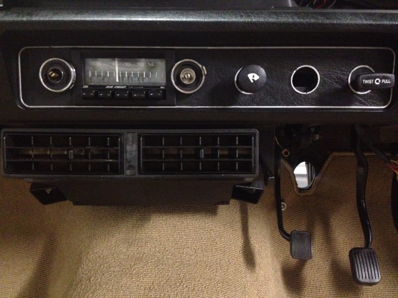

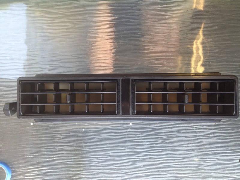

Maybe my mistake, standard LX the vents only pivot up and down but with aircon you get the knob in the middle to move left and right as well. Was this standard on LH?
#527 hanra
Posted 11 June 2012 - 10:28 PM
I'm confused....!!! Dosnt take much...
#528 hanra
Posted 11 June 2012 - 11:10 PM
LH vents m8. So i've been informed. :)
Ah well there ya go!! Interesting. Didn't know there was a difference...?

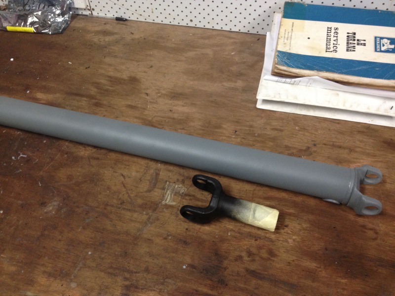

Posted 14 June 2012 - 08:11 PM
Un effing believable..
I gave my replacement tailshaft to another sandblaster on tuesday...
Had an actual phone call from them Wed arvy to say it was done...? Picked it up this morning, its still useable, not damaged in any way, how strange...
$88 to blast and prime....
Ill fit new uni's and get it balanced, then Ill spray it.
Edited by hanra, 14 June 2012 - 08:12 PM.

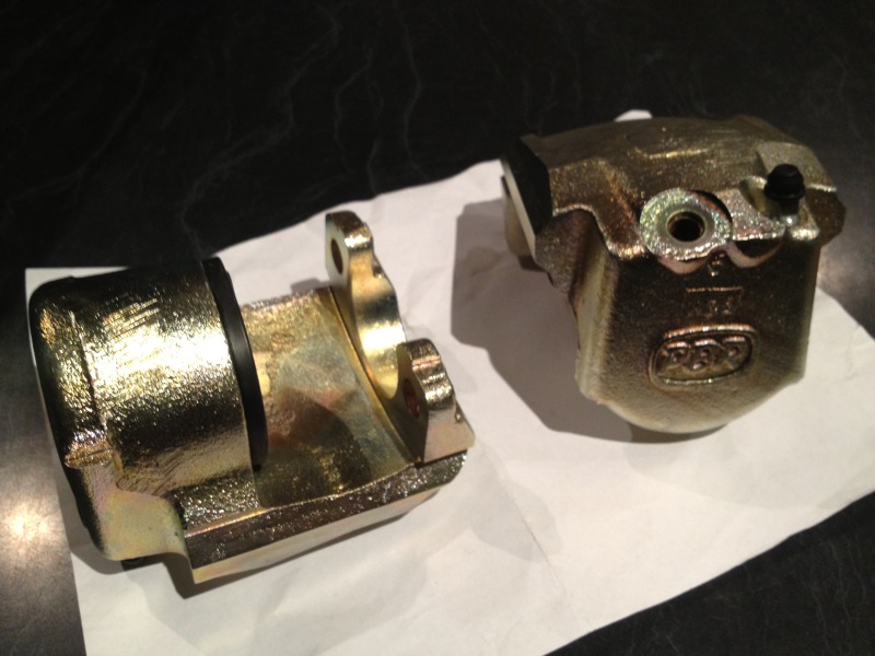

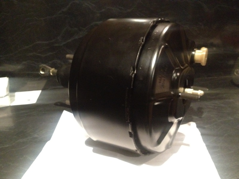

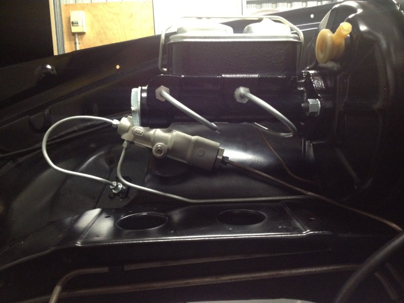

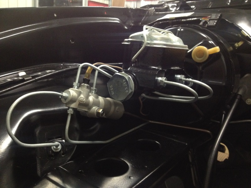

Got my brake booster overhauled. I 2 pac'd it prior to assembly.
Also got the calipers done over. They were pretty sad looking to start with. Wasn't sure if they should be gold or blue??
#534 hanra

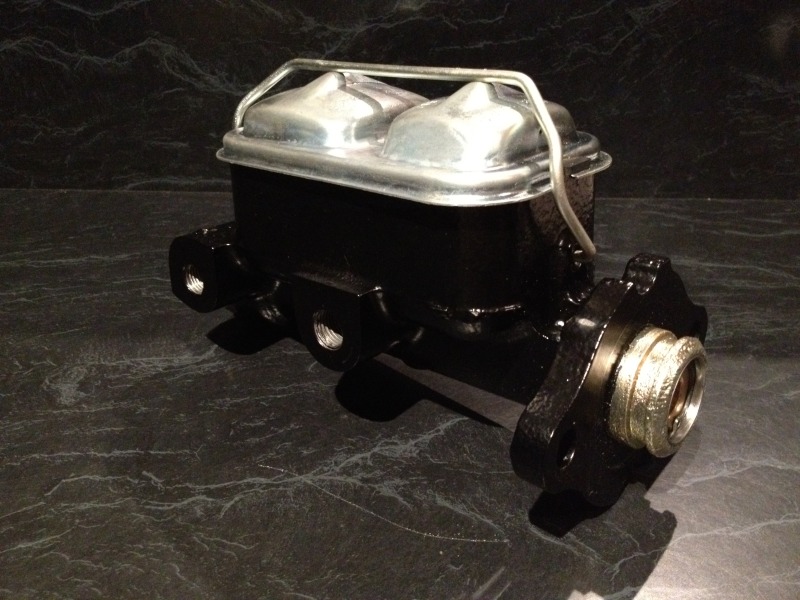

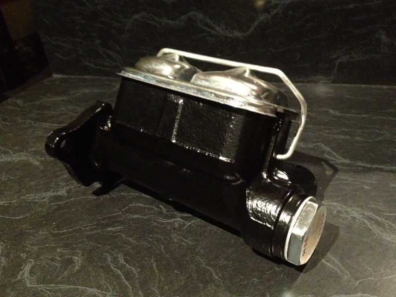

Posted 18 June 2012 - 07:18 PM

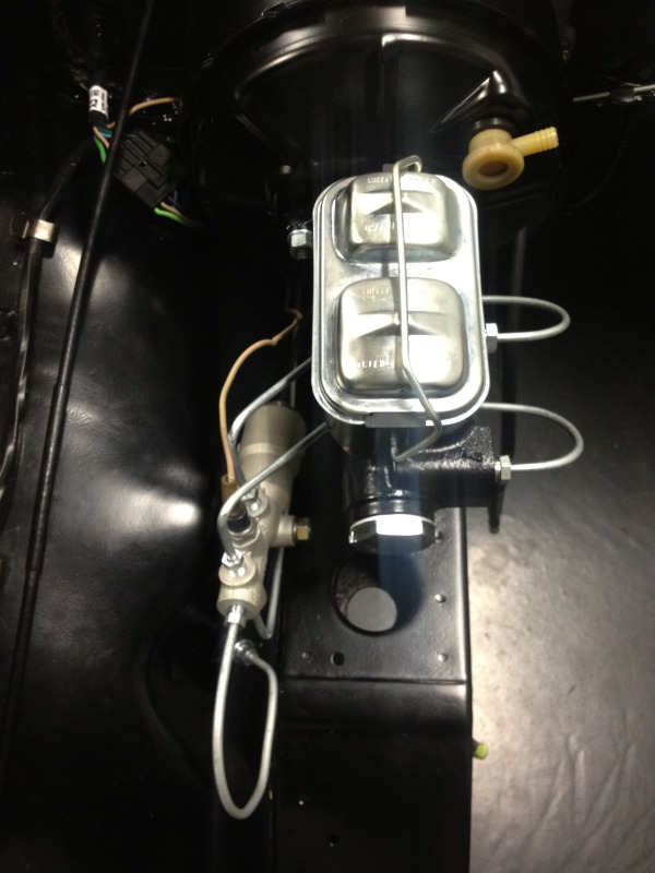

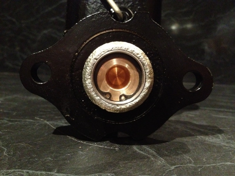

Very happy with my Master Cylinder. I bought it 2nd hand in an unknown condition, and the inside of it was rooted. Had all new pistons lathed up for it and everything else inside is all new. Lid re zinc'd also.
#535 308 Sunbird
308 Sunbird
  • 976 posts
  • Name:Stuart
  • Joined: 20-November 10
Posted 18 June 2012 - 08:23 PM
Top work as usual Brad.

#537 LHSL
LHSL
  • 995 posts
  • Name:Phillip
  • Location:SYDNEY
  • Joined: 30-March 07
Posted 18 June 2012 - 10:55 PM
Nice Brad. What is the cost of recoing a v8 booster. I picked one up the other day for the tribute car.
Phillip
#538 hanra
Posted 18 June 2012 - 10:57 PM
Thanks for trying Mark. I've been hunting around also, but yeah, same.. Plenty of H series rocker covers around. Might even try a wanted ad on eBay? It's amazing all the little differences of a LH Torana V8 Rocker Cover compared to all the others out there.
Phillip, I don't have an itemized invoice but I think I got out of it fairly well. Booster overhaul, M/C overhaul, prop valve overhaul, overhaul calipers with new pistons, 4 new hard lines, 2 rubber hoses, plus a few bits re zinc'd and what not.
Total $1165.
I blasted/2 pac'd the bits whilst everything was apart.
Edited by hanra, 18 June 2012 - 11:05 PM.

Posted 21 June 2012 - 10:35 PM

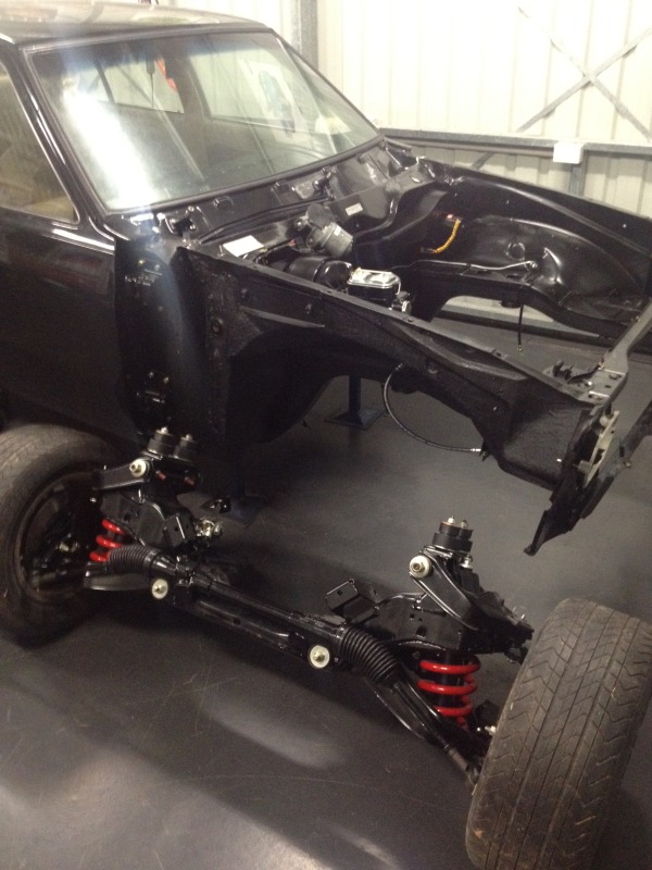

Brakes are pretty much done. Once the front end is in, the calipers can be bolted up.

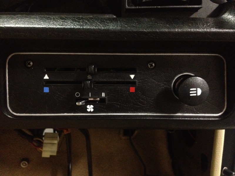

Also some pics of the dash, I did my best to re-furbish the dash/knobs. Still looking for some radio knobs....

And I'm almost ready to lift the donk onto the k-frame. Maybe next weekend I'll get that done?

Good luck Brad finding some radio knobs. I have sourced some rocking horse poo recently which was much easier to find!!! Most radio knobs come with a radio attached...
#545 hanra
Posted 30 June 2012 - 07:17 PM
Yeah I dare say I'll be buying another radio just to get the knobs then dump the radio.... Shame. One knob on eBay just sold for $122????
