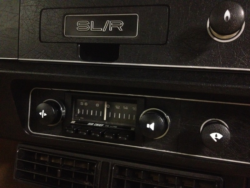

Very nice, how much did the radio knobs end up costing you??

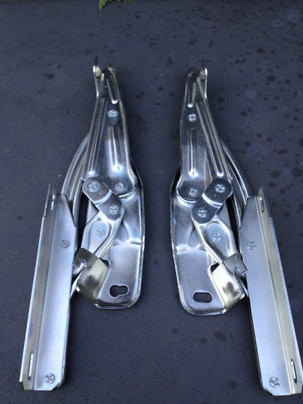

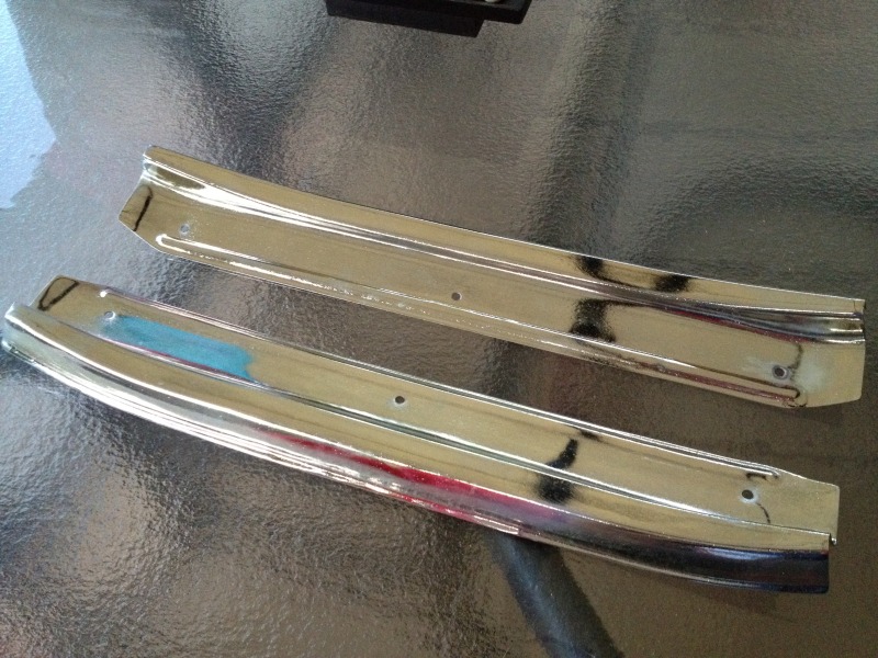

Very happy with Hume Performanc's work on the Rochy... Looks brand new..
Also had some bits re-zinc'd with Albury Electroplaters. Came back really bloody nice actually!!! Interesting how people say there scuff plates are chrome from factory, well these have been zinc'd and they look chrome!

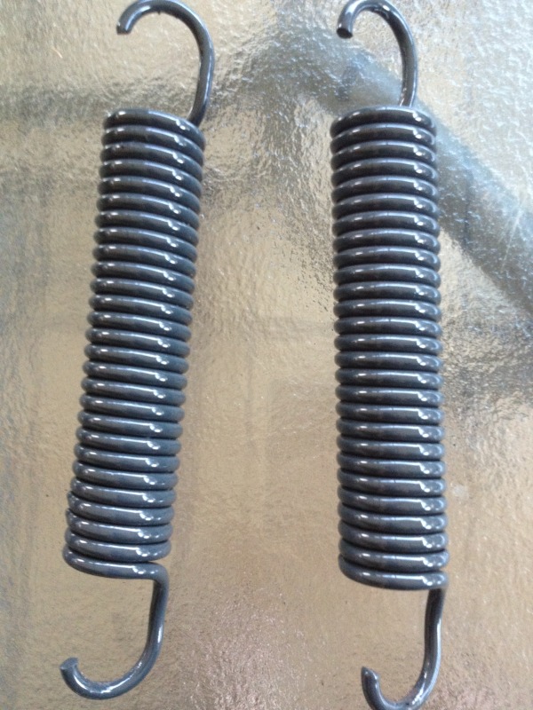

Question..... How do I get the bonnet spring back on......??????

brad have you painted your springs?
#606 _CHEVED_
_CHEVED_
Posted 27 July 2012 - 08:12 PM
I did mine on the grass last time and they were powder coated. Used a big screw driver put one foot on the hinge clipped one end of the spring on the other dug the screw driver into the ground and levered the other end of the spring over using the ground lol worked a treat.
#607 hanra
Yep. Painted them a nice shade of Holden grey? Hope that's correct??? Stretched em with a trolley jack when I painted em.
Ha!!! I reckon the ground is to soft up here for that! I'll give it a shot though, I've got a big mungral screw driver I could use.
brad i did mine with hinges in the bonnet open position
clip one end on and used a smallish philips through the
hook of the spring and through the retaining slot
may use a touch of paper so you don't chip them
in this position the spring does not have to be
stretched far at all

My springs are more an ochre sort of colour
Not sure if SLR's got different spring colours to SL's

That's the color I was going to do mine on the SL/R.

From what I've been able to work out.... And my uneducated use of the Internet. Early LHs had that ochre colour but later LHs had the same colour as the LXs....?
#612 hanra
Posted 27 July 2012 - 09:00 PM
I was going off this thread...
http://www.gmh-toran...__fromsearch__1

What colour are your bonnet hinge springs?

just had a quick look they seem to be all black, no sure if they have been painted before but i tried sanding it back a little and they may have traces of light grey or white under the black... the look almost bare metal inside.. hope that helps.

So did any LH or LX or UC Torana ever have grey bonnet springs? Or have I been given a bump steer?
i think your heading down the right path asking brad
but you must decide what,s right for you
info has been offered as to early LH being yellow ocre
my LX when i got it in 1985 and pretty original at that
stage had grey springs
i used a rubberised paint from a model shop
so that it stretches without cracking
does me !!!
