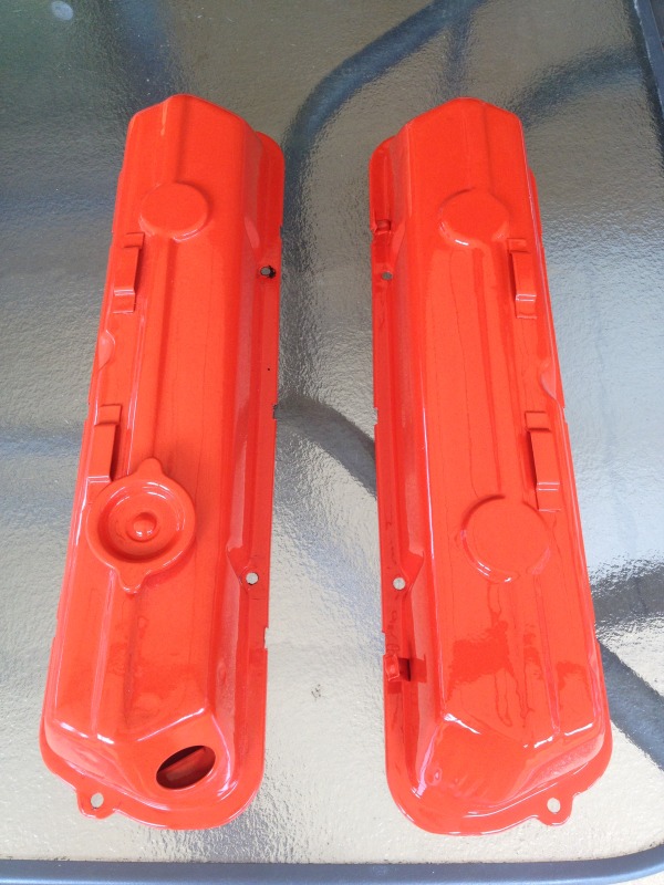

And the rocker covers are in primer still was going to paint them on daturday but had some medical emergencies come up with my dog over the weekend.

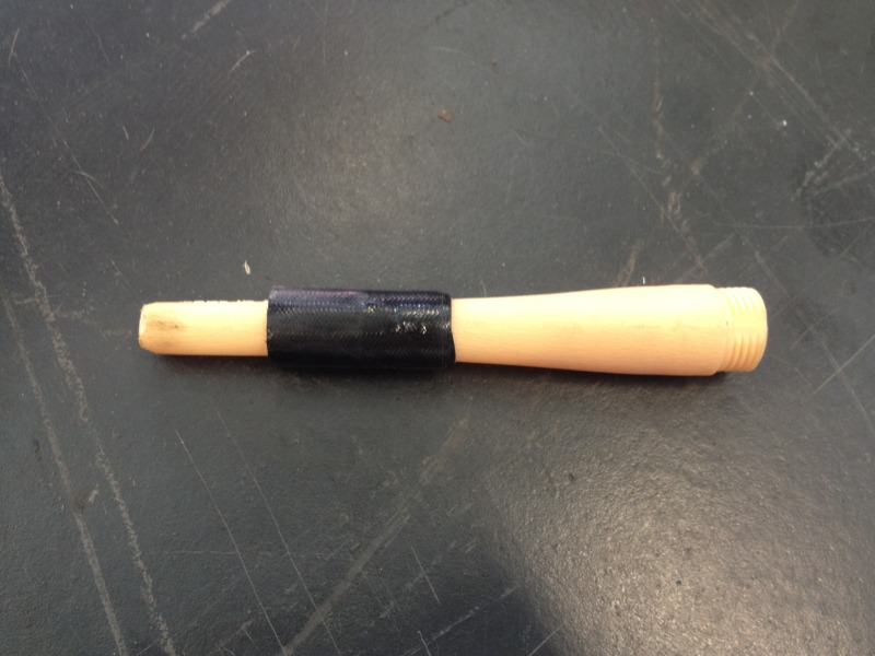

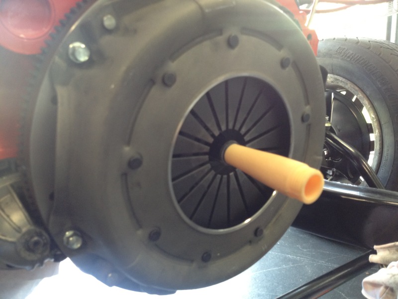

I bodgied up my own clutch aligning tool with the handle of my parts cleaner brush! And frOck me... It was spot on first time I trial fitted the box!! Just slipped straight on.
Just having a lot of difficulty fitting the clutch cover to the box now.... Just wont fit...
Gunna head into work tomorrow to paint those new rocker covers to!!

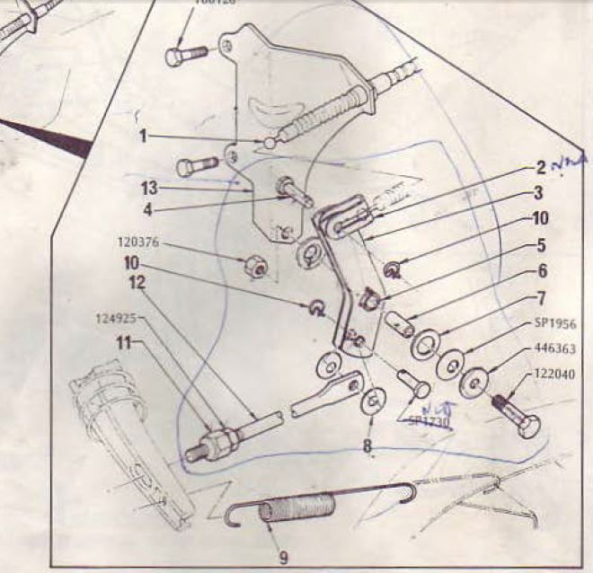

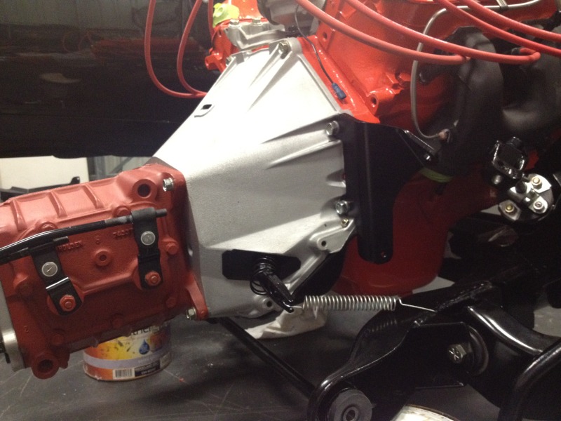

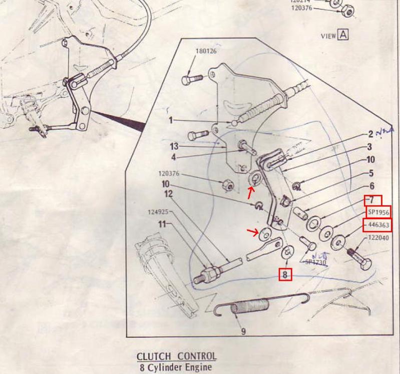

Is this the correct spot for the clutch fork return spring to attach to on the k frame?? Can't see a special hole for it???
#584 _Bomber Watson_
Posted 20 July 2012 - 08:13 PM
It doesnt go back to that black plate with the hole in it in the picutre???
Been a while since i've looked at a rat trap and payed attention.
#585 hanra
Posted 20 July 2012 - 09:53 PM
Nah that hole is for the bolt for the clutch relay rat trap.
Edited by hanra, 20 July 2012 - 09:57 PM.
#586 ls2lxhatch
Posted 20 July 2012 - 10:04 PM
LH manual shows the spring as per your picture except the fork end is not quite right.
Edited by ls2lxhatch, 20 July 2012 - 10:04 PM.

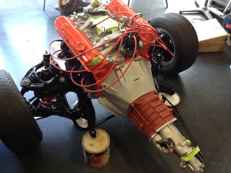

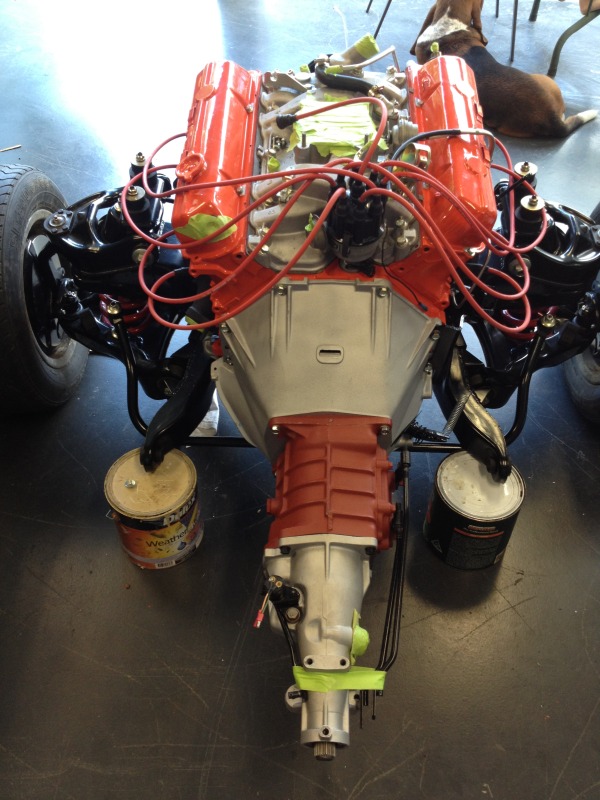

Posted 21 July 2012 - 05:51 PM
Brad,
Looking great - a couple of questions if I may please;
1. The bell housing and tail end of your gearbox - are they painted silver or have you done something to the bare alloy finish because it looks great, and I'd like mine to looks like your gearbox is all.
2. The red colour for the 'guts' of the box - what is it, where did you get it and please tell me this is available in a spray pack so I can do it myself...
Finally, that was a great little 'win' you had with your improvised clutch aligning tool - well done to you!
Thanks, TB
#589 hanra
Posted 21 July 2012 - 06:11 PM
I sand blasted the bell housing and snout at work. Let it soak in some ACF-50 for a week or so to. Looks a treat.
The box is painted Red Oxide primer as I believe this was the factory colour?
Make a trip to bunnings mate!!
