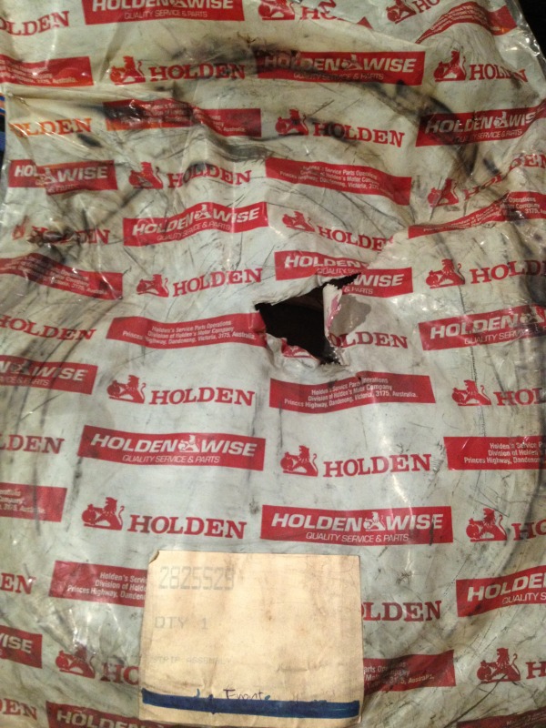

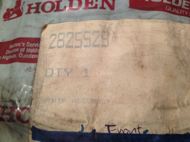

I got a hold of this NOS front bumper rubber also. Ive got a NOS UC rear one also, not sure if it will fit...?

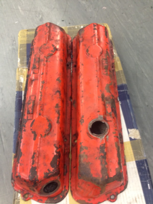

#563 hanra
Posted 11 July 2012 - 11:28 PM

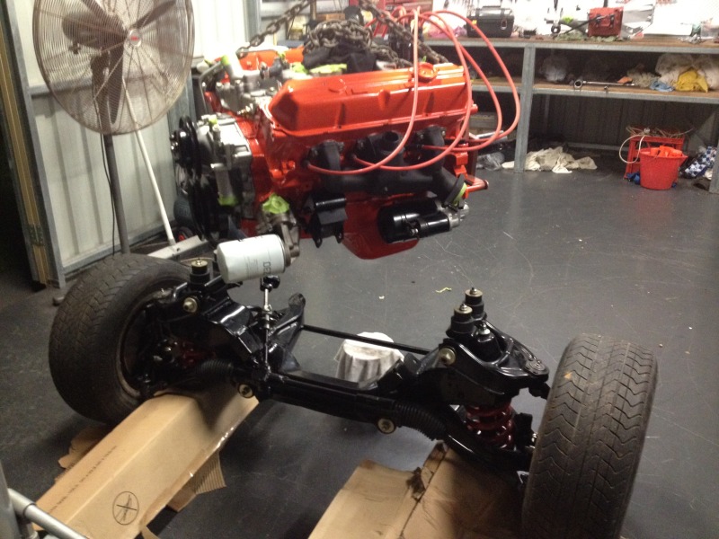

Thought I might as well do some work in the shed tonight....
haha!!!!
love it!!!! love it!!!!
I was like a kid at Christmas time when these babies showed up in the post!!!!!! They are in the stripper tank overnight, I'll blast em tomorrow arv and get some primer on em ready for paint on the weekend.
Edited by hanra, 11 July 2012 - 11:33 PM.
#564 _berro59_
_berro59_
Posted 12 July 2012 - 02:15 PM
Gotta love the look of a V8 on a k frame. They always remind me of a polaris trike on streriods.
I also love getting Torana parcels. They should come up nice.

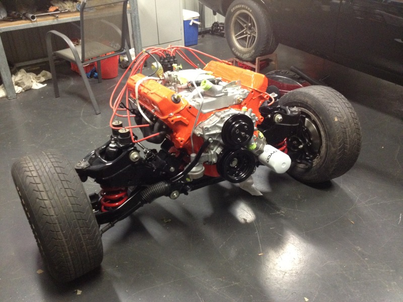

#567 hanra
Posted 12 July 2012 - 05:45 PM
Looks great Brad.
Just out of interest and for my own learning;
- what is a 'stripper tank' - is it a parts washer tank full of thinners or something else altogether? We have a large tank at work that is full of ARDROX 666, its a hardcore stripper that takes off paint and other crap.
- how are going to re-unite the K-frame to the body - lift the car up somehow, roll it all under there and then lower the body down I assume, but wondering what part of the car you'll use as a lifting point? Yes, same way as I removed it, rear wheels up on ramps, brackets fitted to the bumper bar chassis rail mounts with chain in between, engine crane then does the rest.
- it must be bloody hard to move the k-frame about or is it pretty well balanced now the engine is mounted to it? No, its pretty well balanced, once the g/box is bolted up to it, it will be even easier to move around. As it is, I just grab the sway bar and wheel it around.
- will you mate the gearbox before installing the k-frame or do this afterwards? As above, clutch and gearbox will be mated before fitment to the car.
It all looks fantastic by the way - only wish I was as far along as you are. To be totally honest, I expected to be a lot further along by now... I pulled all this out in Jan... what the hell have I been doing for 6 months???
Cheers, TB
And Mort, it would be nice to be 90% finished by Xmas time this year. Rocker covers are stripped, blasted and I just finished priming them
Edited by hanra, 12 July 2012 - 05:46 PM.

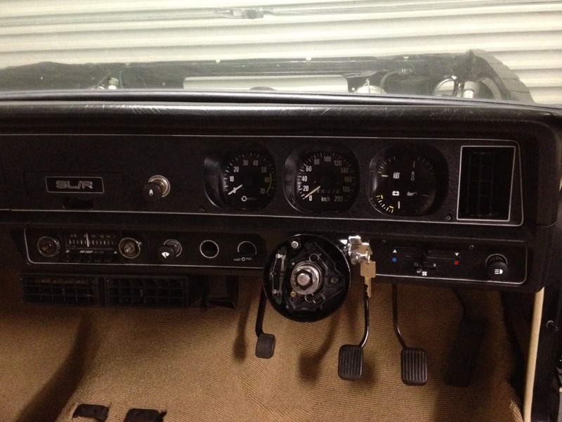

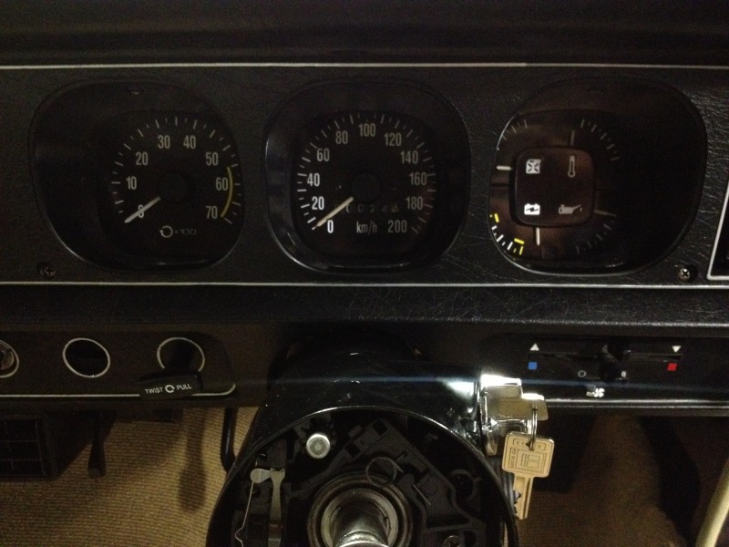

Posted 14 July 2012 - 11:56 PM
Decided to fit the column prior to engine install as I thought Id have issues getting the column through the new firewall grommet with the clips and what no fitted to the end of it... I would imagine trying to re-fit them once the motor was back in would be very tricky???
Anyways since the column is back in, that meant the dash cluster and crash pad could go back in to!

#571 hanra
Posted 15 July 2012 - 12:06 PM
Thanks. Fingers crossed the cluster still works as it did on the bench....
Once the motor n box are in I guess I can fit the centre console and seats...!!!
