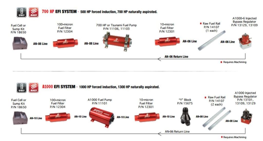

Without knowing the engine HP or what type of fuel you're using, I'd guess you'd want to go with something at least 50 GPH (25% more if you have to run ethanol fuels) with a 1/2" (-8AN) supply and 3/8" (-6AN) return?
#1234 ls2lxhatch
Posted 06 August 2015 - 01:05 AM
-6 will flow enough for a 700 hp naturally aspirated EFI engine.
http://aeromotiveinc.../power-planner/
