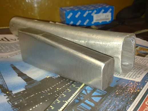

I thought I'd throw a few progress pic's up for everyone to see where I'm at and how I'm making it. (if you ever want to make one yourself)
Below is a wedge used to bash the pipe to the same shape as the inlet ports, used a test piece of alloy pipe.

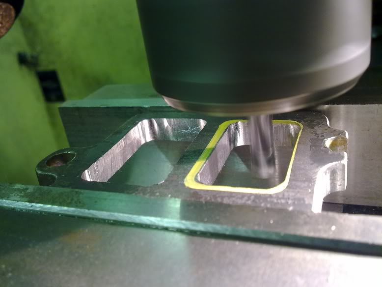

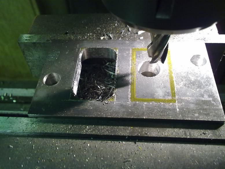

Next I milled out some mild steel to roughly the same as the head for a flange. (leaving about 5mm for fine tuning later on).

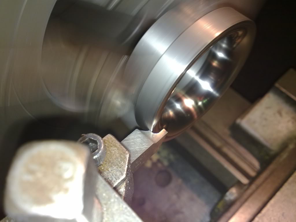

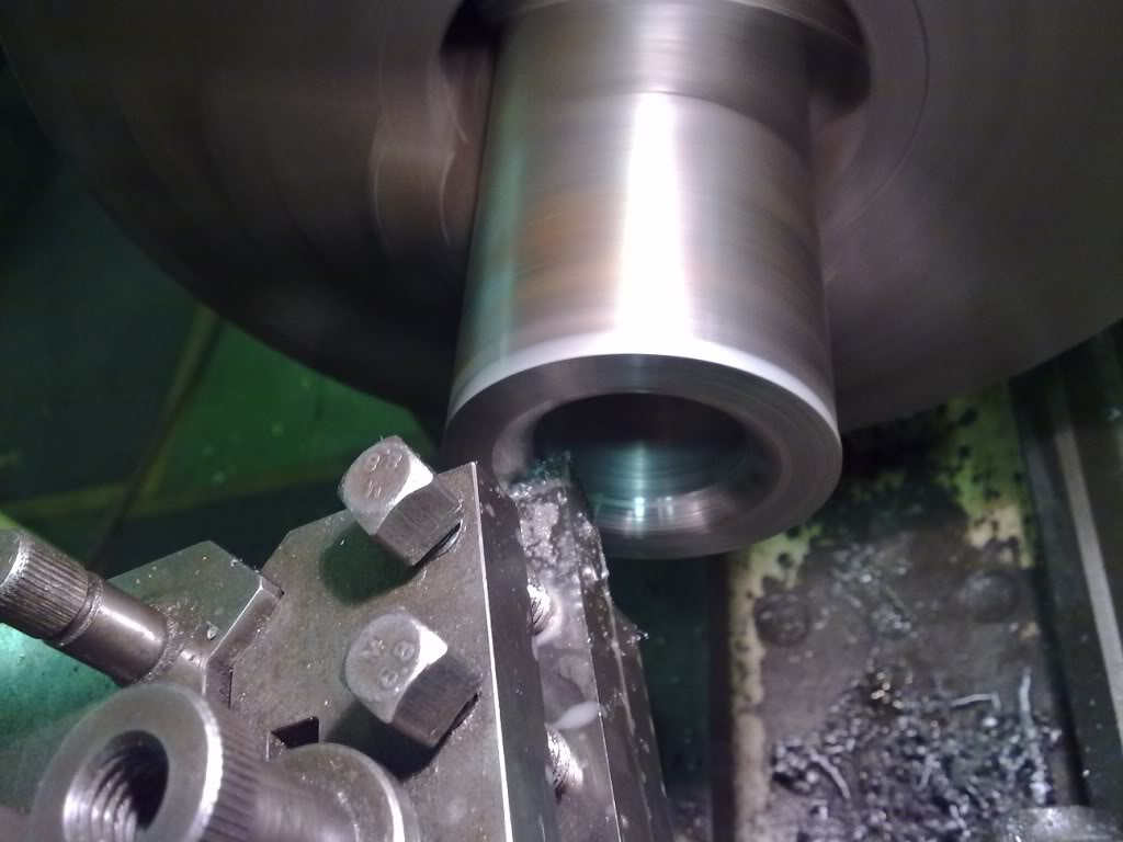

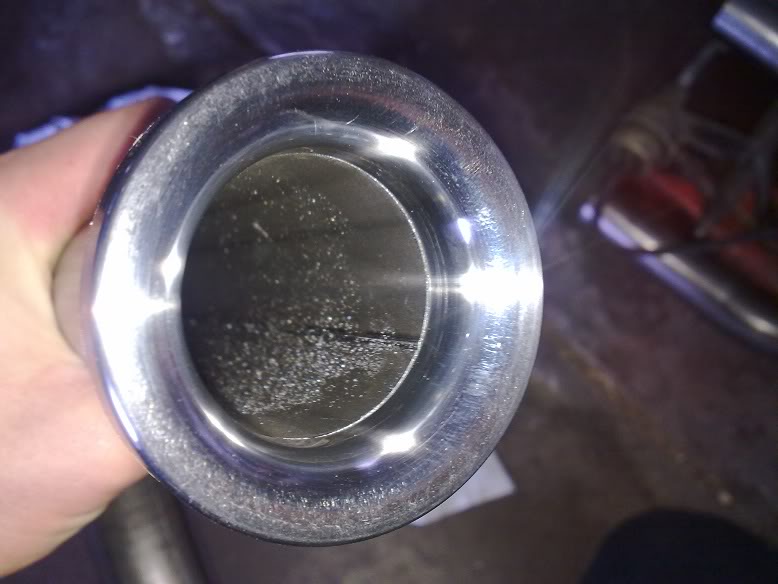

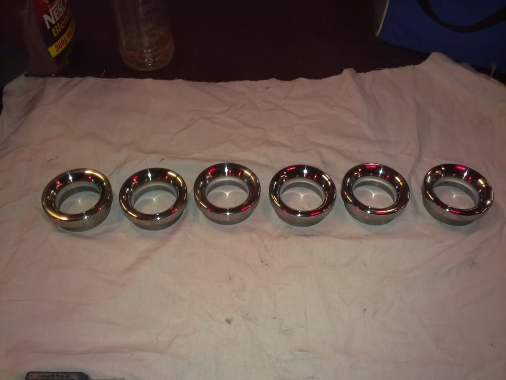

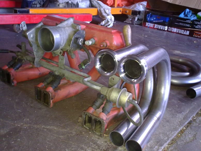

Next I turned up some bellmouth inserts to form the radius on the end of the inlet pipes.
#3 _Inj gtr202_
_Inj gtr202_
Posted 13 July 2011 - 09:52 PM

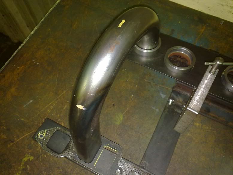

Purchased some 45mm OD mandrel bend exhaust pipe with 100mm Radius and 150mm of straight after the bends (cut most of it off anyway)
Sat them next to the VK Manifoild to get a feel for how they are going to be layed out.
Did a few measurements so see how long I need for the 2nd Harmonic and it turns out is almost identical to the VK length (about 20" total)
so the Mandrel bends are cut 110mm from the Radius at the bottom and pretty much at the tengent up the top.
Cheched clearance etc. and made a jig to hold it all together while it gets fabricated.

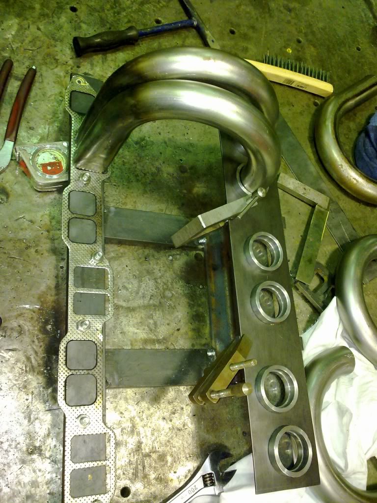

#4 _Inj gtr202_
_Inj gtr202_
Posted 13 July 2011 - 09:58 PM
This is pretty much where I'm at now.
Still need to make the Plenum chamber and finish welding it all together.

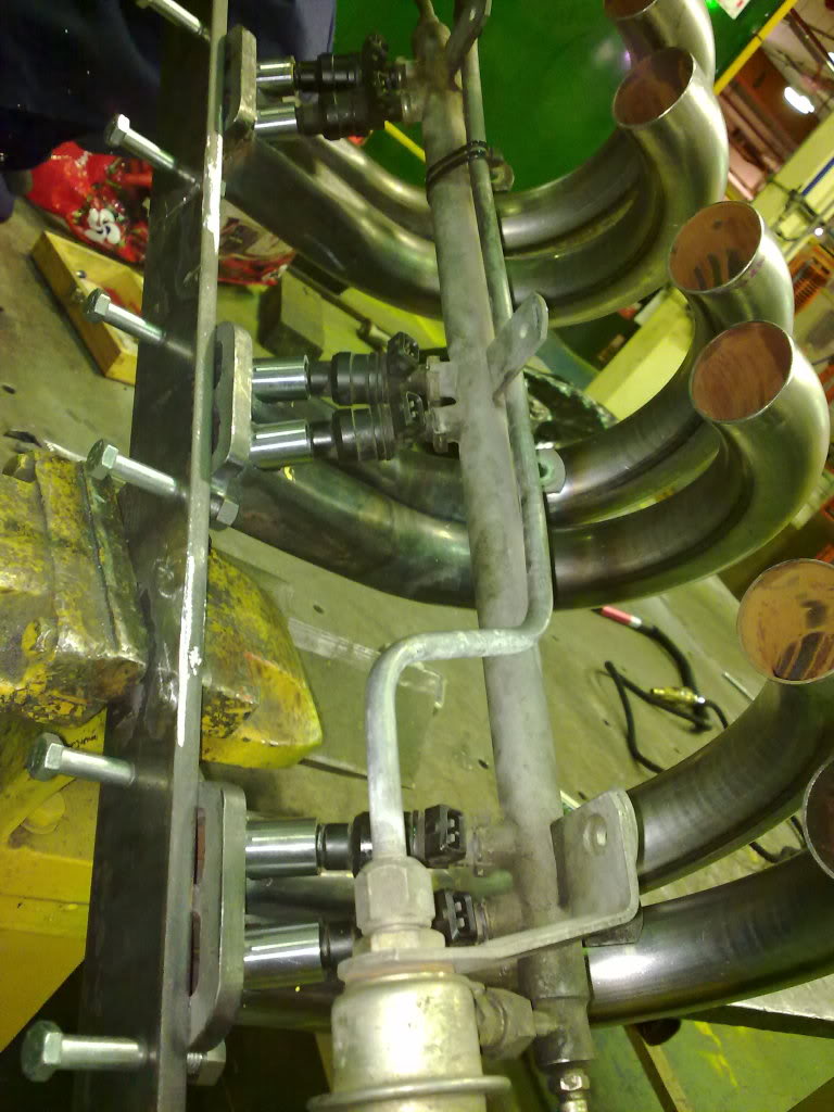

Plan on putting the injectors close to the head because I want to use the same rail and injectors that I already have. (unless there is a very good reason to move them)

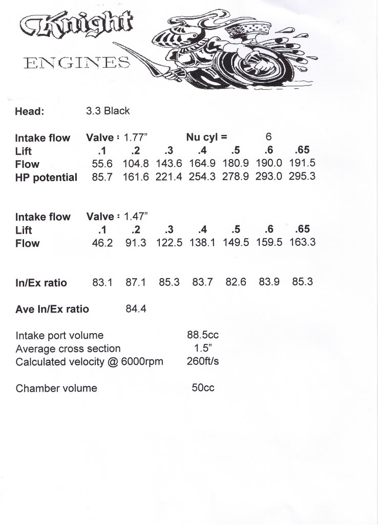

I chose not to go with the IR system because I already had all the bits to put together a Single TB Plenum type manifold. If I was doing it from scratch (from a carby) The Sonic IR system would definitely be a consideration.
[IMG]http://i1100.photobu...t=HeadFlow1.jpg[IMG]
I'm also trying to gain a few extra HP through having the longer runners (like tunnel ram)
I'm aiming for about 250hp from the motor and still have it reasonably street friendly.
I'm running the Camtech Solid CT35 634A-107 My link
The head flow figures (minus the manifold) are as below.
Sounds like FUN.
You may wish to investigate holding the exhaust back a bit.
#18 _Inj gtr202_
_Inj gtr202_
Posted 17 July 2011 - 11:10 PM
Sounds like FUN.
The original plan was to have a cam ground with .453" lift on the exhaust (instead of .519"), but for some reason it did'nt happen.
Tony (from Knight Engines) assured me the extra exhaust made very little difference.
other than different ratio rockers what else could be done to pull it back a bit?

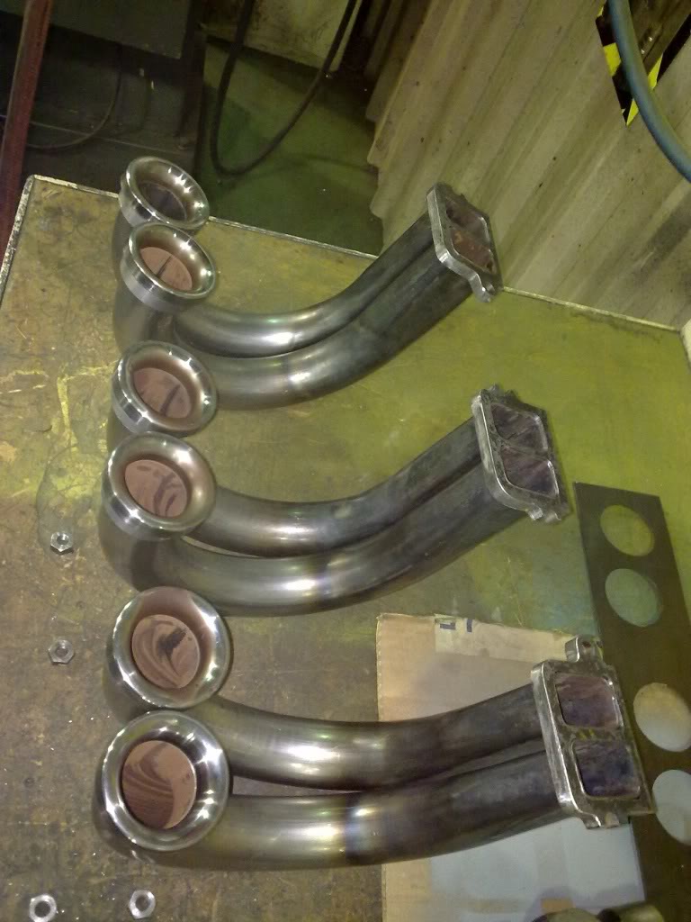

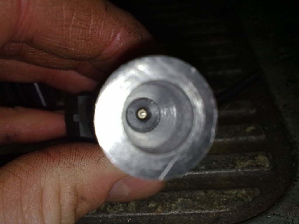

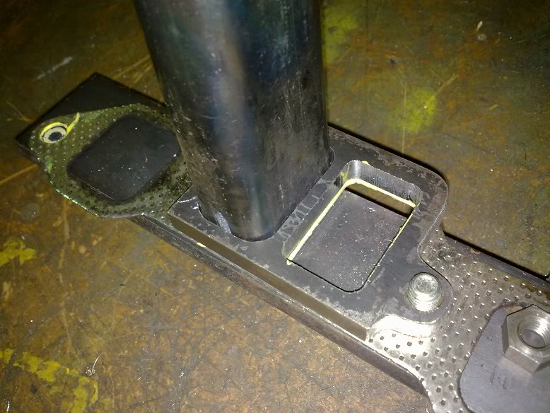

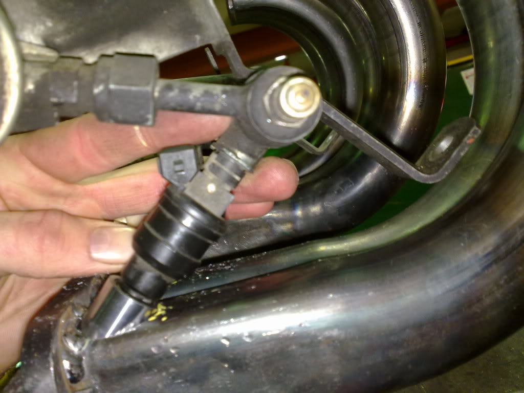

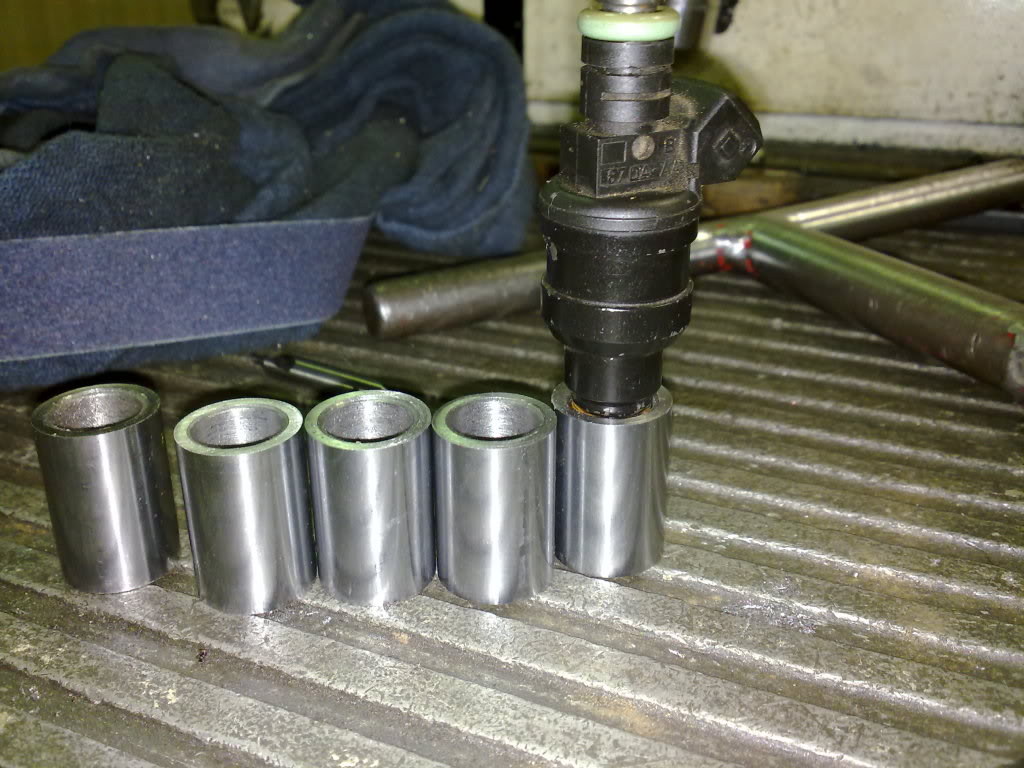

Posted 22 July 2011 - 06:27 PM
Managed to find a few hours this week to do a bit more work.
Turned up some injector bosses.
Welded the runners to the flanges
Cut the holes for the injectors.
