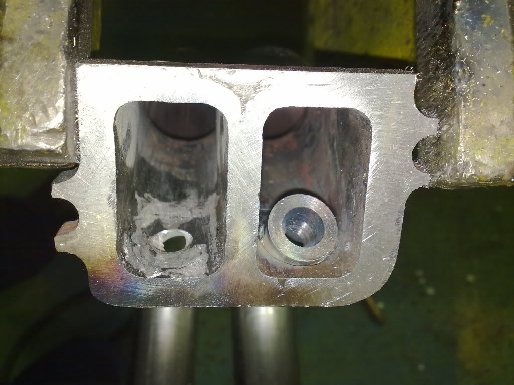

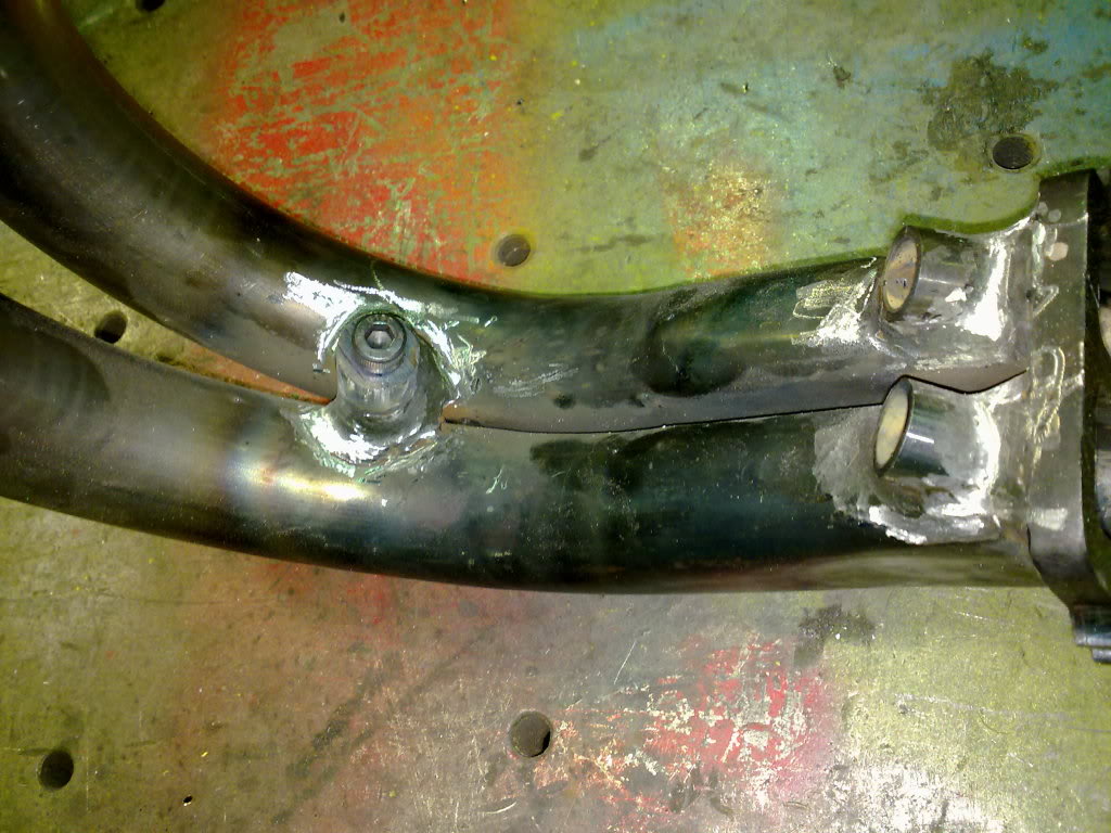

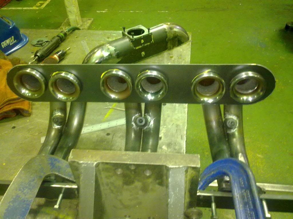

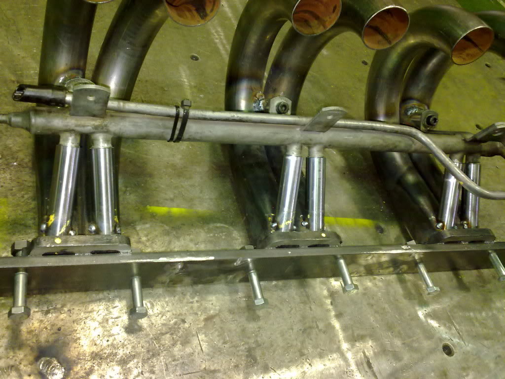

Turned up some spigots the same size as my injectors so I didn't melt them when I welded in the injector bosses.
Ground the bosses flat
Made it look a little neater
repeat 3 times and its almost ready for the plenum to be made.

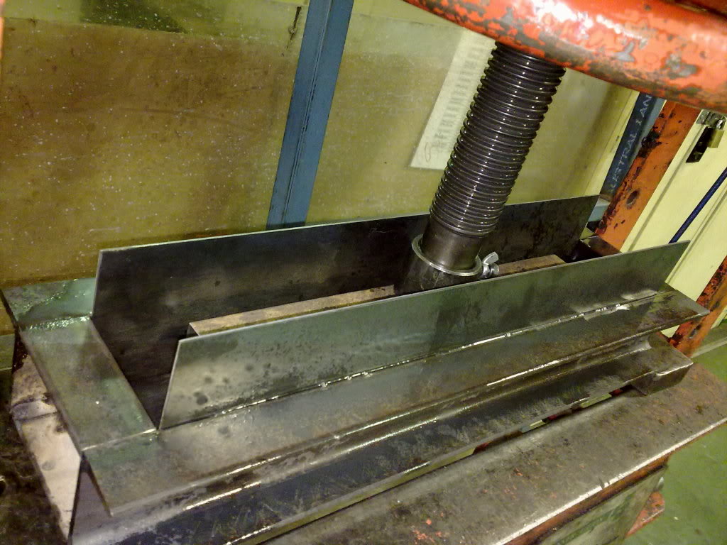

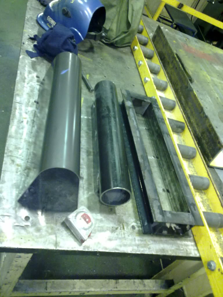

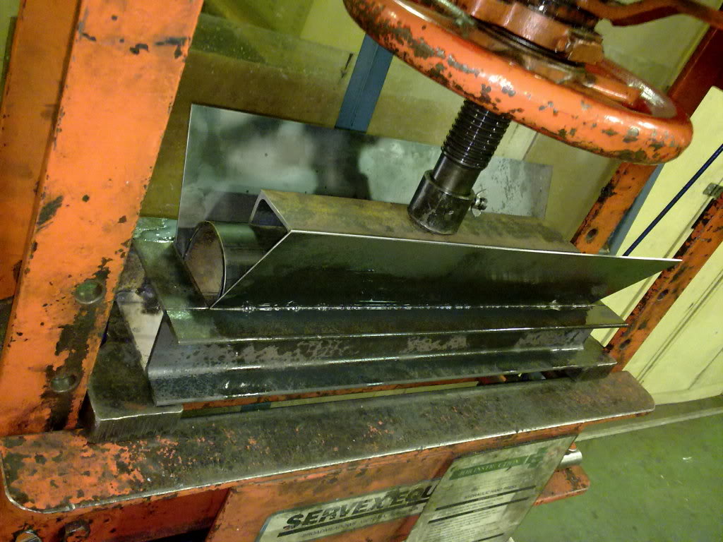

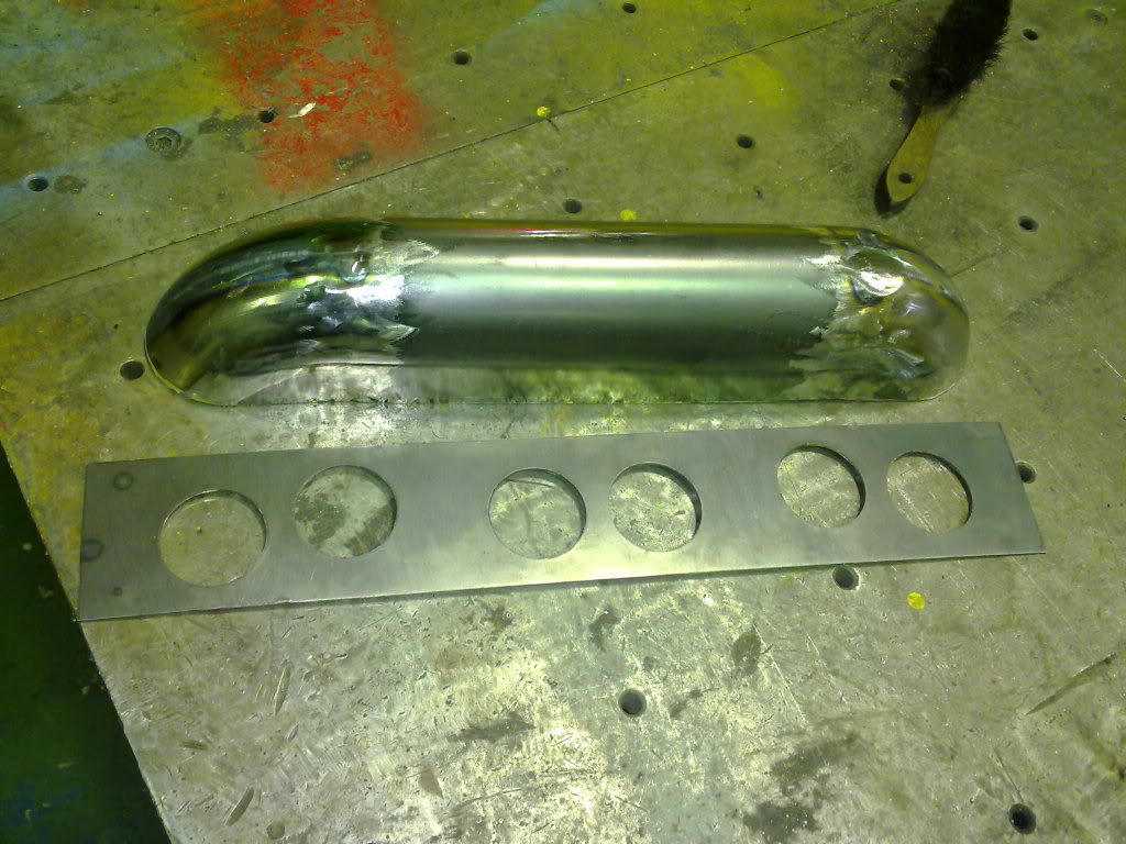

Folded up some 2mm sheet metal after making a home made press tool/ bending tool thingy. this will be the front of the plenum chamber .

neat trick for forming that curve! looking good

How did you determine the volume of the plenum?
From what I have researched the volume of the plenum isn't all that critical. Its more about not feeding one runner more than the rest and not restricting the air flow.
Its going to be around 500x90x100 which comes to around 4.5L. A little on the large side but due to the size of the radius at the end of each runner its as small as I can make it without impeding flow at either end.

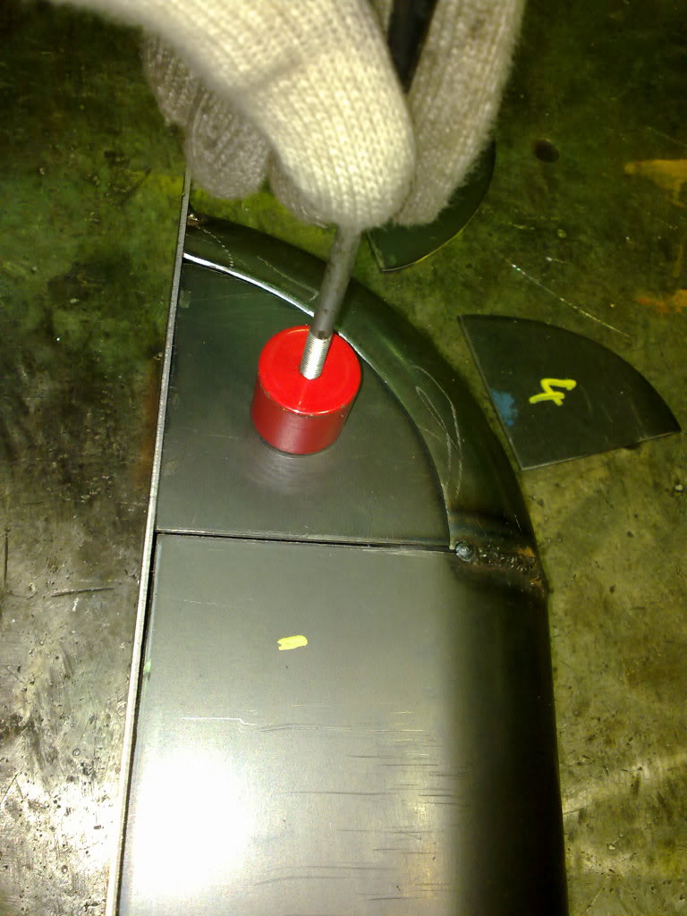

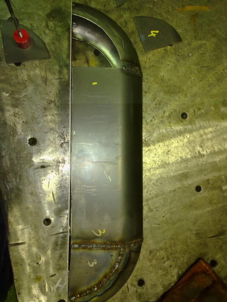

Got a little further with the Plenum.
Turns out the volume is closer to 3L rather than the the 4.5L that I predicted (tested with 600ml coke bottle) :blink:

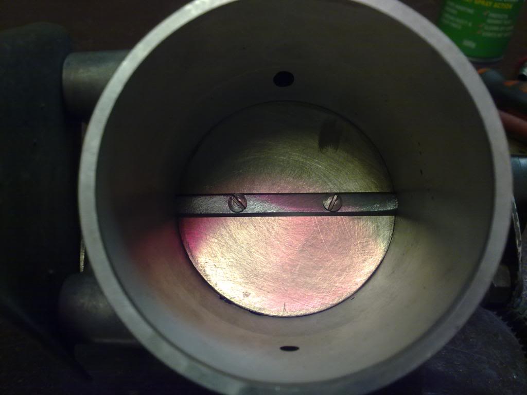

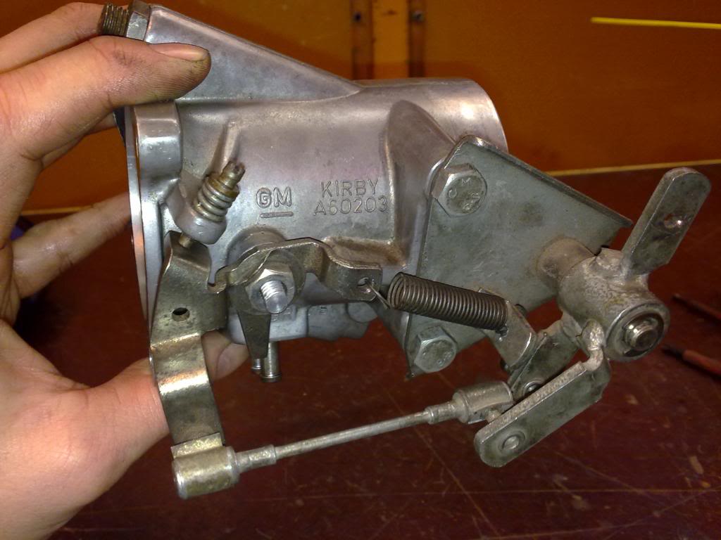

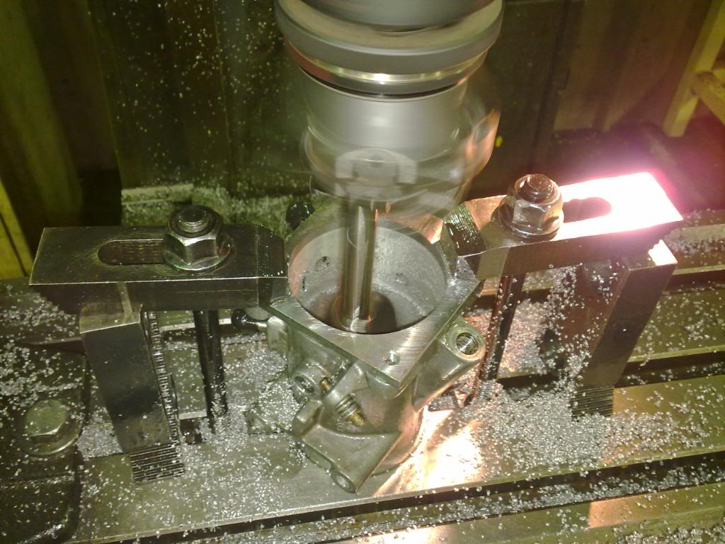

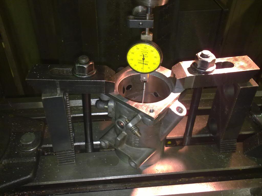

I always thought that my throttle body was 70mm. So there I was on the mill making my backing plate (for the plenum) and measured the BACK of the Throttle body.. and what do ya know.. its 65mm.
65mm may well be big enough, I don't know. So just to be sure I stripped it apart and bored it out to 70mm and made a new throttle blade.
Here are the pics.

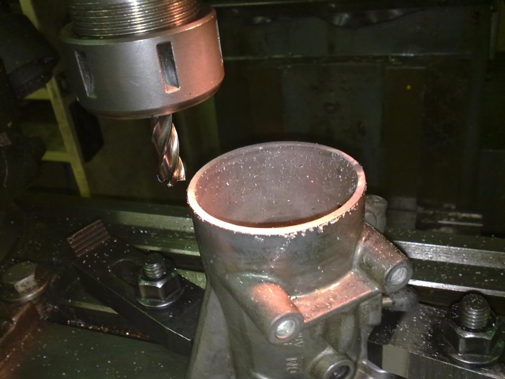

First I sat it on the table and machined the front flat.
then flipped it over and dialed up to find center. You can see the clamps clamped on the backing plate I made to 70mm.

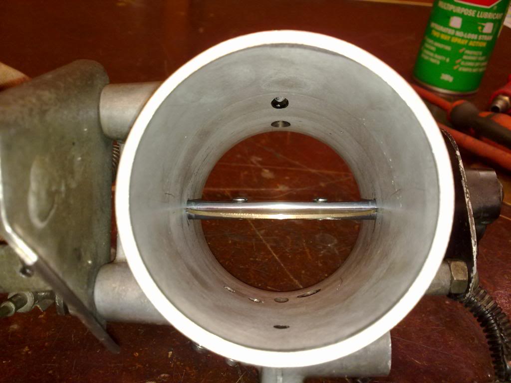

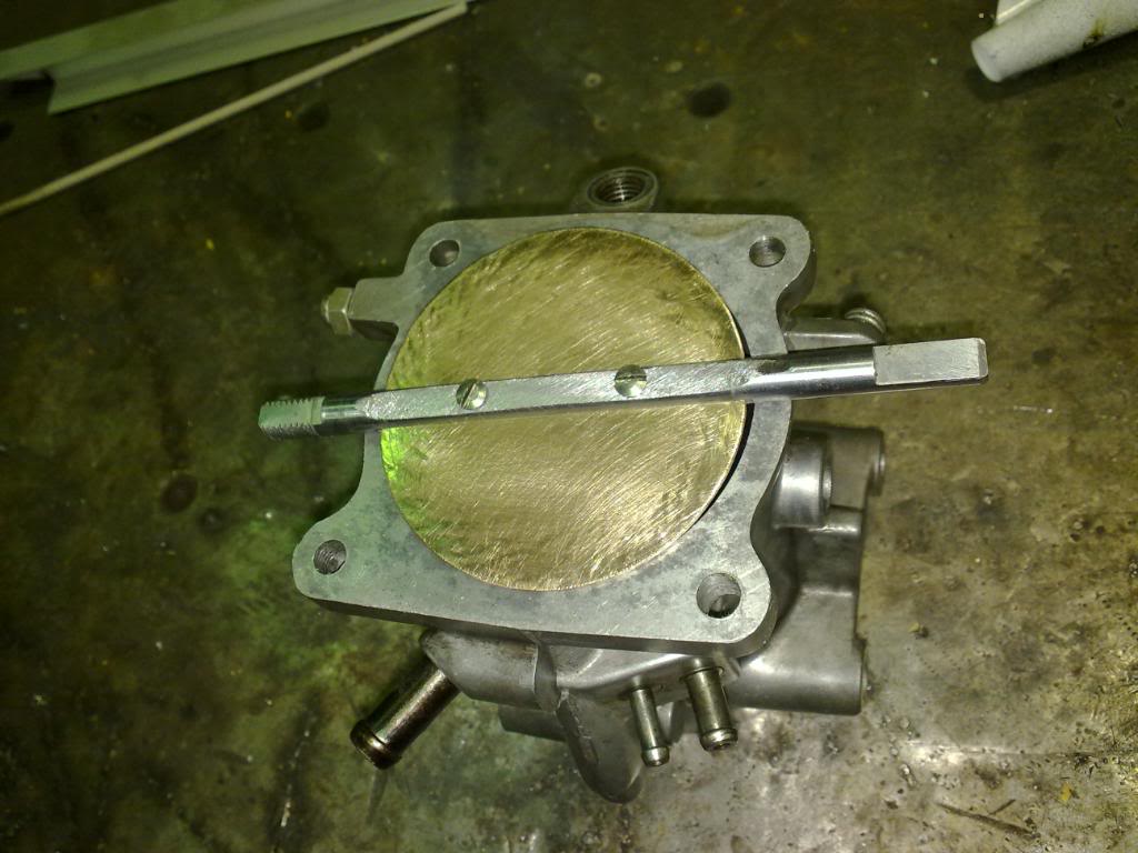

Then bored out to 70mm
had to then flip it back over to do the front because my bore tool wouldn't go deep enough.
Then I turned up a new blade out of brass and filed out original throttle shaft to allow for the extra 5mm.
Decided to re-do the spring anchor point as it would have fouled on the rocker cover. That allowed me to chomp off the ugly bit which hangs down.
#35 _Inj gtr202_
_Inj gtr202_
Posted 02 September 2011 - 06:08 PM
Took a little bit of meat off the shaft while I was at it.
Hopefully I got it to shut tight enough not to scream at idle.

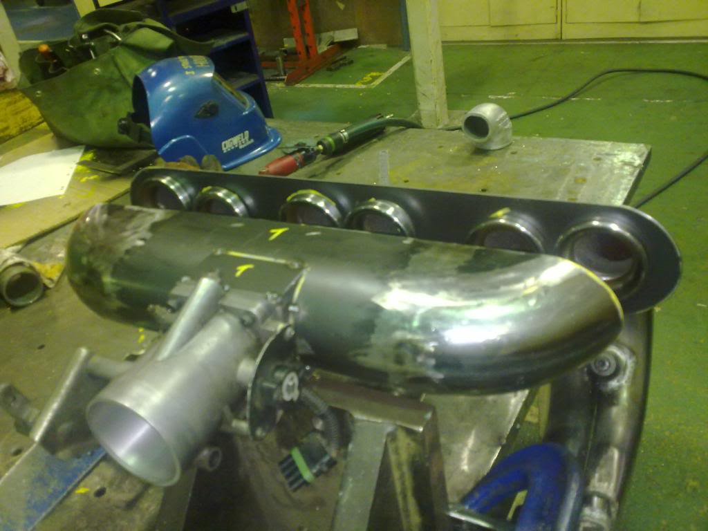

Now I am ready to give the pipes a good clean out and weld them up the Plenum.

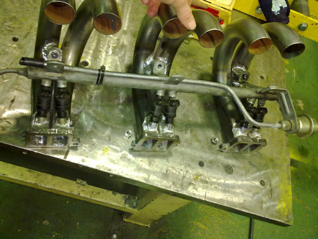

Hey bud, im no expert but have done a fair bit of research as I am making my own manifold as well..
From what ive found plenum volume should be 100% of engine compacity for N/A and 150% for engine capacity for Forced Induction
The way you have your throttle body setup id say the air will shoot straight down port 3 and 4 and you wont get as much down 1,2,5,6.
A mid entering throttle body is better but it should be facing away from the ports so it hits a wall and then disperses. You will notice most stock plenums of this kind have the ports entering from the bottom and the throttle body from the side.
It may be better to cut the runners off so they are pointing straight up and making a cylindrical plenum with dome ends and a side mounted TB
Other thing is the injectors look to be at quite a steep angle? ive found they should be no more then 20degree or aimed directly at the back of the valve as possible. I dont know how much it would effect it if they are aimed at the bottom of the ports, might cause it to pool?
Like I said im not a expert, im not trying to have a dig at what your doing just want to share what ive learnt and possibly help to make yours better in the process... What you have done does looks really good just maybe some design issues.. Id say check with a real expert and see what they think, last thing you want is to lean out the end cylinders and have it go bang. You can have a workshop flowtest it and they can tell you how much flow each runner is getting and if its even and a Decent guy will tell you what you can change to even it up.
I'm no expert either but I have done a fair bit of testing of this type of manifold, checking the flow capacities and mapping velocities through each runner and the TB/plenum.
The velocity through the 70mm TB and plenum will be sufficiently low (and the pressure correspondingly high) that flow variations between runners will be negligible. And if the variation is barely measurable on the flow bench, it'll be even less so on a running engine given the amount of turbulence that will be present in the plenum. As for plenum volume I believe that 99.999% of what is written about determining the "correct" volume (whether for sizing as a hemholtz resonator or not) is horseshit. As far as I can see plenum volume is something that can only be correctly determined by dyno testing, regardless of how many formulas there are that claim to be able to do it to within 5 decimal places. Fortunately though, it seems the plenum volume is one of the least critical aspects of the manifold and so long as it isn't grossly undersized reasonable results can be expected.
Nozzle orientation doesn't seem to be critical for WOT performance, though it is important for emissions and mileage from what I can see. I don't know much at all about this though but if Brett is reading he may be able to shed some light.

It will be getting bolted up and flow tested on the head that will be going in the car, so if there is some strange things going on with the numbers I'll be able to address them before it all gets painted and dyno tuned.
Plan B is a front mount throttle body, I was trying to avoid this because all my air ducting and throttle cables etc are set up for a tb over the rocker cover.

Tony has the head and manifold at the moment and is going to flow test cylinders no1 and 3 or 4. He is of the same opinion as Viper, that the center 2 cylinders will get significantly more flow than the outer 4. I hope he is wrong :sad:.
I've designed up an alternative with the throttle body facing towards the radiator but really hope that the design stays as just that.... a design.
I wish I knew more about flow testing. Does the flow bench pull more or less air than the motor is capable of drawing? ie. a slight flow drop at 28" equals a massive difference at 6,500RPM or bugger all?
28" has been shown over the years to be a good compromise between being able to show a useful correlation to real-world conditions and not having to make the flowbench ridiculously big. Any reasonably sized flowbench would be able to match the real-world flow through the TB and plenum of a 202 at full noise, though some of the little ones like the baby SuperFlows would struggle.
The trouble with testing the plenum on the bench is that the flow will be smooth and continuous, whereas on the engine there will be extreme turbulence in there. That's why even if the flow bench showed some discrepancy I still wouldn't worry too much until I could get it on the dyno and check the EGTs.

Got the Flow report back.
Only no.6 cylinder was tested.
Lift " .1 .2 .3 .4 .5 .6
Head Flow 55.6 104.8 143.6 164.9 180.9 190.0
Head Flow with Manifold 53.2 97.7 129.5 147.4 161.6 166.9
% Drop 4.3 6.7 9.8 10.6 10.6 12.8
Acceptable??? .6" lift is not really relevant in this case as the cam is only .519" lift max.

I don't think you're going to get much better than this without making the runner diameter excessively big.
To keep it in perspective it's flowing a whopping 25 - 30cfm more than the VK manifold. The potential is definitely there to make some good, yet streetable, torque and hp numbers.
Was there no test of 3 or 4?

no 3 or 4 couldn't be tested because the TB was in the way on his flow bench. I suggested removing the TB but he was reluctant to do so because it would have given a different result than with the TB. (plus I'm getting charged $50 a pop).
Going to drop the motor back in the next chance a I get and see how it all goes
