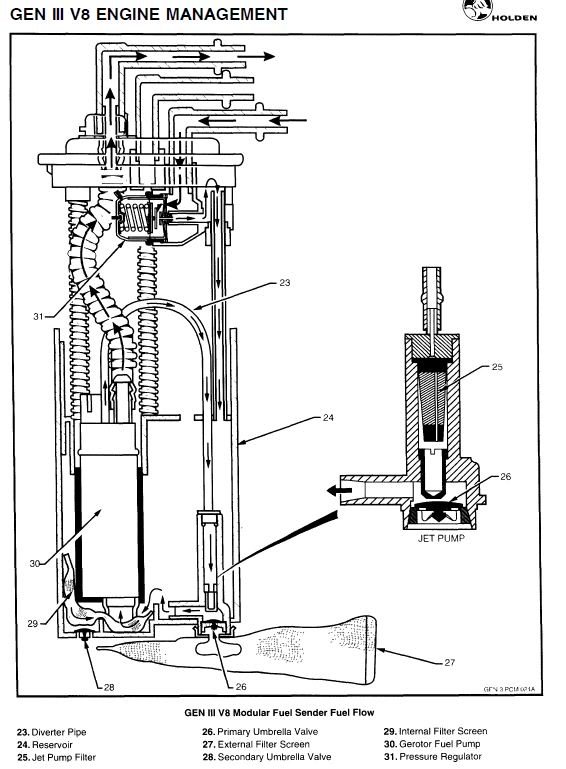

Hi Lenny - yes, that is how I have mine hooked up after a bit googling to make sure. I ran a new fueline up the passenger side of the car - what are you doing?

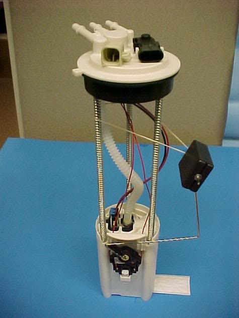

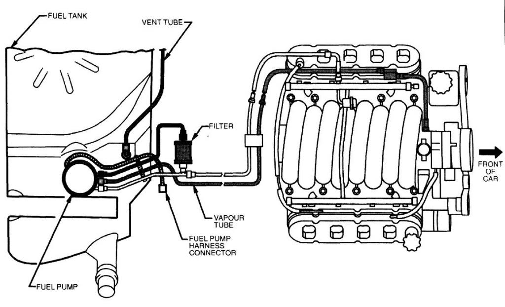

It would probably be quicker to just remove the pump and check. However these may help.
Looks like from top to bottom in the diagram below. Fuel Pressure to fuel filter, Vapour Vent, Fuel Return from filter.
The last diagram is from page 89 (pdf page 92) of the Holden Gen III V8 Engine Management Service Training Manual.

Thanks Andy, Getting the pump and fuel sender out of the tank is a delicate operation as its a tight fit even with the tank removed from the car. Just didn't want to do it unless I really had to. The sketches have verified my thoughts thanks, so I am off to the shed to make a new supply pipe and complete the hook ups.
