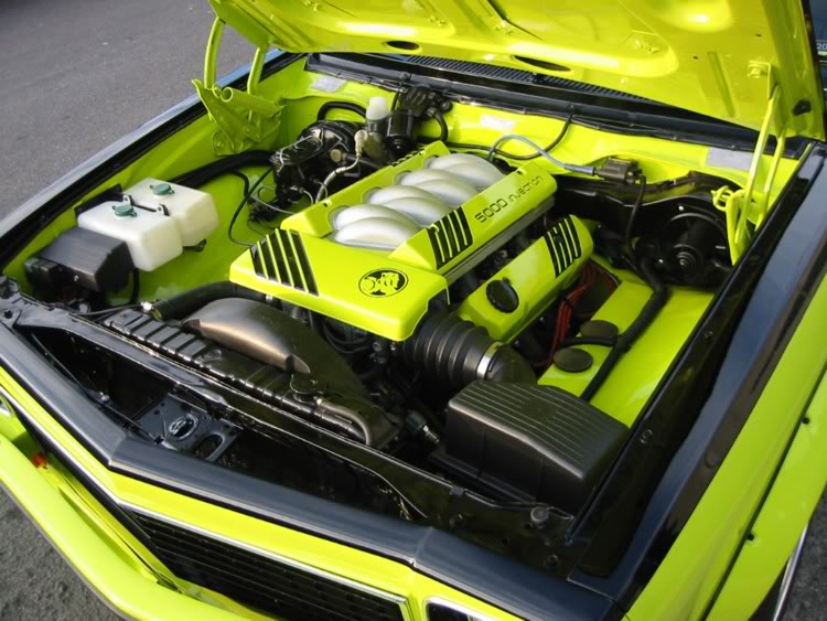

I have been literally in the engine bay for two days trying to sort out the harnesses, heater hose & tap etc etc.. I modified an air box from a Vy commodore but when I put it in today it looked shit house. I might modify and try the original VS HSV box which is in the last photo.
I have seen a couple of 5lt efi conversions and the airbox they have used looks neat but I don't know what they were out of, and carn't seem to find any photos of them.
Please post up some photo if you have any that might fit the bill. I don't like open pod filters so would prefer to go with something that has that factory look about it.

Maybe a V6 one would be the go? Same box as a V8 (except HSVs which had the smoother version like you've got there) but the inlet is more of a 45 degree on the corner rather than straight in the side.
When I did the VK I modified an HSV box to it suited a V6, maybe something like that is an option if you want to muck around with it?

I modified a v6 airbox to fit and it looks ok, but I think the hsv ones look better (I was too cheap to buy one!).

I am struggling with this bit too. I am tossing up making a box to suit the shape and a standard air filter out of mild steel and painting it, as i can't find an airbox that fits like I want it to. I have put it in the too hard basket for now, but I can afford to because my car is far from the stage yours is.
With your skills and equipment, could you make something custom to fit and look just right? Then sell one to me... (you saw that coming I am sure... :-))
Forgot to say - which heater hoses did you end up using? I am just shortening my original donor engine ones (VN V8) but would rather ones that look neater like yours.

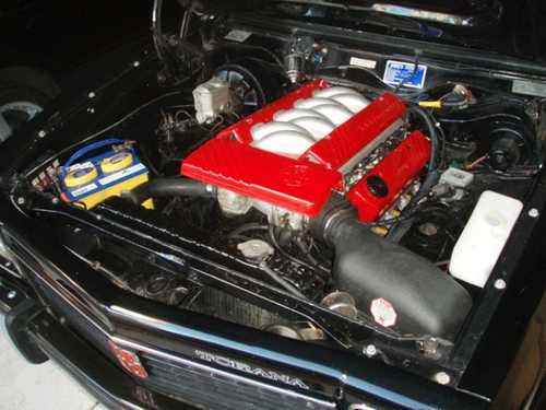

A few people seem to have made the stock airbox fit reasonably well. Picture from this thread.
There are a few airboxes discussed in this Autospeed Article.
I made a fiberglass airbox.
Edited by ls2lxhatch, 29 July 2014 - 07:22 PM.

Wow Andy that looks very flash. I am going to play with the HSV box that come with the engine and see how I go. There not a very big box but still might do the job.

I ended up fitting a HSV air box that that I had lying around for some time. It didn't take much work to get it to fit and I can adapt a cold air induction pipe up without to much mucking around. I think it fits in with the look I was trying to achieve.
Thanks Andy the link you posted recommended this air box as being one of the better ones to use. I thought it may have been a bit small but the figures show it flows better than I thought.
