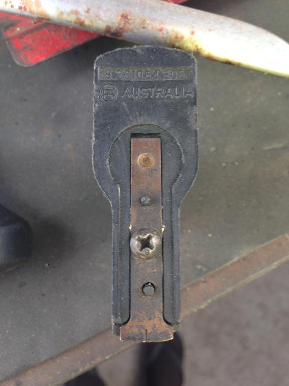

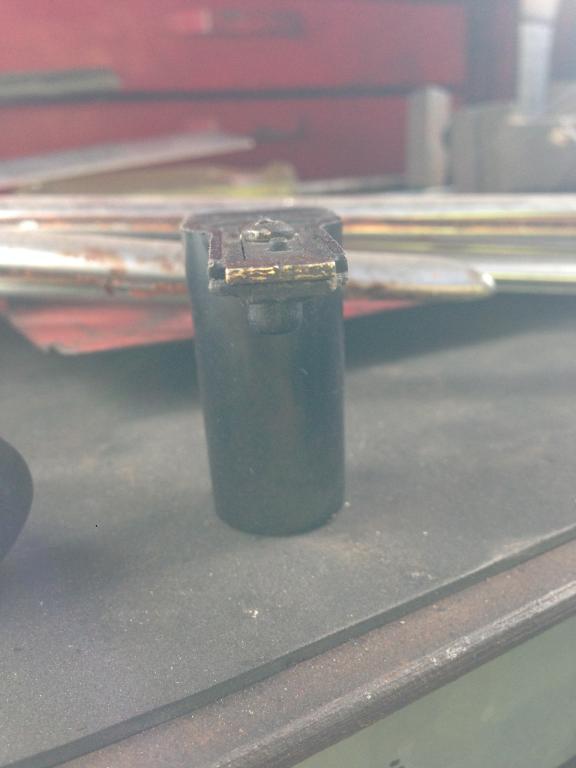

Thought id take a few pics of the rotor button, does this look rooted?

Jacob, I know a few other guys have already suggested this, but if you haven't already taken the rocker cover off and checked you rockers, then you should do so. You mentioned that you heard a bang as you changed down and then the problem started. It is very easy to over-rev on change down and old Holden rockers do not like to rev too high too often. I did exactly the same thing on my old XU1 at Winton with the same result. On the other hand, if you really can turn the rotor button 90 deg without any resistance, then there is clearly a problem in the distributor drive system.

Need to look at the other end of the rotor button.
Ummm. Have you followed the guide I posted?
If you do it, and give answers someone here will give you the diagnosis.
Still reckon its internal.

I haven't actually had the chance to get down and follow the advice given. Hopefully ill be doing this today, just thought id post up some pics in the meantime. Does it actually look ok in general, or does it need to be replaced?

For the $15 for a new one, it won't exactly hurt, that one doesn't exactly look new.

Looks ok from those angles. But its the underside where it fits on the shaft is where the damage will be that may be causing your problem.
