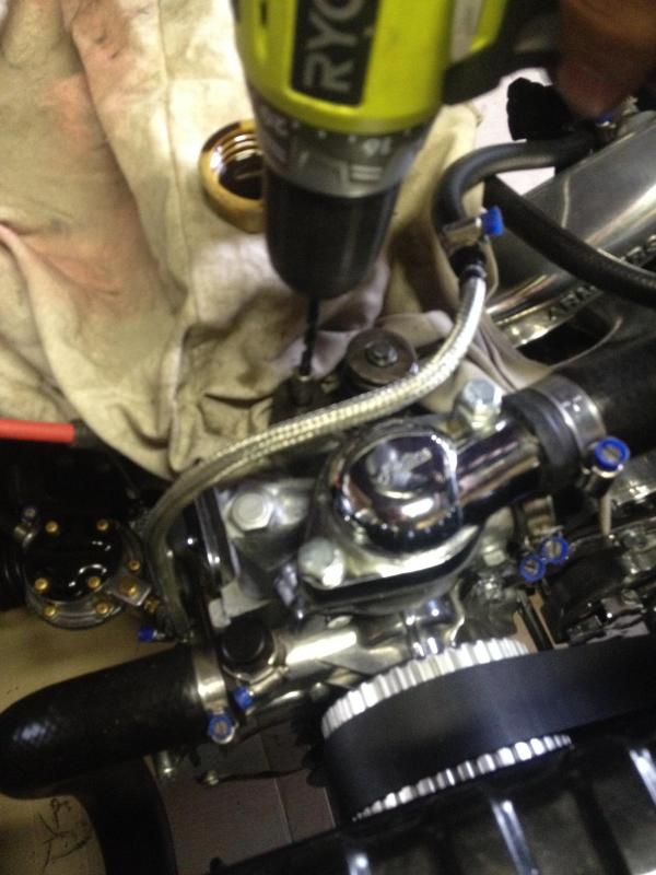

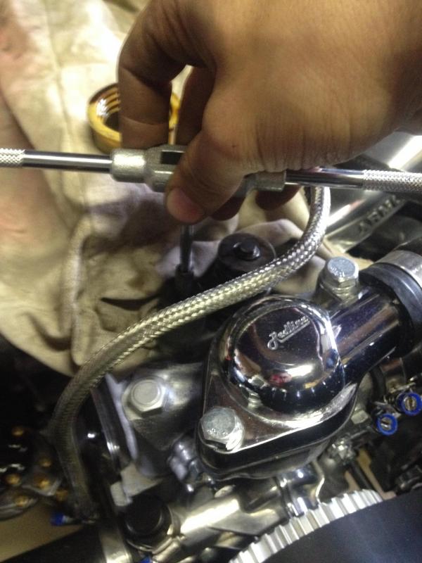

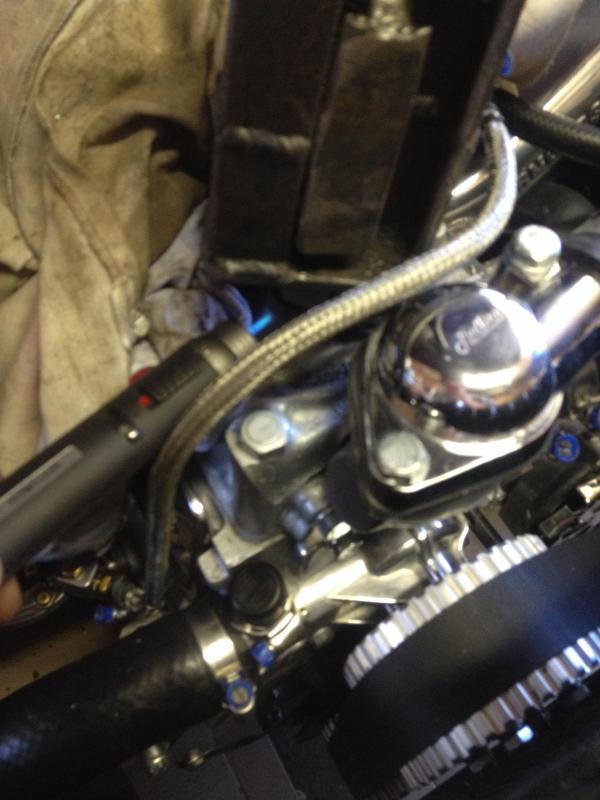

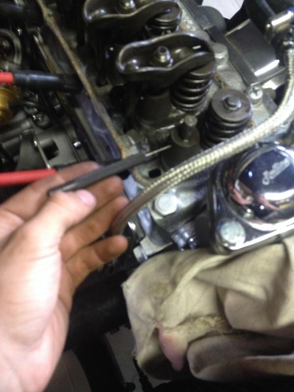

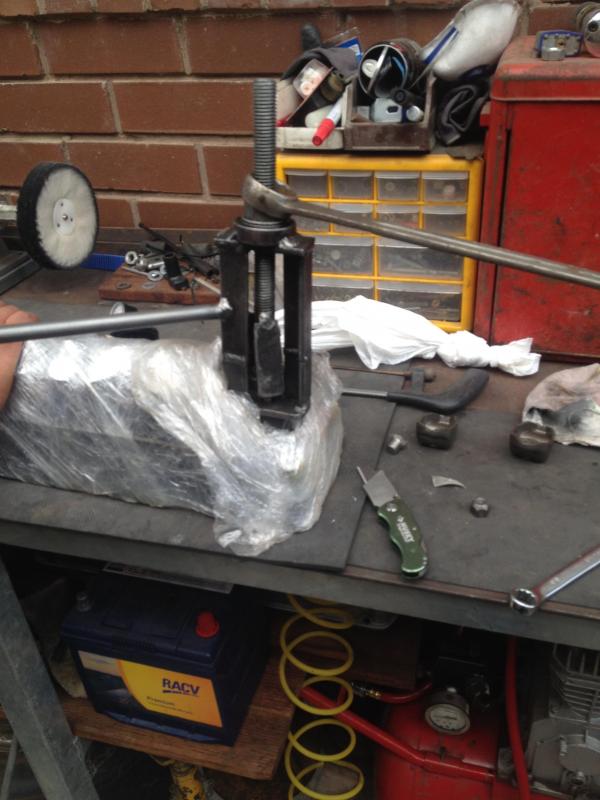

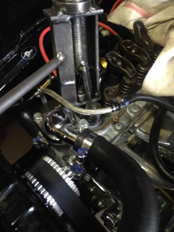

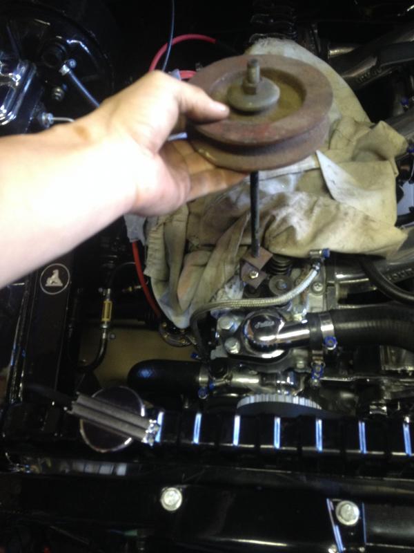

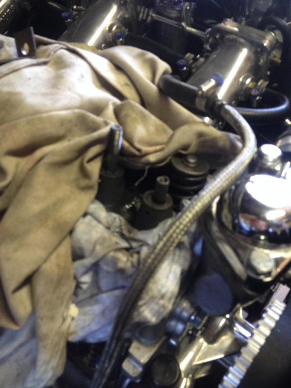

#435 _judgelj_
_judgelj_
Posted 23 February 2014 - 03:49 PM
The problem
Removing a spare rocker stud
Removing roll pin
Drilling stud
Tapping stud with 6mm tap
Attempting to remove... 5 snapped high tensile bolts later...
5 snapped high tensile bolts later... After this i tried the LPG but its too risky for my positive valve seals if i haven't burnt one up already.
Resorted to making a slide hammer
So there you have it. A detailed series of pictures showing you why i am so gutted right now. And on top of everything, it actually turned out to be an amazing day today (despite yesterdays rain and clouds). I saw one slr5000 on the road and i shed a tear as i made my way back from bunnings with the supplies for the car.
I seriously do not know what to do. And i know you are going to say remove the head ya wuss, but its honestly the very last resort.
Edited by judgelj, 23 February 2014 - 03:55 PM.
