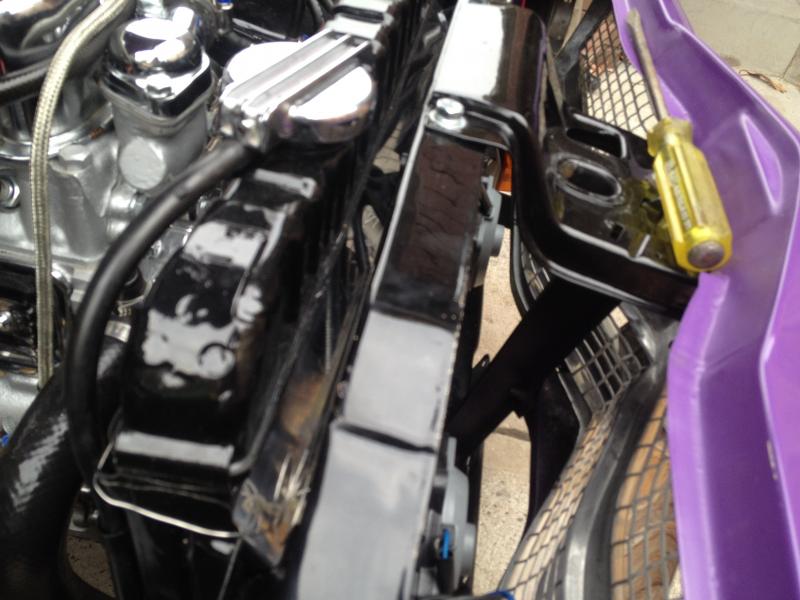

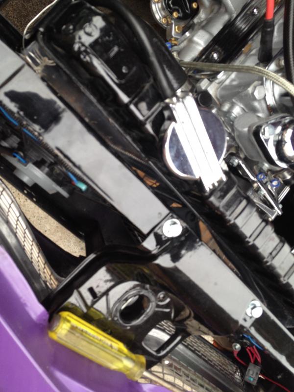

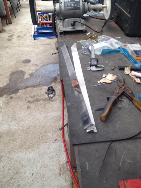

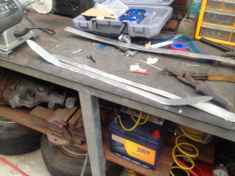

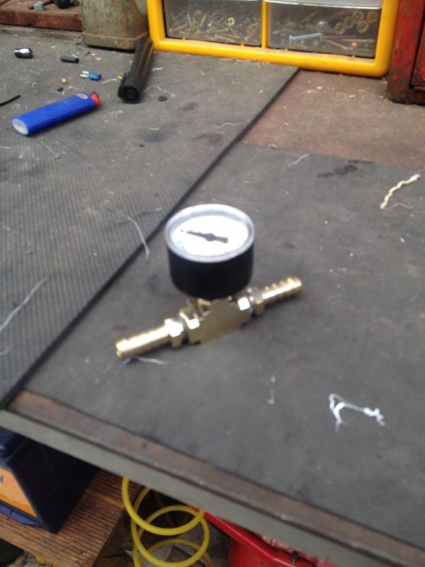

Prior to this, here is some of the work i was doing. Made a fuel pressure gauge fitting and made up some aluminium cowls to direct airflow into the radiator and not up into the engine bay, or down onto the ground.
Dummy and final version
The polished/seemingly see through bit is actually the polished alloy.
Ill be ordering a new speco 15psi gauge from ebay.Whether or not this works as it is pneumatic, ill never know as its 100 psi and wont register a measly 2 psi.
