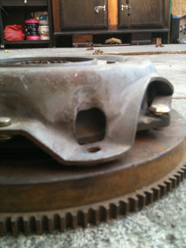

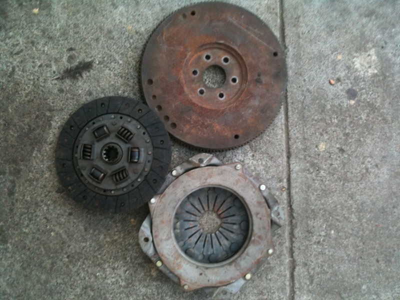

Just to make sure this is the clutch setup i have, do they look about right?
Should there be a gap between the fly wheel and pressure plate?
#34 S pack
Posted 20 June 2012 - 10:04 AM
That clutch set up looks correct for your car but hard to say 100% from pics.
That gap between the pressure plate mounting tabs and the flywheel is correct otherwise there wouldn't be any clamping pressure on the clutch plate.
Also hope you are going to get those rusty surfaces machined.
#35 orangeLJ
Posted 20 June 2012 - 01:07 PM
The flywheel definitely needs a machine, the clutch you might get away with some emery and a light scuff up

yeah flywheel will go in the next couple of days to get done definitely. does the pressure plate need machining or can i get away with some emery?
#37 S pack
Posted 20 June 2012 - 03:05 PM
If the pressure plate is brand new and the rust hasn't pitted into the suface then some emery paper run over it should clean up the surface, however if it is used or there is rust pitting occurring then I'd have it checked and machined if it's suitable for reuse.
