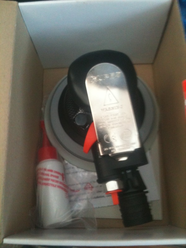

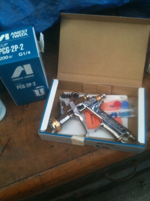

Ok well happy birthday to me! Picked up these babies on the weekend for future body work. Same gun and orbital Toyota production plant uses.
These bad boys are for my newly found interest in polishing! Will start on my wipers which were painted black but quite nice underneath. Will try my hand and polishing them, though i only think they will need a white buff. Will also polish my gutter molds and door molds.

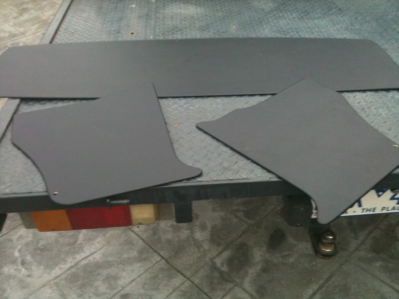

And these are my new kick panels and parcel shelf, just have to cut out the holes!

Hi Jacob
Looks good, nice finish. What size pot do you have on the gun?
Regards Simon
#59 _judgelj_
_judgelj_
Posted 08 July 2012 - 04:20 PM
Hi Simon
Its a 200ml pot, 1.3mm tip

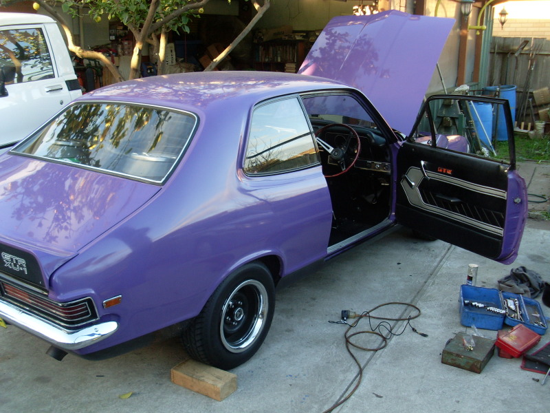

Posted 29 July 2012 - 05:53 PM
Well, what a very eventful two weeks straight of monday to sunday work 9 -7 or so. Enough to put anyone off touching a car ever again. Some people get to have a few days rest when the work gets hard but because my car was stuck at my uncles work shop i had no choice but to work on it every day until it was finished so i could get it out of there, plus the car sitting in the rain really did a number on my stress levels, hoping it wouldn't have developed too much rust.
Why did a manual conversion take two weeks you say? Sit back and relax as this may take a while!
So i began disconnecting everything inside and out in order to remove the transmission, and with the exception of a stubborn converter it came out without any real hassles. The next step was to tap in the spigot bush which had been soaked in oil for a couple of days, no issues there. Bolted on the flywheel and lined the clutch up by eye, slipped in the gearbox and bolted it all up. After i fitted my shifter and attached all the linkages i noticed that it was pretty close to the trans tunnel. Had to use the gearbox mount from the trimatic (are they the same) as the other had perished. Upon bolting up the cross member i noticed the 3/4 gear selector rod was fouling on the trans tunnel, turned out i had what seemed to be LH/LX linkages.

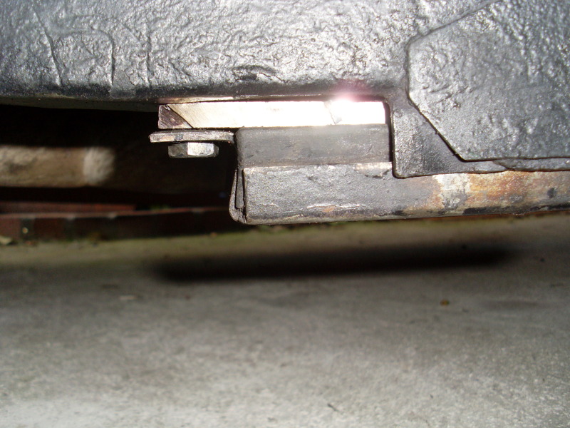

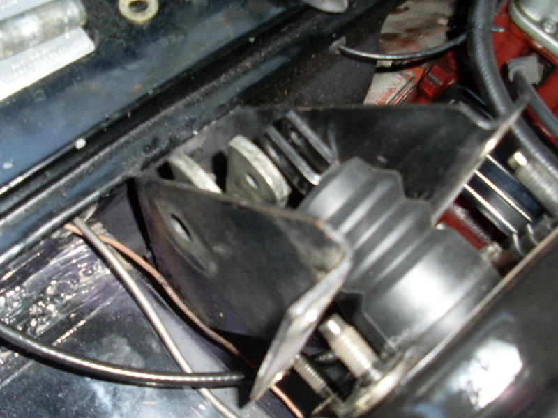

Upon researching i found out that the 4 speed 202's ran spacers between the cross member and chassis rails so i cut some out using 10mm steel and drilled them out with the drill press.
I achieved little with the spacers and decided to leave it and start on my pedals. I was hoping for a day job, two days max as the car needed to be gone Monday. Oh boy was i in for it!!

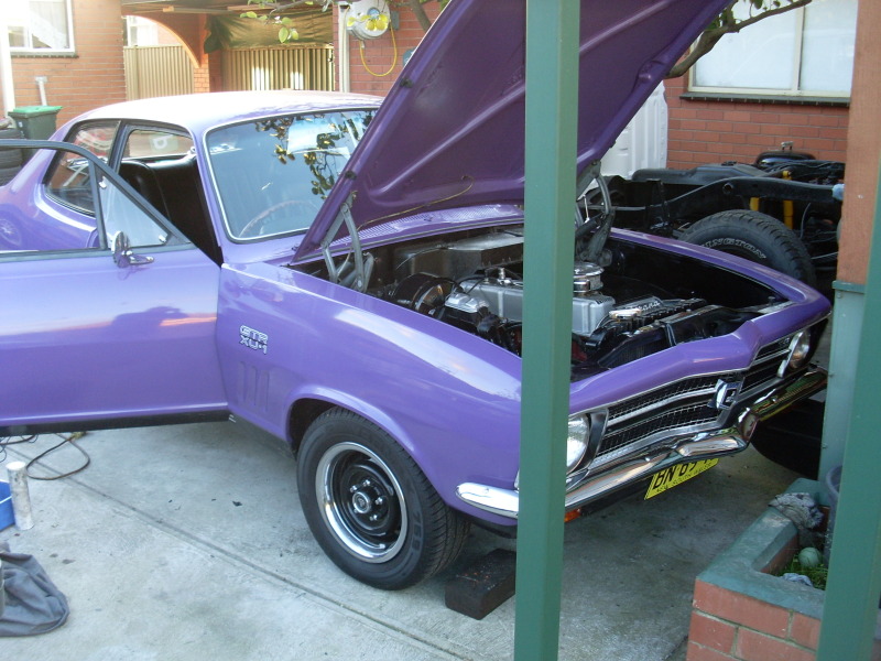

Rolled her away from the hoist and parked her around the back.

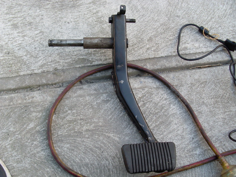

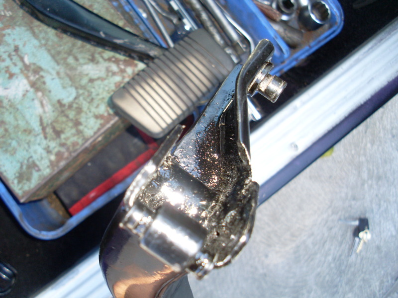

Pulled the front seat out as to not brake my back and proceeded to remove what i thought was the auto brake pedal. Had a bit of trouble getting the bloody booster rod off as someone had welded what i presumed was too thick a bolt (what did holden use originally?).Posted Image
Could not for the life of my get it off so unbolted the booster and the said rod from inside the engine bay.
Pedal came out quite easily, with the addition of a home made sleeve.
It was obviously modified and much to my surprise originally a manual brake pedal. Not quite sure why there was a plate welded on the back but didn't worry me as it was going.

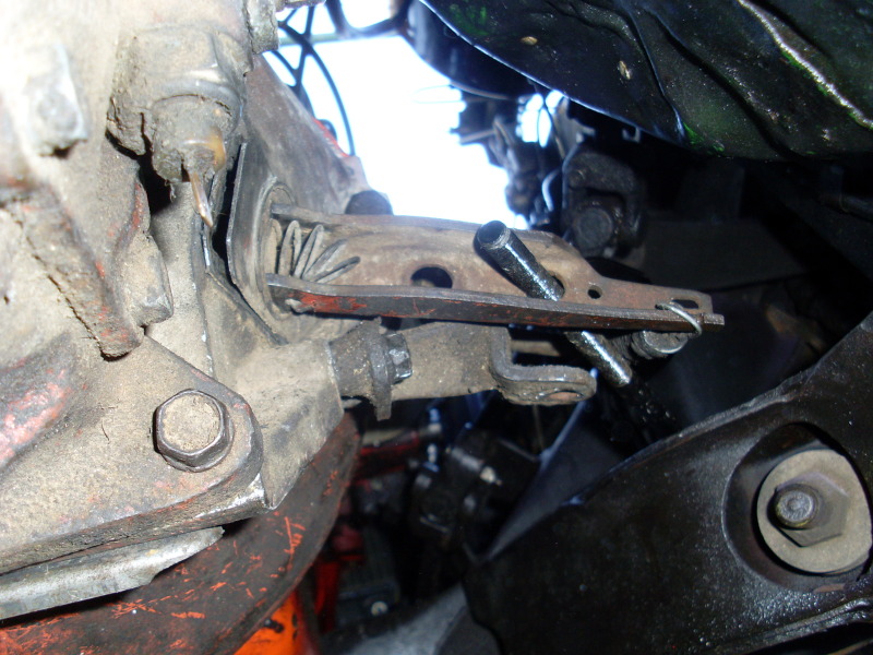

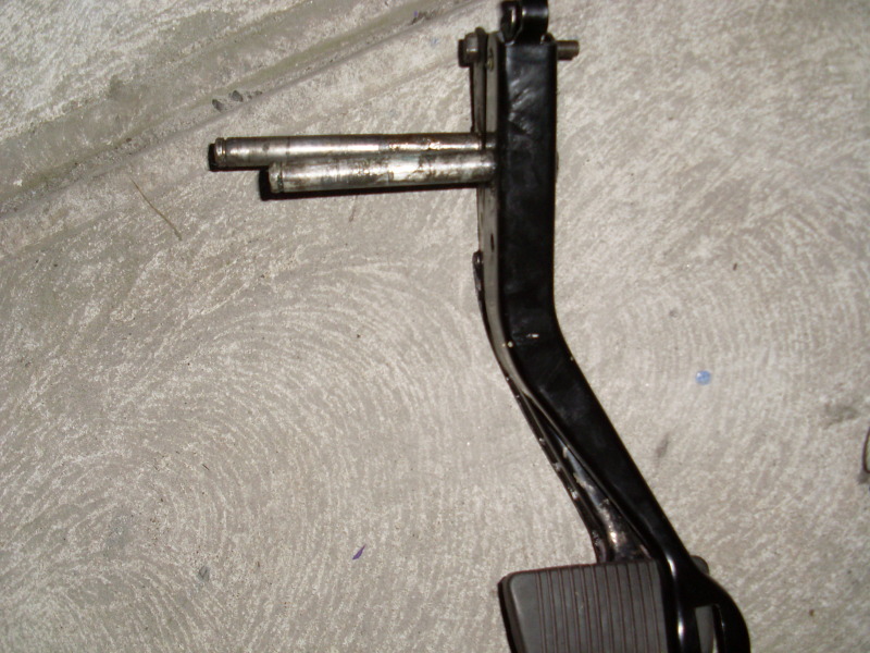

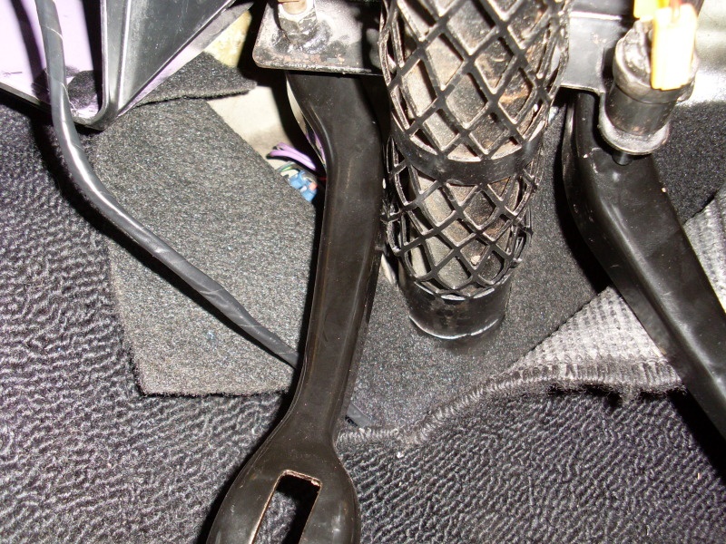

First thing i noticed was the difference in pivot rod lengths, and at that stage i didnt know why. I proceeded to try and bolt it all up only to find that the pivot rod was too short on one of the pedals. It appeared that the one i pulled out had been extended so i tried to use that one instead and this happened.
The clutch pedal was fouling on the steering column and i could not figure out why. This was pretty stressful as i not knowing why played on my mind, i wasnt sure if i was doing something wrong or it was the car. It got really late that sunday so i packed my things and went home. After a bit of research it was brought to my attention that the setup was all wrong and the clutch pedal should sit on the right side of the column, along side the brake, not on the opposite end. Turns out this was a result of the steering column being moved over 4" when it had a V8.
Come monday i was pretty bummed and ready to throw in the towel and fit the auto up again. I was out of ideas but with some kind words and encouragement i was ready to give it a go. I was under the impression it couldnt be done but thankfully i was told otherwise so i thought i would give it a go. I did some investigating and found that the 308 was coupled with a supra 5 speed so it was obviously manual once before and could very well be done with the 4 speed. This also explained the modification to the existing brake pedal as the rod would have been lengthened to run a clutch pedal further out from where they were from factory (factory rod is shorter). The sleeve was used to take up all the play from side to side and keep the brake pedal in one spot with the retaining clip on the other end.
Without hesitation i pulled out the grinder and got to work.
Before shots:

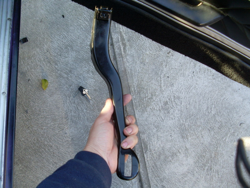

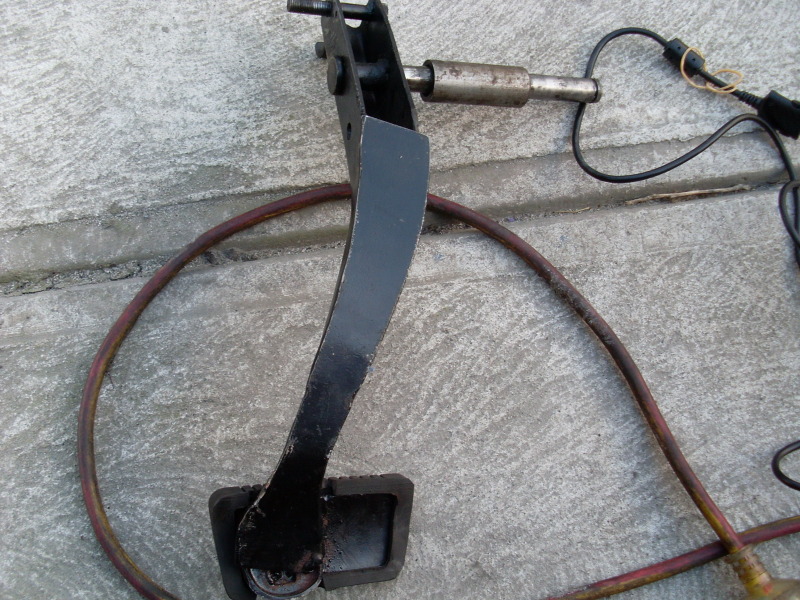

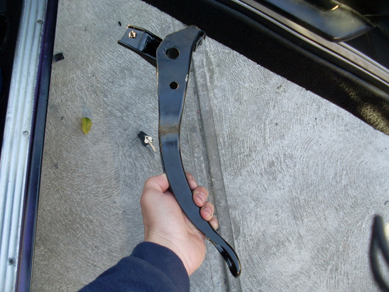

Made up a template of how the clutch pedal should be shaped in order to clear the column. At this stage i was unsure if it would work at all but went ahead with it anyhow.
Couldnt bring myself to cut it up but it was for a good cause.
Decided to use the original brake pedal as i could be bother removing the longer pin. Ground the sides flush and cut off the rectangular plate.
Dummy'ing up the new pedal.
Took day after day of bending, shaping, mocking up untill i finally got it right. The amount of times i was ready to weld and decided to change it completely, it got a bit frustrating.
Cut up the necessary pieces out of 3mm steel and got my uncle to weld it all up for me. He also re welded the brake pedal as it split the welds grinding it down.
Before i cut it up i traced the original shape and cut some slits to bend it close to the original shape. I wanted to maintain the same travel so payed close attention to the length as well, didn't want it being short in comparison to the brake pedal.
Spent the next day or so grinding and unfortunately being as impatient as i was went to fast and gouged the crap out of the metal. It didnt help that i was using a solid disc so switched to a flap disc and the results were impressive. Much better but still needed some work. Would have liked to 2pak them again but was in a bit of a rush so i spray puttied them in the hope i would level out the surface.
Hit them with the rattle can and although i wasn't happy it would have to do.
Next step was to sort out the rat trap. I bolted it to the chassis rail but noticed there was no where to bolt the relay support brace. Turns out of had a LH/LX bell housing bracket and it needed to be modified accordingly.
As you can see its a horizontal mounting tab and needed to be vertical so i cut out some angle steel and had it welded. Gotta love these welds, if anything was to brake it would be the bell housing i reckon.
Edited by judgelj, 29 July 2012 - 06:06 PM.
#68 _judgelj_
_judgelj_
Posted 29 July 2012 - 06:06 PM
All bolted up
Neutral safety switch bypassed.

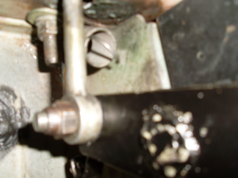

Next step was to sort out the over center spring assembly. At this point i was really clueless and had no real idea of what needed to be done. Took a lot of measuring and trialing to finally work out what needed be done. a 1/2" rod with a 3/8" step down. End product was insanely cool, a bit over kill but it wasnt untill afterwards that i actually saw a picture of the holden factory item. What you see was once a Ford head bolt, machined by my uncle in his lathe to resemble what it is now. As you can see the heax head was deleted and cleaned up, Nut welded on and tapered. Two step downs to 3/8" with matching thread in 3/8 UNF.
Added another hex washer nut which was turned down never to be the same again.
Was a major job to get it right and with a lot of trial and error worked in the end. Seeing as though the pedals would not have gone in when i wanted them to i took the time to paint them properly. Rubbed them back with 800 wet and sprayed straight over with 2k black. Paint reacted slightly with the acrylic putty but still looked great.
Finished product.
Cut up the sleave to space the clutch pedal out just before the ratainer clip.
Tapered the inner nut on the pin to sit nicely on the rounded surface.
Tried to get the spring in and it went the first time however forgot the bushes so it had to come out again. Spent a lot of time stuffing around with bushes that didnt fit (thanks rares), i put it all together and attempted to replace the spring and BAM, it snapped. Started to machine a new one out of alloy on the lathe but turned out it would take a while so i used some rapid fix to repair the plastic temporarily until i can get a new one machined (currently looking to buy or borrow one to copy).
How they look once fitted.
One thing i noticed about this car was that everything was modified, even the entire throttle assembly. Would someone be able to tell me if the booster bracket has been moved over?
Well anyway everything seemed to be done including the clutch cable anchor i made to pivot off the clutch pedal. Had to pop out the factory pivot point as after years of use it had nearly worn off. I used a long bolt as the anchor would not line up with the cable.
So tried to fire it up and after discovering it had a kill switch couldnt figure out what was preventing it from firing. After further investigation it seemed that the engine was jammed and to cut a long story short the flywheel bolts were 120 thou too long. So out came the box and did a few things to it while it was out.
Too long
Bent the bracket to sit further away from the tunnel.
Reverse light switch loom
Made up a new rod adjuster bracket as the old plastic POS broke.
Plenty of clearence
Modified crossmember for the supra box? The start of the tunnel had been modified to clear the bigger bell housing.
Shorter bolts

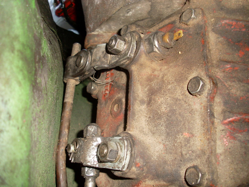

What is this switch for?

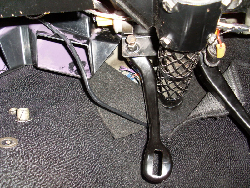

Took her for a road test and she went well. So much more fun to drive, pulls so much harder. Shifter is sloppy but havent driven a four speed before so im guessing they are all like that?
The only problem that was left bard the pedal rubbers not fitting on because of the extra bracing on the back of the pedals was that the clutch cable fouls on the extra steering knuckle when you turn. To combat this i was thinkin of backing off the tension and using an anchored pulley to keep the cable away from the steering by allowing it to operate with a slight bend.

Great work Jacob, switch on box senses when box is in top gear as far as I am aware, tells vacuum module when car is in top on later cars Known as transmission control switch, allows vac
advance in top gear only

Jacob, don't worry about that switch on the gearbox, it's not applicable to your car.

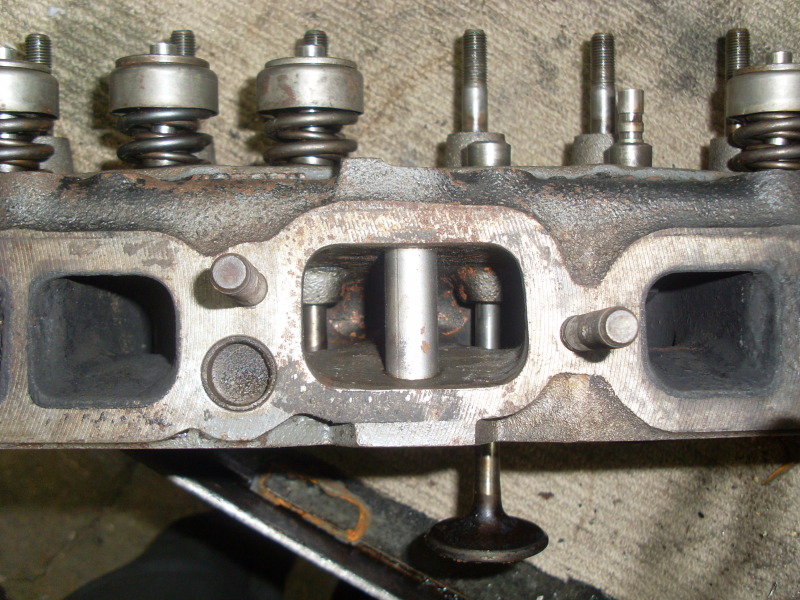

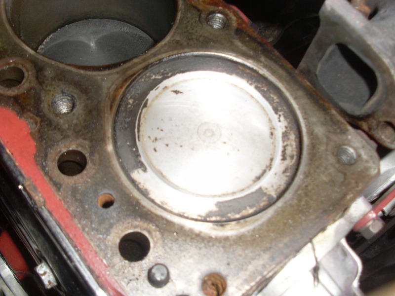

Ok so i have taken my head into the shop to have the valcve springs replaced as they were only holding 55 pound. Asked him to check it out for me and it turns out the guides are worn as well as the valve stems. He reckons to re do the guides, second hand valves and increase the throat size for free it will cost me 500 all up including springs to get the head to brand new. Before i take it anywhere else which i didnt really want to do, how reasonable does this sound? Seems like i could find something reco'd of the same spec for similal pricing?

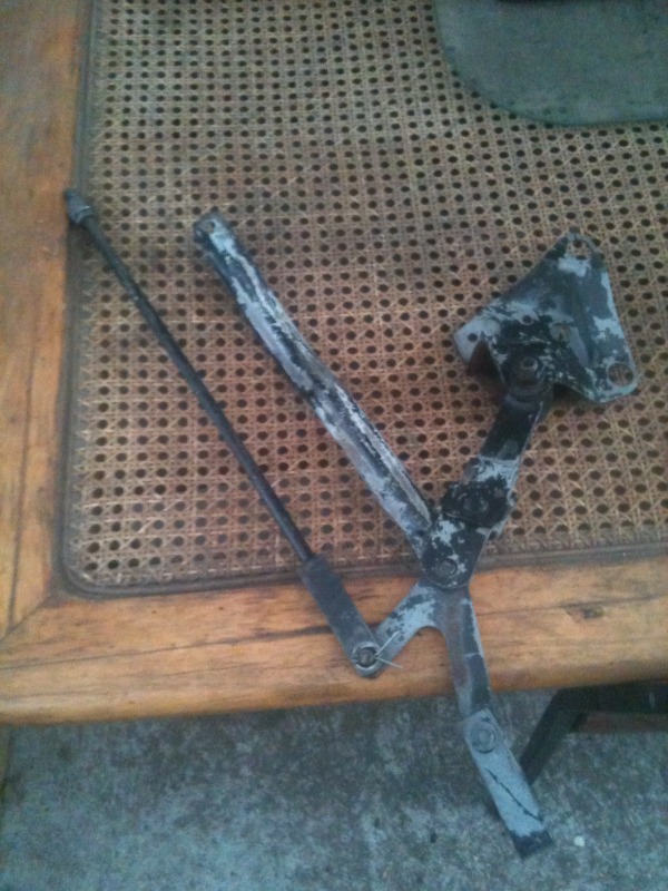

Have become addicted to polishing metal now and finished off my wiper blades

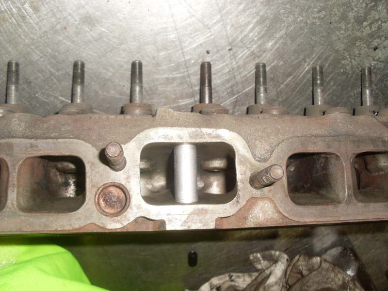

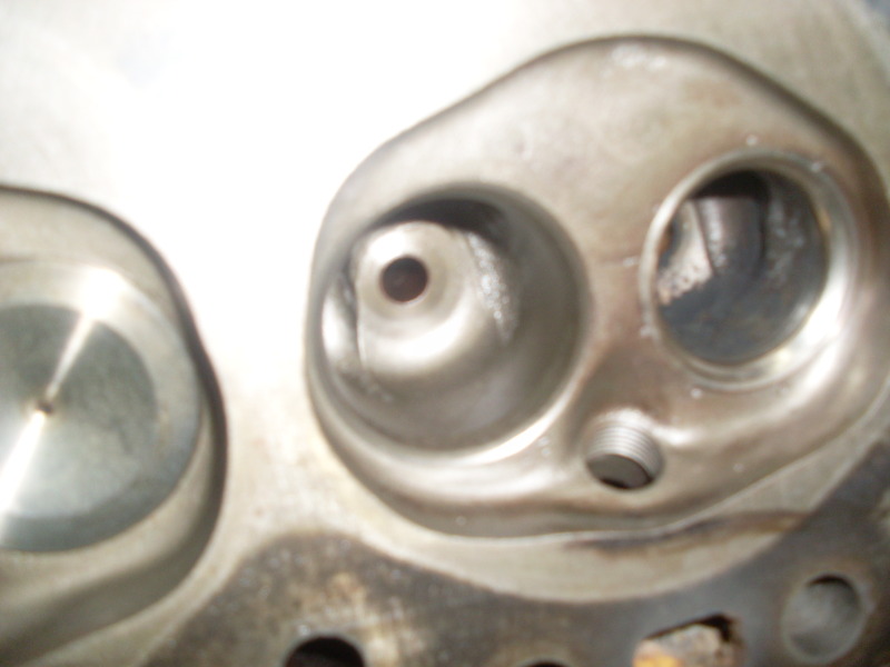

Guides on 186 head
Guides on 161 head
Ports on 161
Ports on 186
186 Valves
