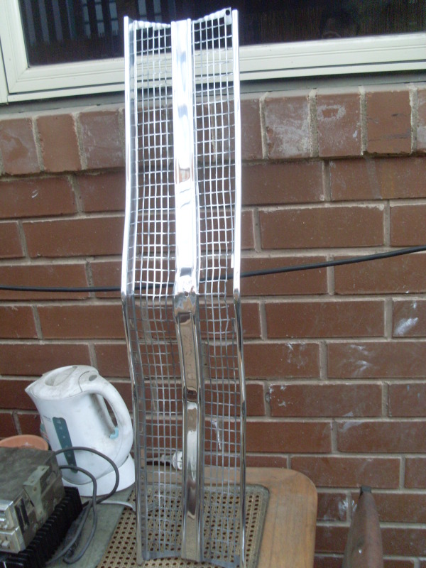

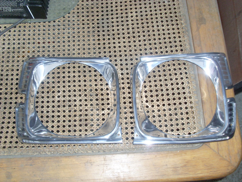

Well i've picked up my grille and wow what a good job. Looks beautiful, too beautiful to paint in fact. The only thing he couldn't do was the mesh section as the wheel would catch and rip it to shreds and i'm not prepared to pay big dollars for it to be done by hand so i will give it a go myself.

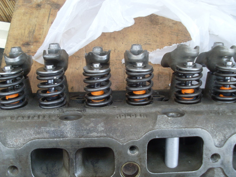

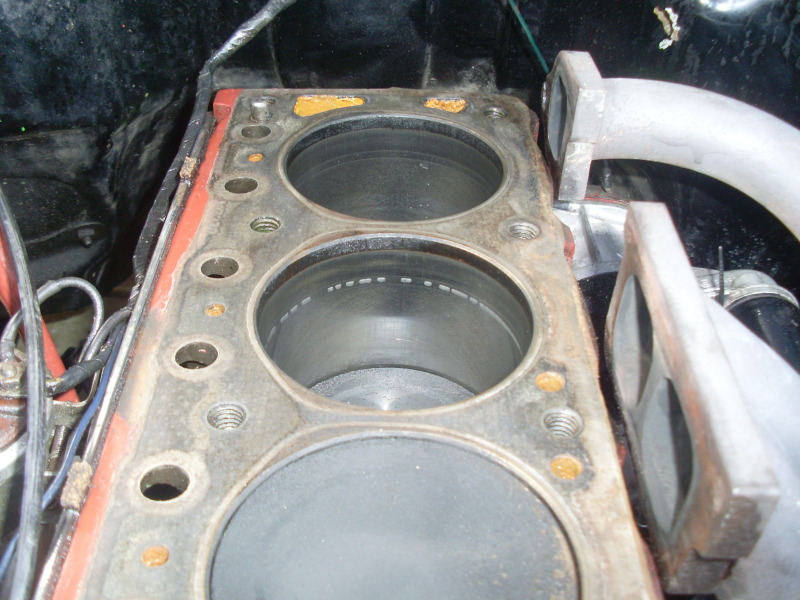

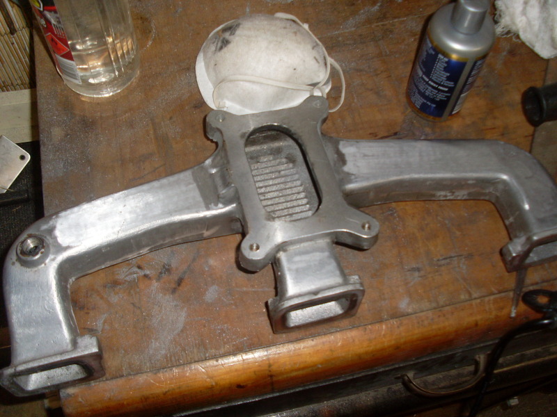

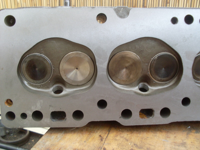

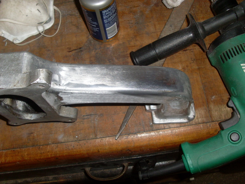

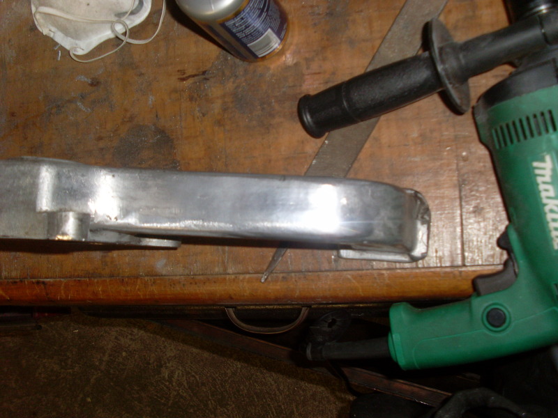

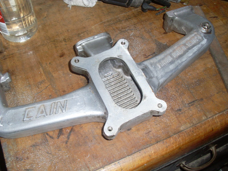

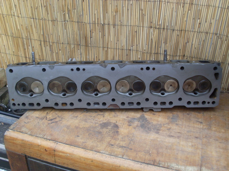

Head also went back on. Cleaned the block, fitted gasket and torqued to 30ft/p then to 75ft/p in sequence. I realised i was using a 186 manual so i hope this is correct? Manifold will go on as soon as it's polished, currently in the process of doing so. Have ground down all the lettering and tabs to go for the smooth look.
Seals fitted

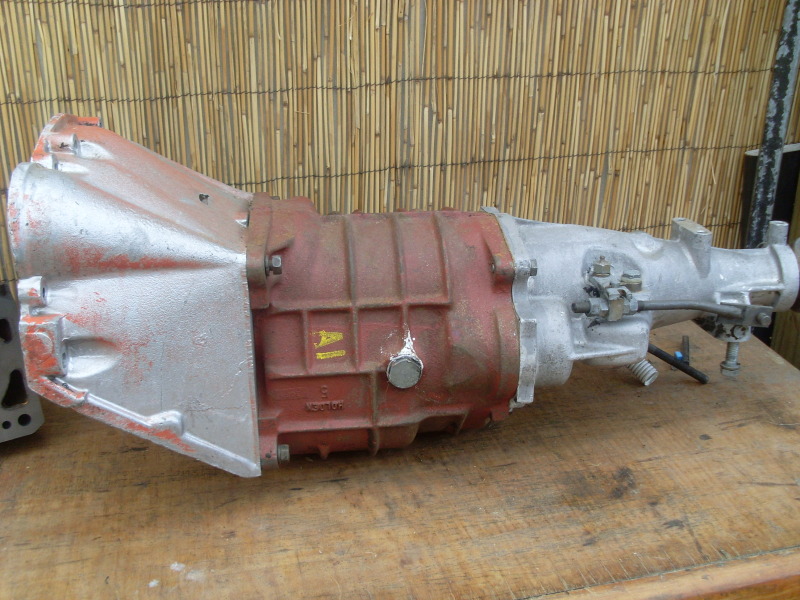

Started restoring my G/B to go back in at a later time, would you believe this was completely black. Took a while with the gurney.

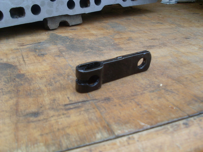

Got my clutch anchor thanks to the forum member Ice and his handy work. Cheers mate!

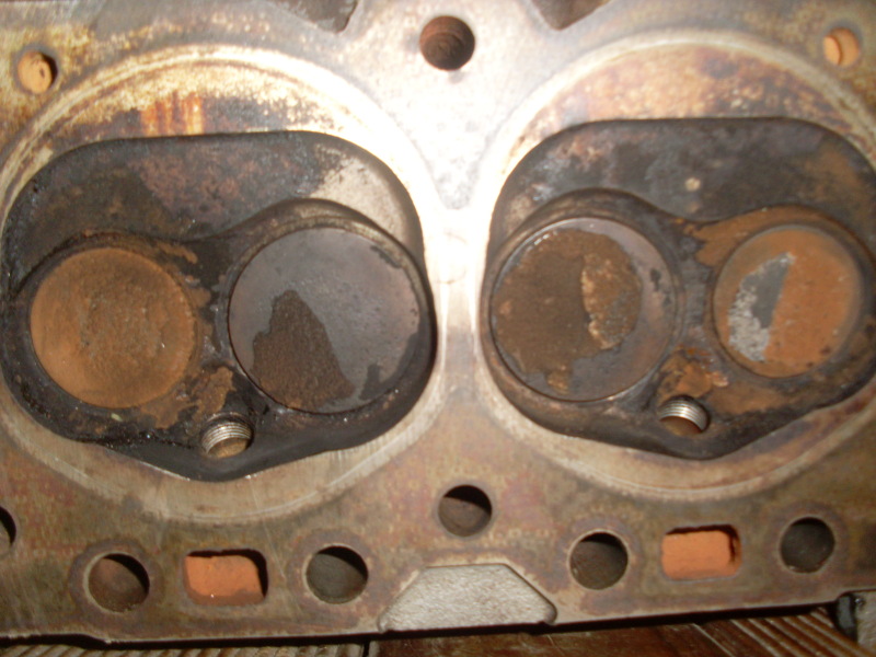

Anyone know what the white residue is in the second cylinder from the back? It wouldn't wipe off.

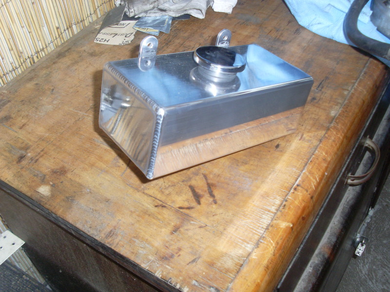

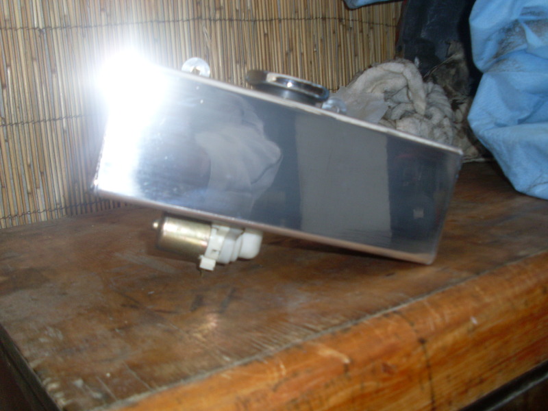

Polished washer bottle
This was the 161 head if anyone was curious. Closed chambers but with a recess machined which makes it one cc larger than the open chamber 186.

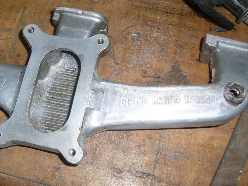

Interesting firing order in the pre-ground manifold pic :-)
What exactly are you running in that thing! ;-)

Potta, manifold was taking too much time and has been retired to sitting on the bench indefinitely!

Haha, good spotting Potta, looks like an eighth cylinder has snuck in there according to this pic!! :P

Oh wow, so that makes it rare and highly valuable, doesn't it? And to think I ground It off!!

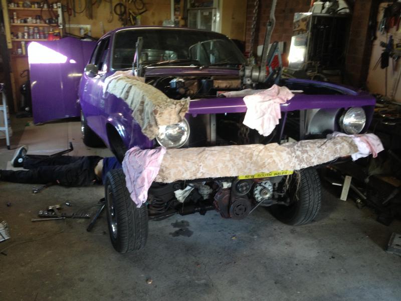

Trying to get the engine/k frame removal started. Just want to know the best way to remove the steering column...
Hi, you don't need to remove your steering column. Just undo the four bolts on the rubber coupling. I just did it on mine today here are a few pics.
Attached File  044.JPG   162.22K   3 downloads
I made a bracket that slips into the bumper mount slots, make it stick out far enough so the chains don't damage your nose.
Attached File  047.JPG   152.15K   3 downloads
Attached File  048.JPG   148.32K   5 downloads
My old skateboard came was very handy for supporting the gearbox, then I just rolled the whole lot out.

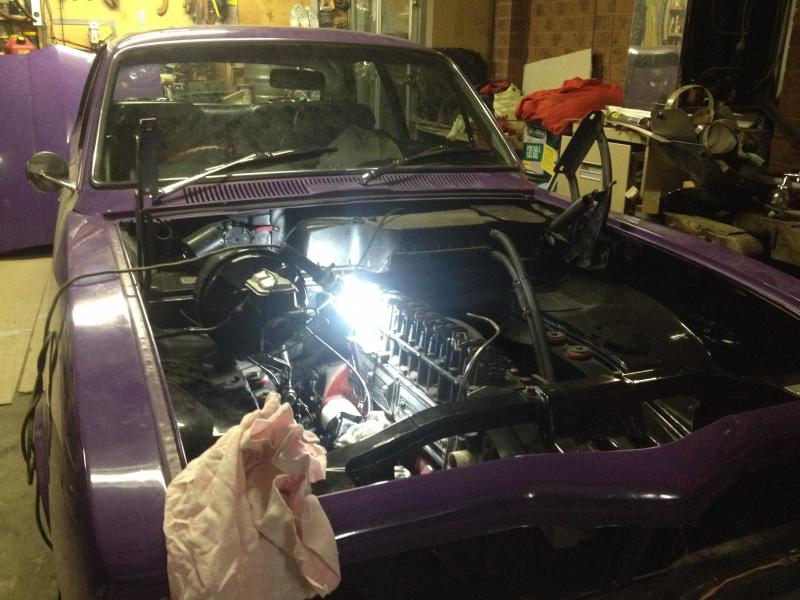

Got started on a few things, including prepping the engine bay for the front end removal. Disconnected radiator, various hoses/lines/wires etc. All that is left is the rat trap and steering shaft. Is anyone able to give me a brief rundown on steering knuckle dis-assembly?

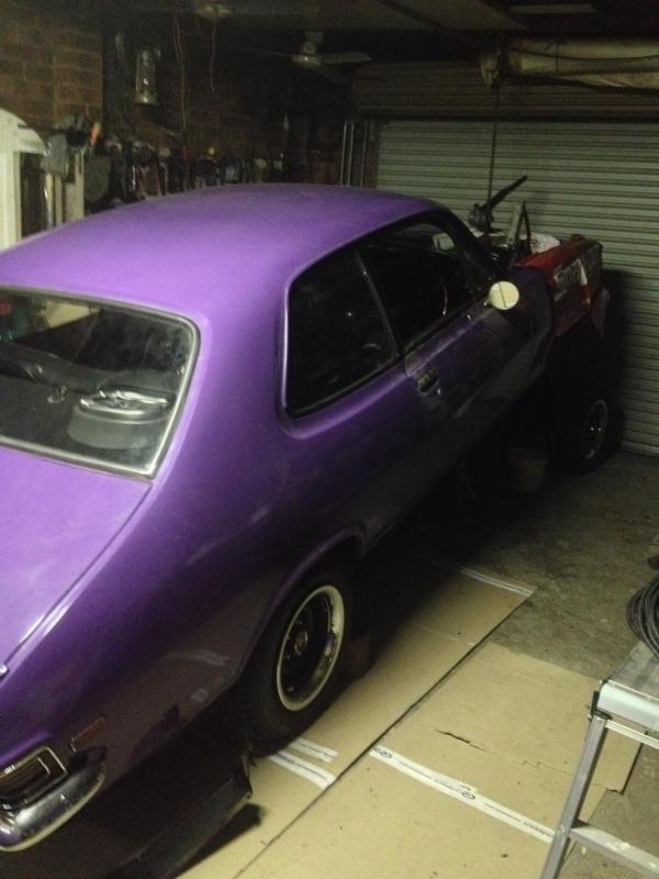

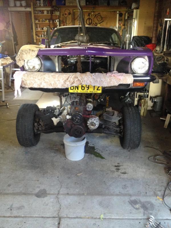

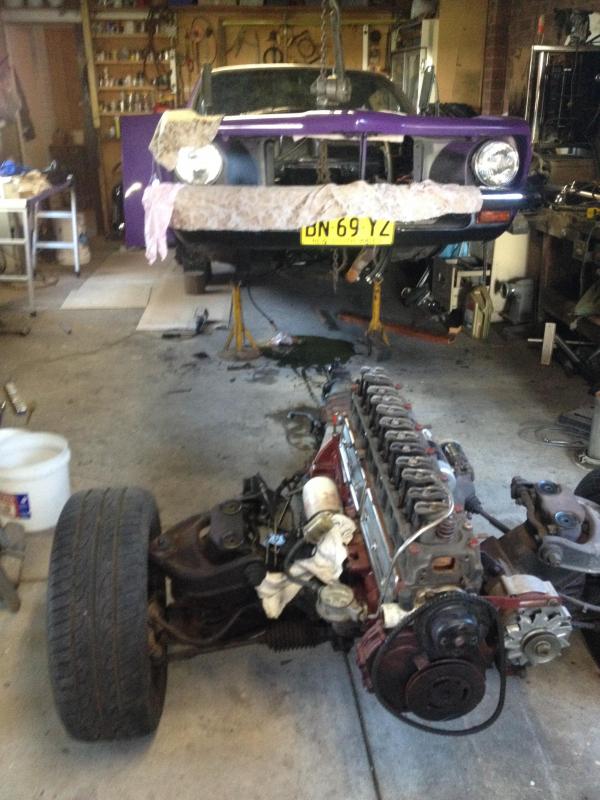

Well anyway, after a much hated break, finally got around to the good stuff. What a prick of a job. So not as easy as what i thought it would be. In fact a lot more disconnecting than i anticipated. Moved the car on the tandem to a place i could actually work on it. Started by disconnecting everything. Took me a while to find a suitable lifting block. Finally went with some cut down redgum and managed to scratch up a fair few things with the chain. Hardest part was getting the tail shaft out of the box by rolling it forward. Got it out, box fell off the jack, and the motor made some nice improvements to the front part of the body.
Apart from that got it rolled out and ready to be modified. Plan is:

Do you mind sharing where you had your grille & headlight surrounds done?
